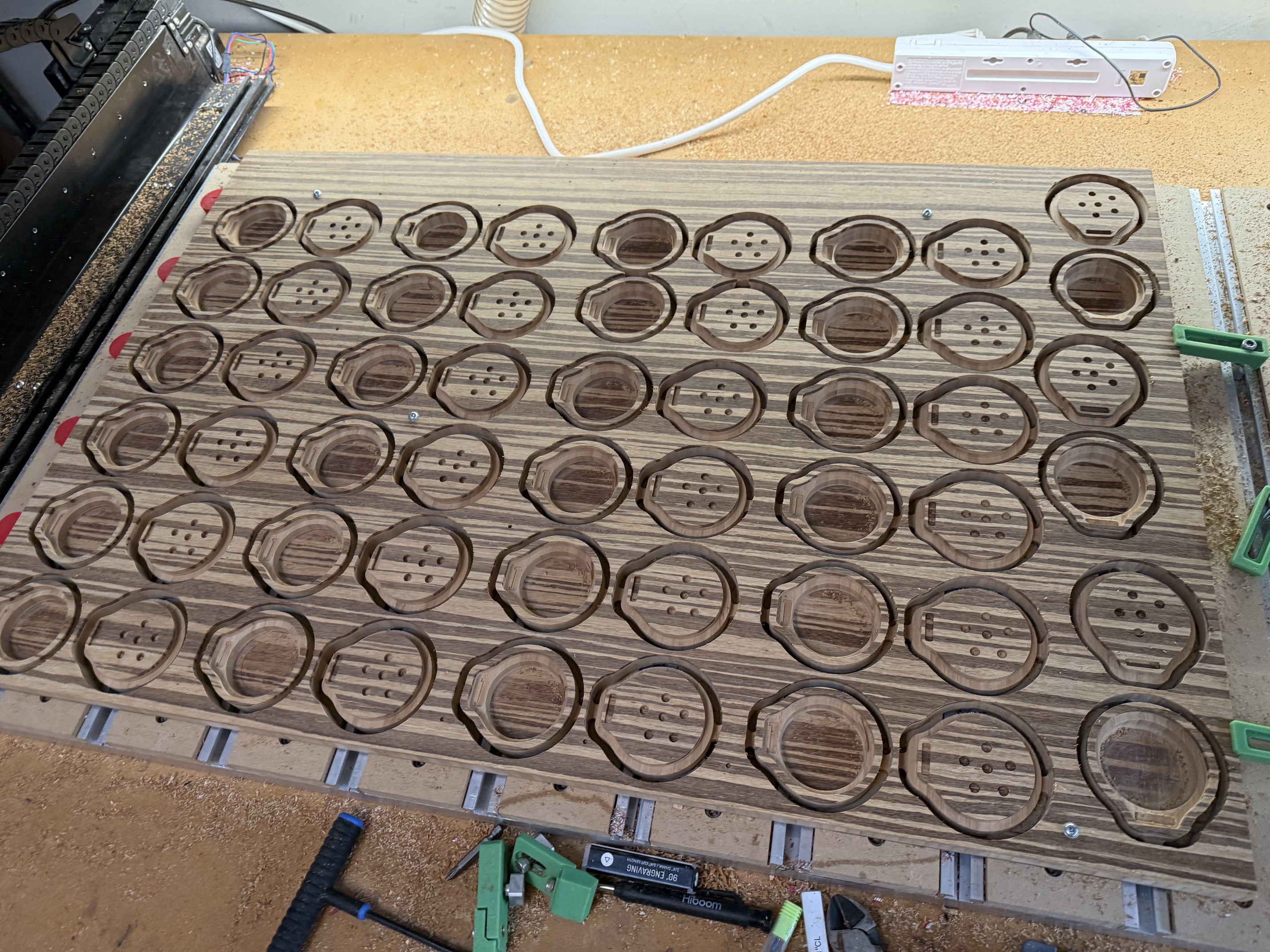

Started out making a couple of scentwork vessels for Olivia (my Golden Retriever) and my scentwork class’s present exchange. Wound up making a bunch. Only issue is drilling the holes. Ended up just drilling a shallow marker spot and drilling them out by hand.
The material is BAM-X, a bamboo plywood. Machines well but the 1/8 end mill screamed like crazy no matter what feeds and speeds I tried. The other bits like an 1/2 inch bowl bit and an 1/8 inch roigh weren’t much better.
Anybody else have any experience with this stuff?

Are you cutting slots as narrow as the tool significantly deeper than the diameter of the tool?
Where possible avoid slotting and add geometry and cut as a pocket

Not that specific brand, but I have cut both laminated bamboo cutting boards as well as strand woven bamboo stair treads, and that stuff is as hard as a rock - as it were.
I typically had to cut no deeper than 0.040" or 0.050" per pass to keep the bit from screaming.
