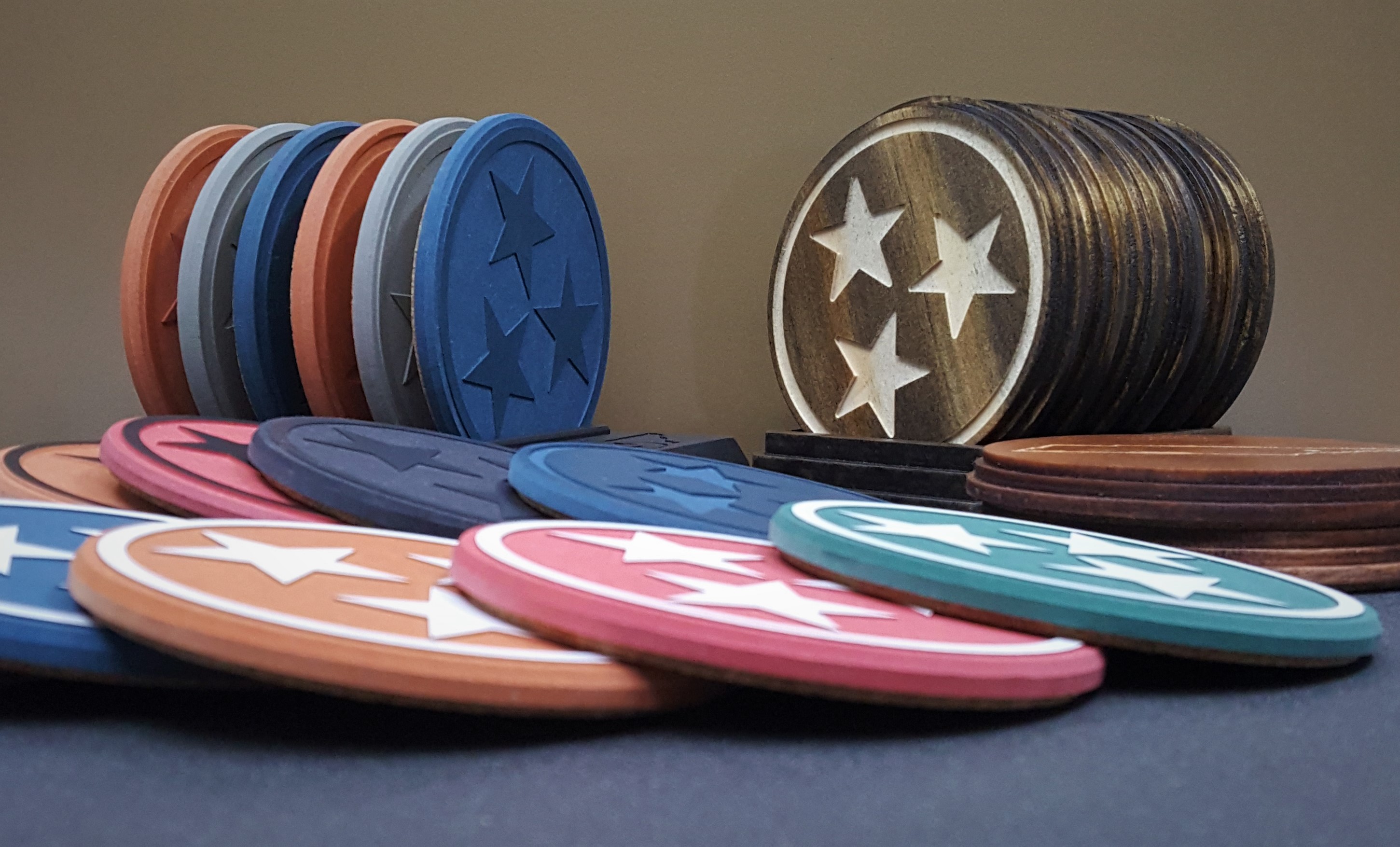

Well this monkey started thinking, and like I have stated before that is a recipe for disaster… “just make a website” my brain was whispering sweetly…“it would be easier to ‘peddle your wares’ that way,” sang the siren’s song… yeeeaaahhhh that took longer than I thought. Kudos to you guys with sleek websites, that stuff isn’t easy.
I have cut some things…just nothing out of the ordinary or remotely groundbreaking. Lots of coasters and riverway signs. I wish I had something cooler to add to my post like linear rails or some neat upgrade as I am chomping at the bit for more “pure cnc” fun. I just cant afford to have my machine down right now and I seem to constantly be behind. I have toyed with the idea of building a Shapeoko clone “from scratch” since I have an extra controller board laying around, but we all know where that will end up (if it ever ended
) as I share the same desires as the rest of you crazy dudes…
Anyways, on to something slightly more interesting…
Coasters:
