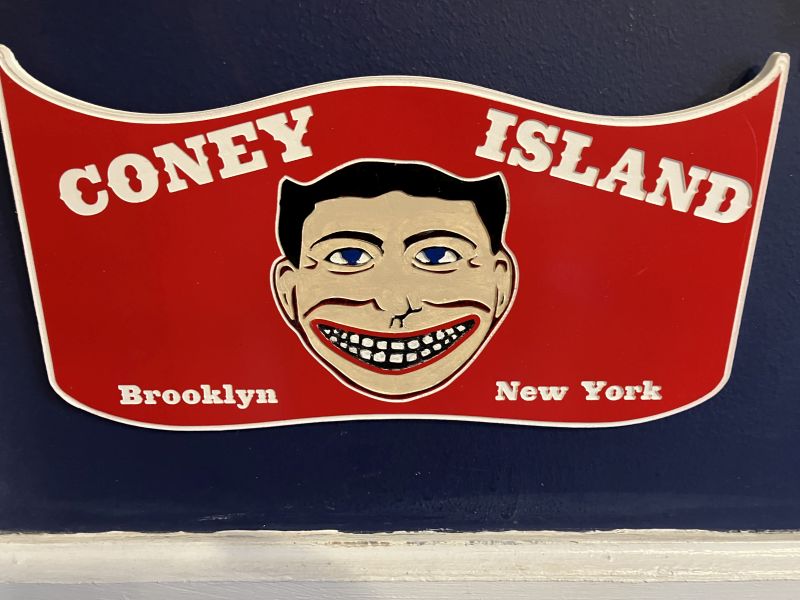

I use this 1mm bit for fine detail in PVC and acrylic. It’s cheap and works great. Amazon.com
This sign is only about 12 inches wide.
Thats really really nice !!
