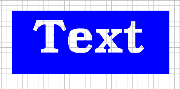

I’m also at a loss as to how to essentially invert the text area/background so that the text is left clear and the background ends up frosted with the drag bit. I tried a couple of boolean operations , none of which gave me what I wanted.
In a program such as Photoshop…really any image manipulation program, you can take a basic drawing and use CONTROL+I to invert a black and white image.
This is a graphic design/illustration problem known as “figure-ground reversal” — usually offsetting to add a surround, drawing in a surround, or deleting surrounding geometry is necessary:
if you’re still stuck, upload your file and we will look into it with you.
I’m not sure I grasp what I need to do from these posts. Forgive me. At the moment it’s a simple test, just a some text on an area 100mm * 75mm
where the white lettering is untouched and the background is ‘cut’ with a drag bit.
I’ve seen your videos, so I’d guess you’d know if this is likely to result in something better than just basic edge lighting?
Do you have a vector original?
No I’m just using CC to add the text to a blank canvas. The shaded part was just to show what the end result should be like.
Carbide Create should work well for that, try the “Engraving” toolpath if you have Carbide Create Pro.
For an alternative/work-around see:
if you’re still stuck, upload the file you are working on.
Got it thanks. No idea why I couldn’t just get it in the first place.
