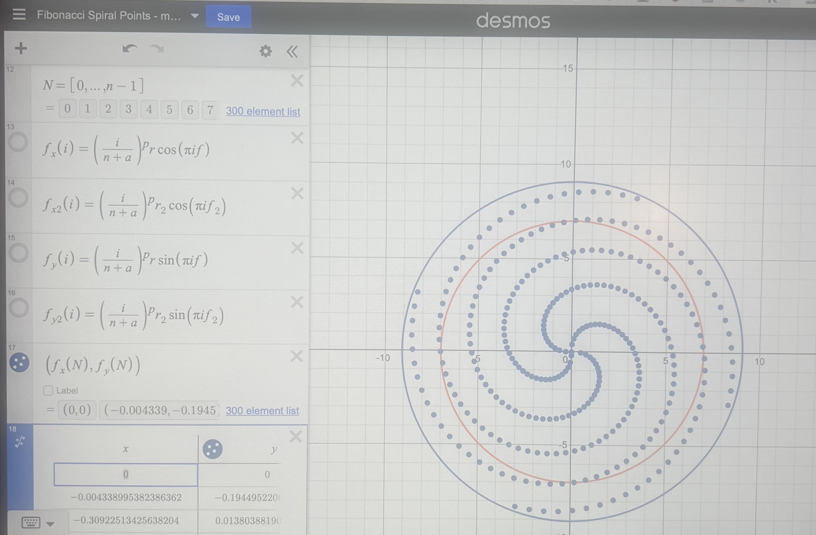

Not terribly exciting, just interesting patterns for carving and surfacing.
I’ve used desmos for things like this in the past but it’s a painful workflow
V-carve those spirals into a brass coin and drop a gem in the middle. Eh, could be cool. (I’m a bit of a one trick pony, don’t judge me :yum:)
