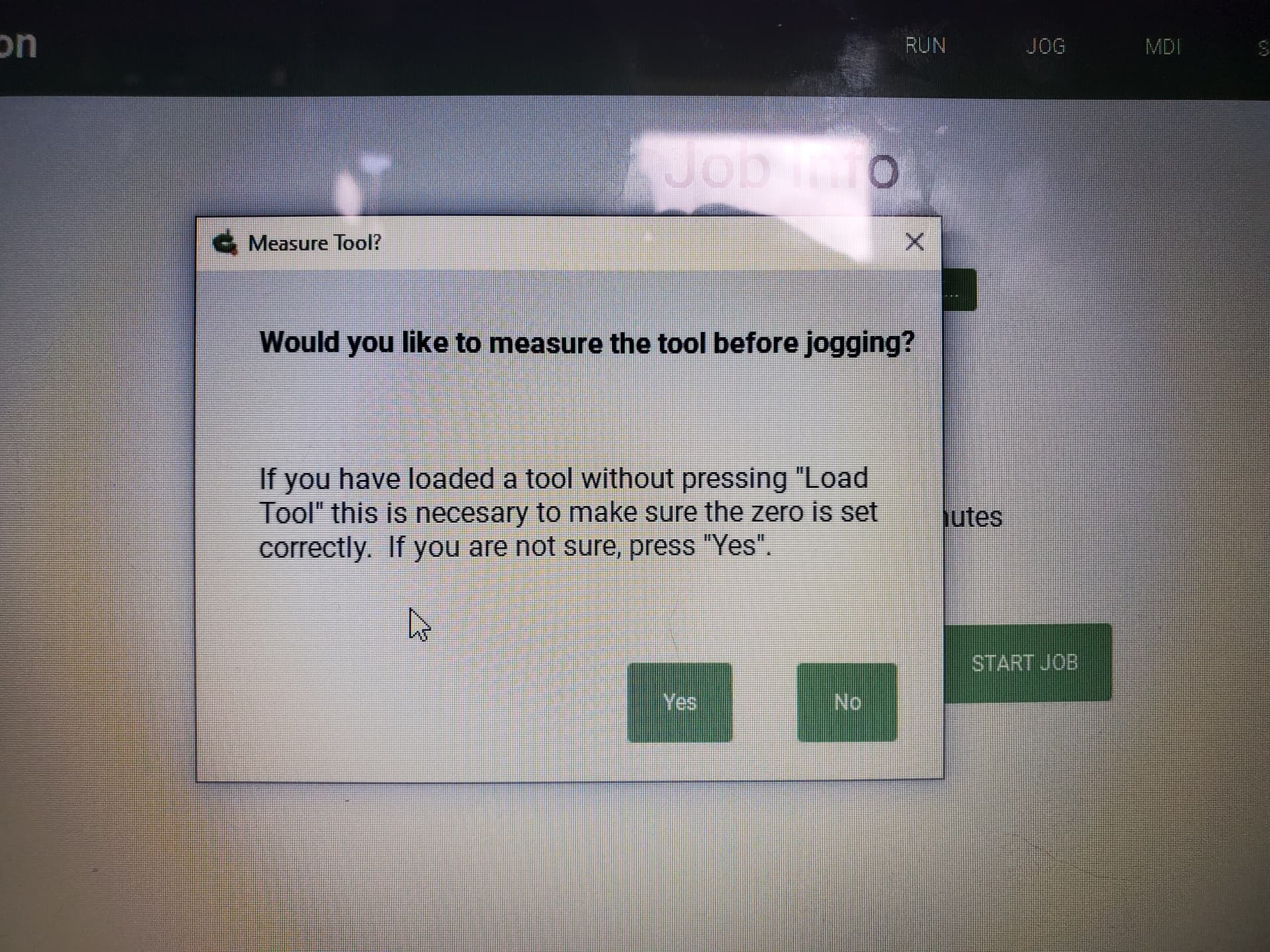

I recently updated my Carbide Motion to the 642 build. the machine is now popping up new windows and not doing what I am used to. Before, I would find my 0,0,0 point, install the program for cutting. It would go to the Bitsetter, and get the depth of the bit, then move to the front-center and request me to turn on the router and to what speed. After doing that it would begin cutting.
Now, it is giving me some “would I like to measure the tool before jogging” message. I have clicked (yes) and tried it again and clicked (no).
It doesn’t jog at all it is still at the 0,0,0 point and telling me to turn on the router at the proper speed. I hesitate because the bit may be lightly touching the wood just a hair at that point. I don’t want to start spinning the bit and cause it to mark the wood.

With the new version you will need to acknowledge the prompts, and then you will gain control of the machine and be able to jog as desired.
For the endmill change, you will need to have a suitable post-processor selected in your CAM tool (for Carbide Create it’s “Carbide 3D Shapeoko”) and have a BitSetter installed, enabled, and configured.
You should be able to go back to 537 by uninstalling the new version, then reinstalling the older version from your Downloads folder.

But looking through the download / changes page of Carbide 3D, Version 541’s change was "- (NEW) Added option to check tool length when entering Jog mode when BitSetter is enabled."
So what I am seeing, in this new version 542, I don’t think it is a bug, but the new programing of the software. I think it is doing what it is programed to do, but that is my question, it is asking me questions I don’t understand, and when I have a bit change, (before - it would move up on the Z axis a few inches and move the gantry forward so I could make the bit change.)
Now when it gets done cutting with one bit and needs a bit change, the Z axis comes out of the wood about a half inch and the gantry doesn’t come forward. It doesn’t leave enough room to pull a bit out of the collet and insert a new bit.

Correct. 541 added some new prompts.
They are listed and discussed at:
Basically, when there’s a chance the tool has been changed the program asks if you’re not sure if you need to remeasure and affords an option to do so.
Well, I deleted Carbide Motion from my computer and re-downloaded it, and re-installed it. I initialized the machine, it used the BitSetter and measured the bit. I get this pop up window.
So my question still remains, what is the correct answer for this pop-up window?
If you’ve changed the tool w/o using the “Load Tool” button, click “Yes” to remeasure the tool.
If you haven’t, click “No”.

What are you using as a post-processor in Carbide Create under Edit | Select Post Processor?
It should be “Carbide 3D Shapeoko”.

And checking Carbide Create it was set to ‘basic G-code’. I have no idea why this changed. I haven’t made any changes or updates to Carbide Create.
