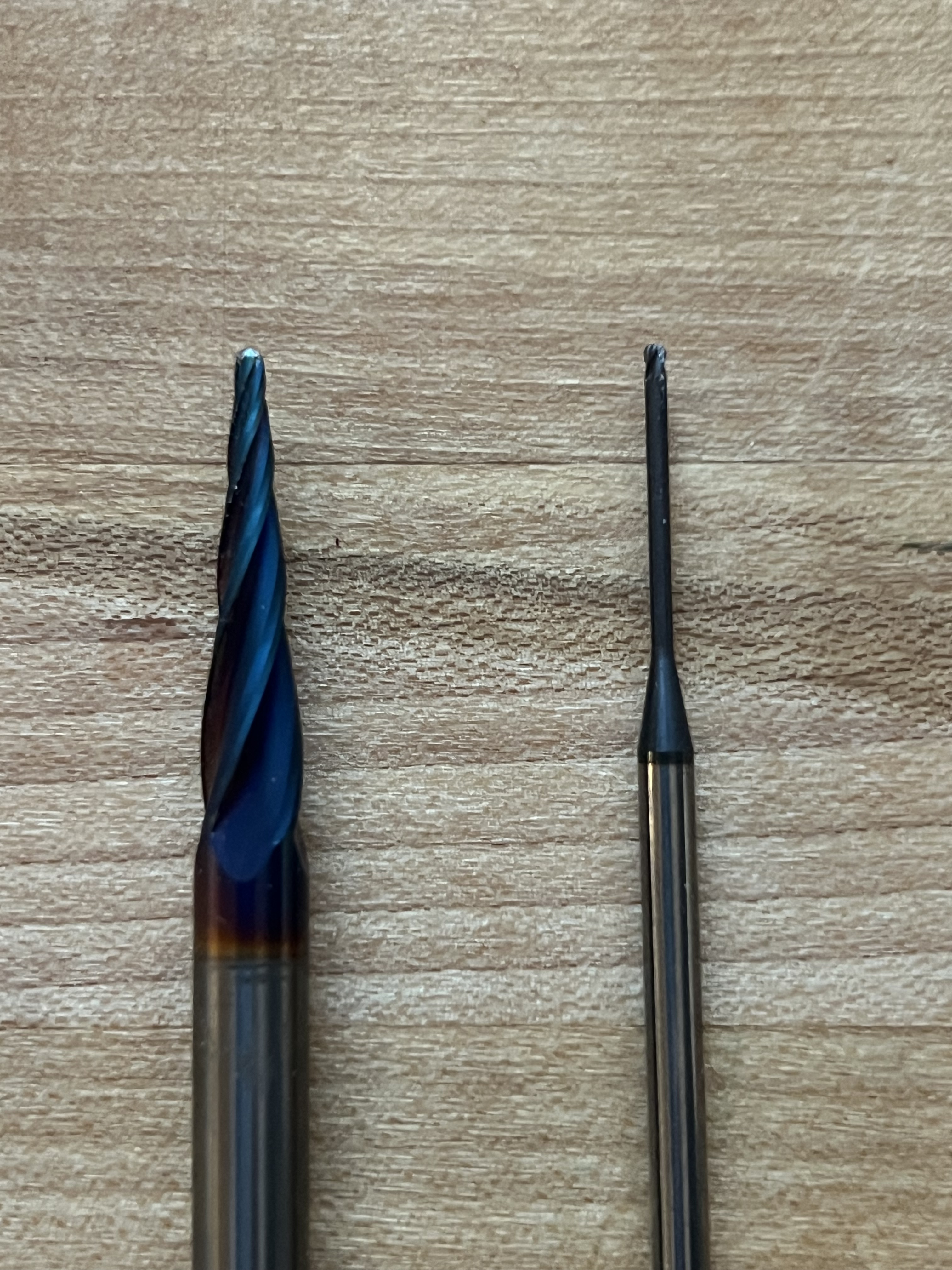

A note on ball nose tools, if your design allows for it, you should prefer the tapered ball nose tools. They are going to be much stronger and are just generally more useful in my opinion.
A photo to show the extremes of my ball nose tooling comment. Similar size effective cutting radius on the ball…can you guess which one I prefer :sweat_smile:
Do you have to manually enter all the dimension info for the Amana bits into carbide create, I’m definitely going to buy the left one, but I’m away from the machine and I’m pretty sure that’s not already ā€˜in the bits’.
The ones which we sell are already in Carbide Create.
