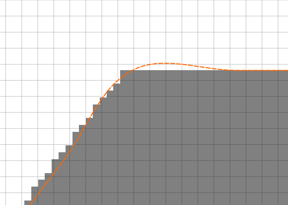

Is it just me or has the generated bounding box gotten as bad as the autotrace image. Like who thought it would be a good idea to take corners and then make them massive round blobs and nice smooth corner contours into wavey garbage?
Did you try changing the angle and other settings?
Could you upload the image, a screengrab of your settinga screen and the .c2d or a screengrab of the result?
It’s a proprietary image but here’s some closeups of non chamfered sharp angles one of which goes from an angle into a curved surface.
2nd one is straight left side curved right side
It’s not the end of the world and I can correct it myself (original problem was probably the standard resolution model? As when I swapped to HD and didn’t scale it down to its normal scale it didn’t happen as bad (that’s the ones pictured). So the question is does Carbide Create need to change the way it does scaling so that it is actually scaling up from the initial size instead of creating it at the initial size and applying a scale factor that scales down so when you are at your modeled size you lose resolution? Or just allow us to set scale initially before it’s generated? I’m not 100% on what causes it but something is done in a way that just sort of gets it done but probably not right. The same way that slot I gave you guys early on in this topic was scaled wrong but the rest of the model was right.
Also yes I did play with the settings quite a bit to see if anything would come out right and the larger the starting scale the more accurate it was which makes no sense unless CC is creating a tessellated image itself to convert it to a Raster pattern for tracing?

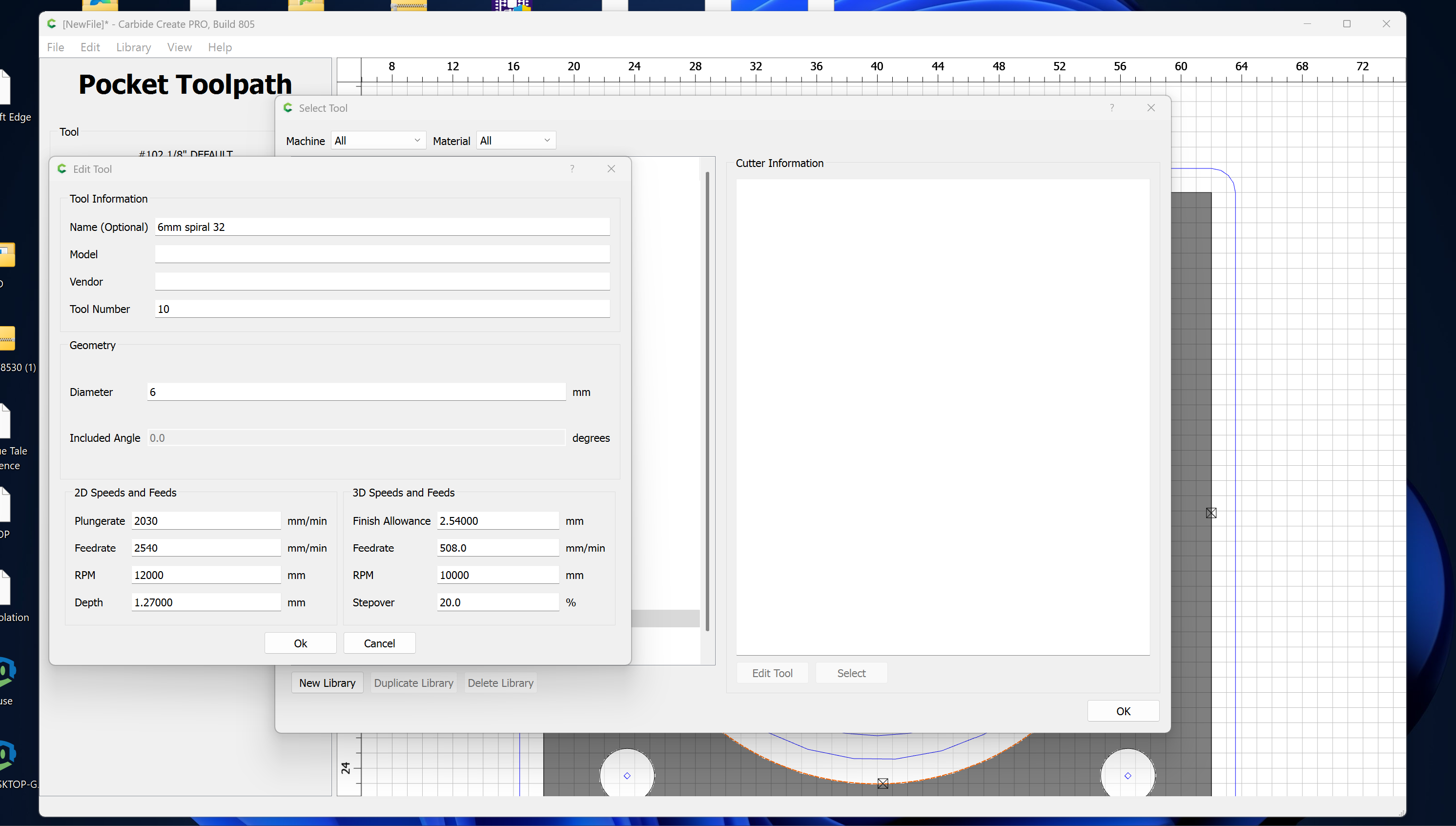

Cannot create new tool
version 805
sit will not save without Degrees ?
win 11 24
End Mill & Ball Mill have the Included Angle greyed out. It’s not relevant to those tool types.
Vee Bits & Engravers allow an Included Angle.
You will need to change the decimal separator to a period (.) in order to enter such tooling (or bypass Carbide Create and just directly edit the underlying .csv).

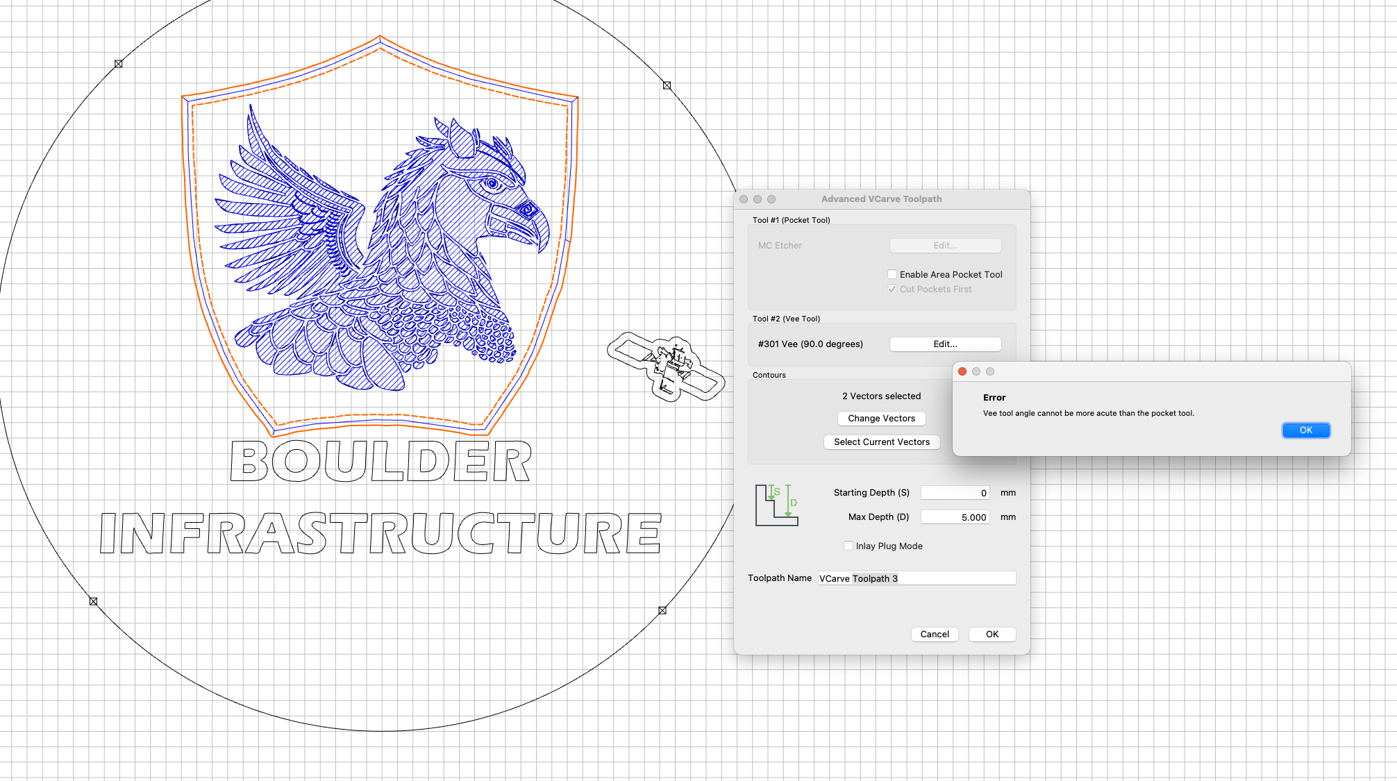

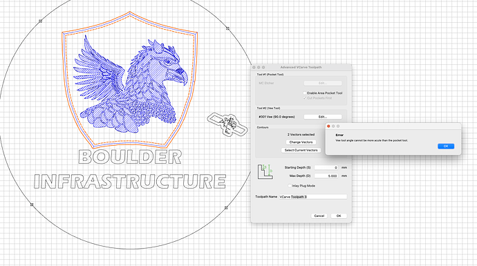

Just ran into a minor bug when trying to create a Vcarve toolpath in the 805 build. Since my previous toolpath was using the MC Etcher, the Pocketing portion of the VCarve toolpath generator was populated with the MC Etcher. Since the area I was planning to Vcarve was very small, there was no need to create a pocketing toolpath. Despite the ‘Enable Area Pocket Tool’ option not being selected, it wouldn’t let me create the toolpath and would throw an error.
Workaround: Enable the Area Pocket Tool option > Select a regular endmill to use for the pocket > Disable the Area Pocket Tool option
Not a big deal, but figured I’d pass it along.

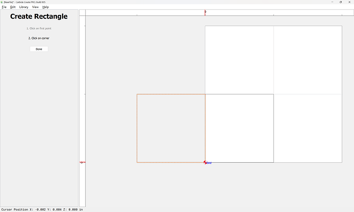

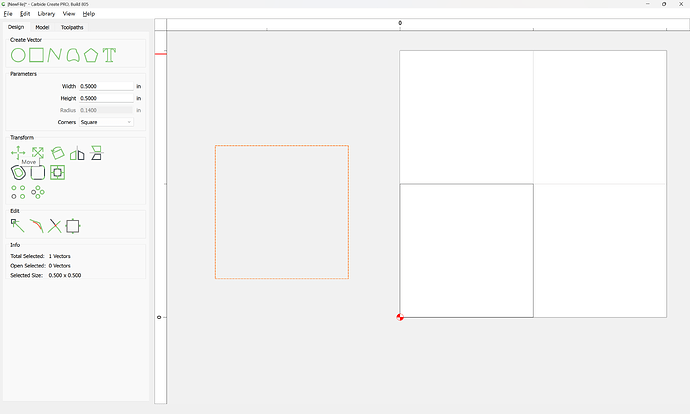

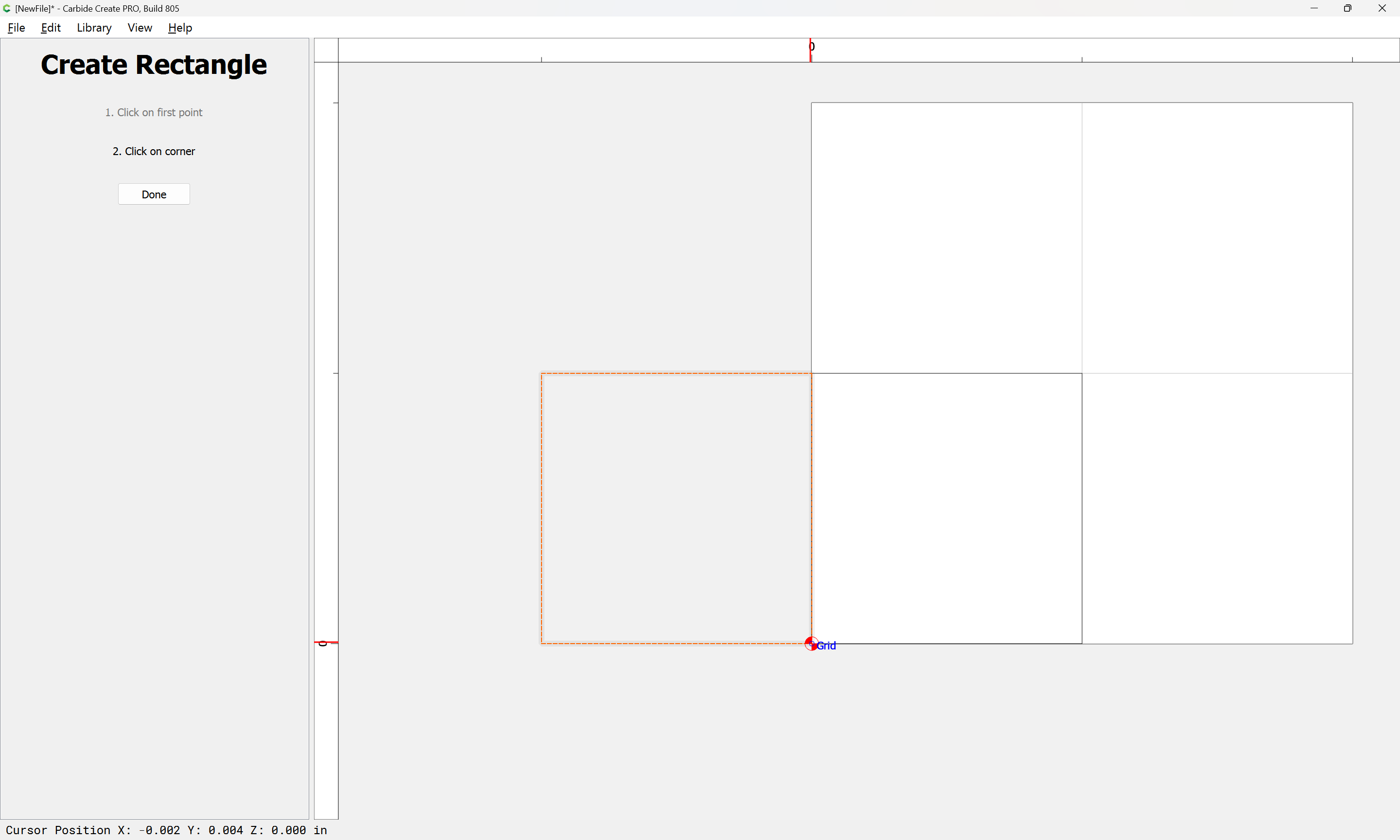

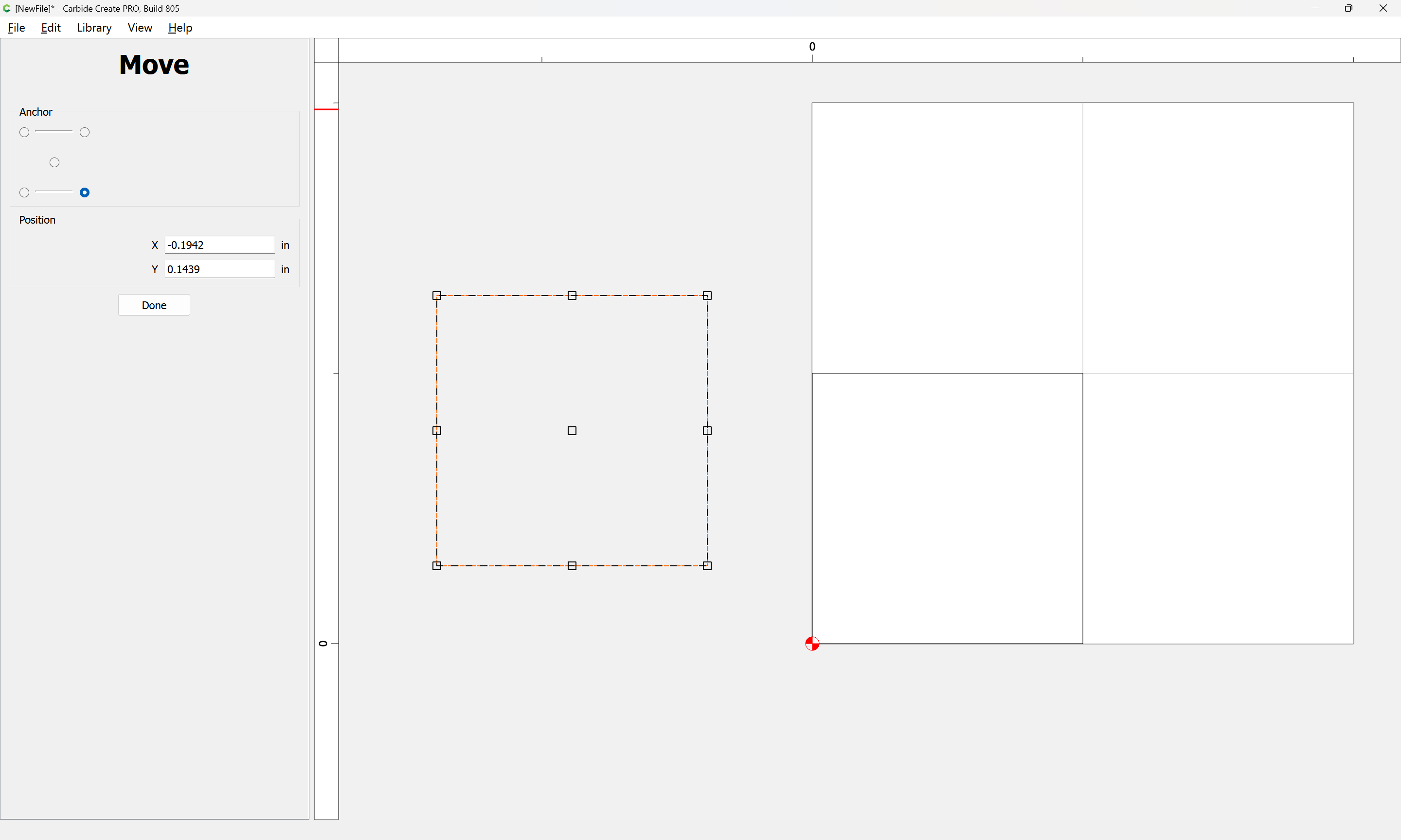

I wanted to create a box in both corners. The first one snapped to grid (toggled on), but the second wouldn’t snap to the bottom right corner. I then tried the move button and chose the bottom right corner, setting both options to zero. It still wouldn’t move there, but wanted to align to bottom left corner. Not sure if that is a glitch in v8.
Do you have “Snap to Grid” turned on?
I get a grid snap at the origin:

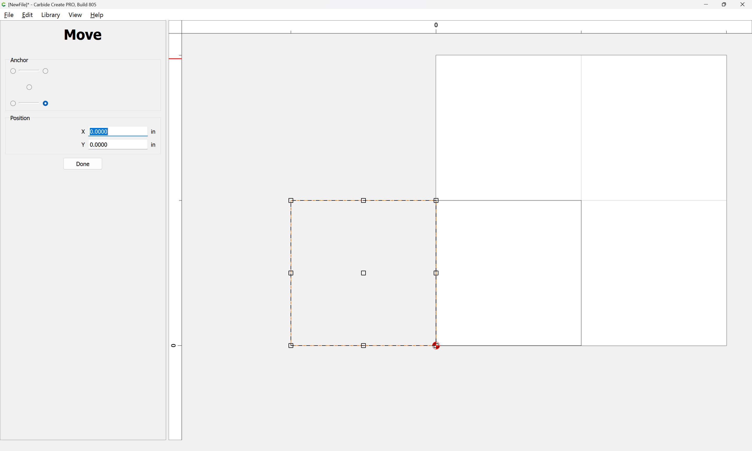

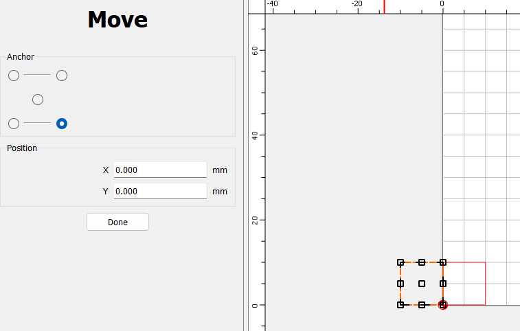

That movement:
is what is expected based on my understanding of the selection of the bottom right corner as Anchor and putting it at 0,0 — why would one expect something else?
