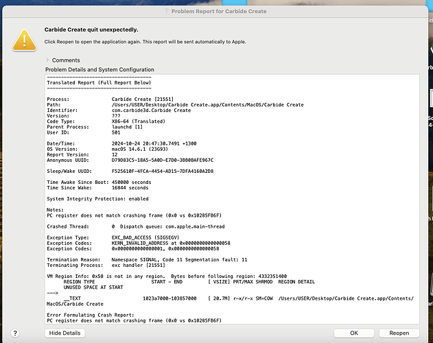

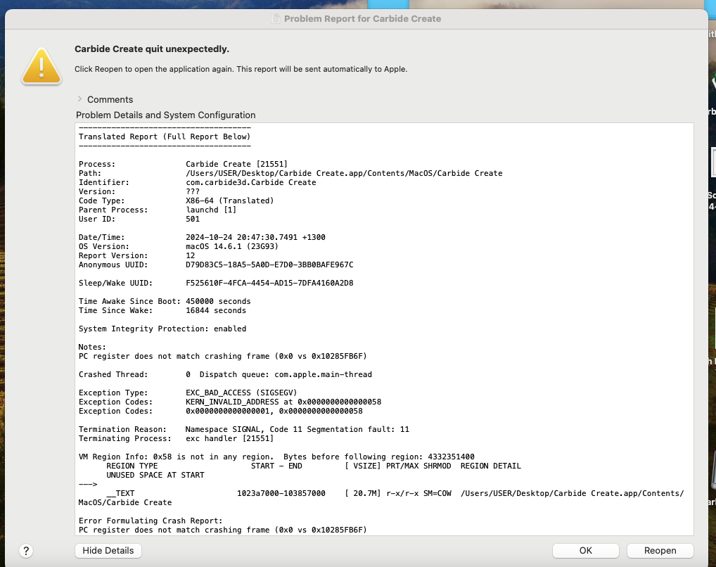

Hi my 805 crashed overnight here is the report

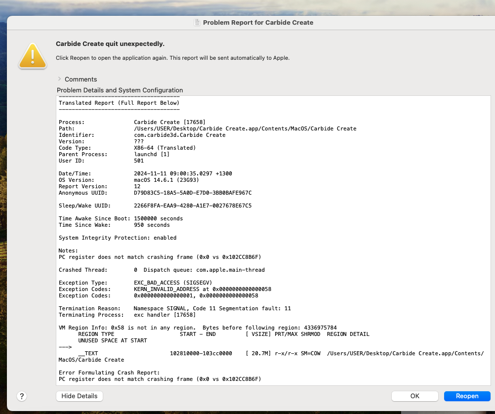

805 just quit again for me

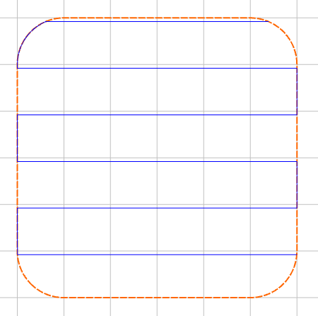

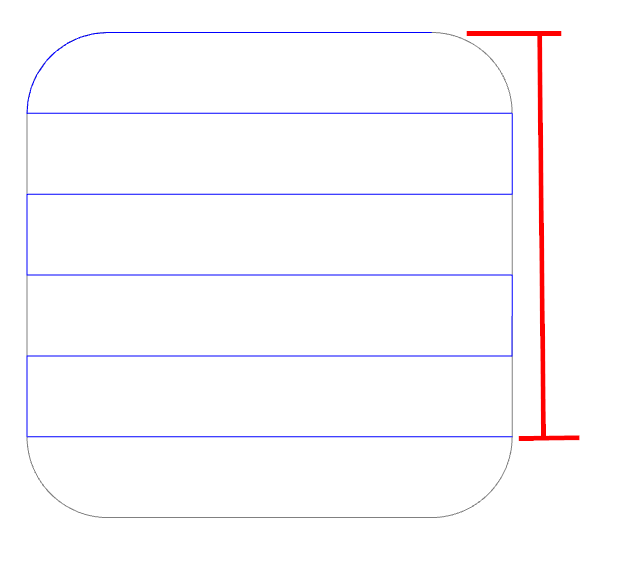

Facing Toolpath.
Stepovers occur right on the boundary. Cutting passes are offset inside the boundary, and not evenly???
After we have reported bugs to Carbide support, is there a way to see some kind of roadmap or plan for fixing the bugs? We know plans change, just would be nice to know how that reported bug was prioritized.
We don’t have any public bug tracking.
What kind of stepover was the bit set for in your test setup?
I just tried with a couple different sizes of endmill & stepover values & the toolpath seems to start the first pass 1mm less than the stepover value from the lower edge. Then subsequent passes use the actual stepover value until the last.

  • Facing and 3D roughing toolpaths now center the raster passes within the area to machine.

Passes are more evenly spaced, but the last pass is missing when it’s an exact factor
