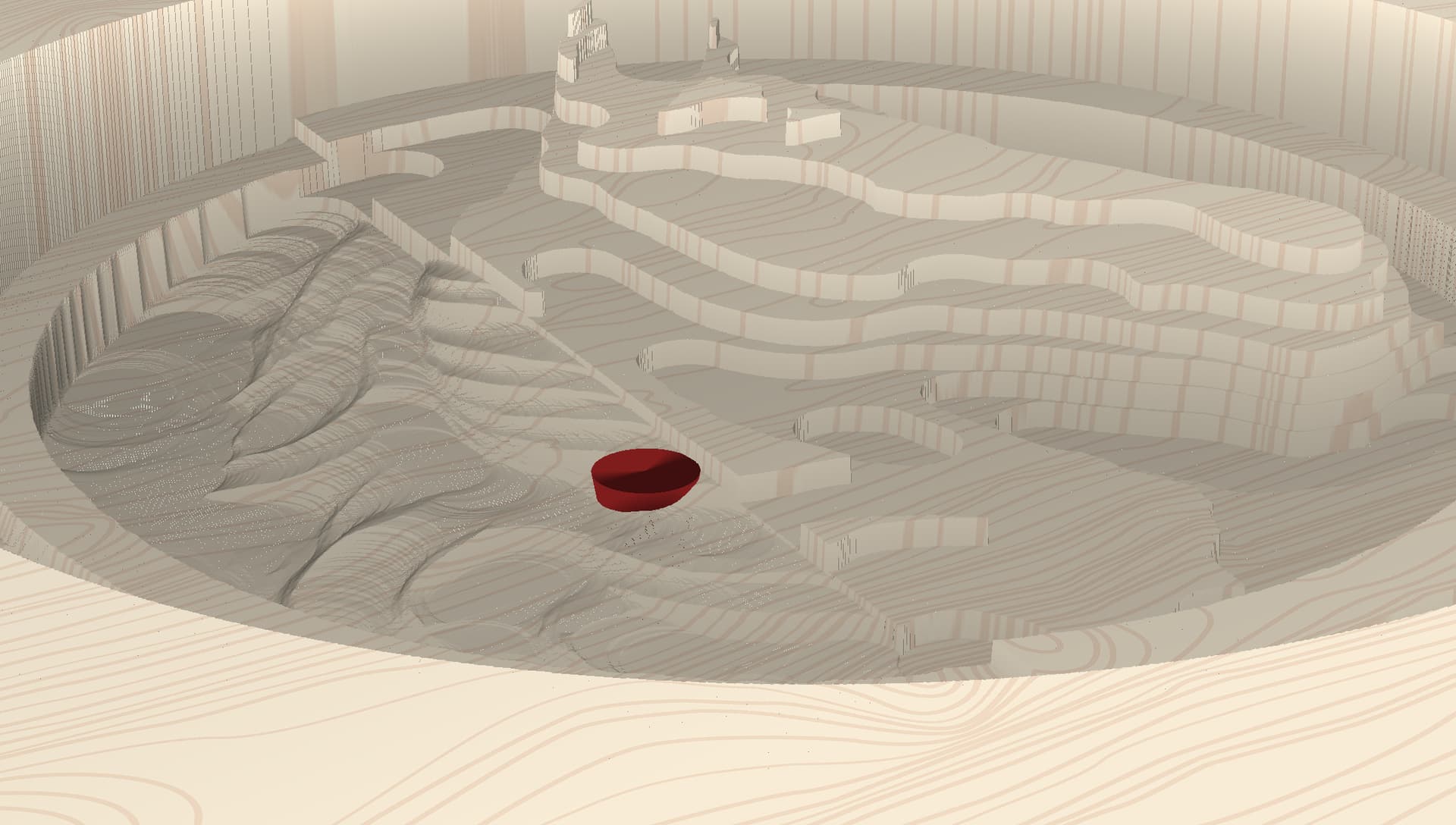

With all the recent changes, I was curious how CC handles utilizing a V-bit with 3D finishing - so I tried it. Guess it’s not really supported, but it makes for an interesting simulation result.
Seems to place the point of the bit somewhere below the model - using the non-cone shaped part as the end of the bit? Would this then generate G-code which would cut way below the intended surface? I may have to try just to see what it does. Bug or just unintentional consequences of not supporting V-bits in the 3D Toolpath generator?
Send over the file and we’ll take a look.
Looking at your file (sent privately) I suspect it has to do with the way the tool was defined and there’s probably a bug too. We’ll dig into it.
EDIT- We found the problem- it’s definitely the V bit not being handled correctly in 3D. We should be able to get the working relatively quickly.
That would be really awesome… Cause then a Taper Ball Mill could be setup as a pseudo-Vbit & the simulation could give quite close representation!
Another thing I had noticed while watching the tool simulator in that project file was the behavior of the 3D Roughing toolpaths - and is something I’ve noticed before while running other projects.
When the roughing gets down to just the outer ring, it’ll make in/out edge paths which clear out all the material between. But then it makes a raster path within the ring as if it somehow could have missed some material. Some layers it reverses the order of the rim/raster paths.
Anyway, I just wondered if you guys had ever looked at refining how the algorithm works cause it can add significant time to the roughing operation. Is there any way it could refine itself by checking if a path function is actually removing any material?
