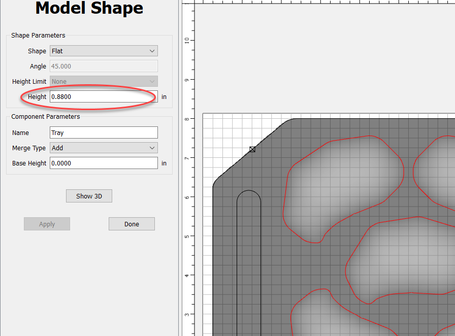

I recently built a 3D model within CC (Build 805). It’s an oyster serving tray where there are 12 3D pockets for the oysters themselves. I first made the tray itself as the first model shape. Then subtracted the oyster pockets. All worked great. However, and here is the question…
When adding the initial model shape, there is a “Height” value that can be provided. And, this can be added using the “t” variable. So, it goes and pulls the thickness value from the project settings. All great.
However, once you tab out of the field, it converts to a hard value as seen above. So, if you change the thickness in the settings, this value is now fixed and does not change. This seems to be a bug, not a feature. But I am wondering if there is a valid reason for doing this? If so, please explain. Otherwise, would be nice to have that variable remain a variable. If you forget to go in and adjust it, it does have bad consequences on the size and depth of the pocketed features.
It’s more of a design decision than bug or feature. Right now, the only entries that keep the depths as a symbolic value, rather than converting it to the current value, are machining depths. For the toolpaths, we did it more as a way to create “Toolpath templates,” which would allow you to reuse the same file using both the variables and layers to update the content.
We’d consider allowing it for model components, but it doesn’t seem like it would be as widely applicable as it is for the toolpath depths.
Thanks for the response, Rob. And I totally get your point. Just thought I would ask.

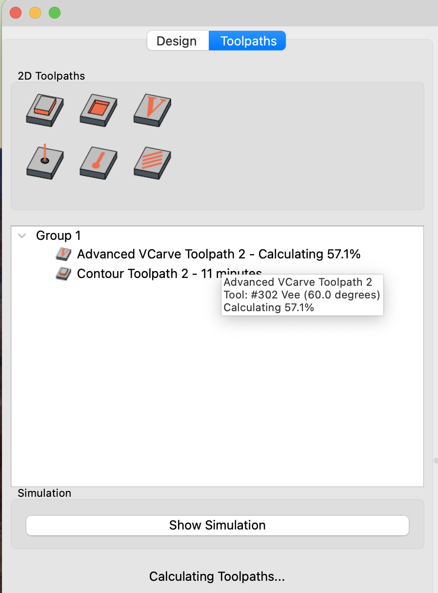

I think i have a legit V8 issue. Attaching a file that works fine in 778 but in 808 it never finishes calculating the vcarve path and if i wait long enough throws an out of memory error. I did some experimentation and and i scale down the art a lot it will work, but at the size is it in the attached file it does not. Let me know if i can provide any additional details
GabbyArt.c2d (552 KB)
I tried it in 809 and 810, and it was complete in seconds for me. I suspect that you’re on a computer with very limited memory.
Can you tell me how much memory your machine has? Or, if you’re on Windows and get a crash, can you be sure to send the BugSplat in so we can confirm?
Mac M4 Pro with 48GB of memory. Lol. Attaching screenshot of where it gets stuck.
Ok, 809 or 810 fixed. Was still on 808 as i hadn’t noticed the new versions. Thank you!

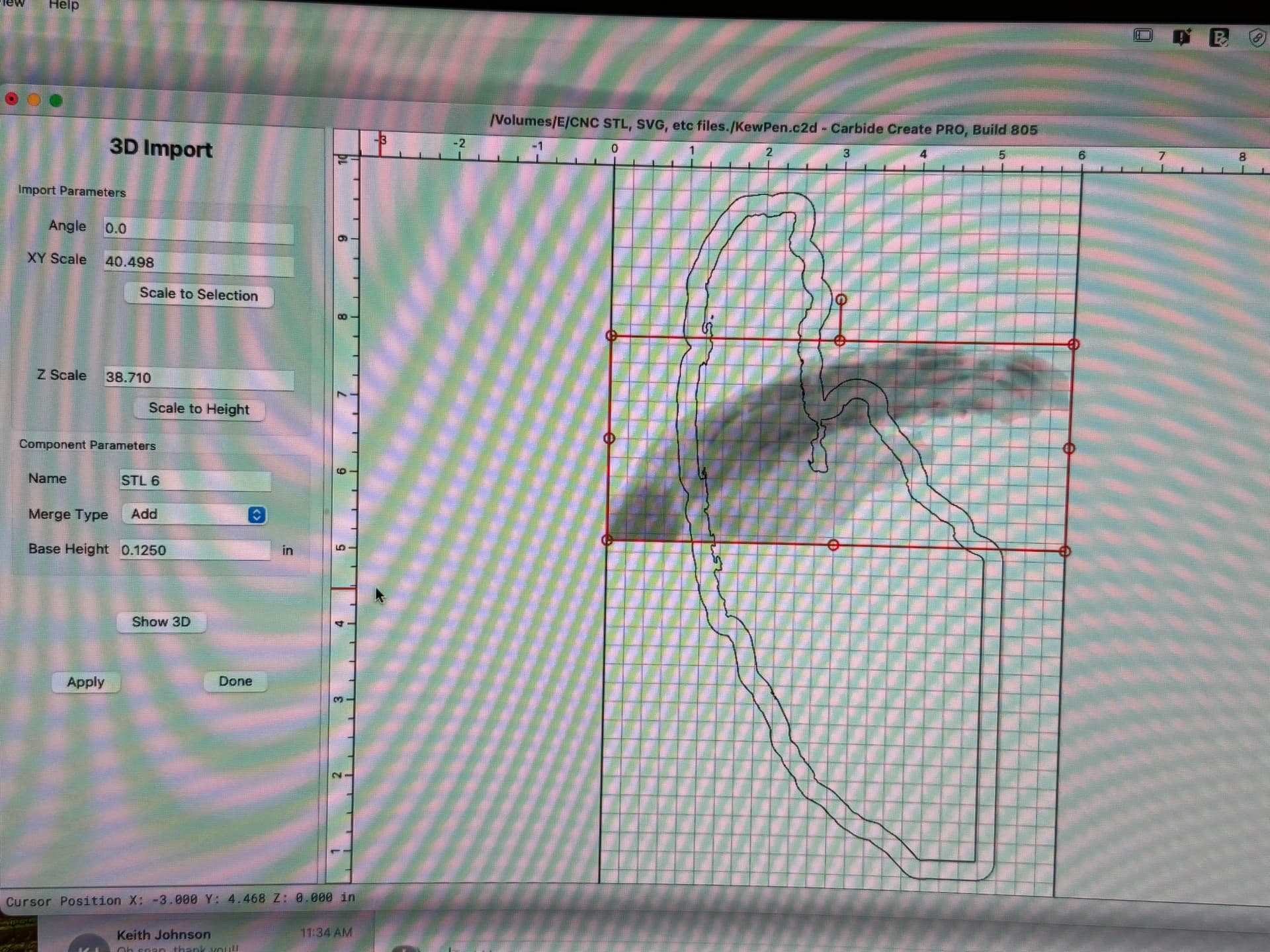

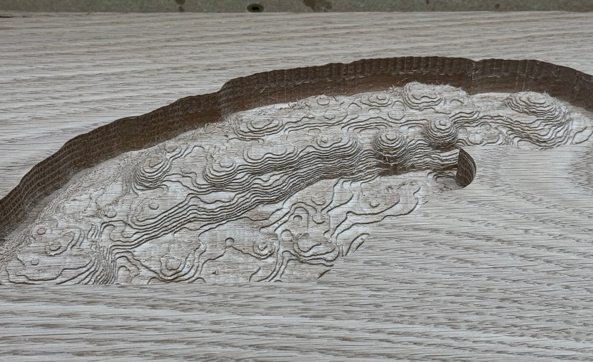

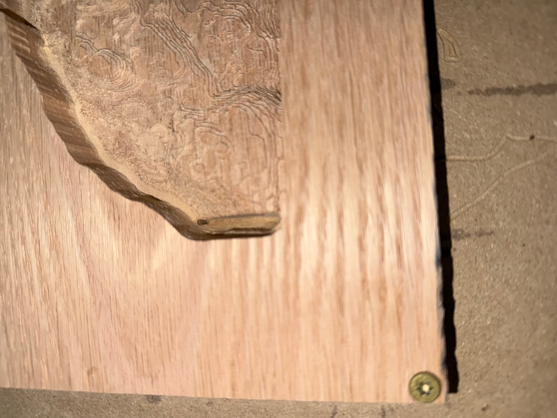

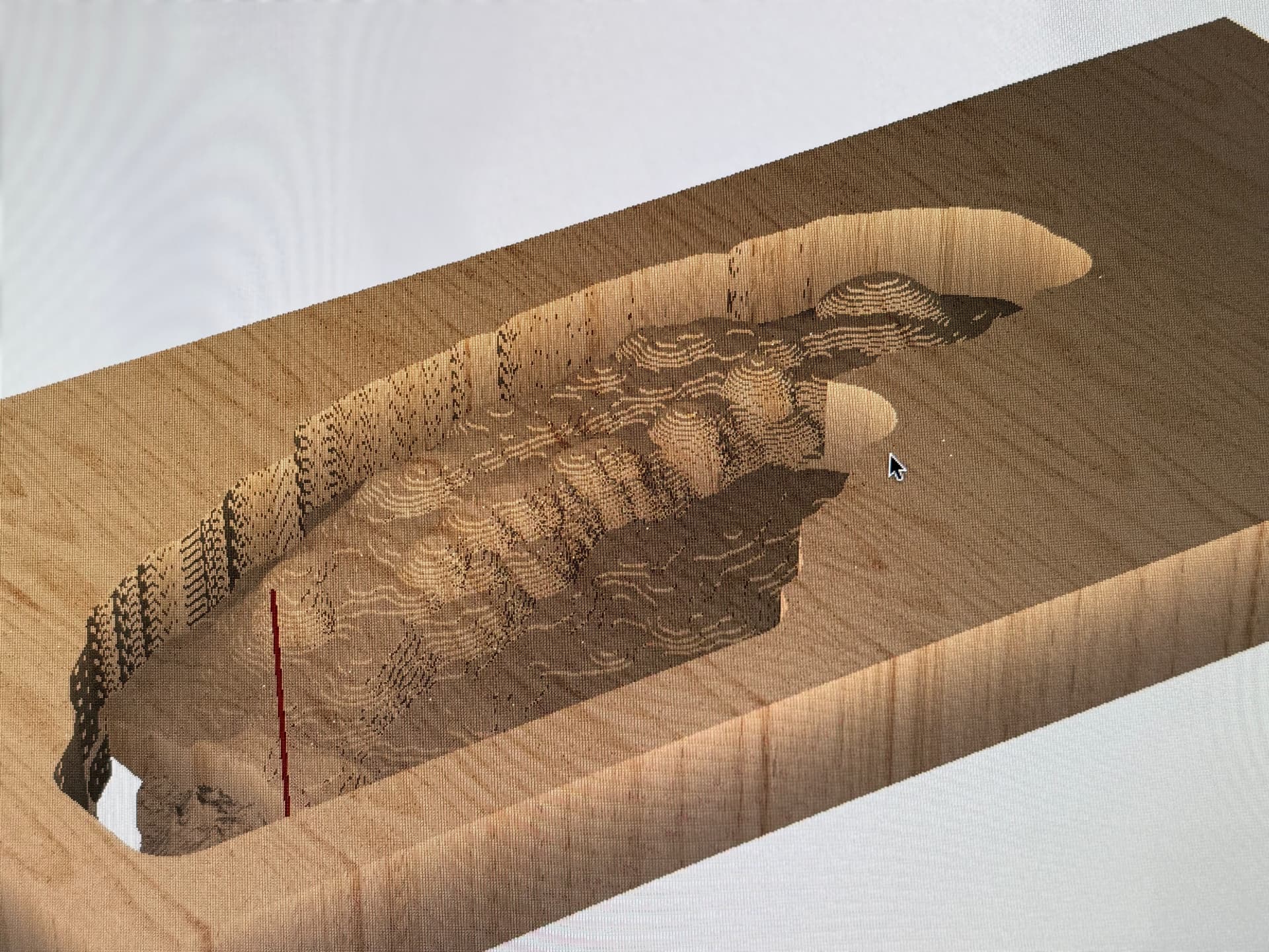

Hello, I recently downloaded V8 beta. I had some difficulty with it but due to the wonderful people in support I was able to resolve those. But now I am attempting to do a height map 3D carve and am having issues. With the design I have left a base thickness of 0.125", and also a 0.25" border around the outside of the main carve. I completed the rough carve with no issues. I used a 1/8" end mill. When I started the finish carve with a 1/32 taper, 10% stepover the bit plunged in and was carving through the full thickness of the wood and into the spoiler board. I stopped the carve. When I looked at the tool path simulation again, I did notice that the finish carve is cutting all of the way through and taking a lot of material with it. V7 I have not had this issue with other types of carves. This is my very first attempt at a height map carve and I am using V8. So I am not sure if I am doing something wrong, or is this a glitch that needs to be fixed in the beta version.

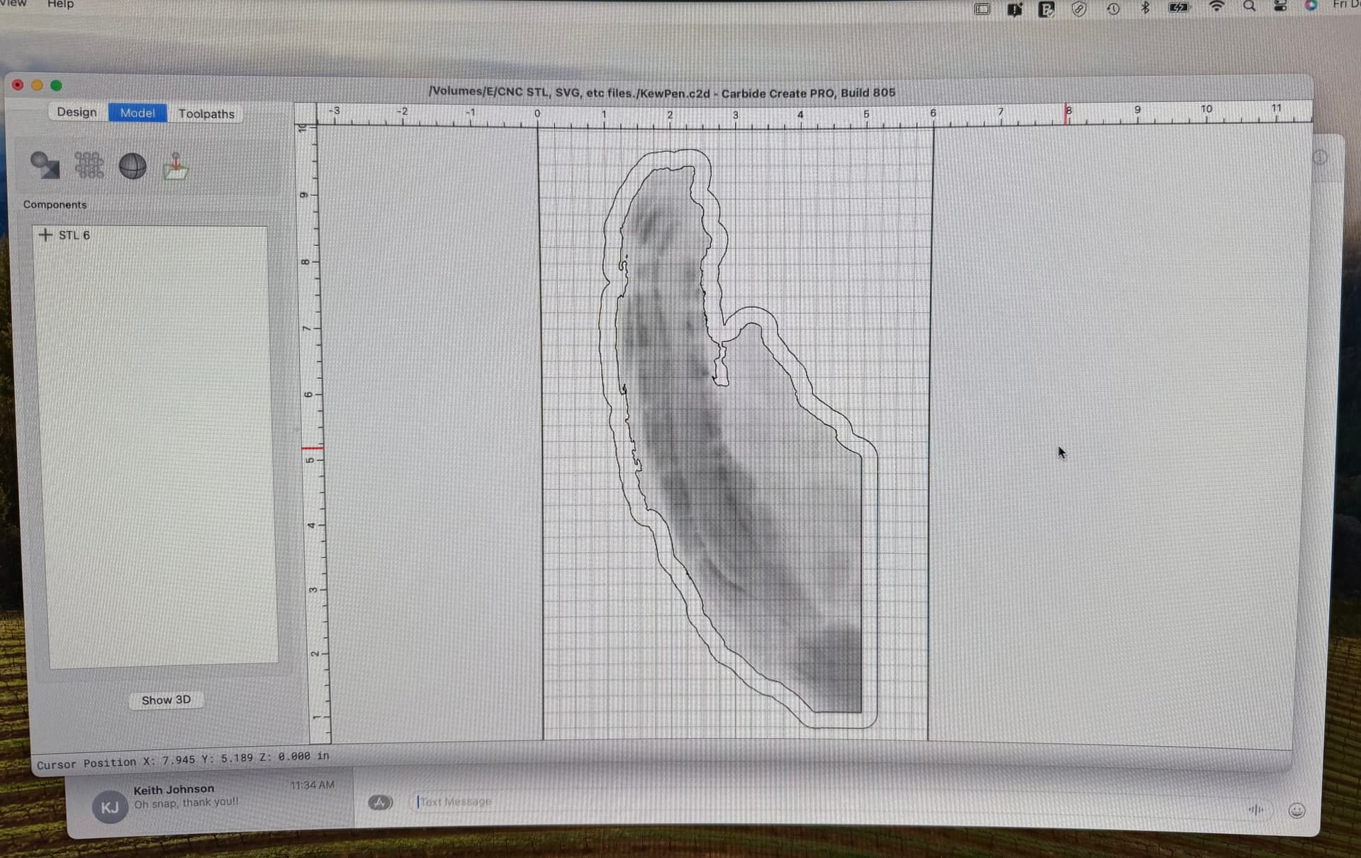

One other thing I noticed. If I go into the model section, and look at something under the +STL the screen will revert back to the position the grey scale model was originally placed before I rotated it. I have to click on the undo button to get it back in the position I want it in.
Need to create a base 3D component larger than your main carve area to keep the toolpath from ‘falling off a cliff’ at the edge of the carve. Doesn’t have to be very thick(0.001") just to give the toolpath a bottom limit.
