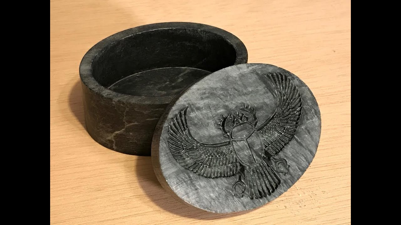

You mentioned soapstone earlier. I just happened across this video from @45rpm John Clark
Looks interesting and he did not use lubrication.
Soapstone is a very different animal. It’s basically highly compressed talc. It cuts like butter (Very dusty butter, which is probably not great for your lungs so dust collection is good). No water needed. It would be cool for chess pieces I think.

@45rpm any tips or tricks other than your video about soapstone I should be aware of? I assume no specialty bits needed with its softness?
It’s noted as being abrasive and dusty.

It was a mess on the old nomad I had. I wasn’t entirely prepared to introduce water into the mix. When I ran the first project I ended up using a pipette to drip water infront of the tool, hoping to minimize the water.
No special bits, but as Will said it’s very dusty and not at all lung friendly. Mask ++
It’s always good to do some small tests to see how fine the detail can get before it starts to crumble or chip. If I remember right, I also sliced mine on the band saw with no issues.
