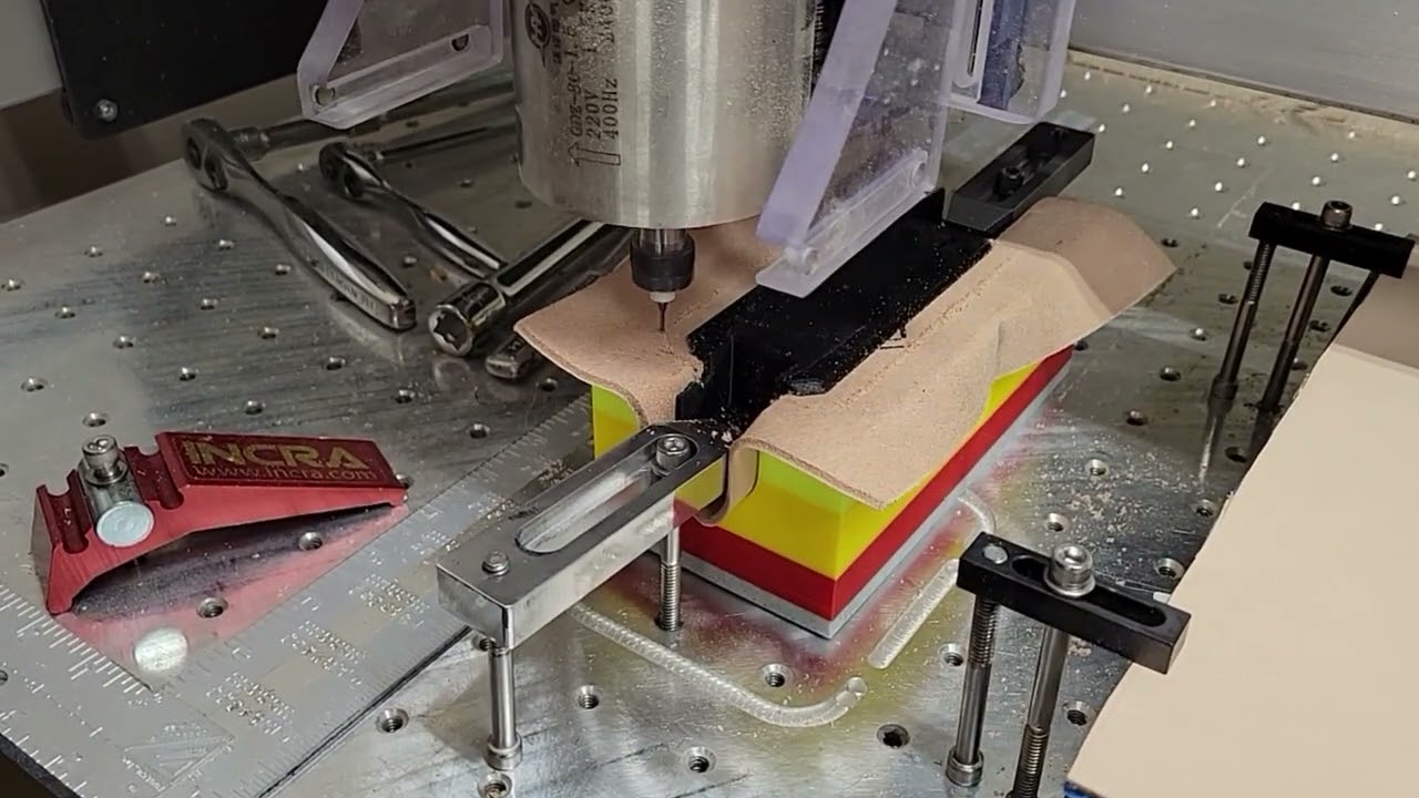

I made a leather holster for a flashlight.
When I get home I will see if I have any additional pictures or videos if you are interested.

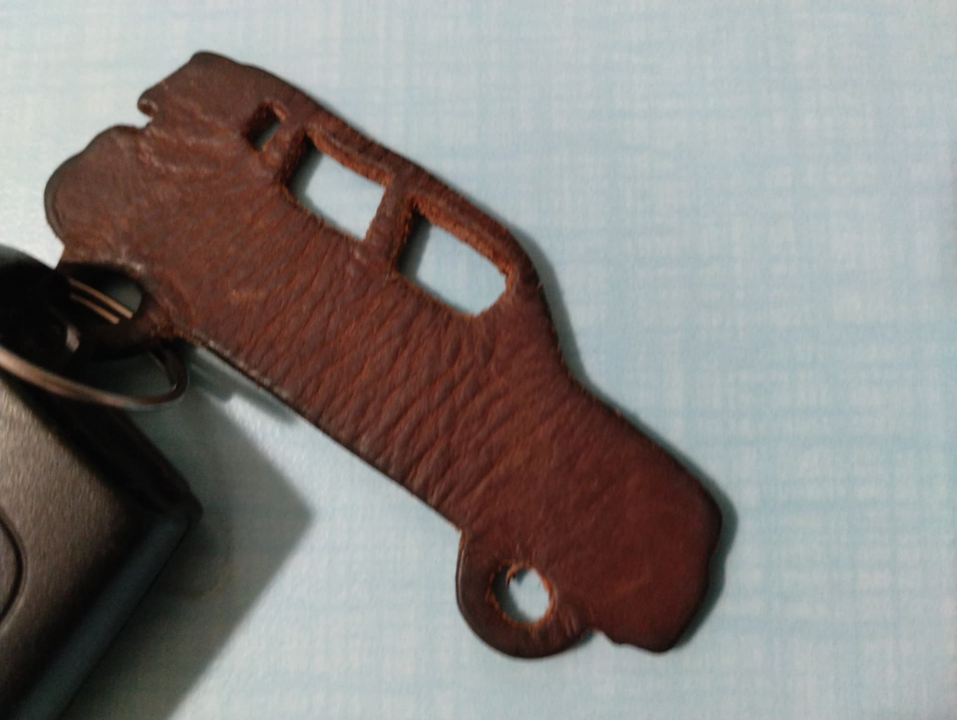

made this key hanger for my wife’s 2021 Jeep Renegade when she got it, she uses it relentlessly every day.

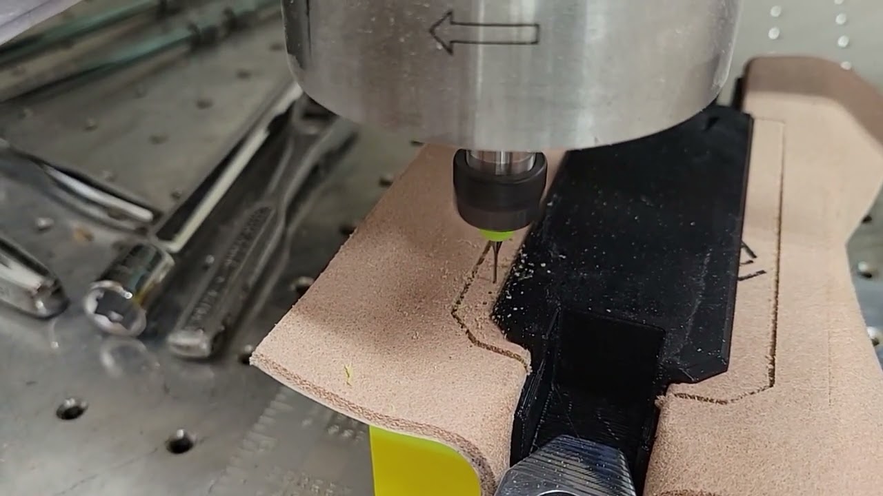

I used double sided tape, and a small diameter bit.
I do not like the charred laser cut edges.

Looks like I uploaded all of the videos I shot to Youtube already. :slight_smile: There were only two more. I guess, for me, the main issue I had was holding it down, and the tape and CA glue method worked great for me, and then using a down cut bit instead of a diamond rasp gave a better edge.
I would also leave a bit more room between the edge and the lacing holes so you can sand the edges flush after they are sewn together, because even if you drill the holes in both pieces, it’s difficult to get them perfectly aligned. I ended up using a couple of sewing needles to line them up to glue them together before sewing and ended up having to sand the two edges smooth before chamfering and burnishing the edges with Gum Tragacanth.

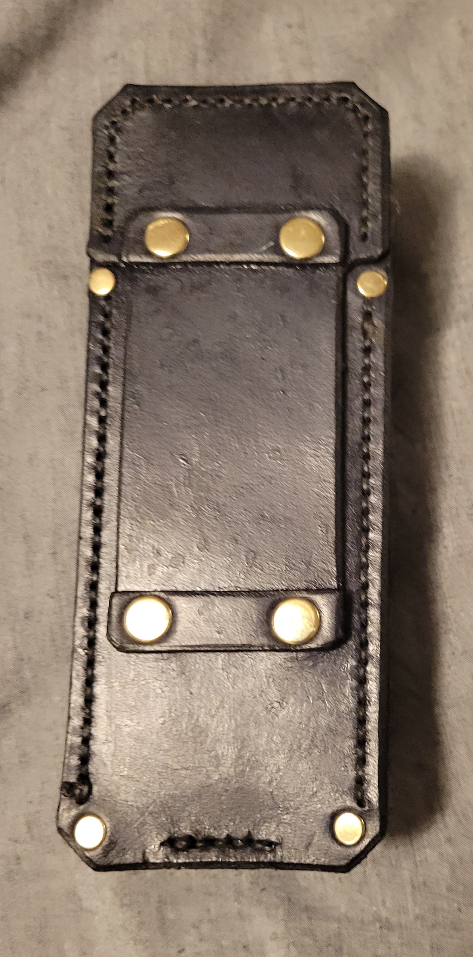

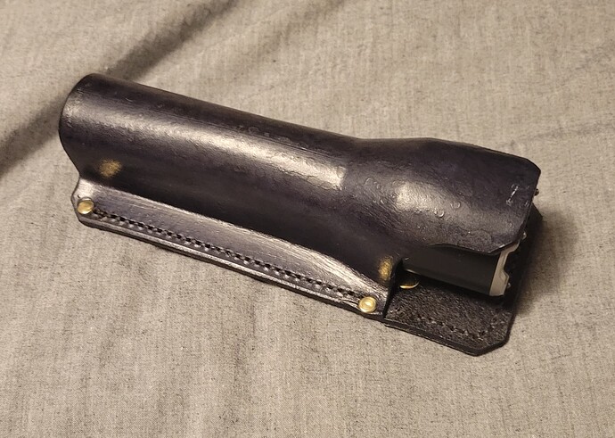

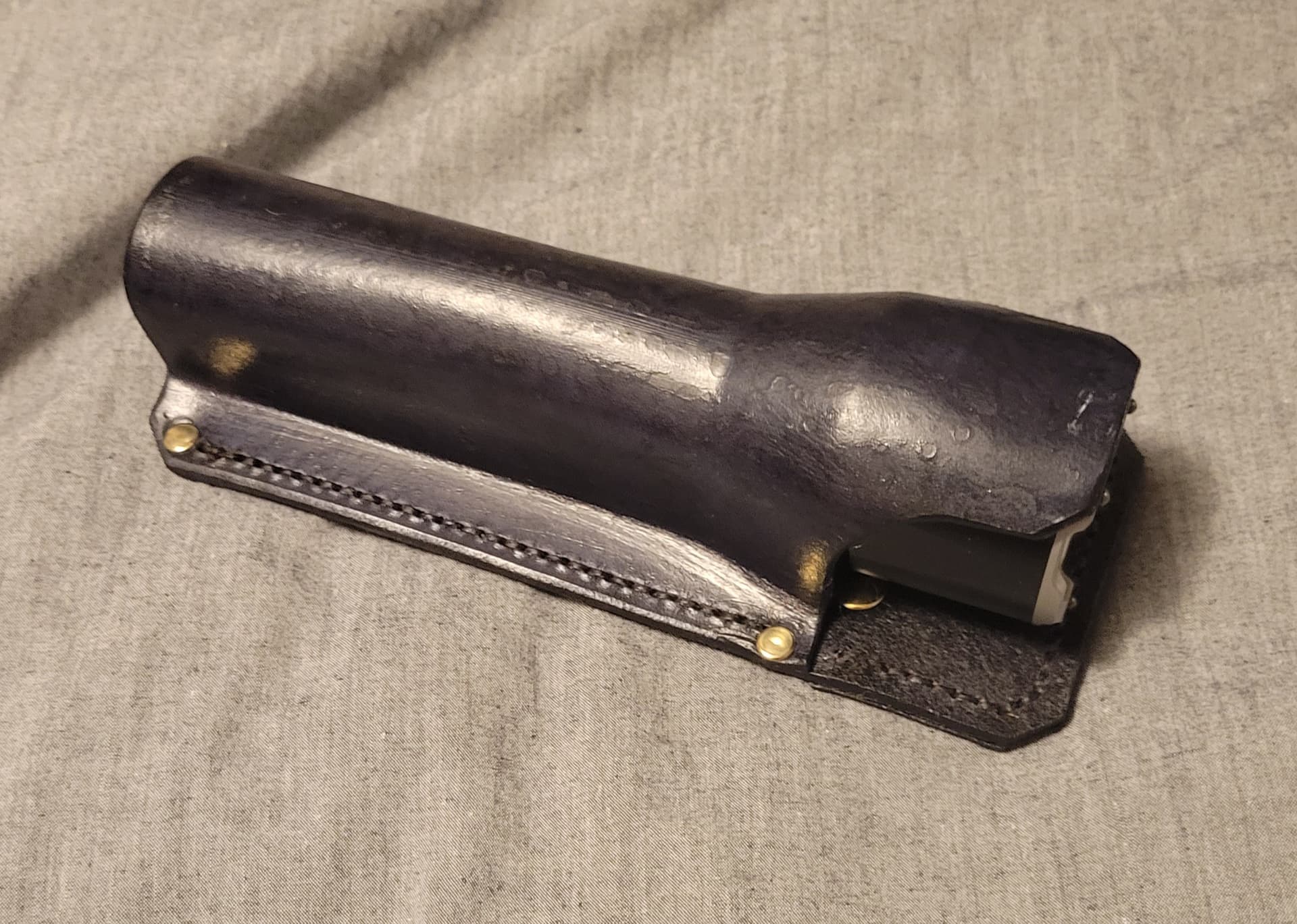

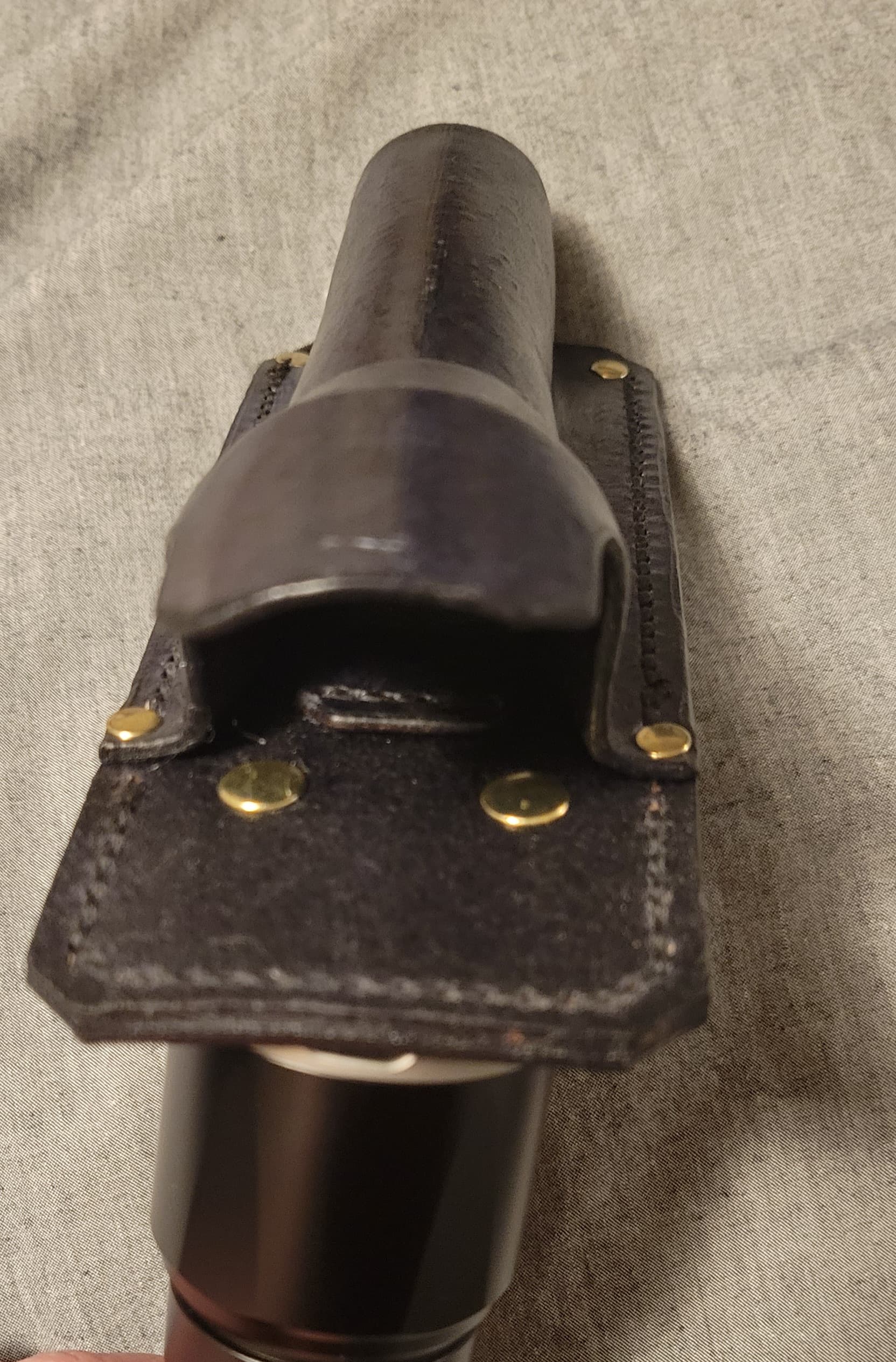

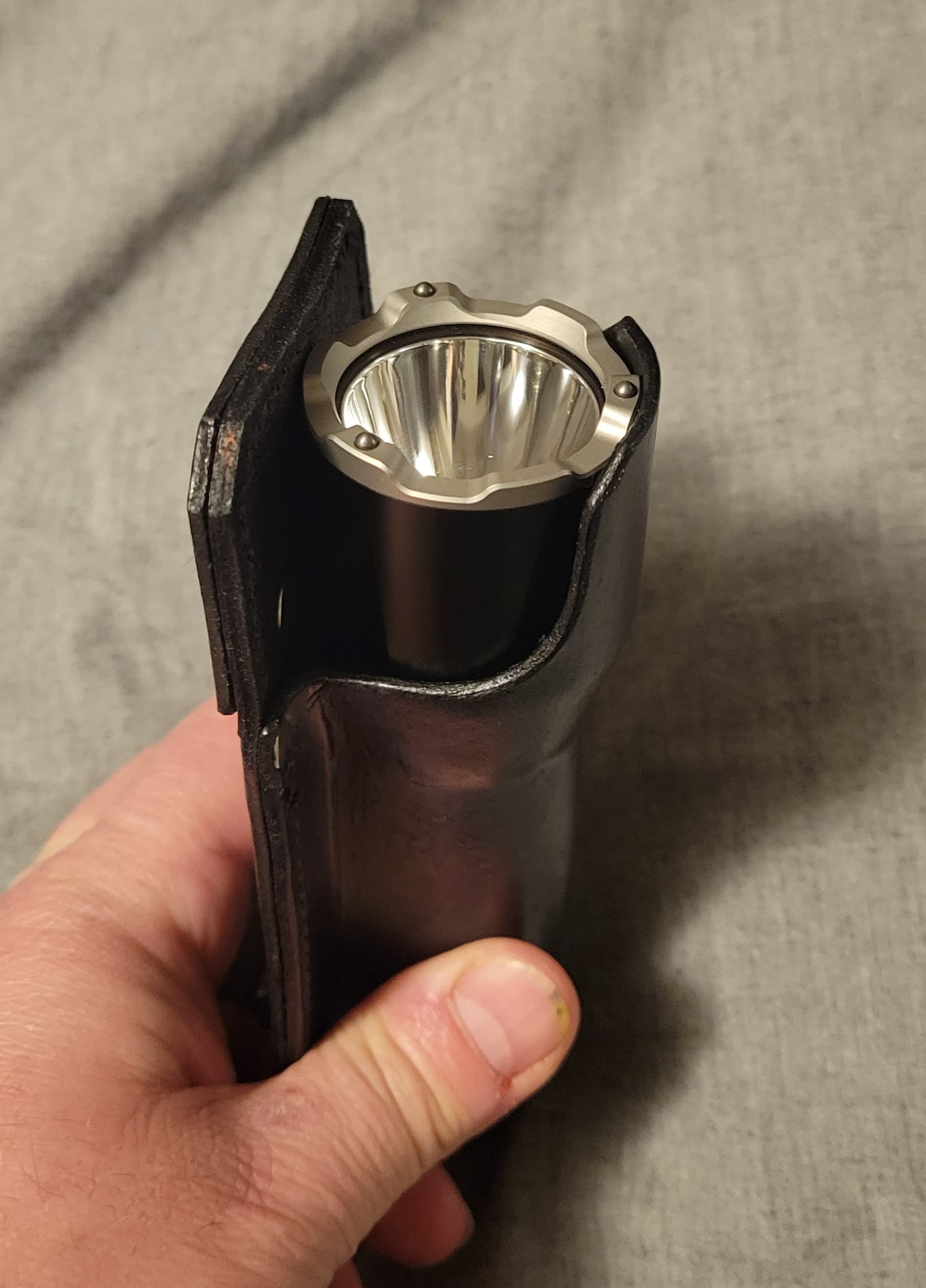

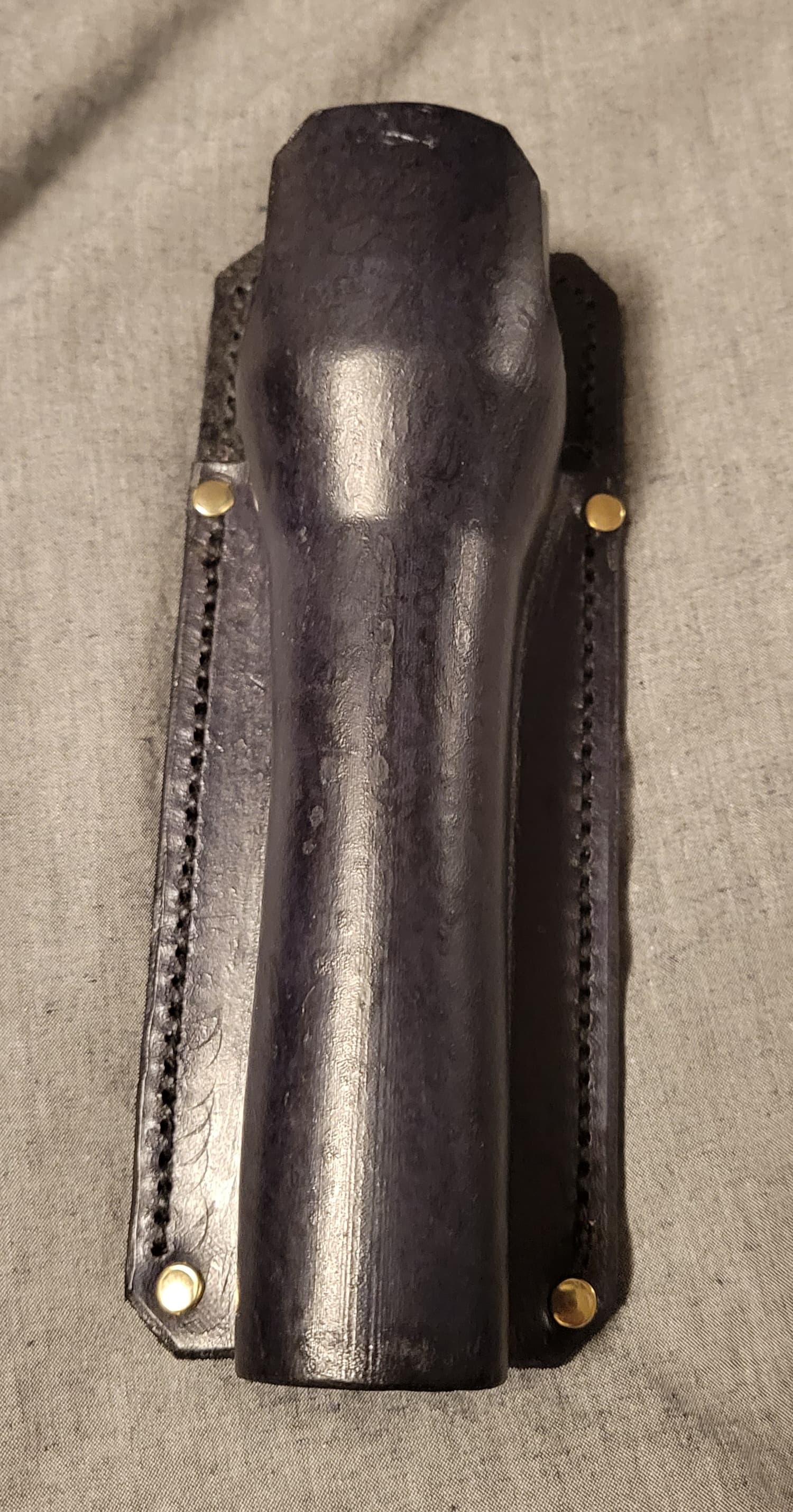

Okay, here are the pics of the completed flashlight holder. I made a big mistake with the application of the waterproofing though. Put it on and left it to soak in. That was a horrible mistake. Apply it in small areas and rub it in, then wipe off the excess immediately.
Thanks for posting the results, very nice looking flashlight holder for sure. The several times I have used leather waterproofing products it specifically stated to wipe on and rub in and then wipe off in small areas at a time. The rivets look clean with the stitching. Good job!
Thanks! Yeah, I watched videos on how to do the stitching and bought a nice stitching pony and a few different needle sizes and thread sizes / types and practices stitching on scrap pieces…
And when it came to the waterproofing, I was like “How hard could it be?”… :neutral_face: (sad trombone)
Anyway, as far as the overall build went, it came together just fine, was functionally exactly what I wanted, but ergonomically it failed for me.
The belt loop was too low on the holster. Because I am fat, the top edge of the holster dug into my side because it protruded so far above my belt. When I get around to making another one, I will move the belt loop as far up as I can.
It held the flashlight without any play, but the flashlight could be removed easily with thumb and pointer finger.
The guard on the outboard side of the flashlight head completely covered the head so that when I walked / bumped / turned into doors and door frames and other objects the metal head would not hit and Mar the surfaces.
The holster extended below the flashlight, preventing the tail cap buttons from being depressed, turning on the flashlight. That is a big issue with my current holster. When I sit down, I sometimes turn on the flashlight, and because my current flashlight has a strap over the lens, I don’t know it’s on until the Nylon strap gets hot enough to melt. Then I start smelling melted plastic and have to figure out where it is coming from. The first couple of times were very scary - suddenly smelling melting plastic. Now, that is the first thing I check.
Anyway, I still have plenty of everything to make another holster - except time. Oh well, maybe someday… :joy:
