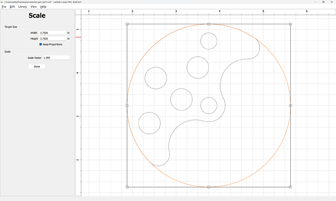

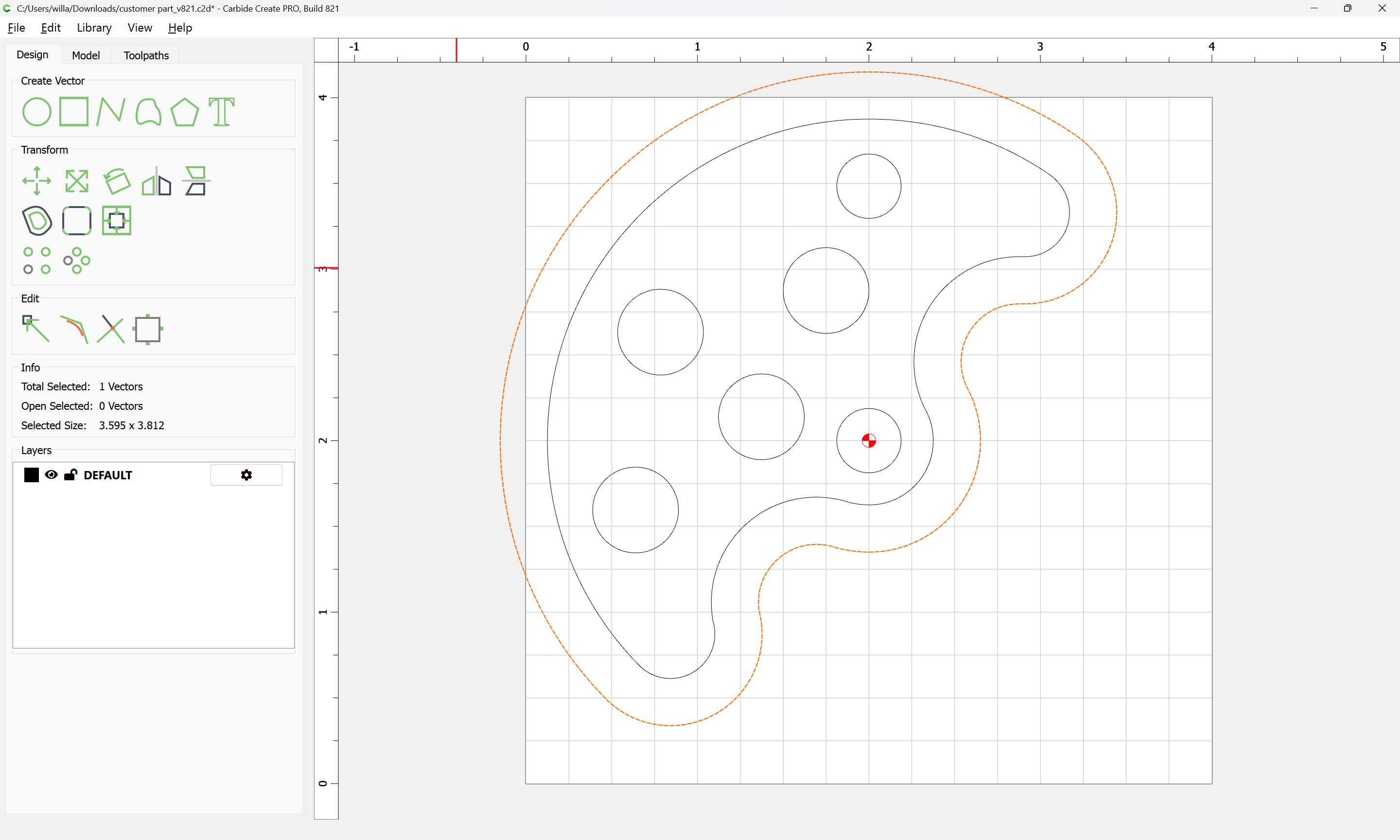

I’m trying to be careful here with copyright laws and all. I scanned that drawing from the plans. It’s on a 1/8” grid with the darker lines being at the 1” points. The diameter of the large outer circle is 3-¾”. My intent of those whole thing is to determine if a CNC fits into my workflow. My experience with the small pieces on these models can sometimes be difficult. They get more complicated when: 1) There are multiple copies of the same part and 2) These parts are connected by a dowel so they must all be exactly alike and in line. So my original query was to determine if the time taken to reproduce these parts in CAD, is worth it. Right now I can convince myself either way that I “need” a Shapeoko Pro. Certainly not for all the parts, but for ones similar to the sample that I sent. My model building goal is to make the moving parts line up perfectly and move smoothly. Thank you all for the responses you’ve provided. I will certainly look further into the Sketchup add-ons.
In that case, scaling to 0.5 should yield the desired result:

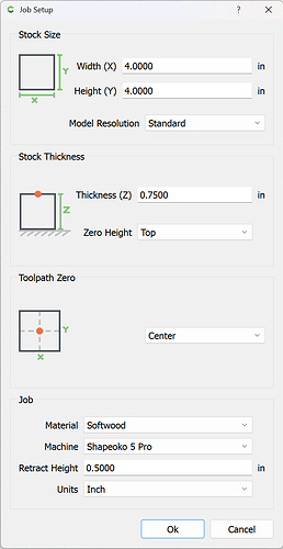

That leaves the last question of, “What stock thickness?”
FWIW, IME, if one views CAD and CAM as digital fixturing and jigs and machine setups, then it is faster, and it increases the efficiency of machine time, since setups/workholding for CAM go much more quickly than setting up a traditional tool.

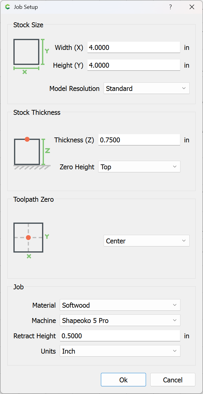

The thickness of this piece is ¾”. I agree that a CNC will improve the efficiency of a work flow if the user is familiar and comfortable with the software use to create the part. For me, that software would be Sketchup. I read early on that Sketchup wouldn’t work, but one of the responses in this forum pointed out an add-on that will allow it to work. If that’s the case, I’m sold. I see a new Shapeoko in my shop. Thanks for your help.
To finish this in Carbide Create, set the Job Setup to the correct dimensions:

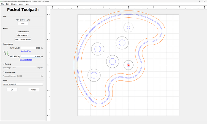

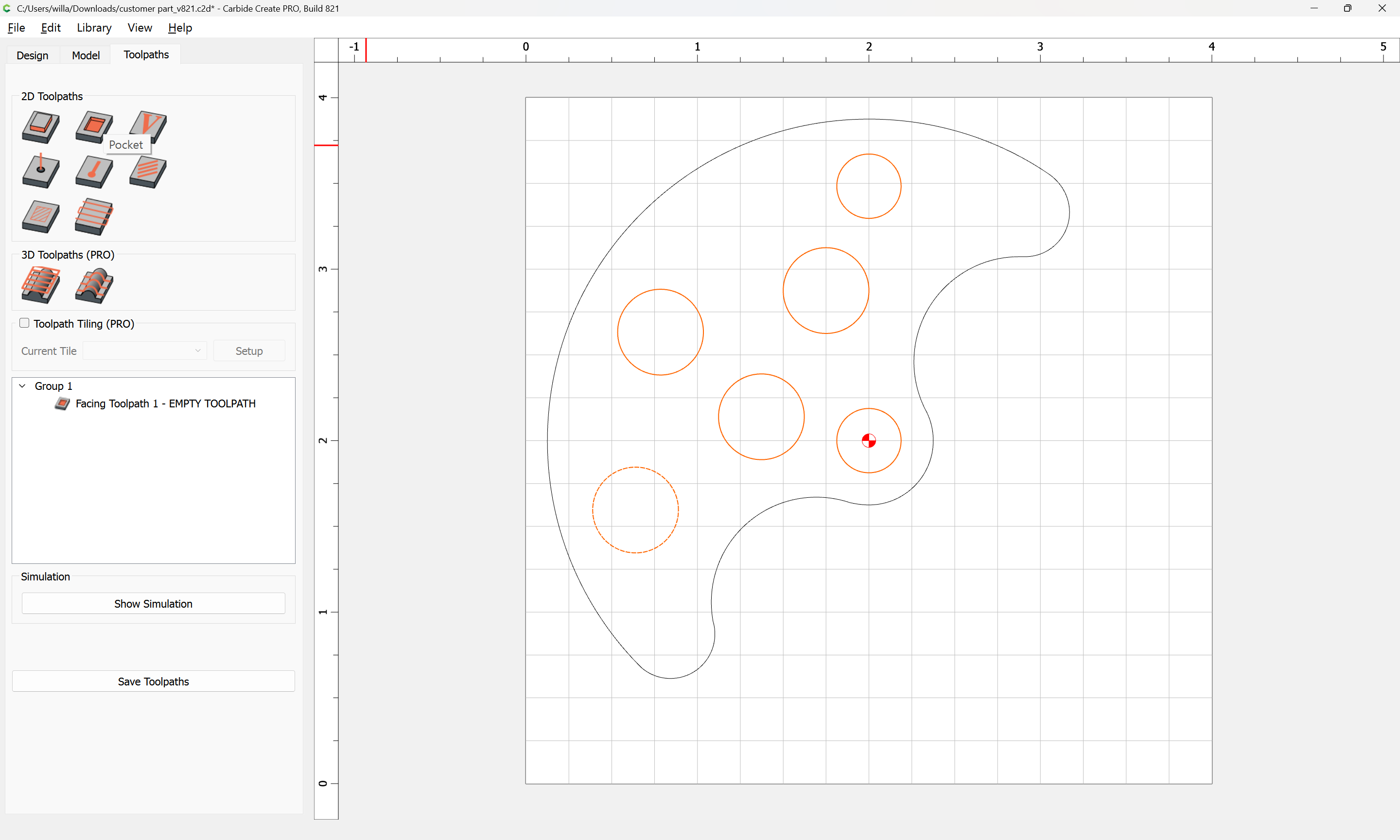

Then assign toolpaths — first a pocket:
to the interior elements using a suitable tool — note that you will want a tool w/ at least an 0.75" cutting flute length:

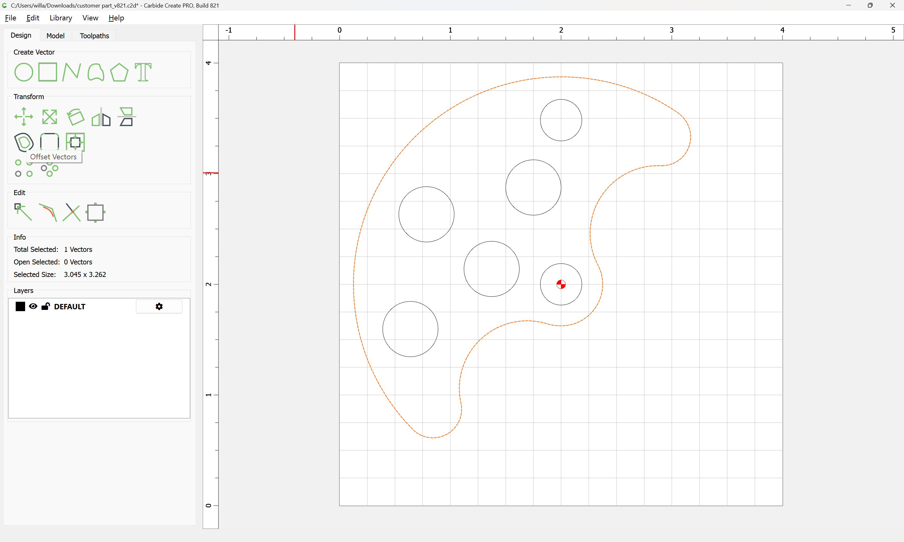

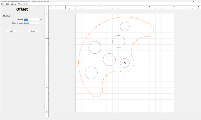

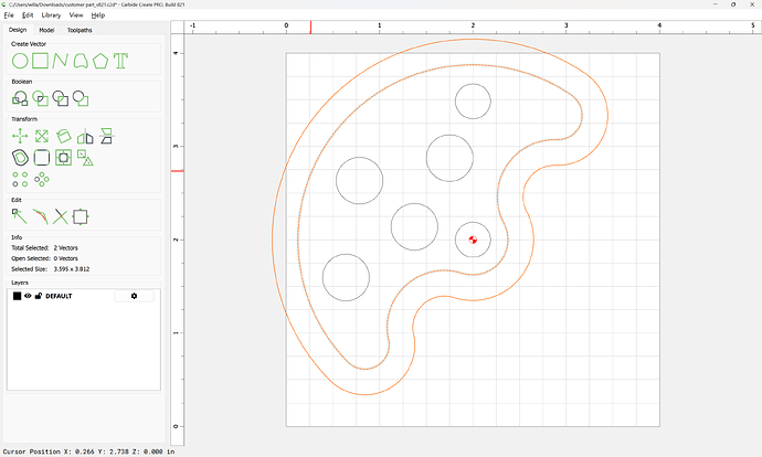

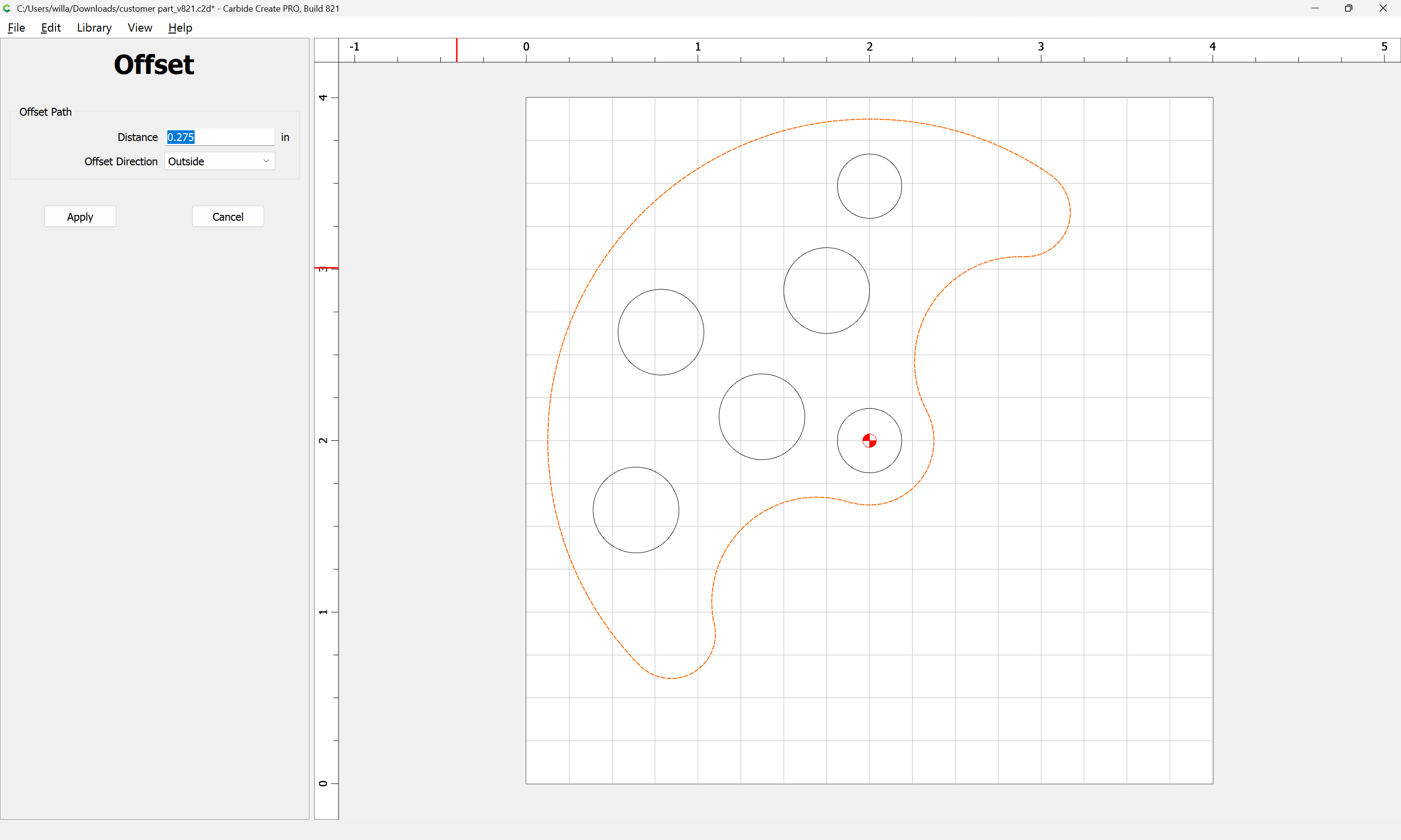

For the perimeter, you will want to go back to the Design tab and Offset:

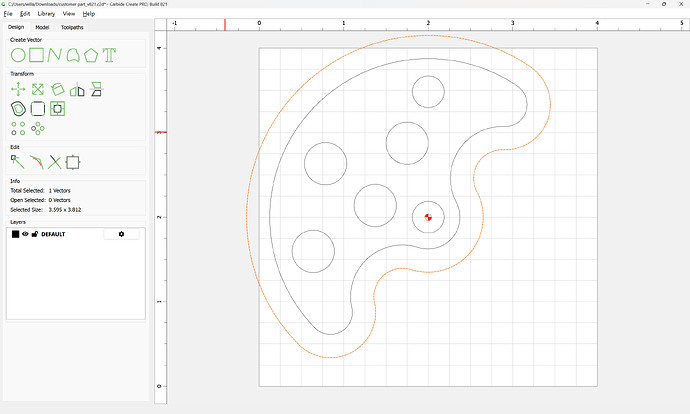

by endmill diameter plus 10%:
Apply
Then shift-click on the original geometry and add it to the selection:
and assign a Pocket toolpath down to tab height:

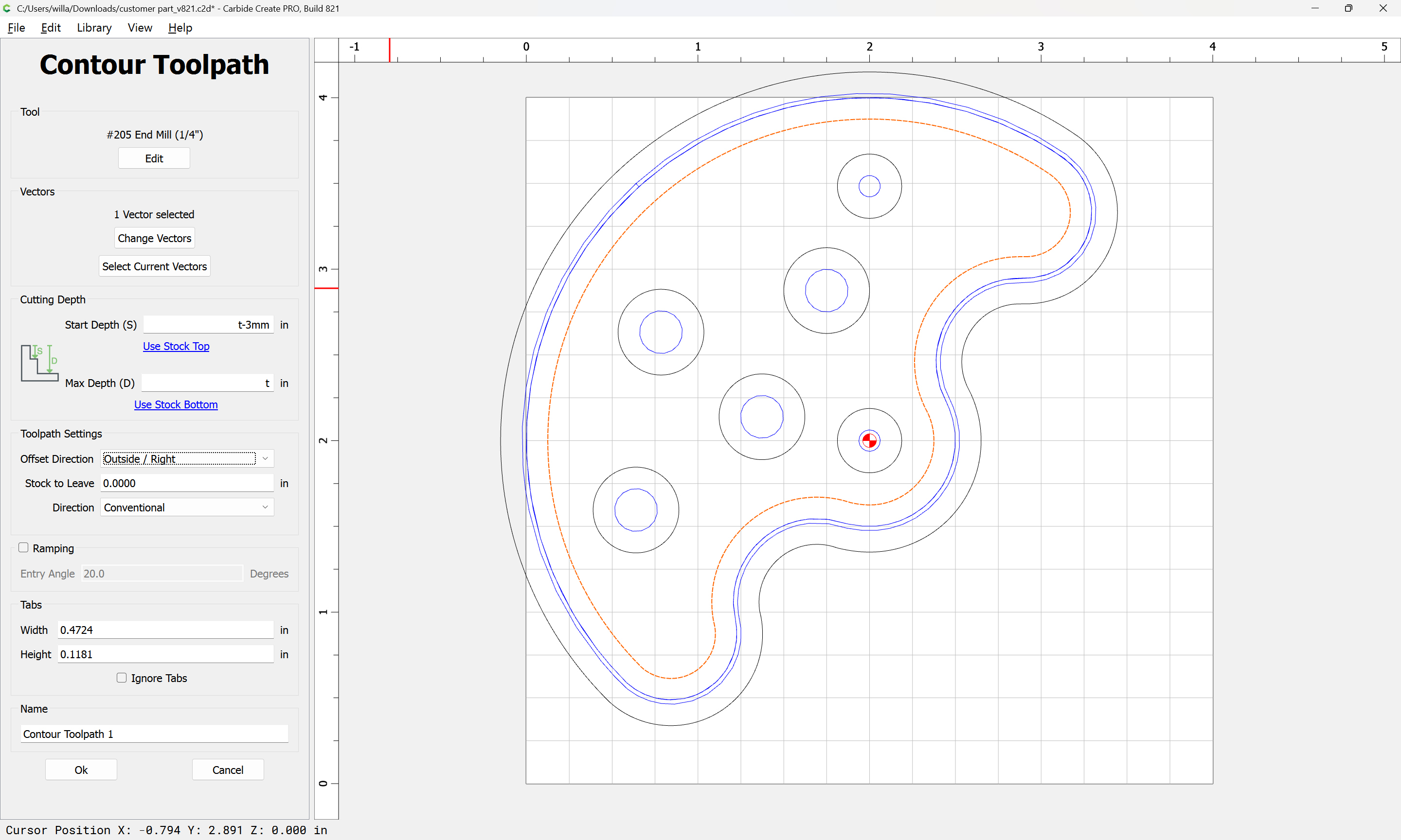

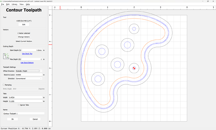

Then select only the original geometry and assign an Outside Contour toolpath to cut through the stock:
If workholding is such that tabs are needed, go back to the Design tab and add them.

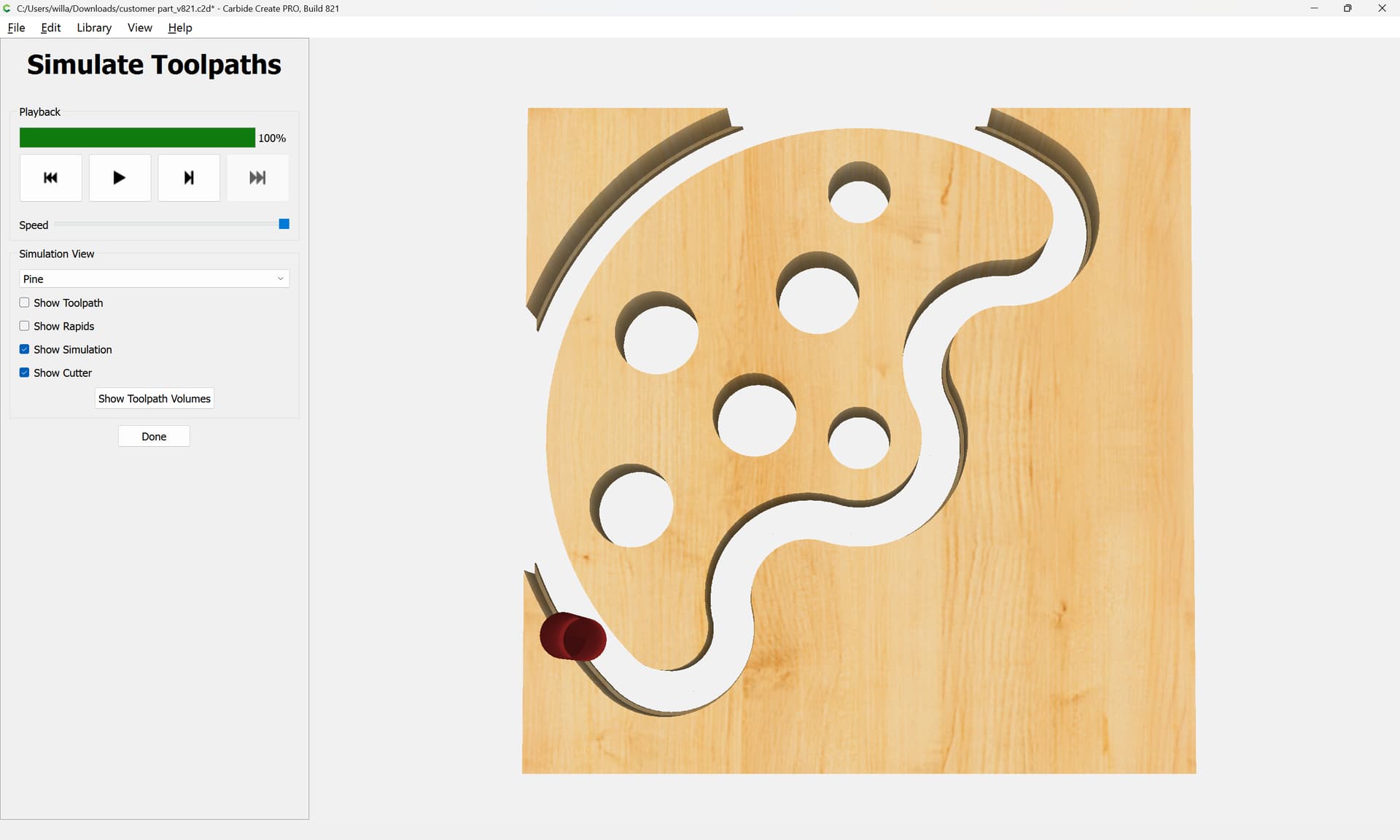

The preview without tabs:

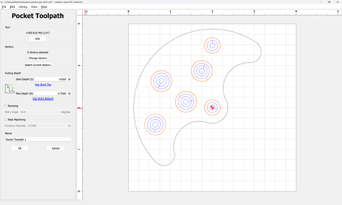

There are two approaches for making holes:
  • a “Drill” toolpath — this requires a tool which will cut the desired hole dimension, and is vulnerable to issues of tool/machine deflection:

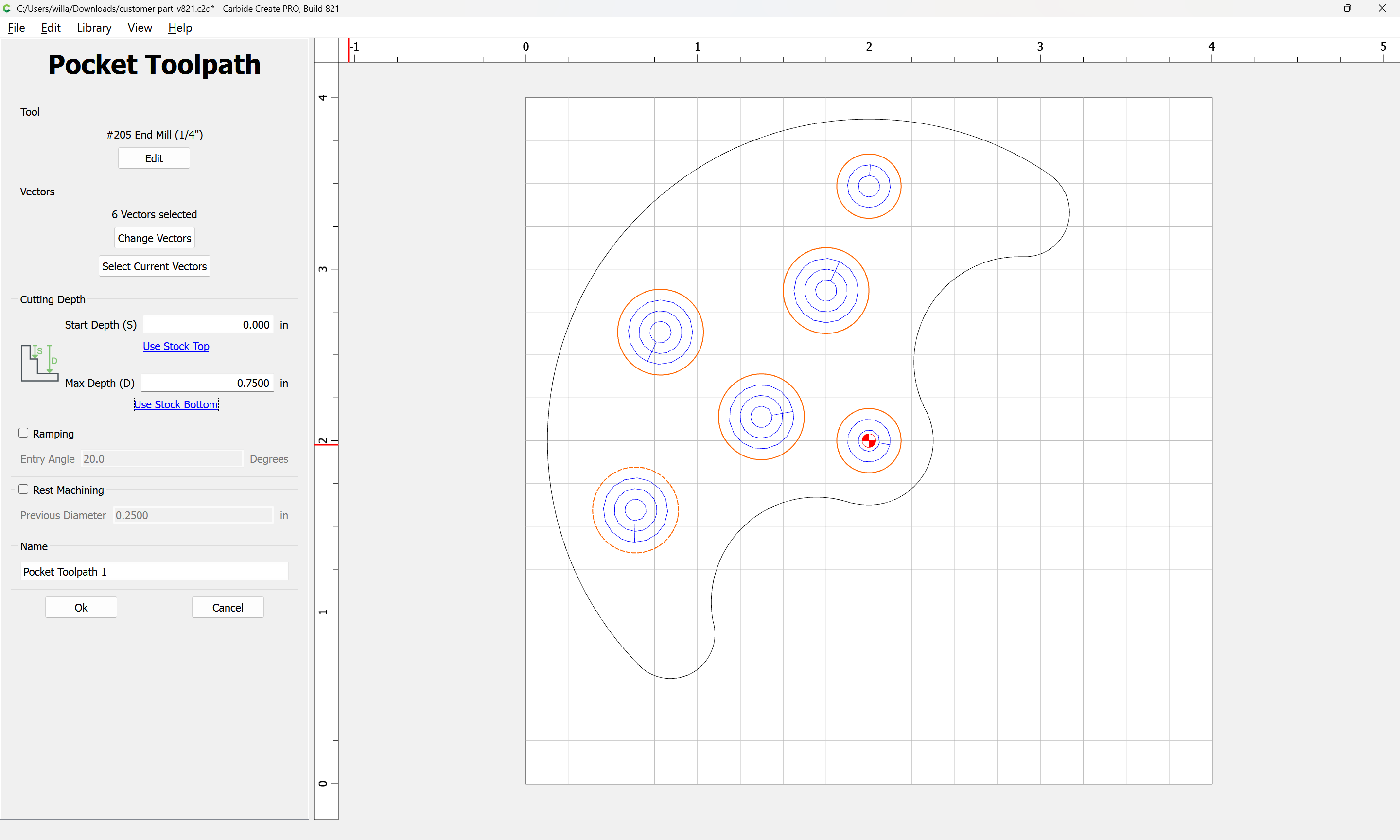

  • a “Pocket” toolpath as was shown above:
Select round geometry:
assign a Pocket toolpath:
Note that this allows the option of drawing the hole smaller, cutting it, doing a test fit, then adjusting the size and re-running the toolpath.

In your example a Contour for the outside profile and Pockets for the holes would be what I would do. If your material is thick ( again a feel ) a Pocket for the outside edge would be appropriate. Drilling holes does not produce accurate holes, you are better off “circle milling” ( a Pocket ) inside the hole with a tool bit smaller than the part hole.

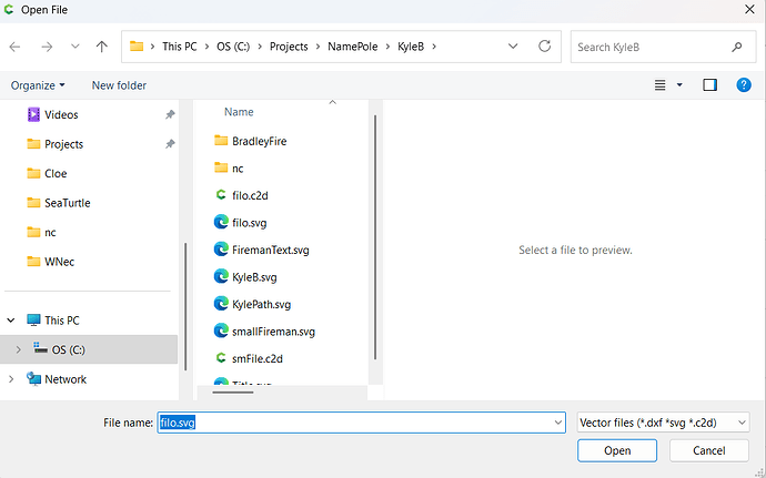

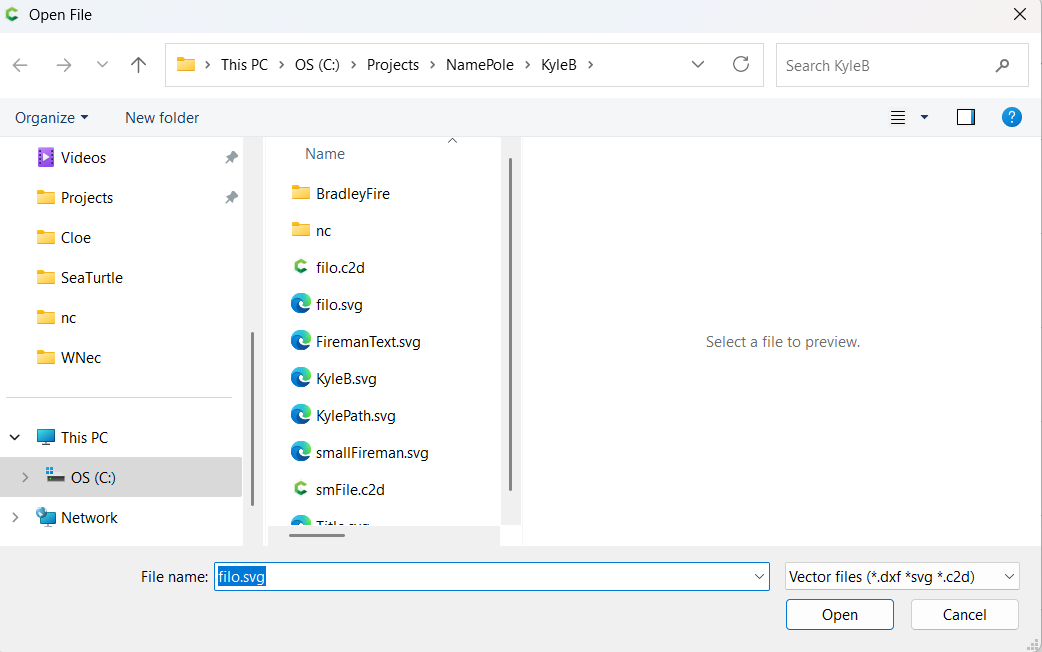

Note that for arcs in DXFs, it will be necessary to use a third software application to import the DXF, then export as an SVG (which will preserve the arcs as curves), then import the SVG into Carbide Create.
If the free STL export from Sketchup is an option, then any 3D CAM tool will work (MeshCAM is about the easiest).
Let us know if you need assistance with any aspect of Carbide Create.
Based on your recommendation in another thread, Will, I am successfully using the free/open source LibreCAD to resave the DXF’s I output from VersaCad, as SVG’s.
@nukebert - Based the the previous thread, it seems that Carbide Create will interpret a DXF files Arc and generate a series of “strokes” that represent the Arc. It works, just not optimum.
If you can export an SVG file, the results in Carbide Create will translate correctly.
