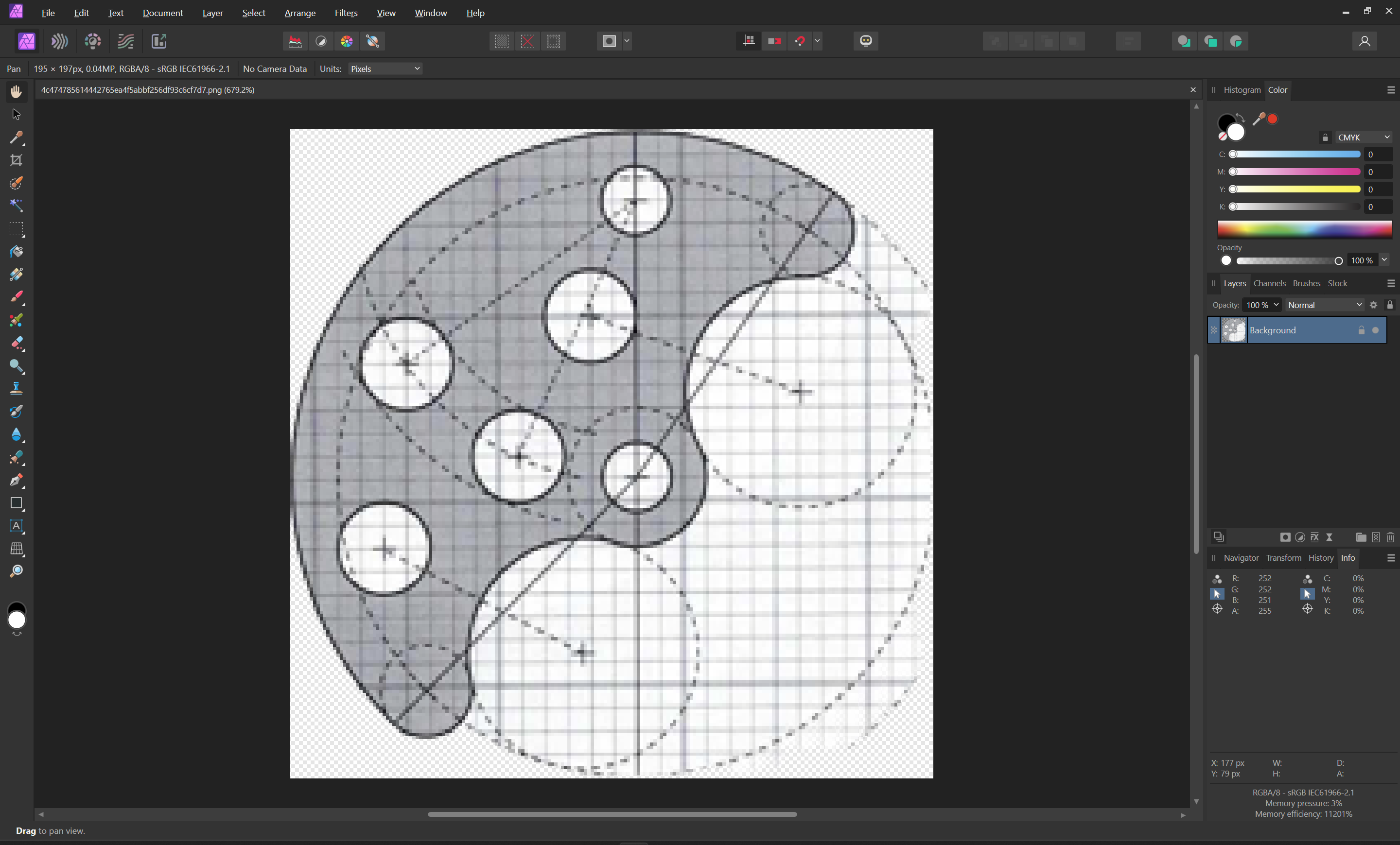

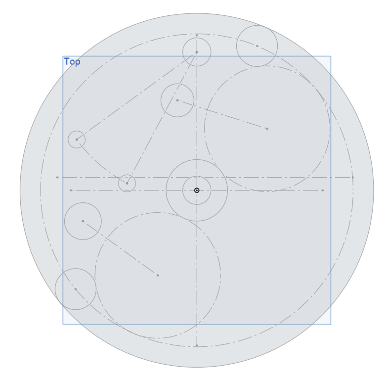

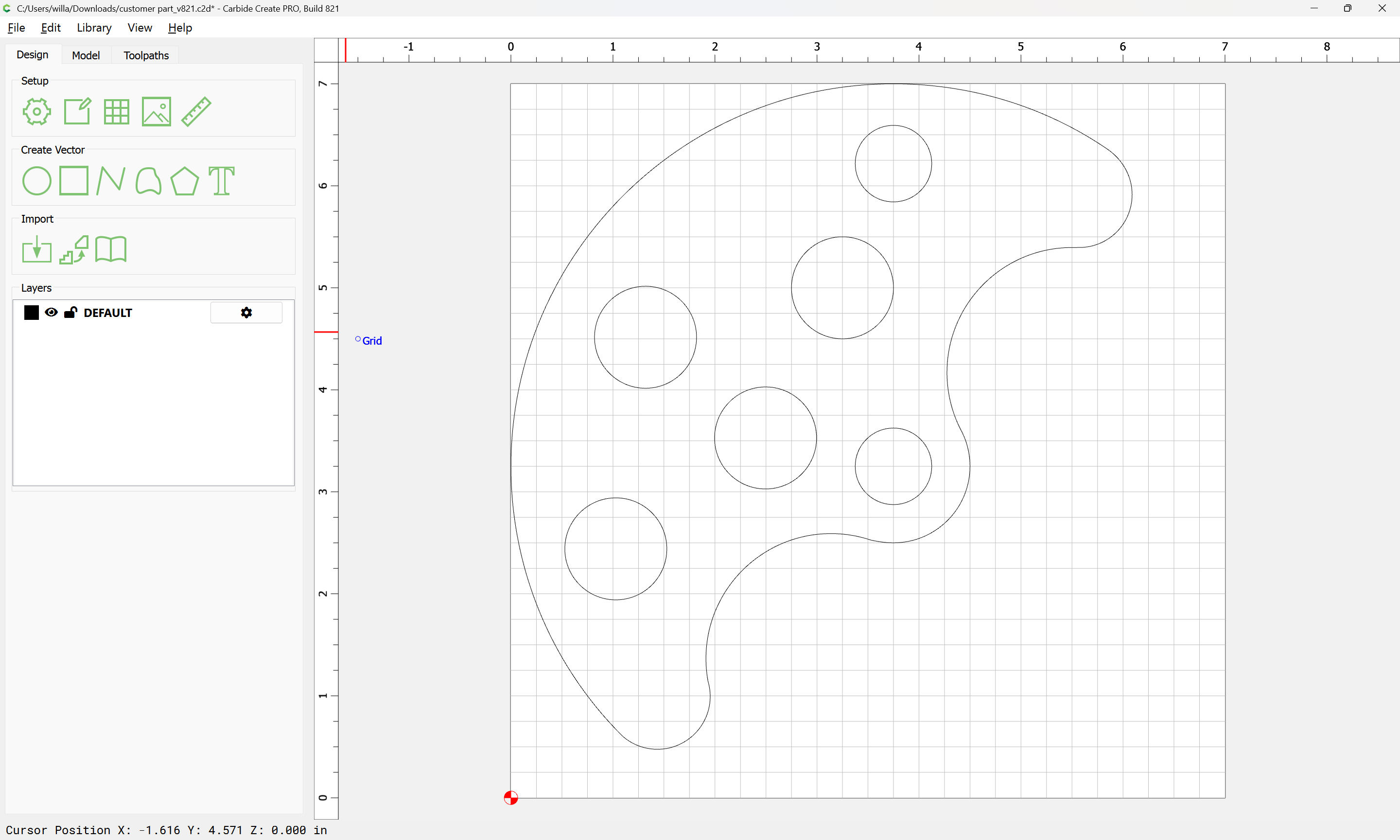

OK. This is a part as requested.

How comfortable are you with a CAD system ?
That part is 2D and can be drawn in any 2D system that supports tangent arcs.
You can export via DXF or SVG so long as the Arc’s do not get stroked to line segments.
Given what you have created without CNC, I am going to watch what this master does with a new implement of creation.
I will layout the part if you can provide dimensions.

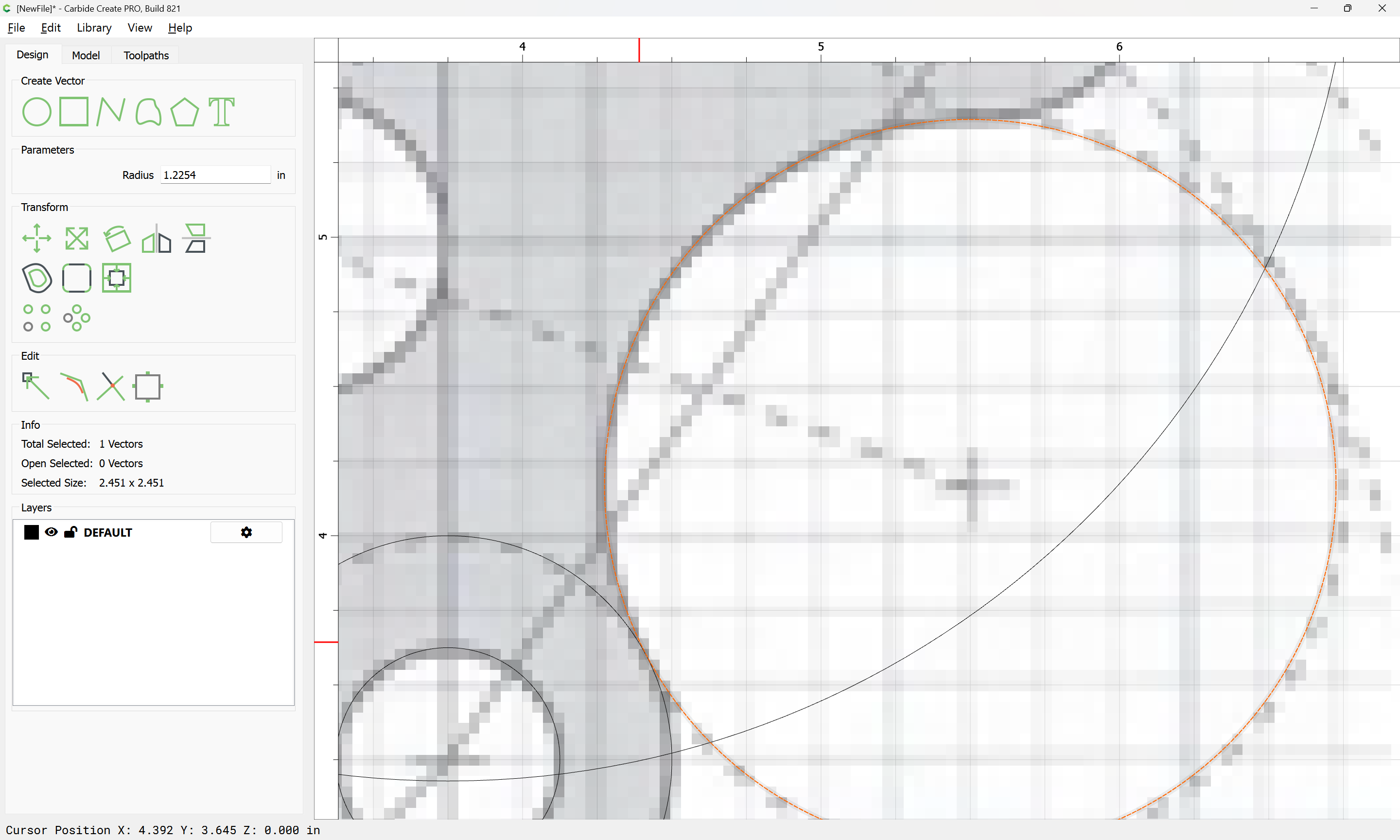

This is quite low resolution:
and I don’t see any dimensions.

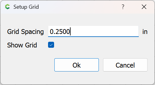

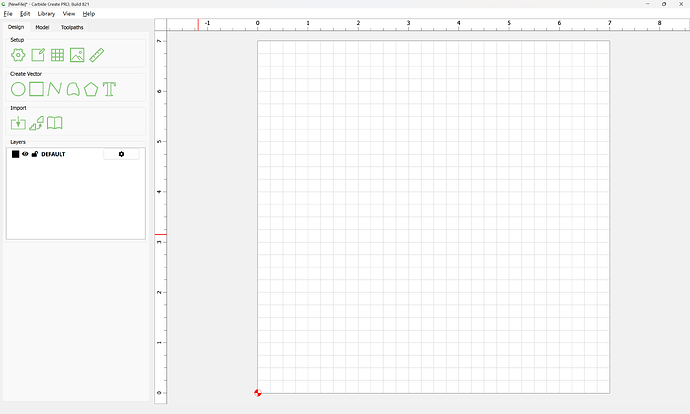

Assuming that the grid is 1" with 1/4" divisions…

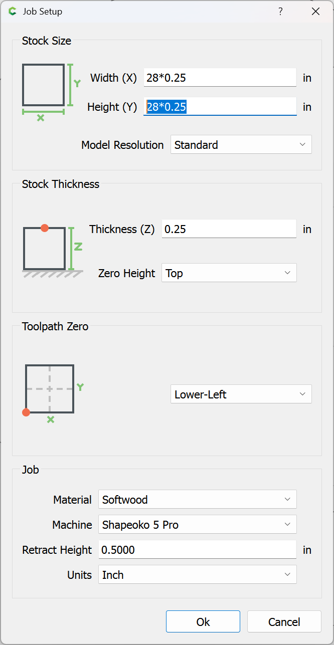

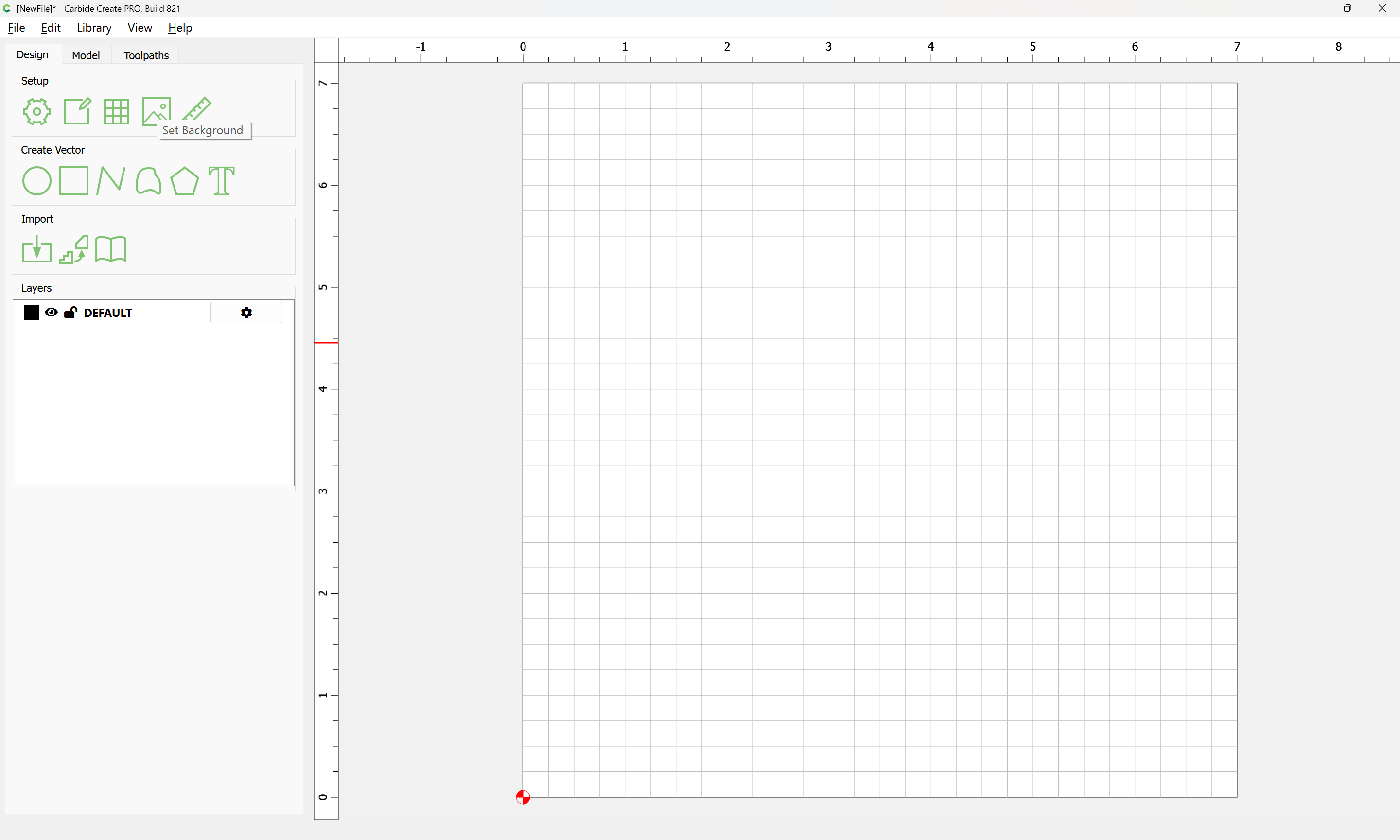

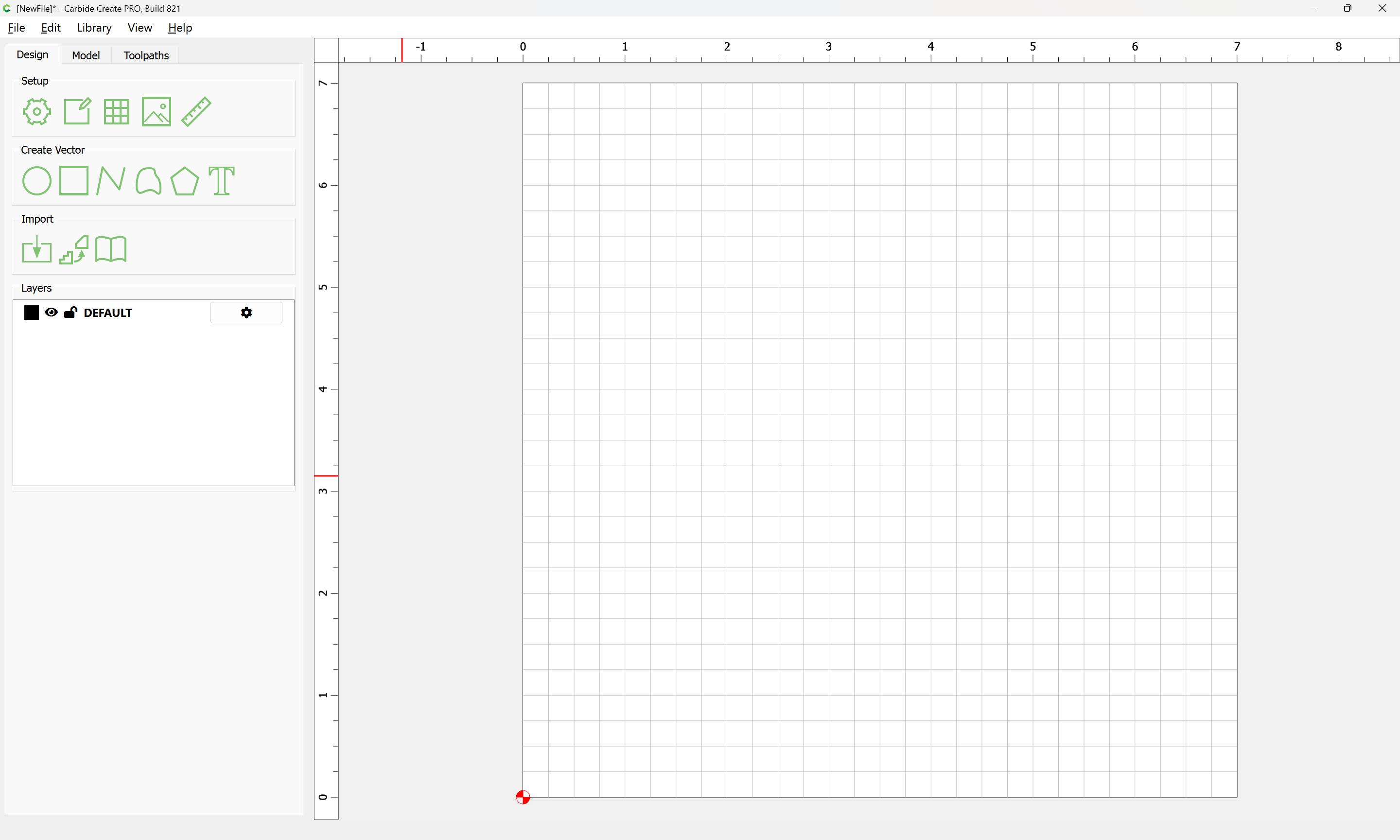

(described at: Job Setup)

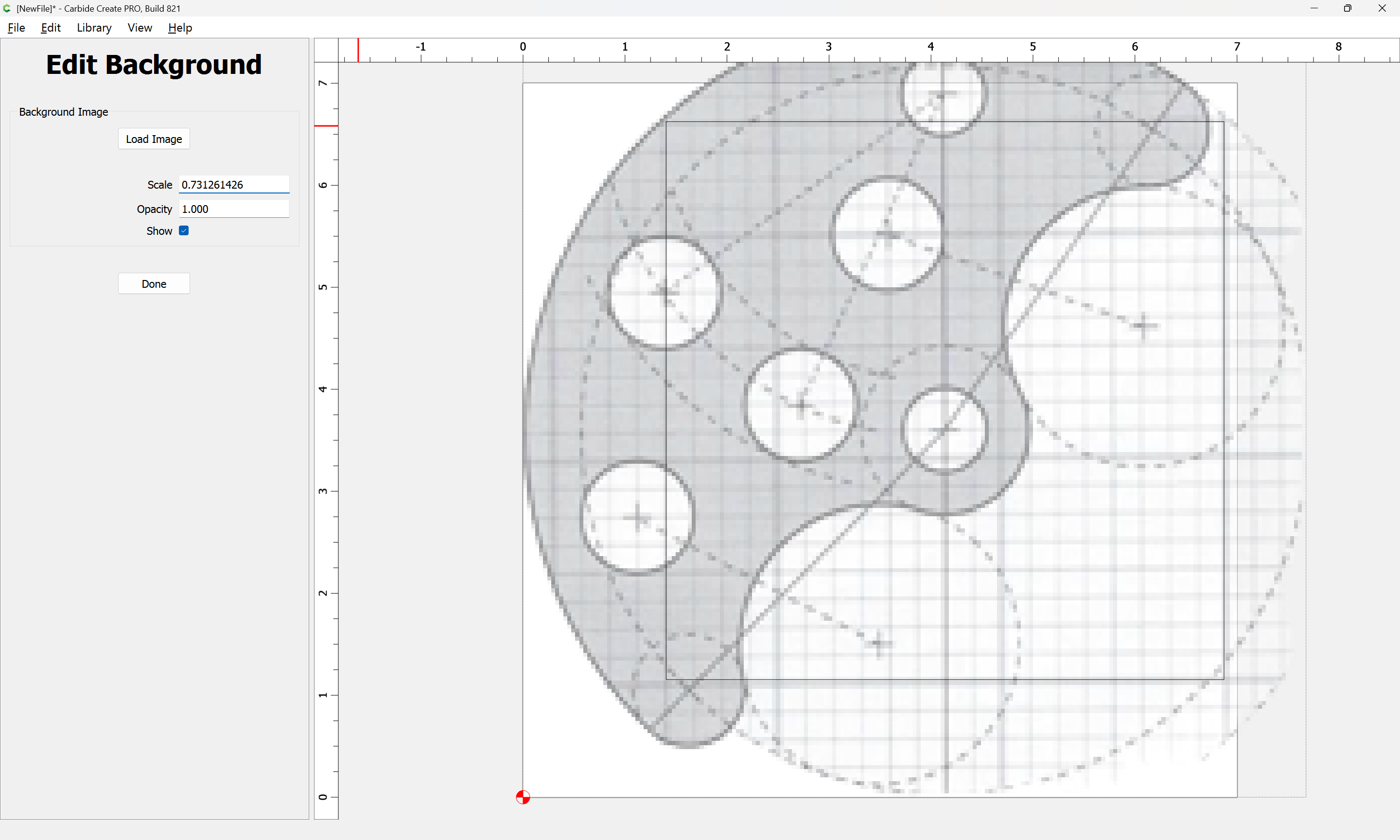

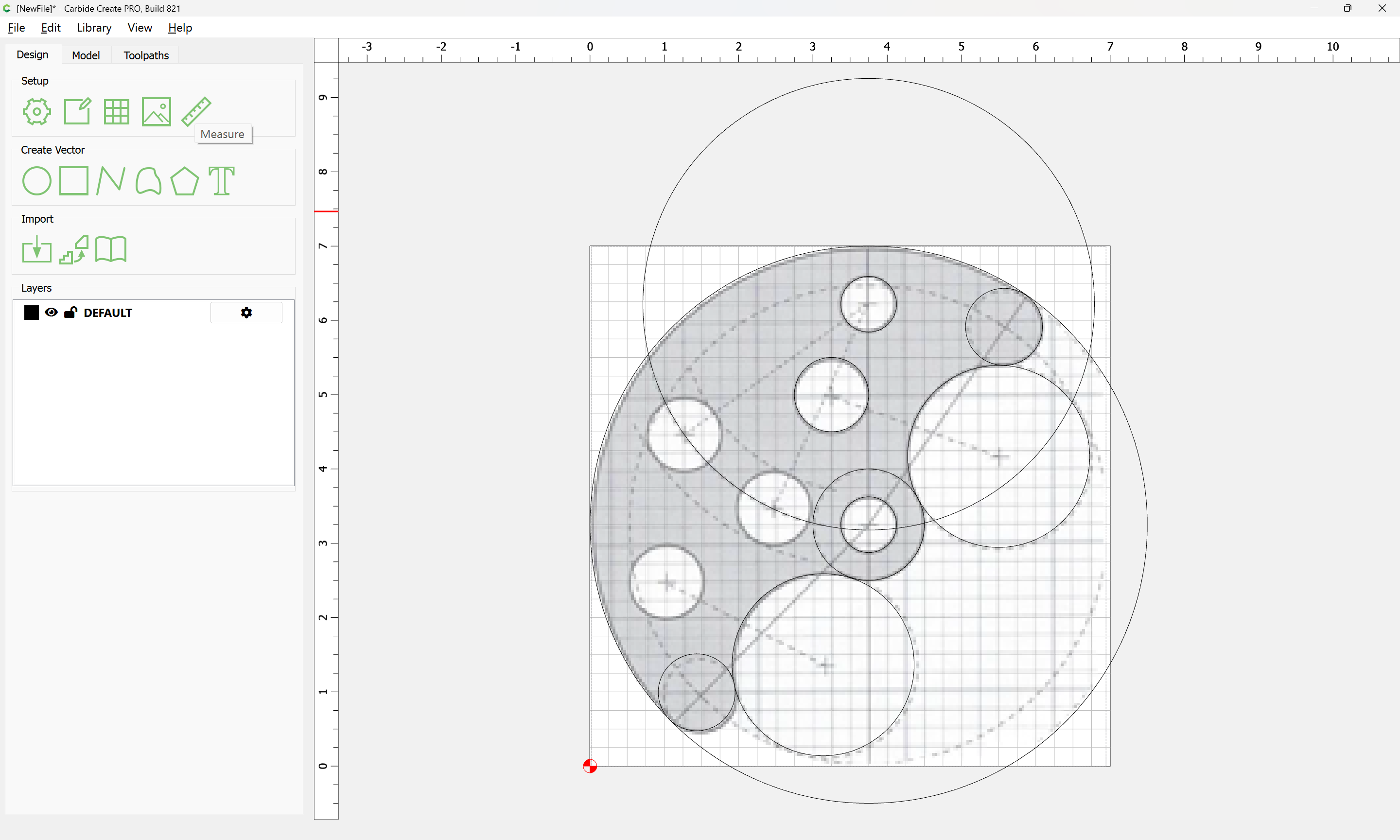

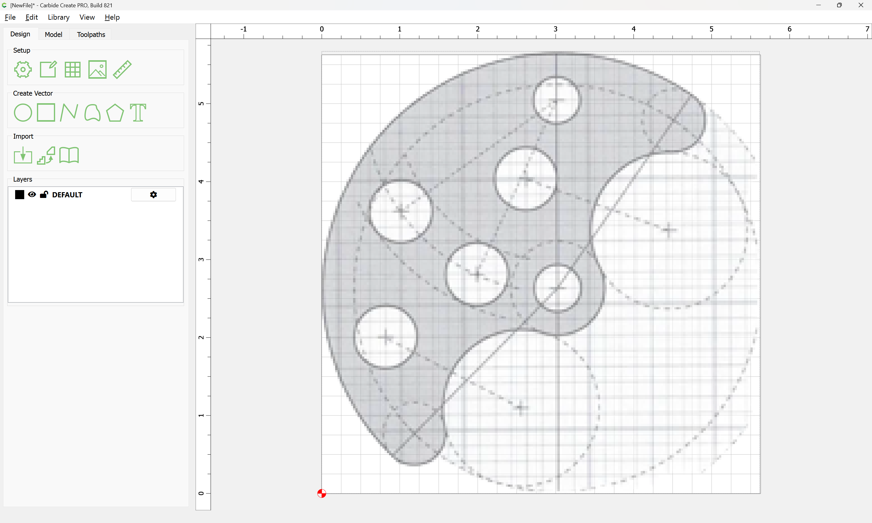

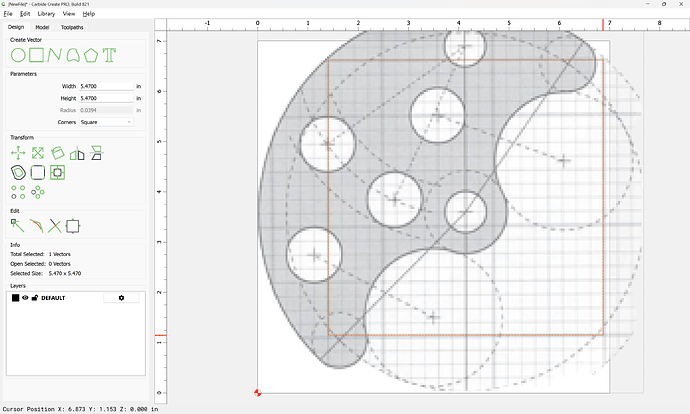

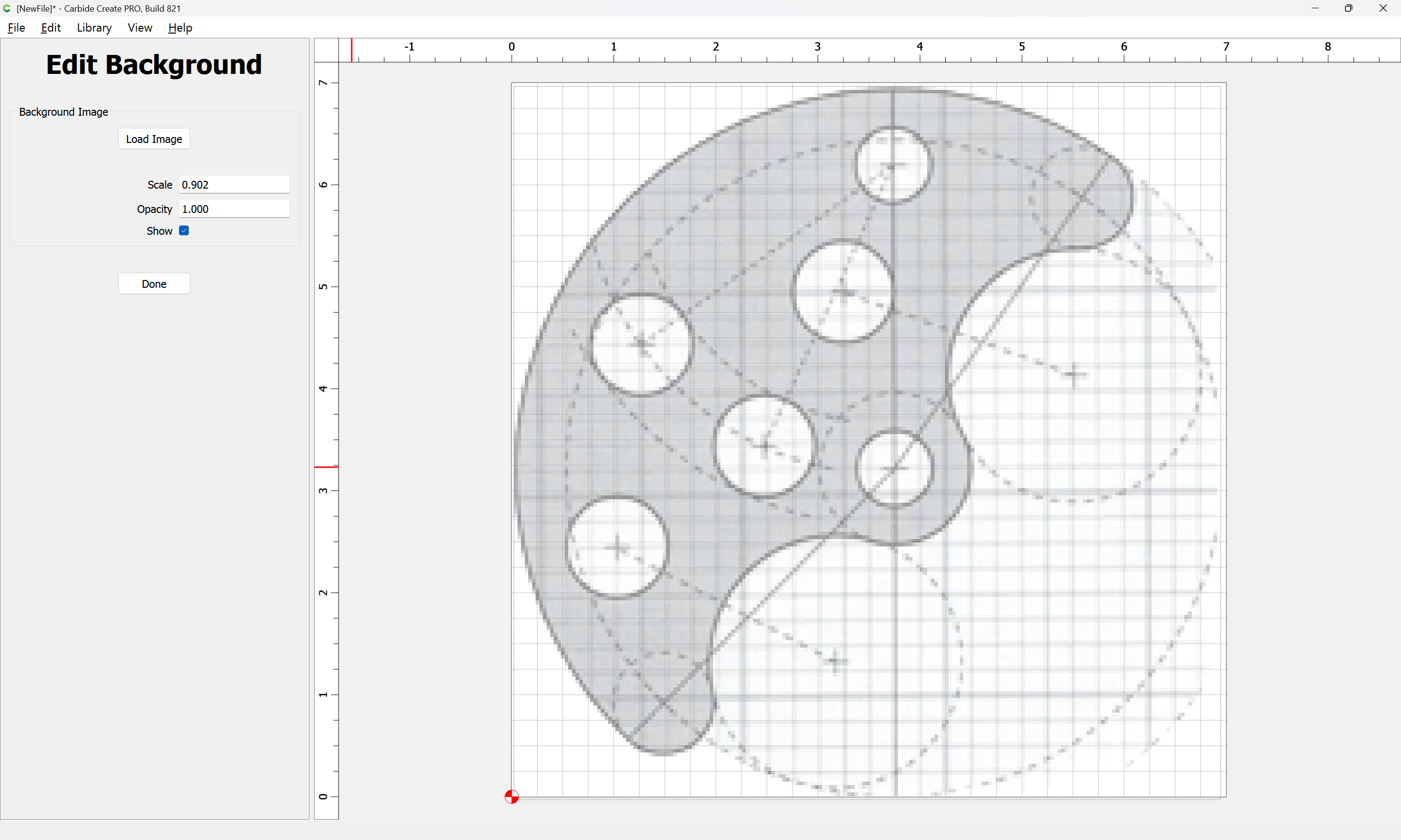

we import the pixel image as a background:

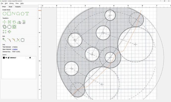

and adjust until the grid lines line up by drawing a square as large as possible:

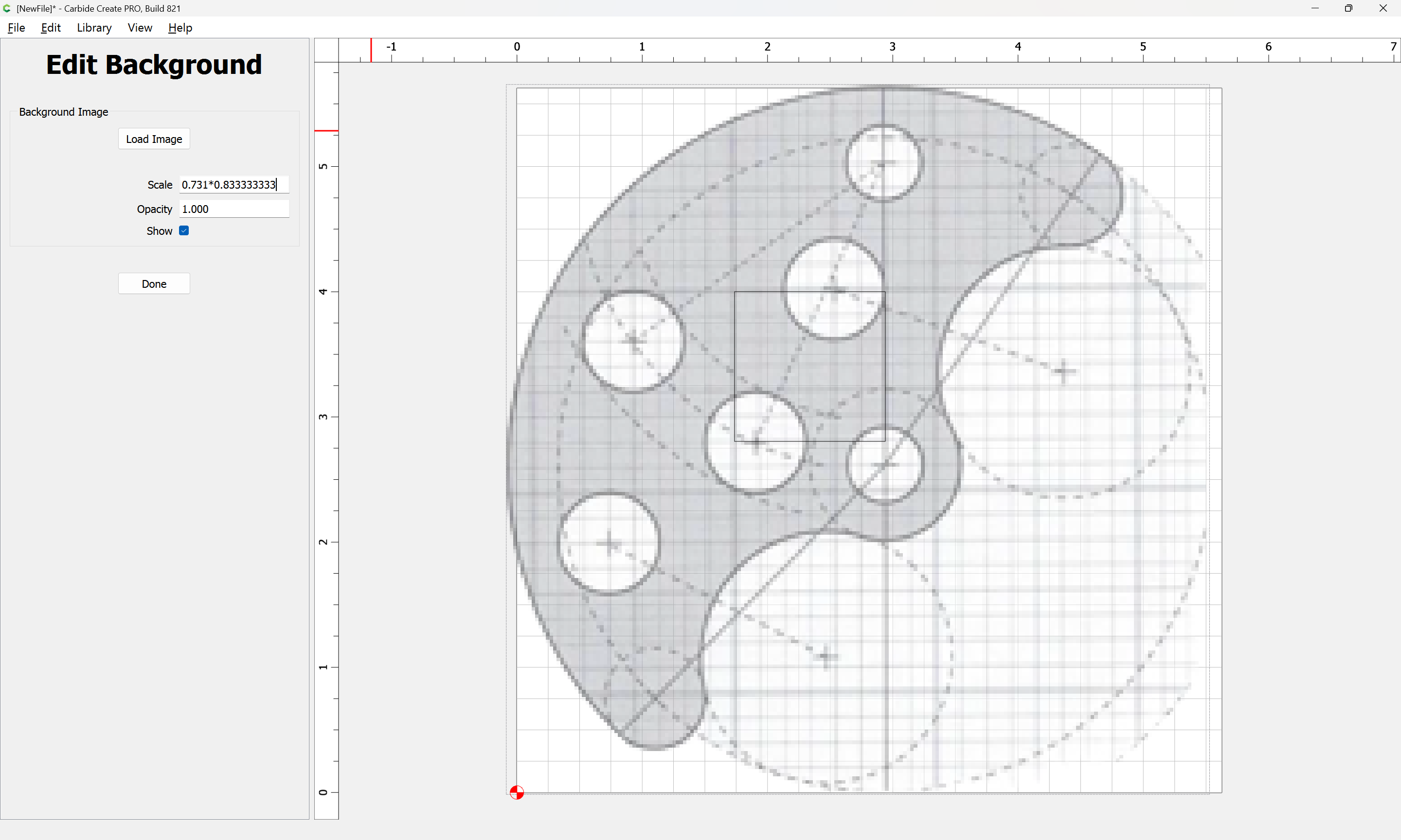

and determining the necessary scale:
4 / 5.47 = 0.731261426

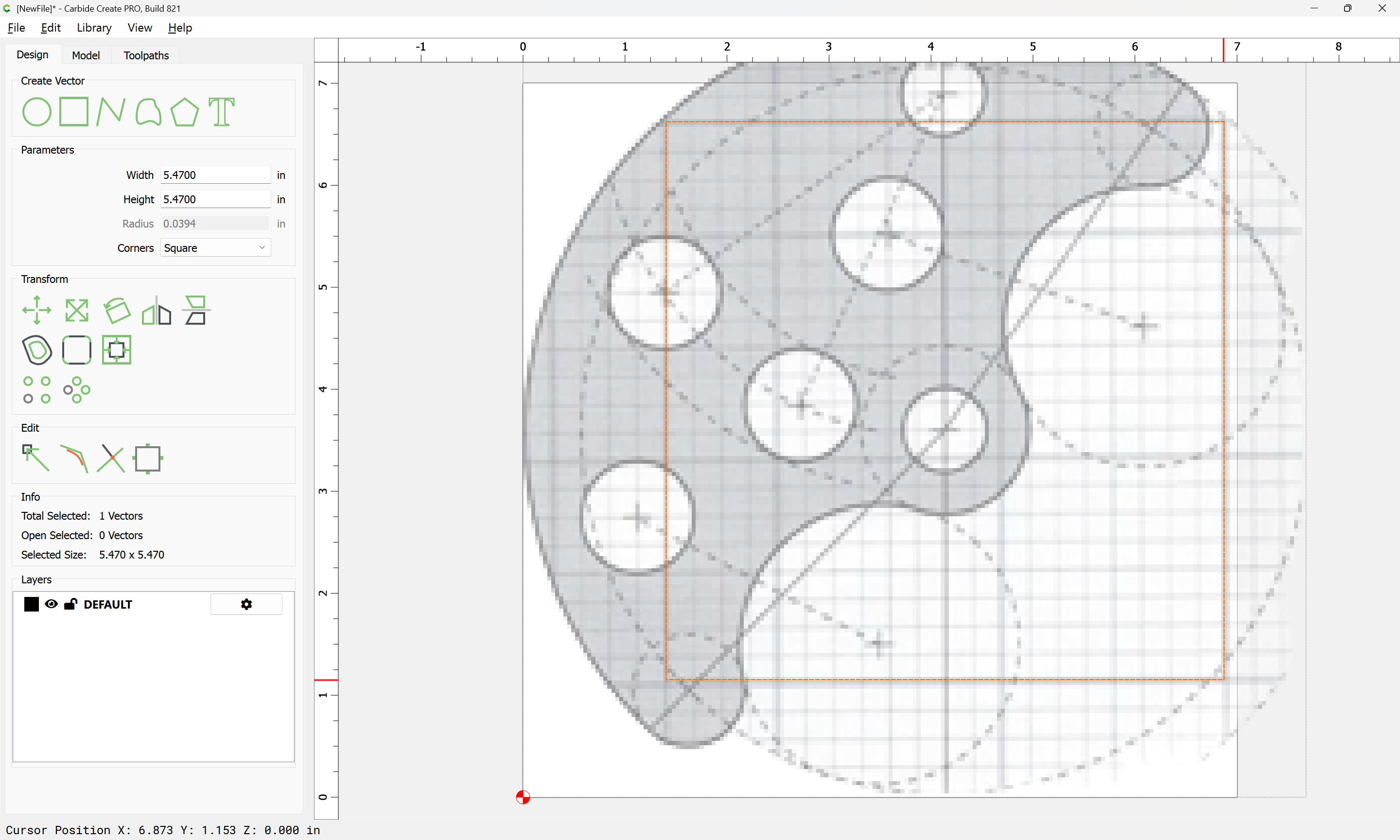

show the Grid:
and drag things around until they line up and if need be adjust the scaling further:

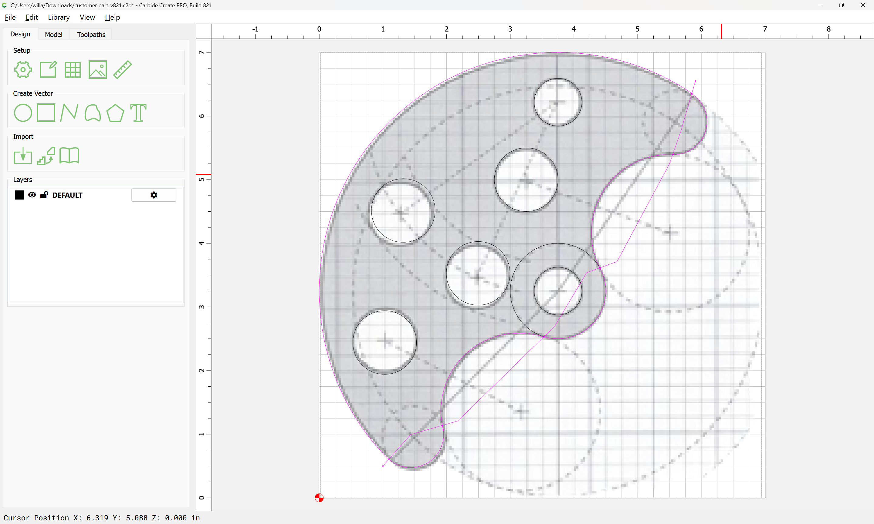

After fiddling around for longer than I’d care to admit we arrive at:
which seems workable…

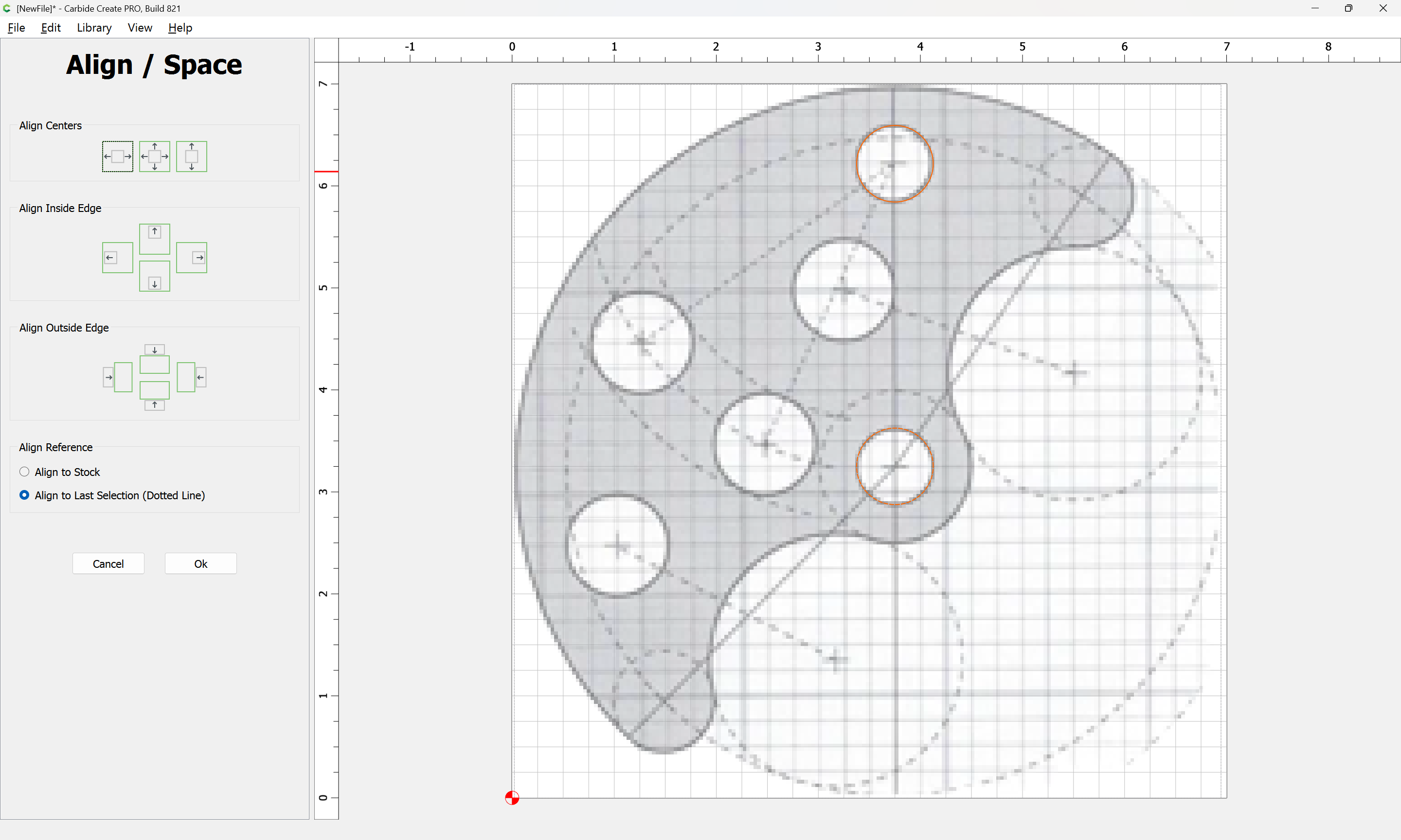

Here my contribution
I think it is geometrically constrained correctly, but I do not have dimensions.

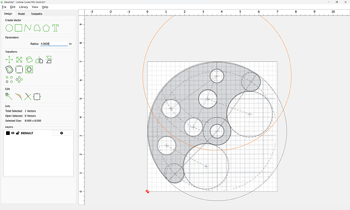

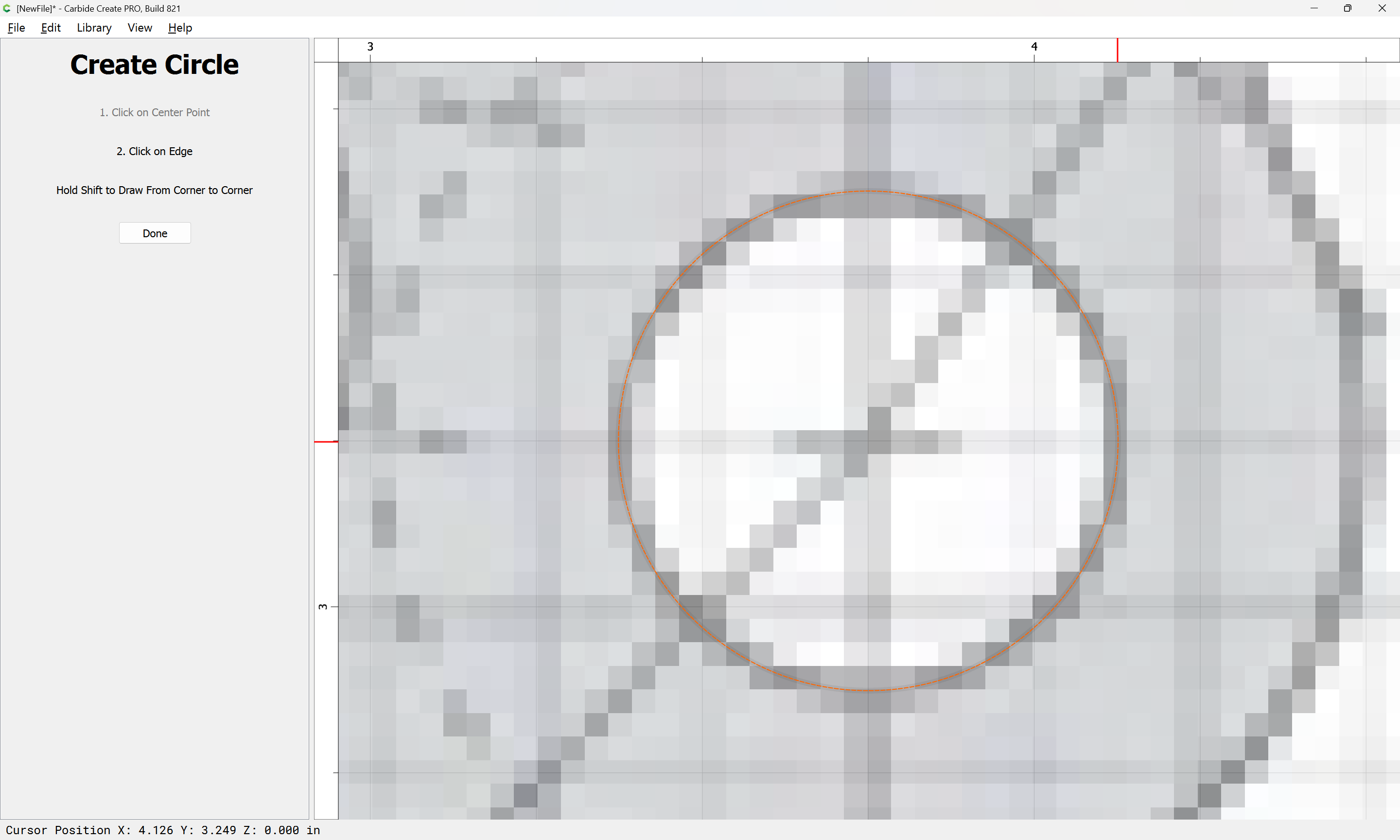

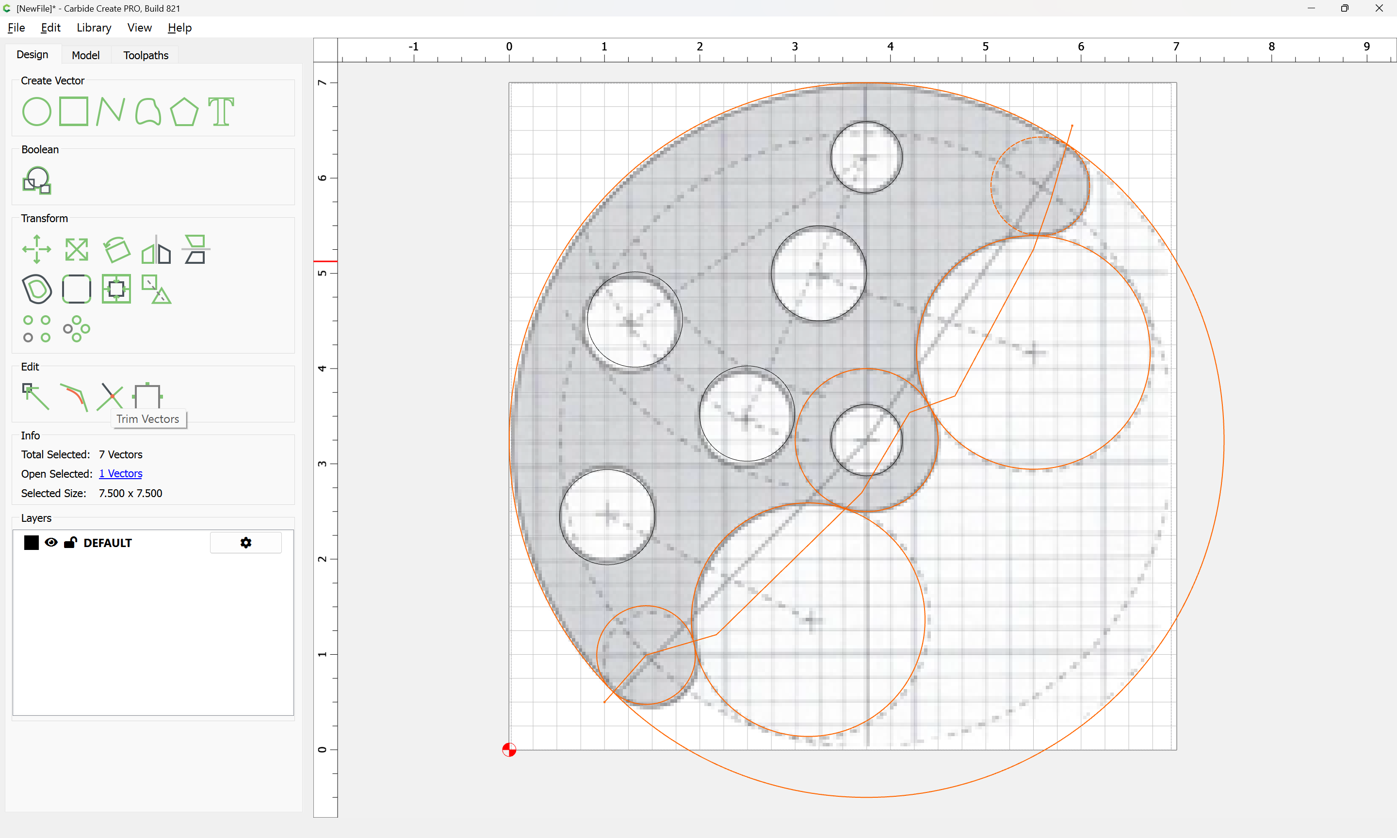

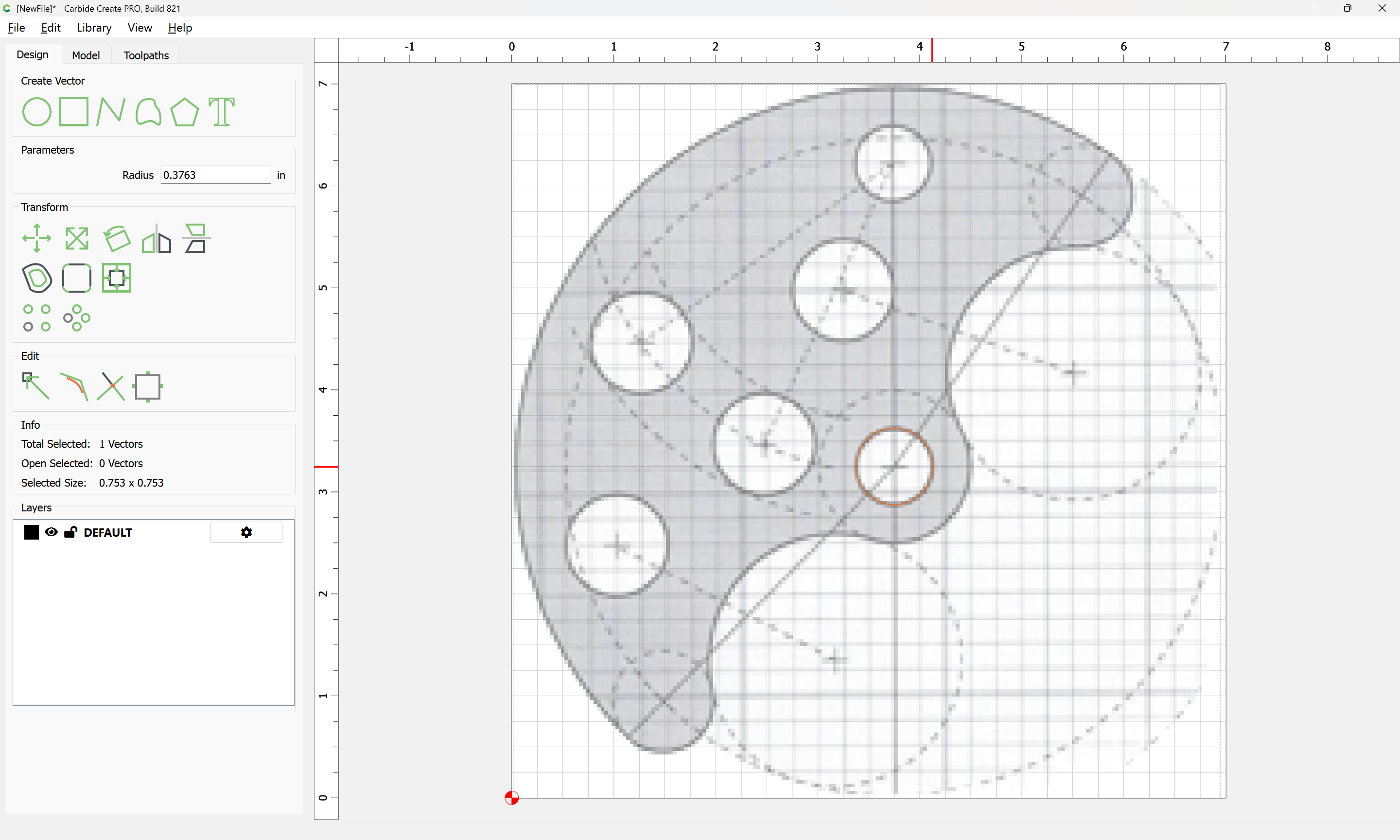

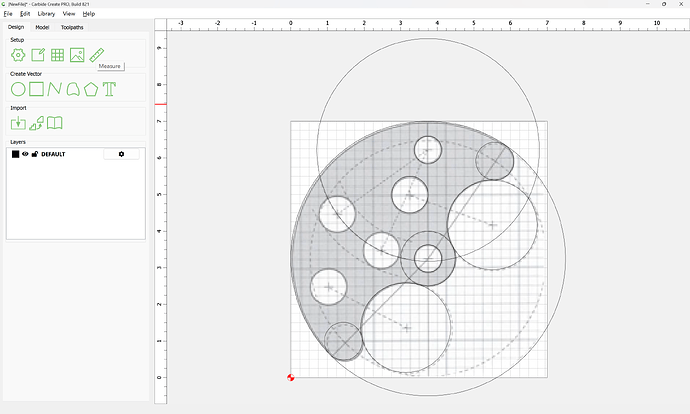

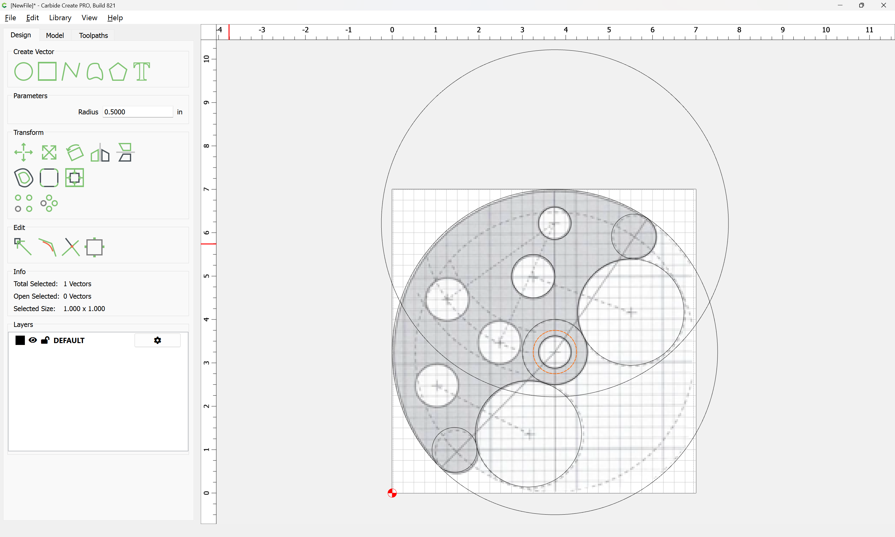

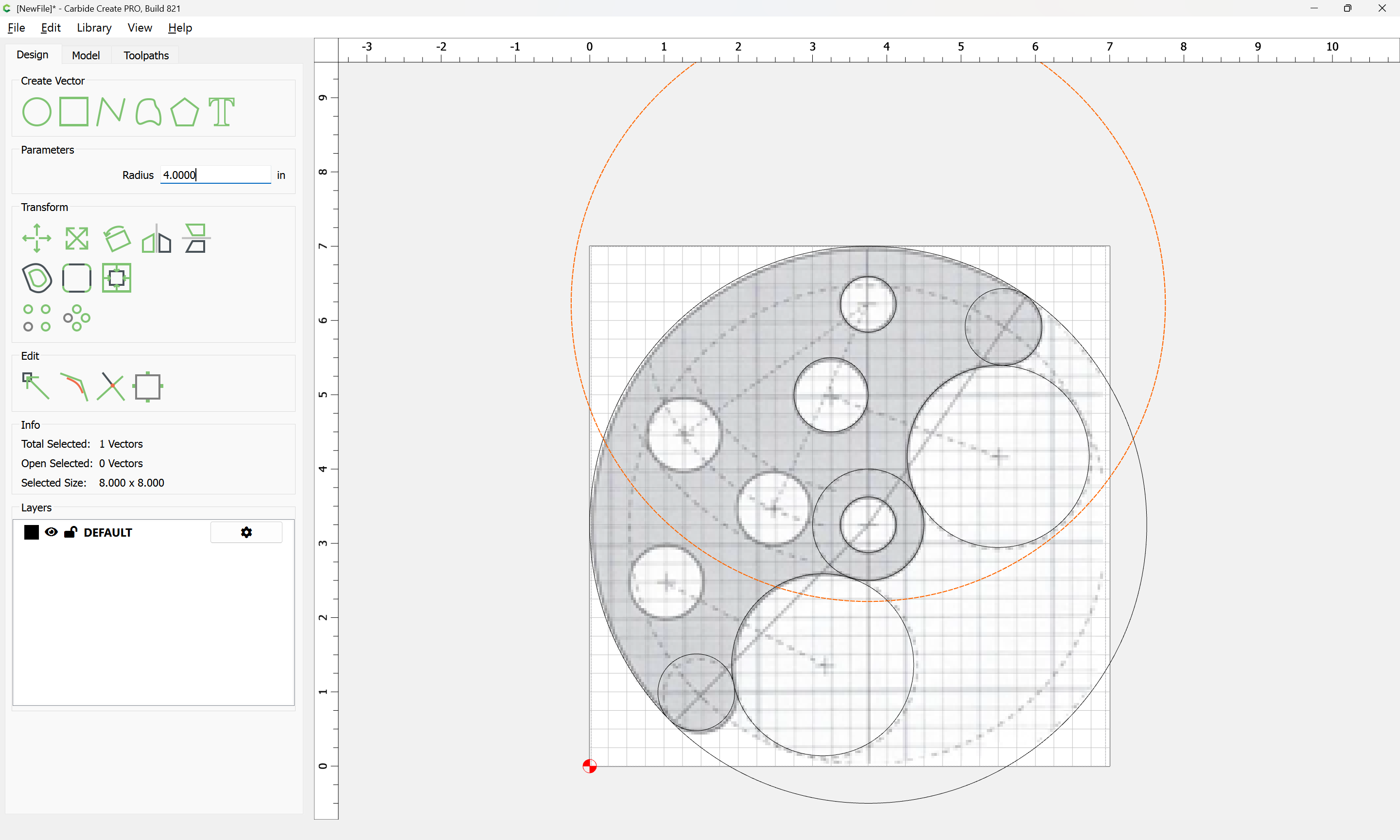

At this point, it’s “just” a matter of drawing circles:
and copy-pasting and adjusting sizes:

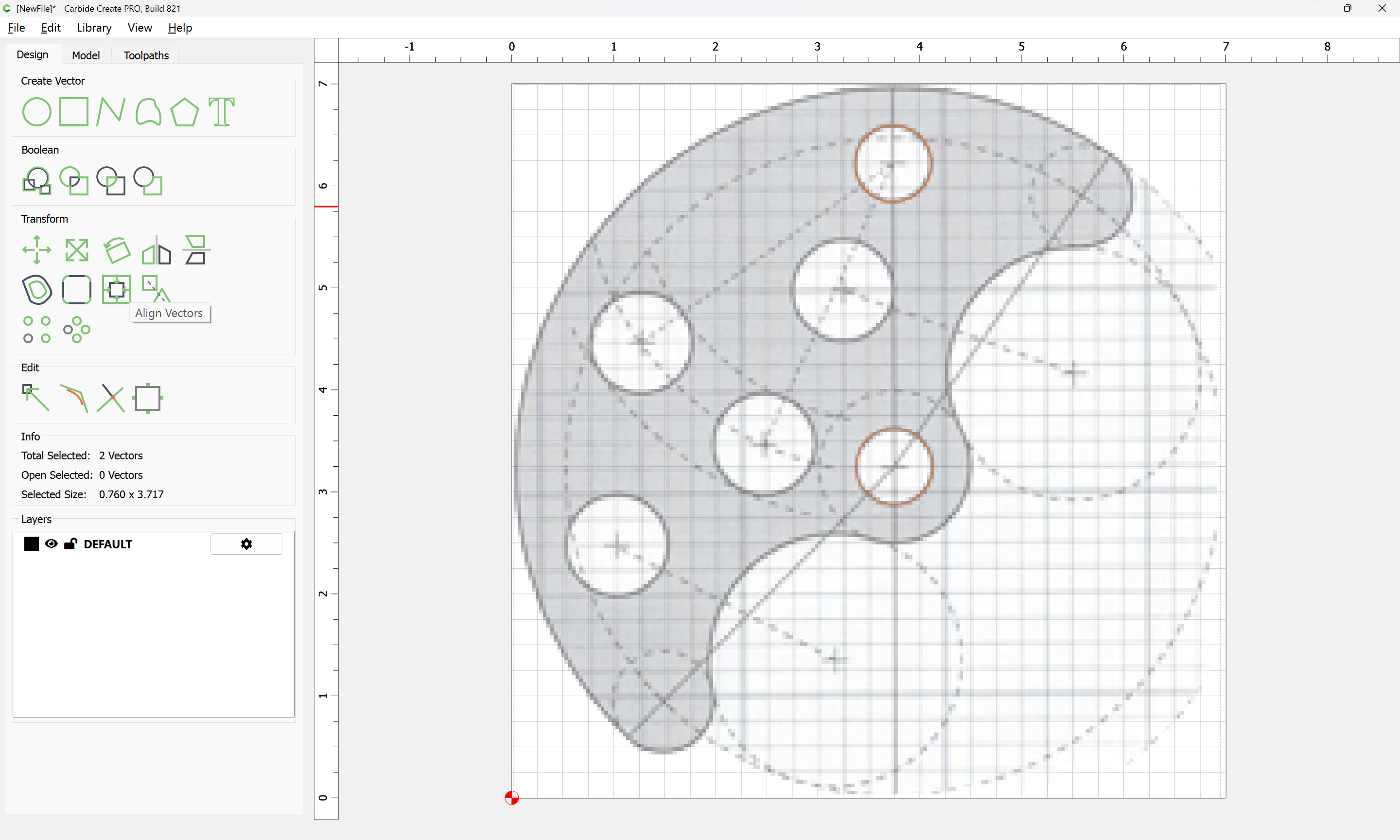

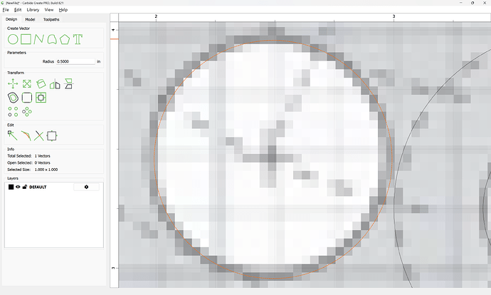

and ensuring that things are aligned (since it’s not possible to drag by the center of a circle in the current beta):
and drawing in circles for arcs:
and further drawing circles and forcing things to align where the coarse pixel grid does not allow them to:

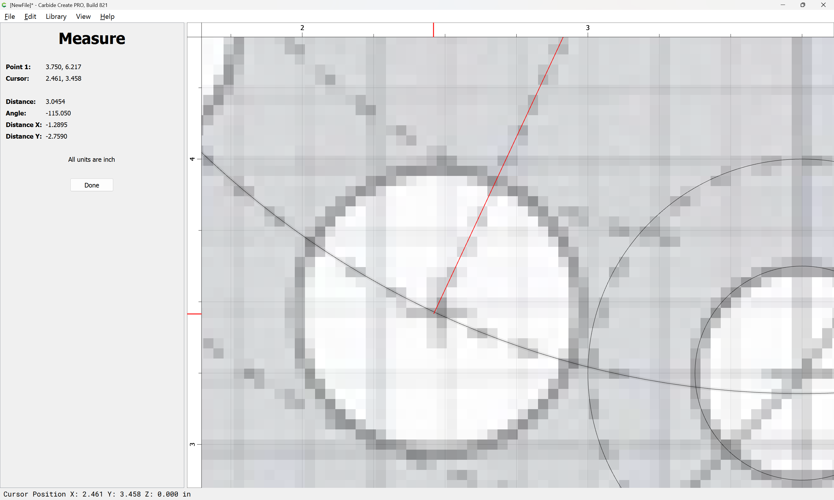

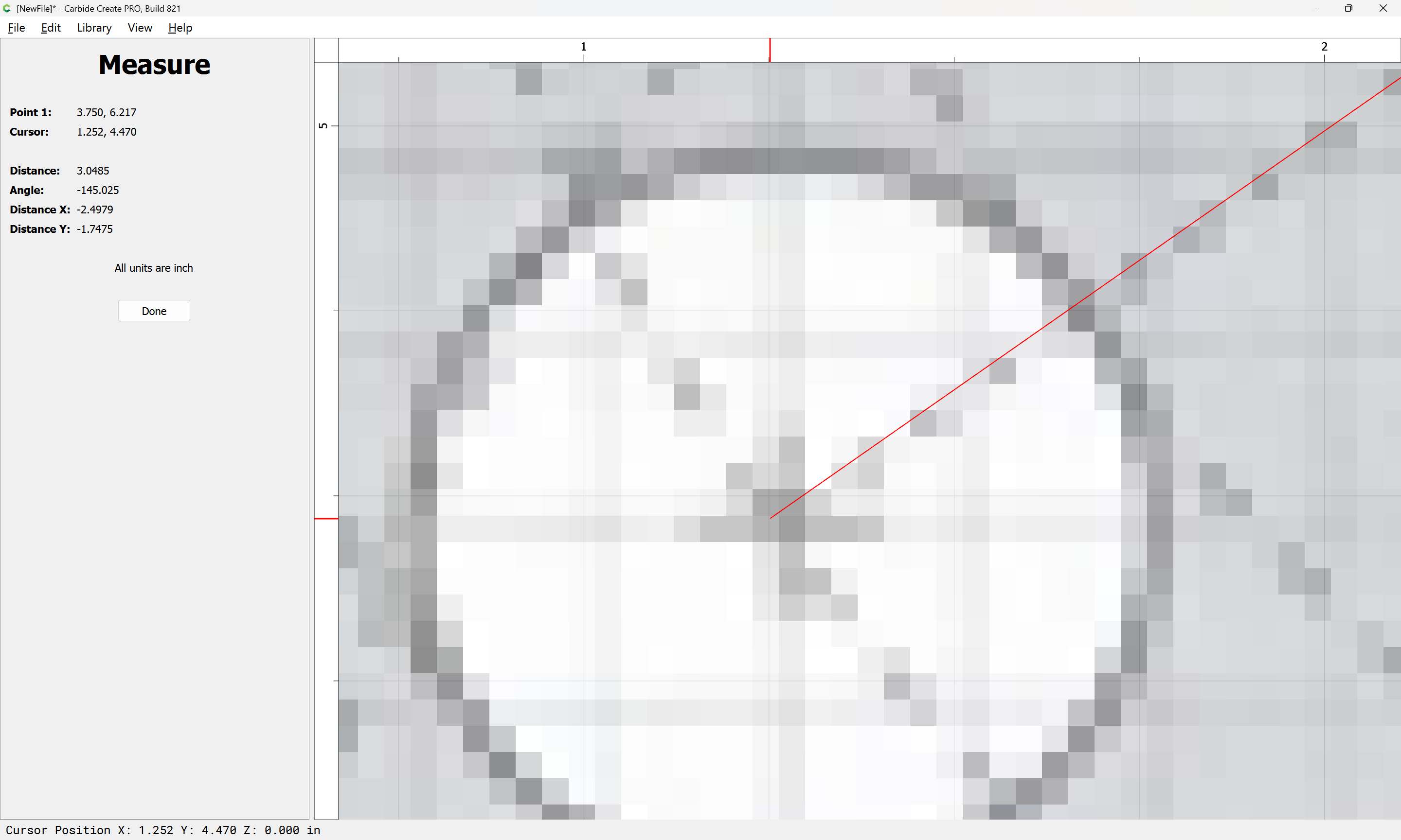

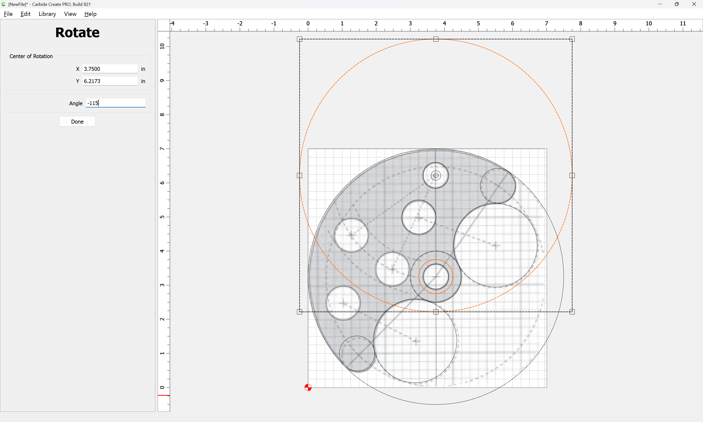

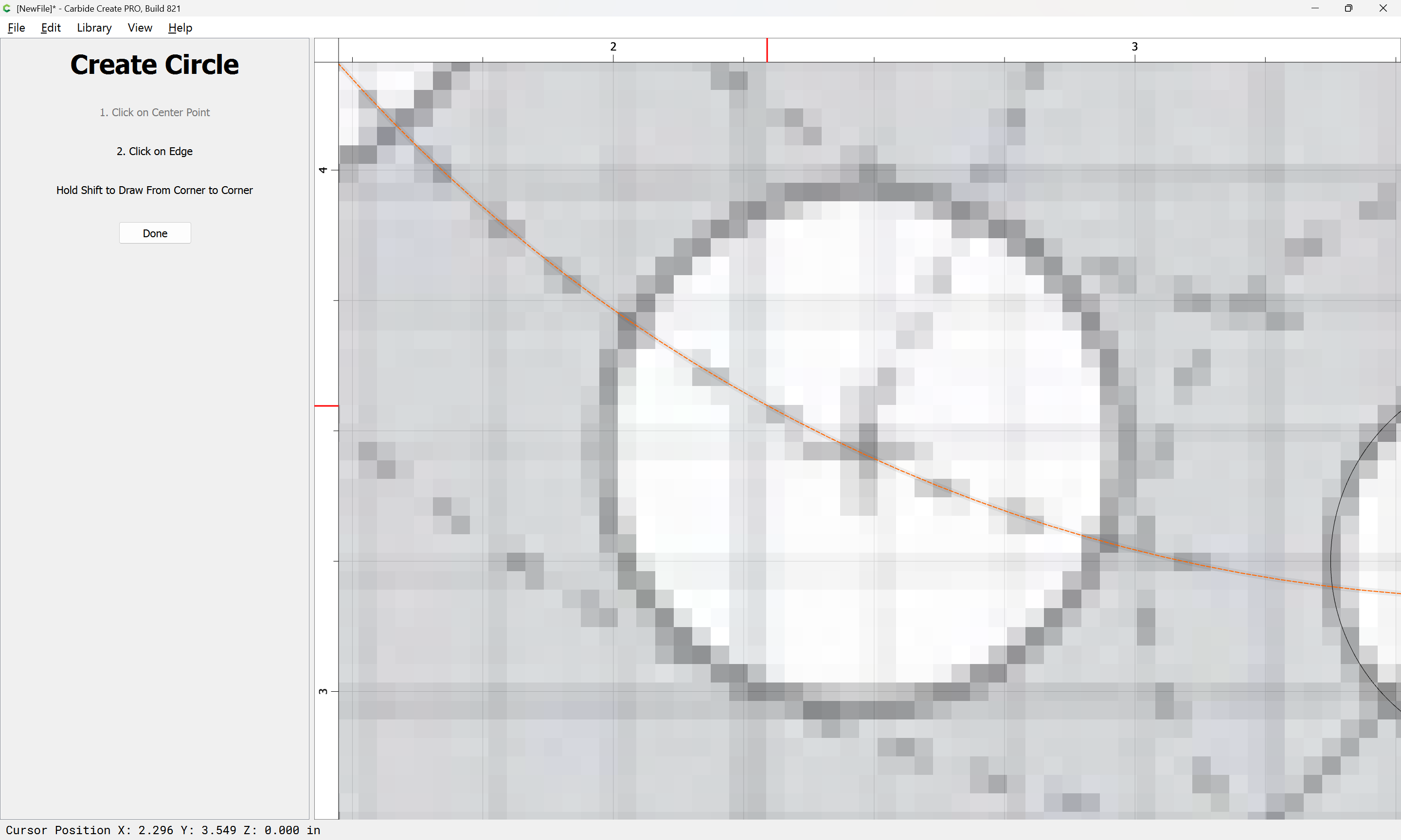

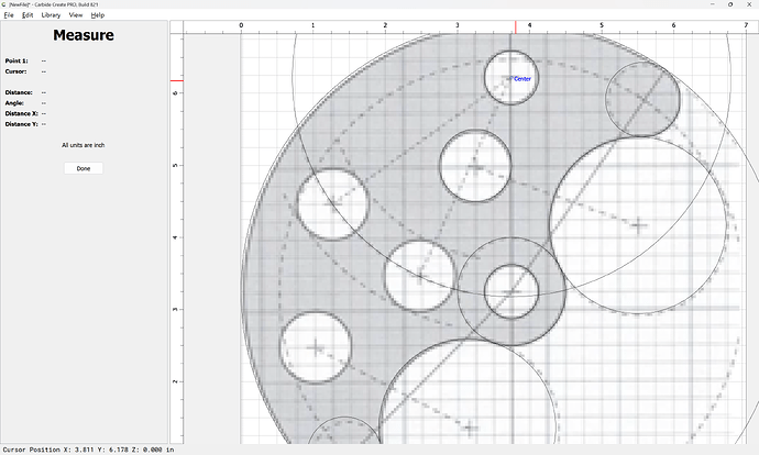

Note that you can use the Measure tool:

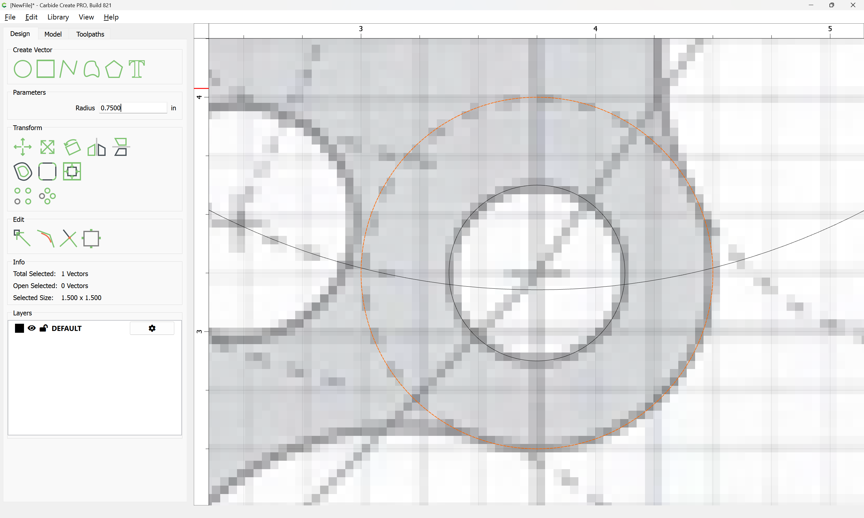

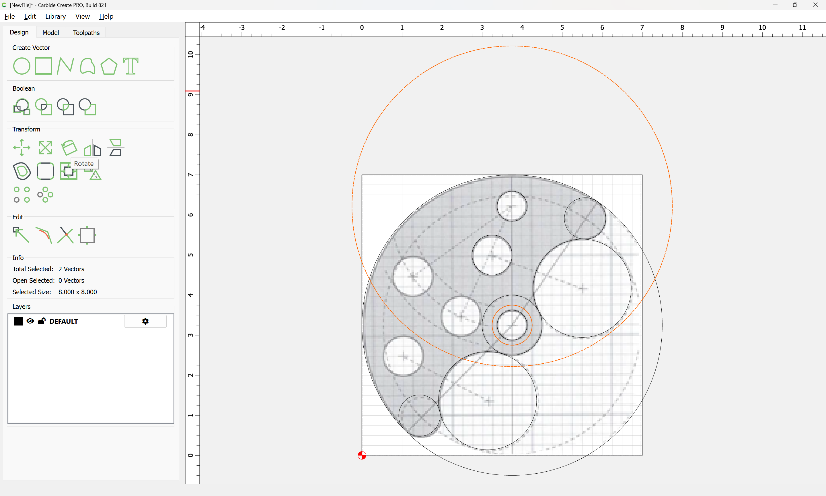

to get rotation and so forth — you’ll just want to increase the radius of the circle so that it is sufficiently larger:

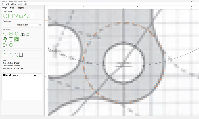

Then draw in a circle of the appropriate size:
and position it at the beginning:
and then use the larger circle:
to rotate:
Repeating this for each other instance:

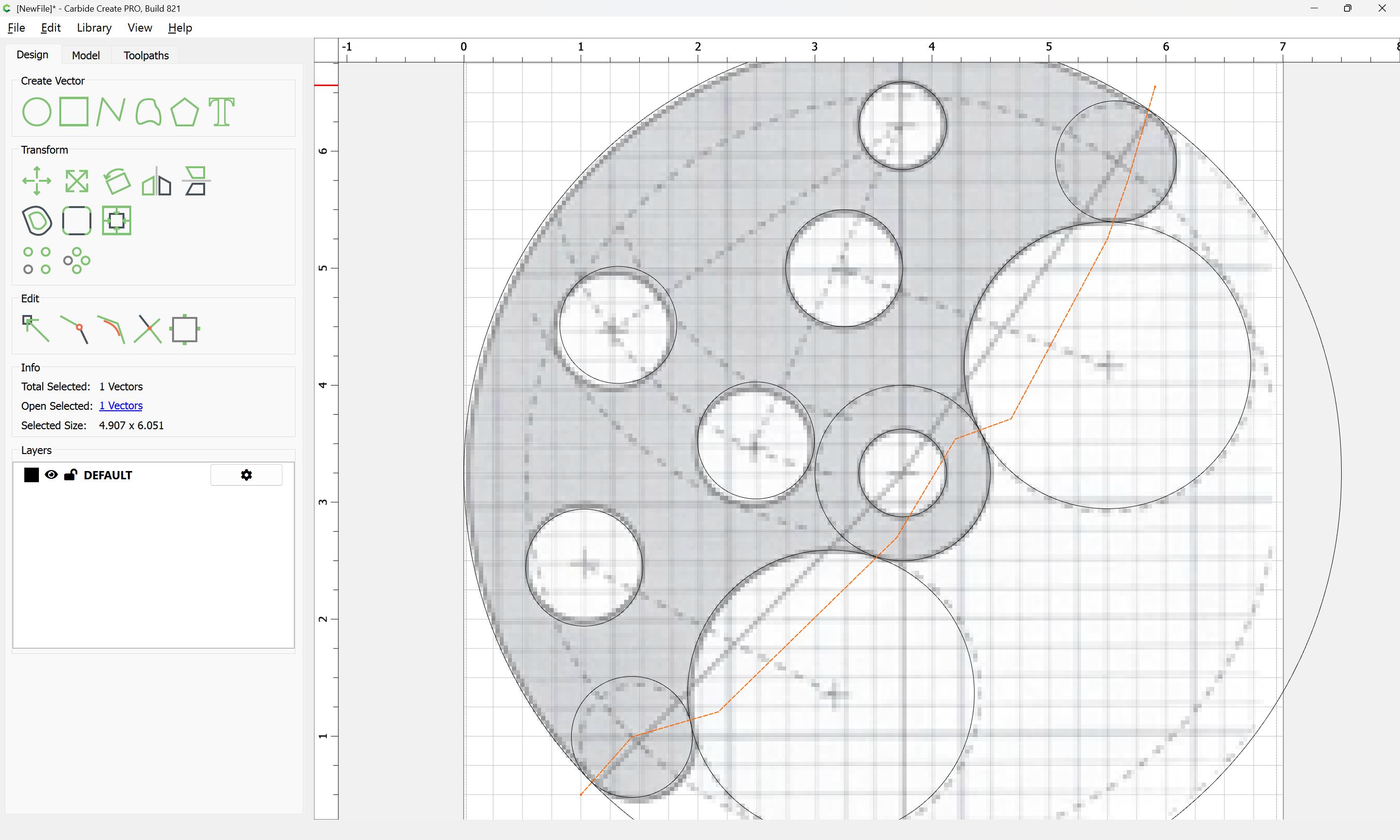

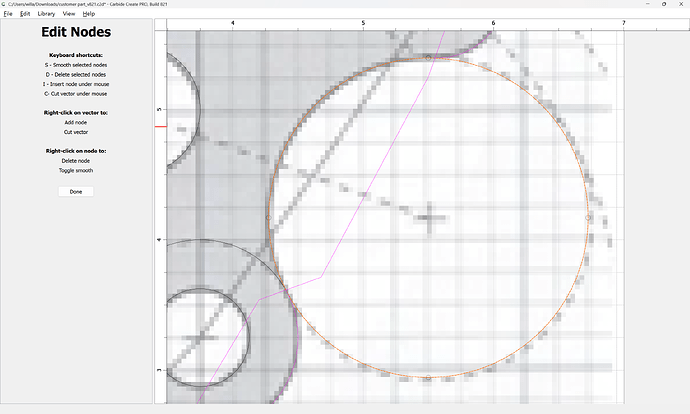

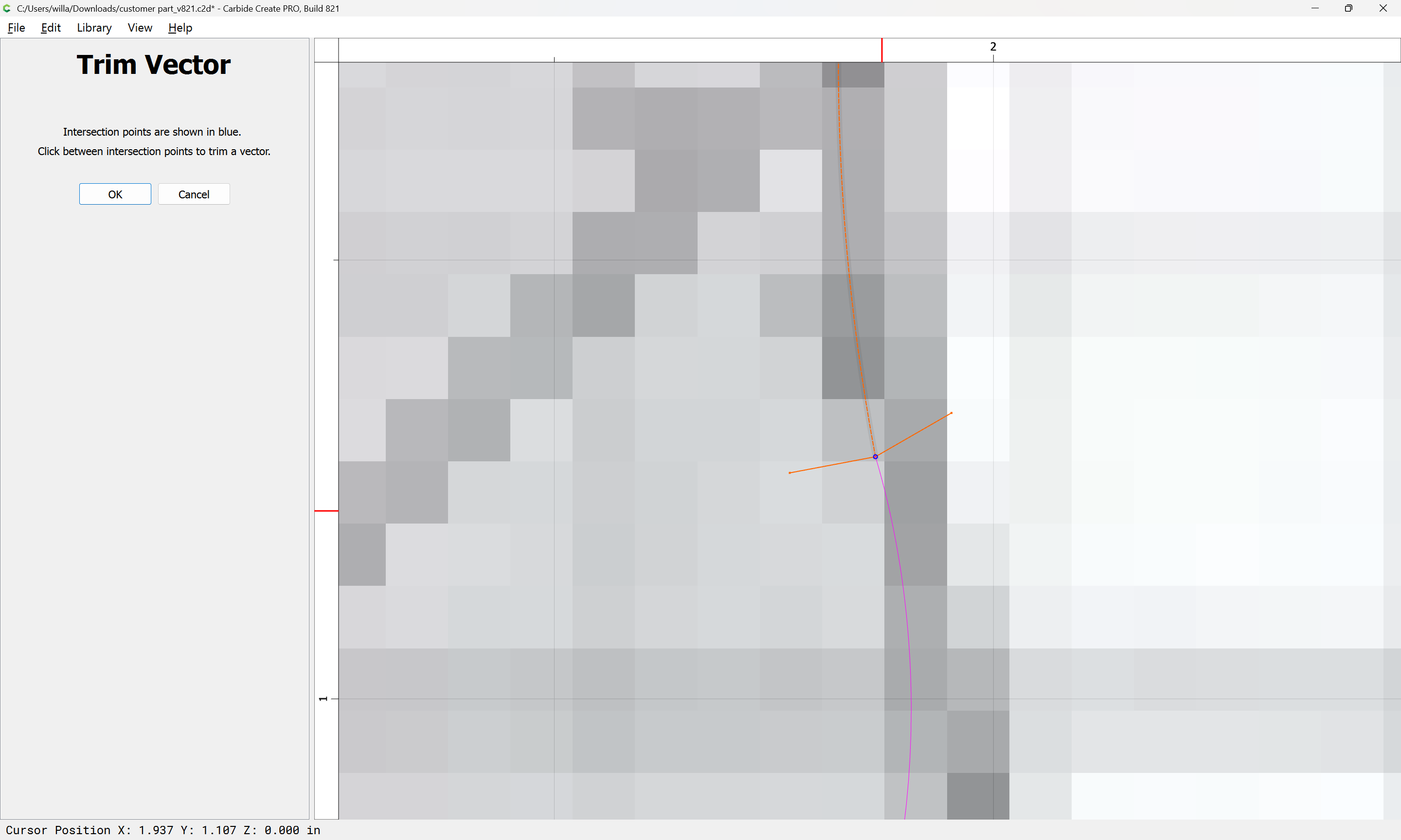

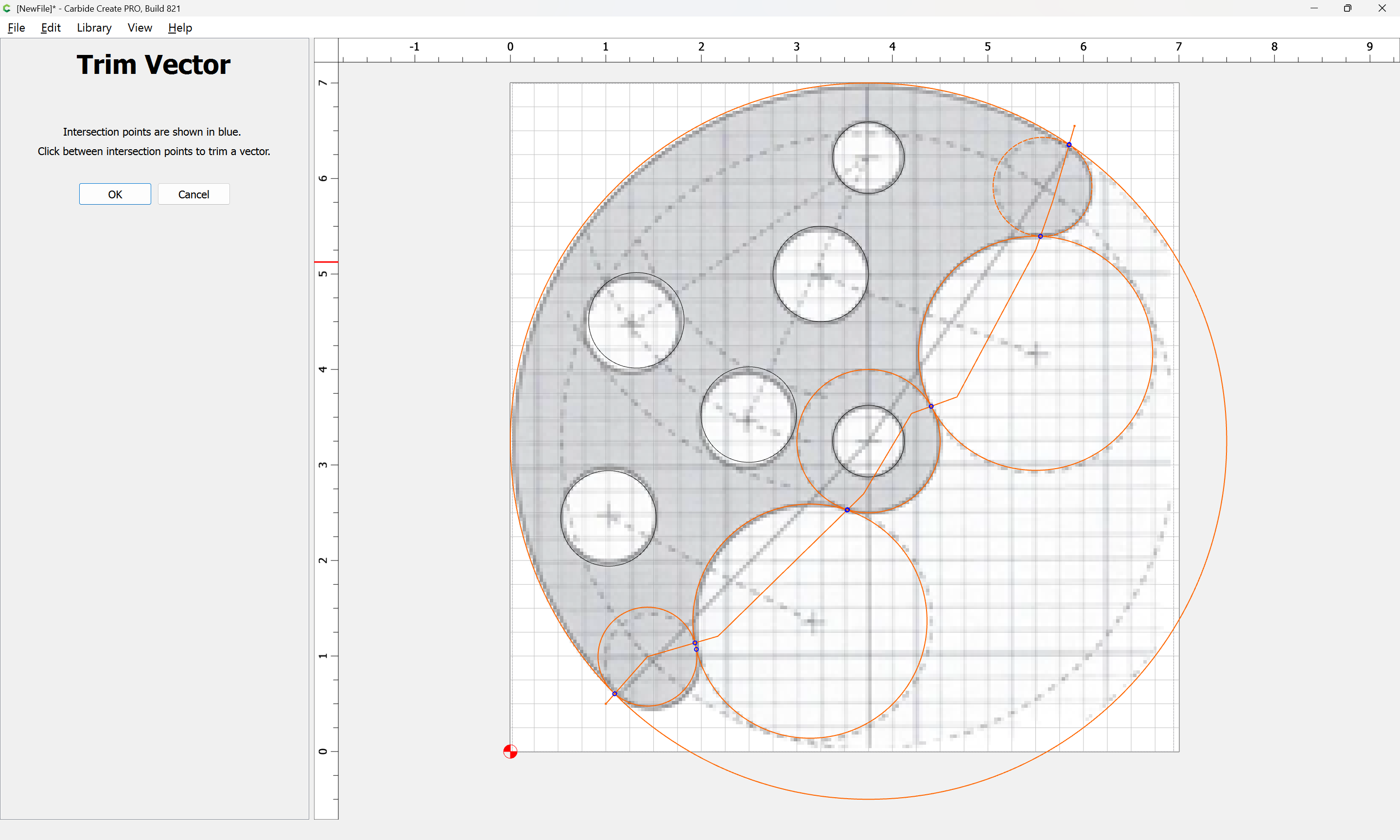

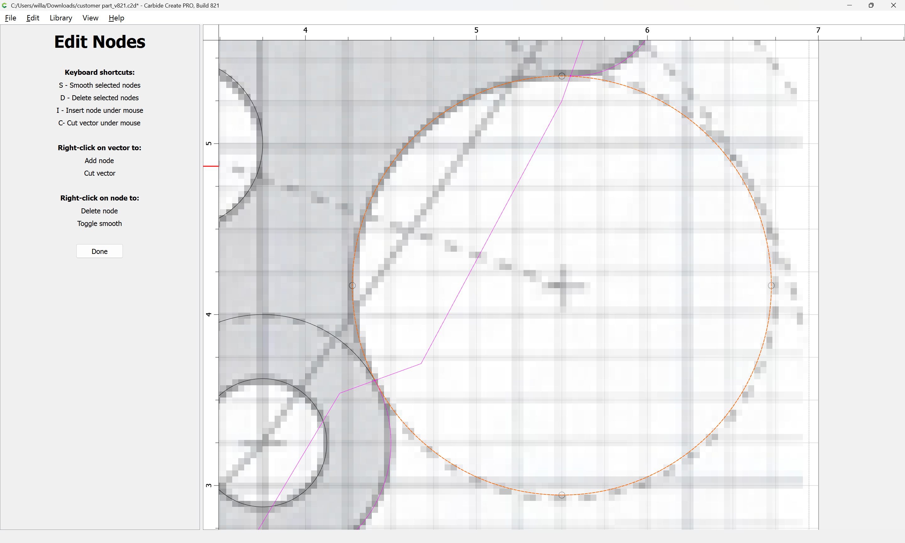

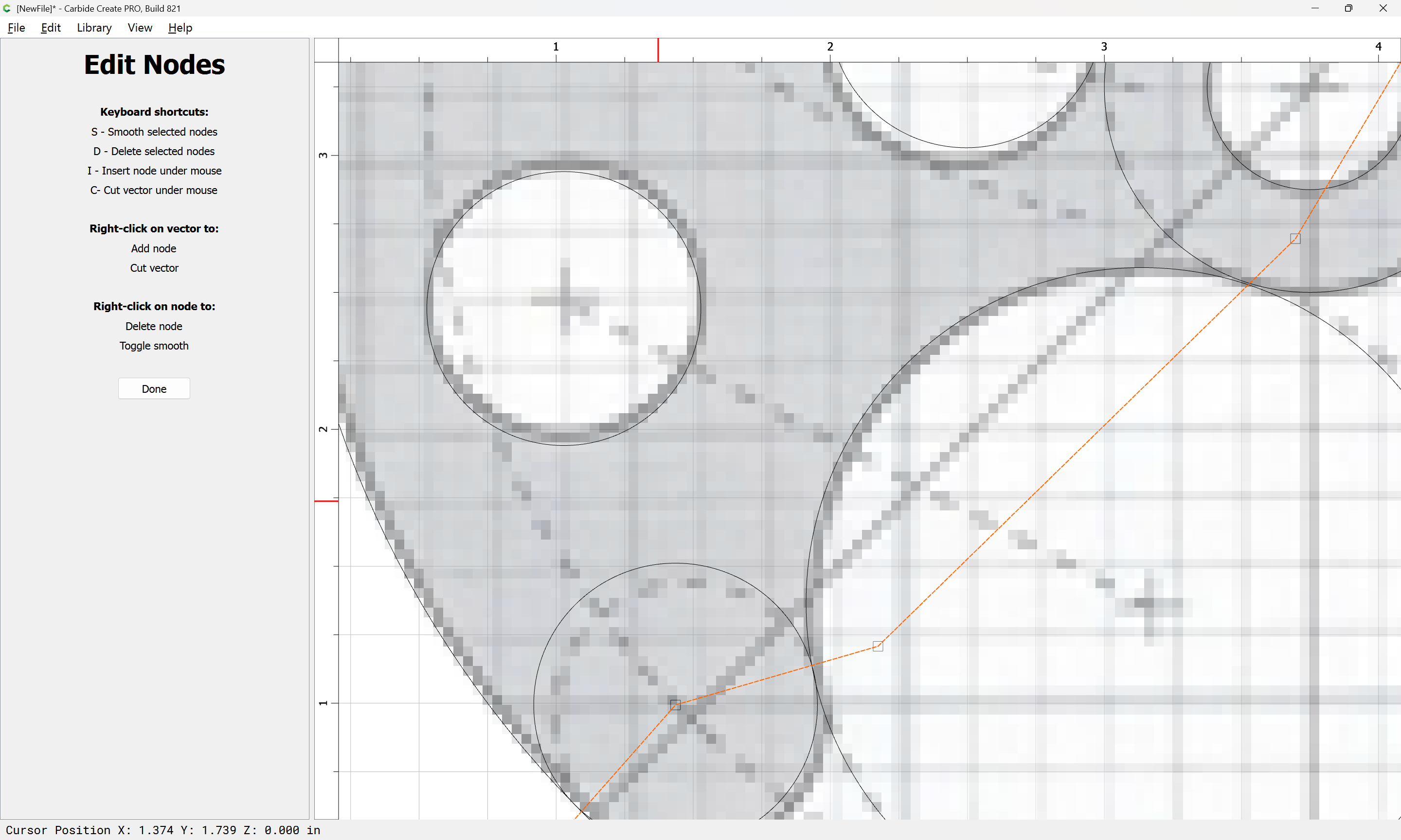

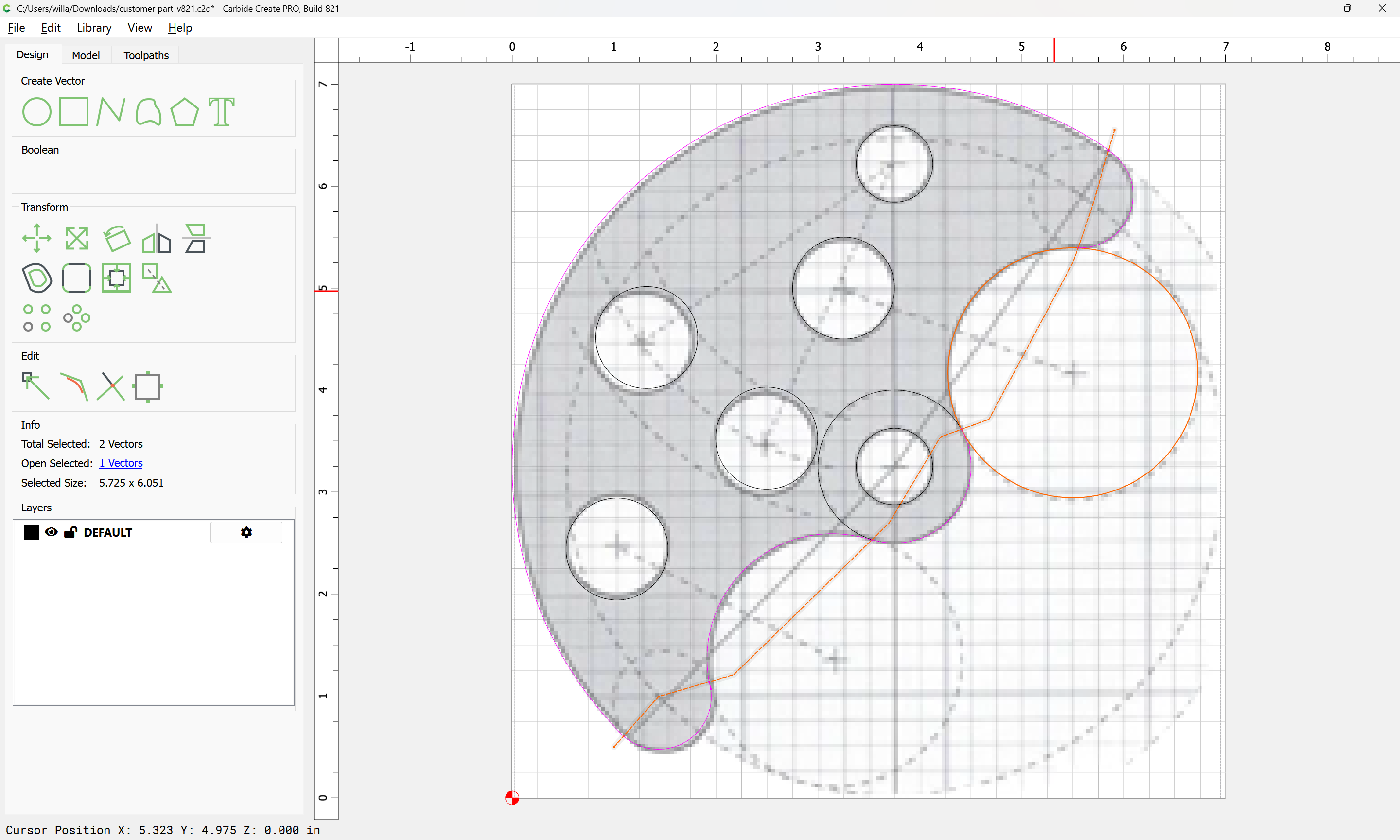

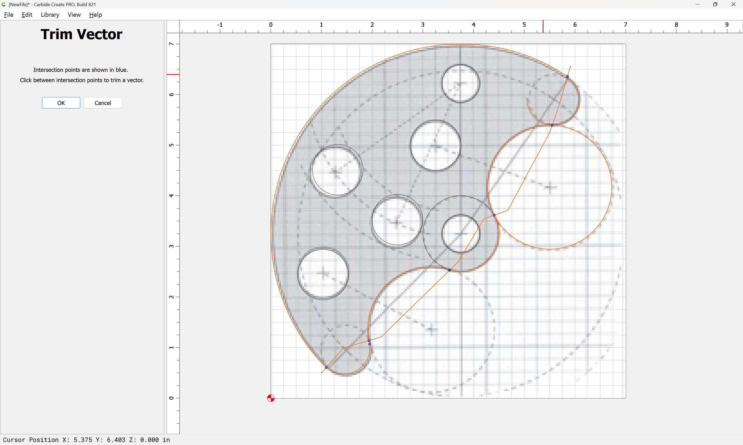

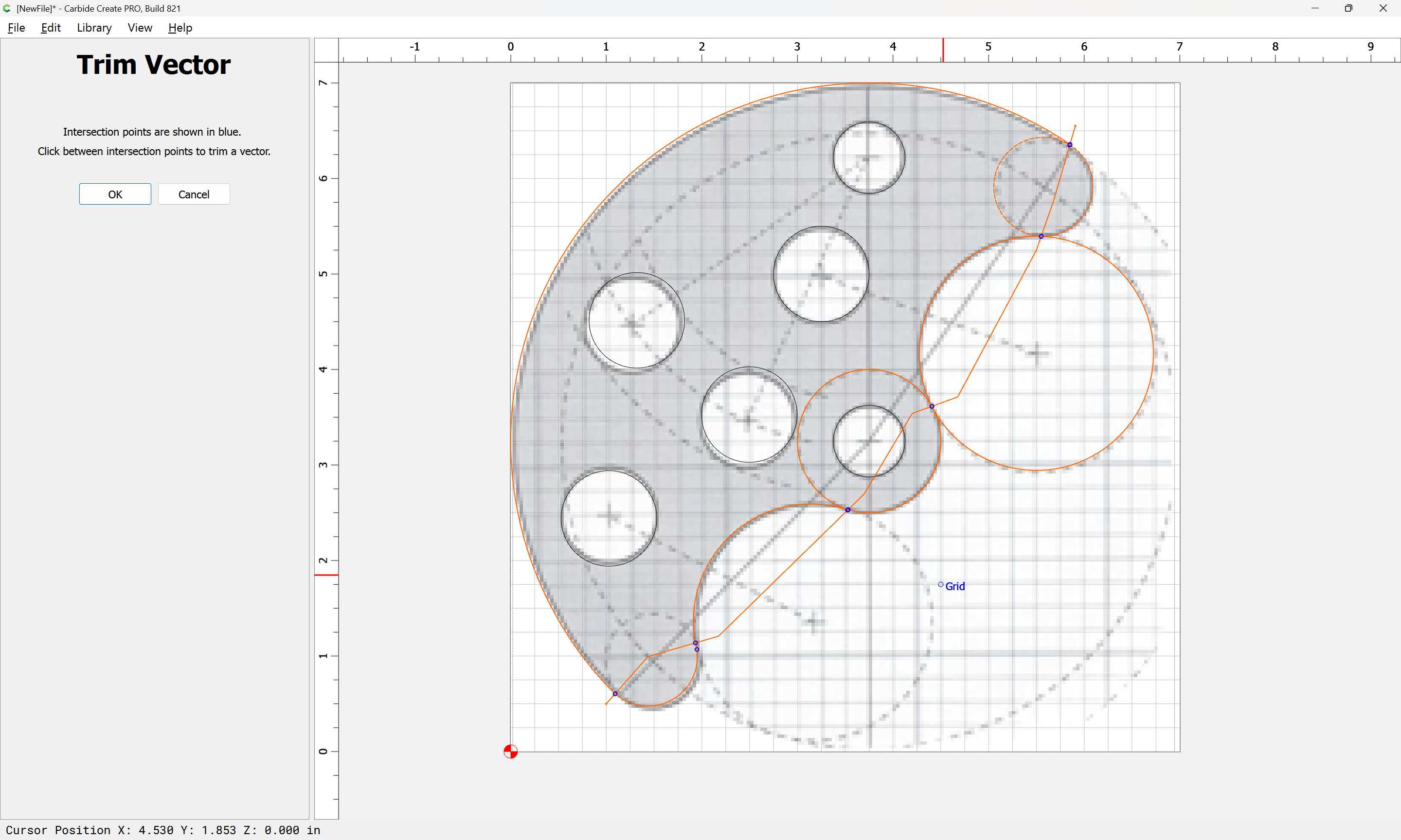

Once one has all the circular geometry drawn in, then draw in a polyline to define each point of intersection:
adjust as need be using Node Editing:

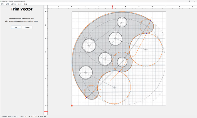

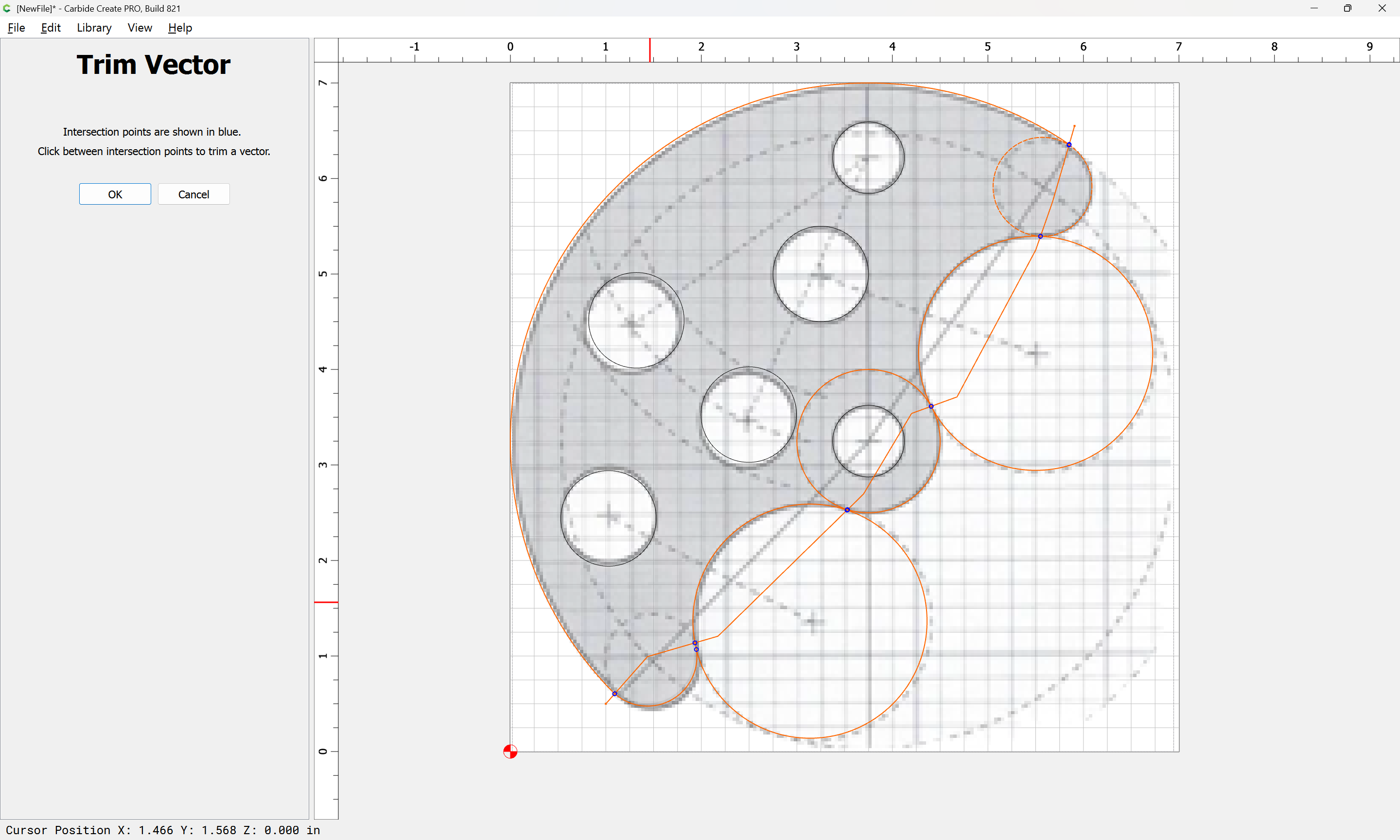

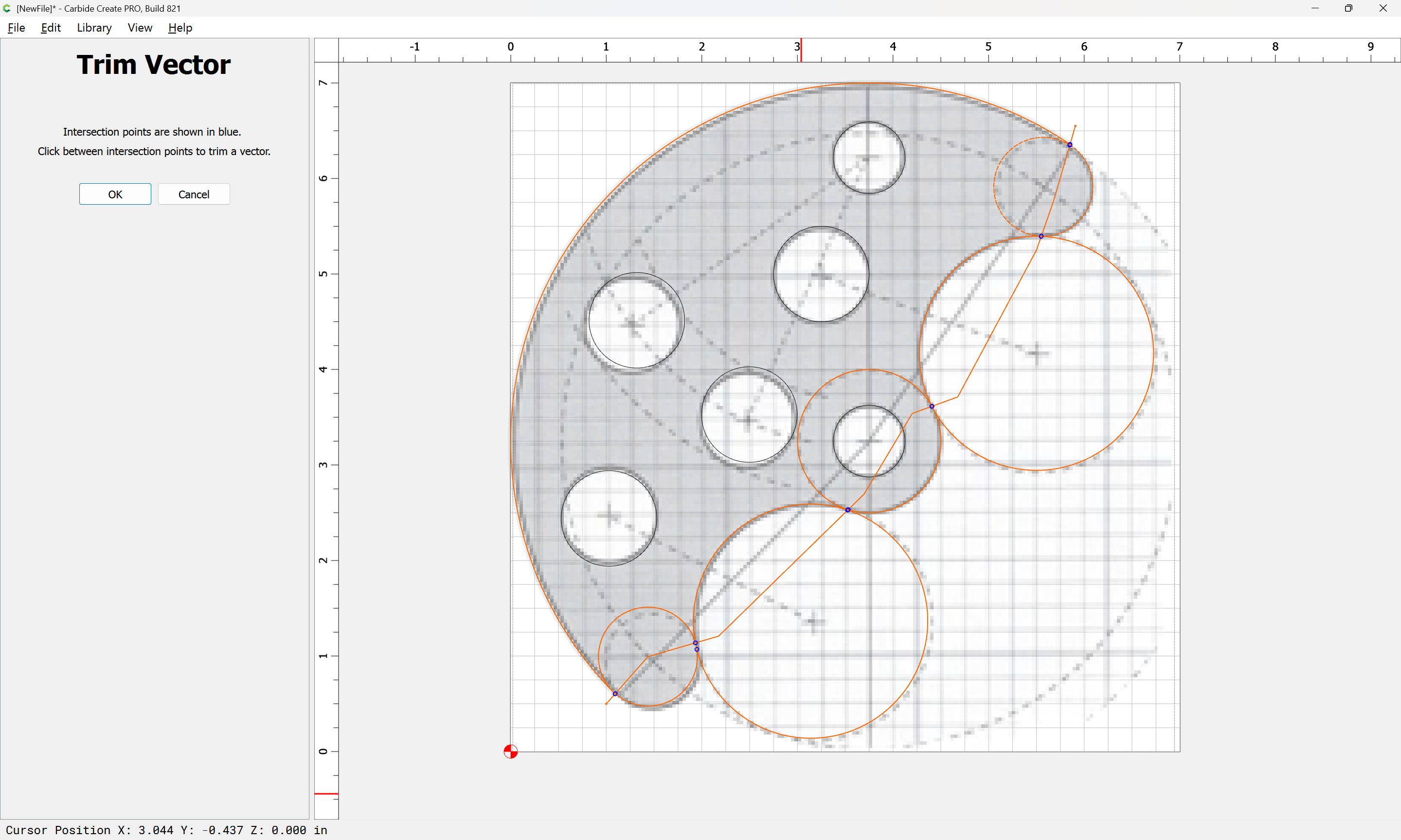

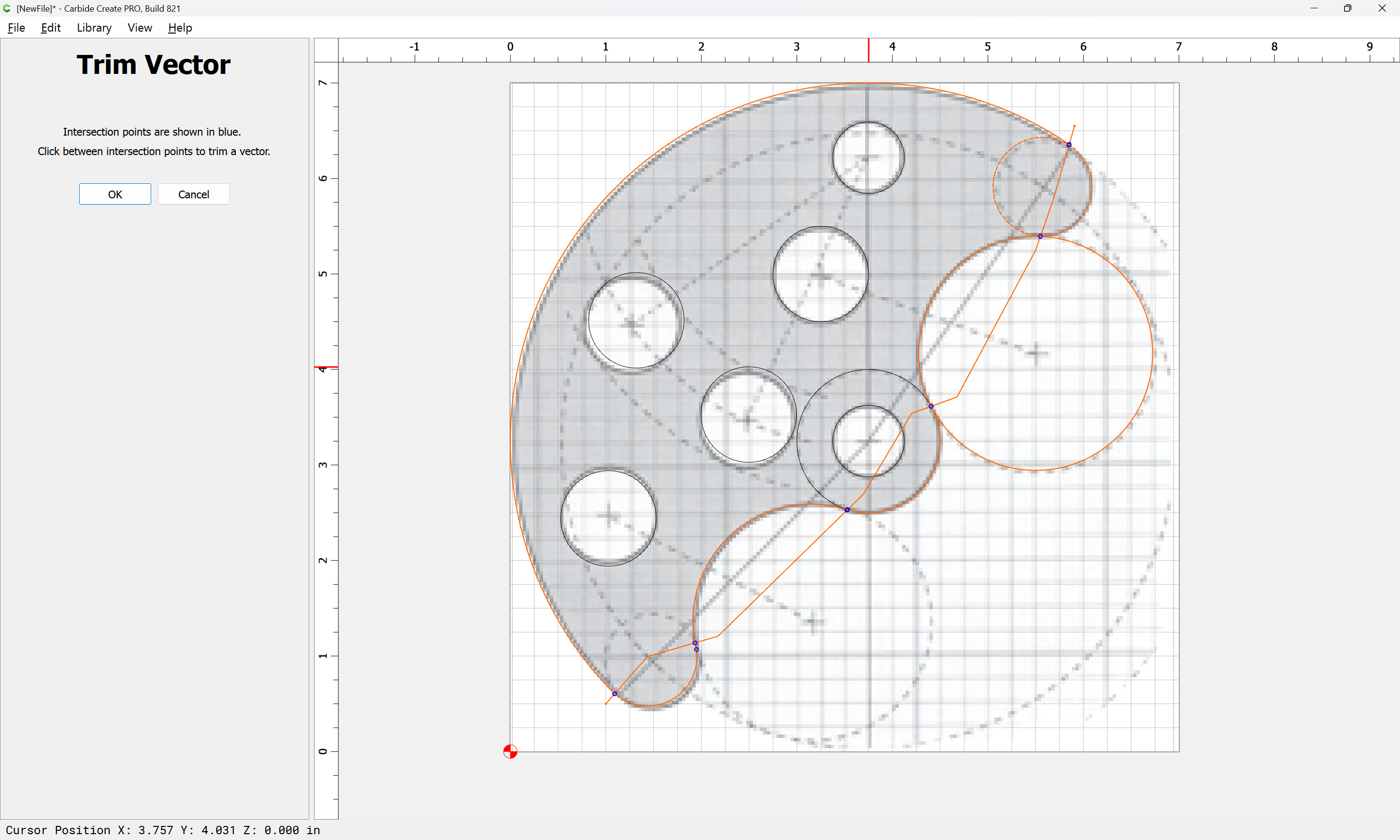

Then select the geometry in question:

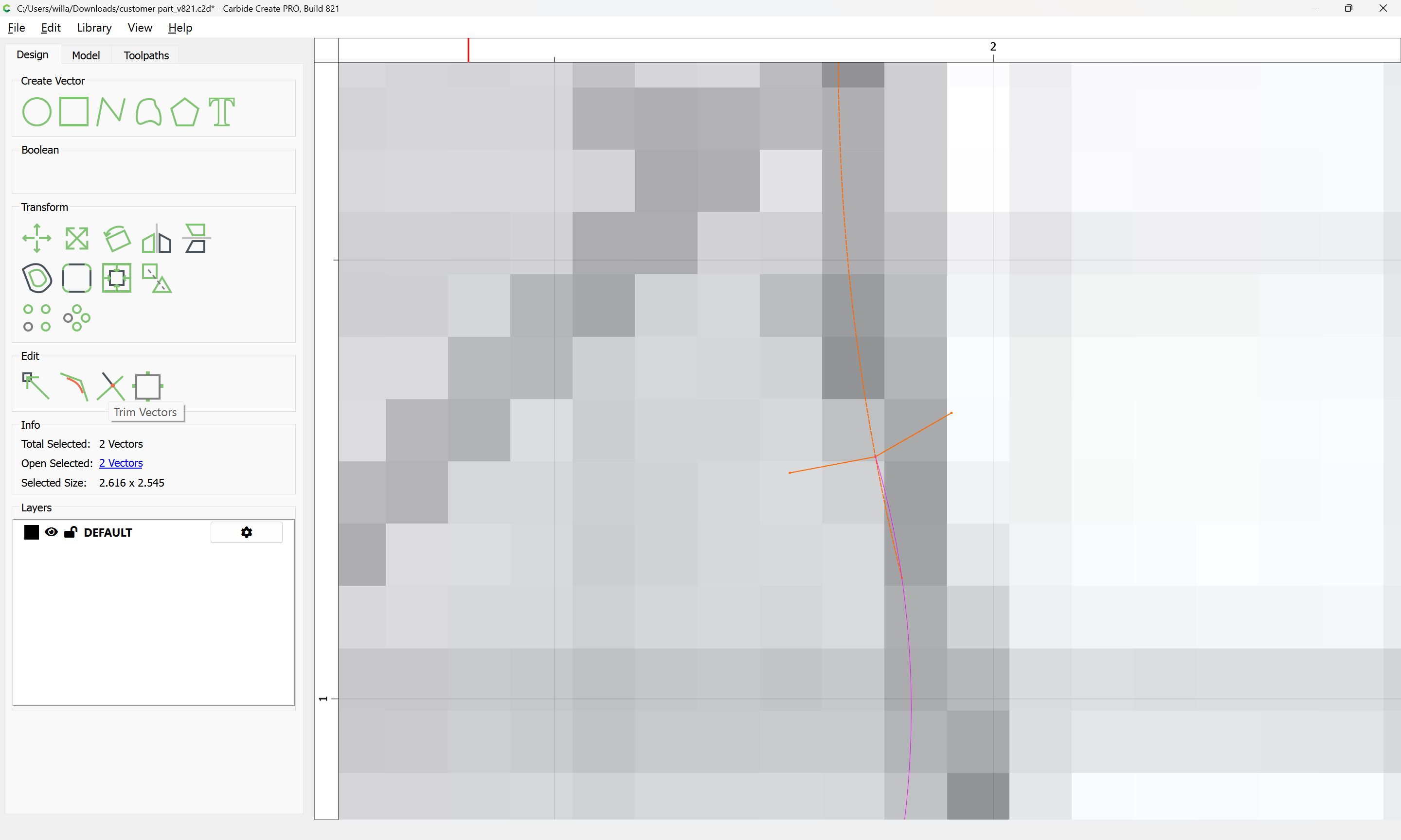

and use Trim Vectors to cut it down to only those parts which are wanted:
If need be click Done and reselect only what is not yet trimmed:
(or re-draw, or Node Edit)

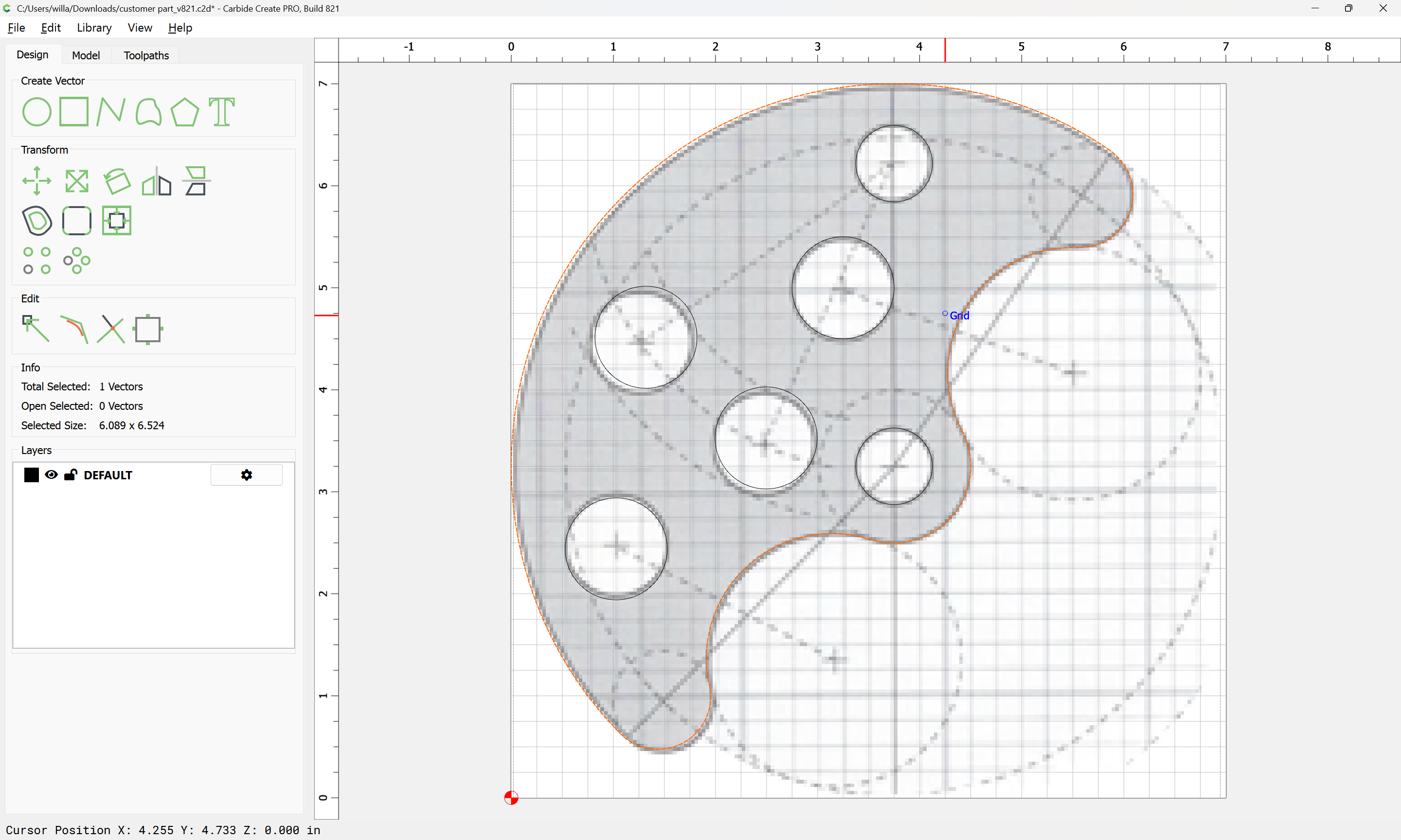

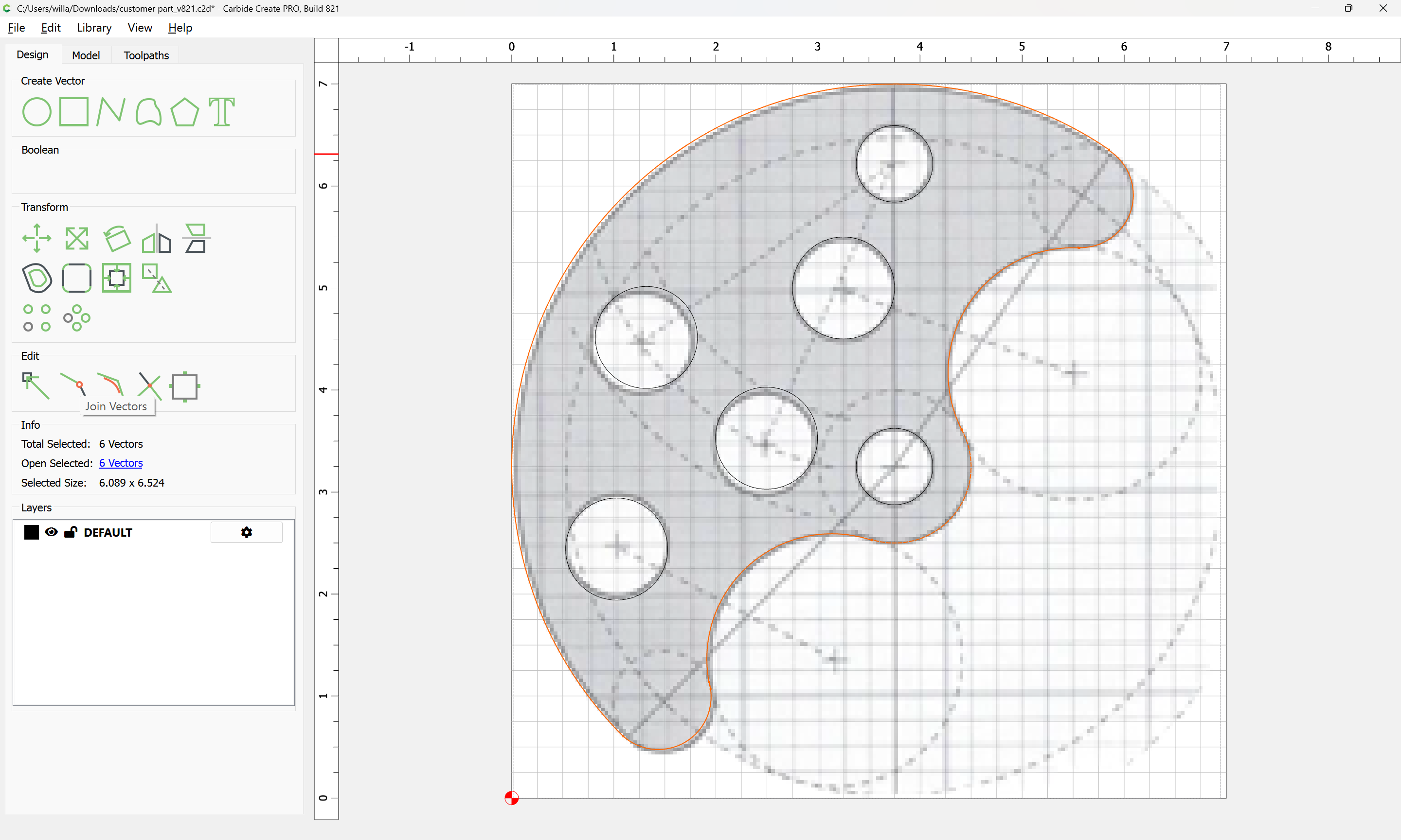

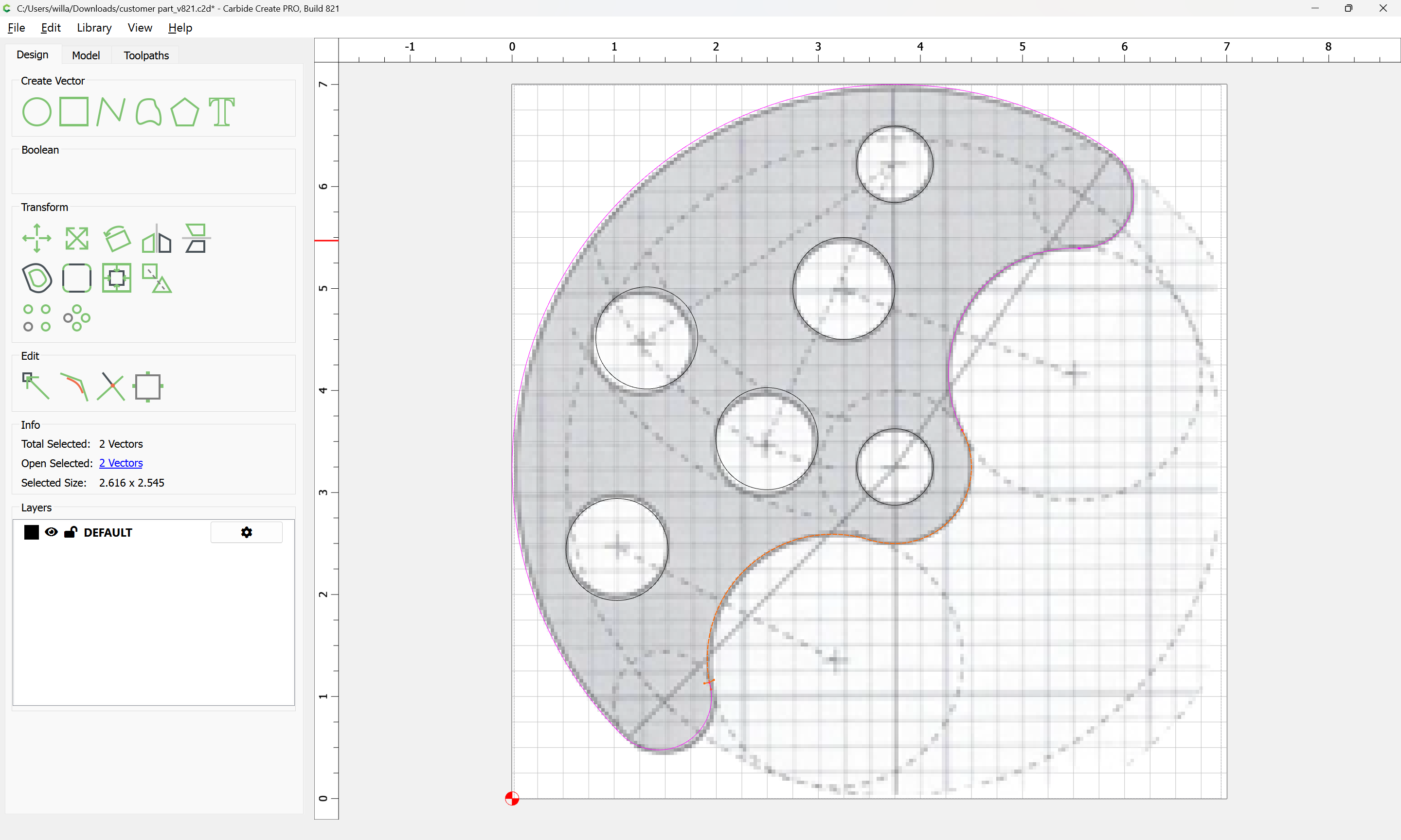

Eventually one arrives at:
and the polyline may be removed and the trimmed geometry selected:
and Join Vectors used to close:
Yes
If need be, draw in geometry to trim again:
Attached as a v8 file.
