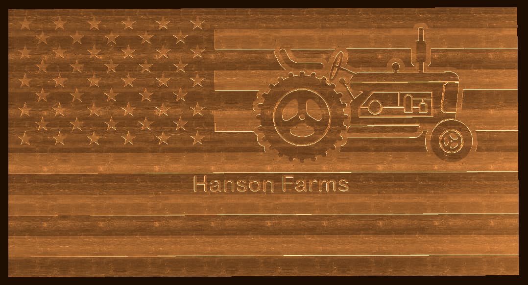

Made for a customer who will use it as a gift.
Original request
It went through several design iterations…
Based on the original request
So I removed the names, and added a tractor
Final design approved.
19" x 36", so it’s going to require tiling. I did use the tiling feature, and set it at 20" so the overlap was between the tractor & the union.
I did a couple test cuts with the scrap to see how it cut, and decide what to do with the edges
On the machine
I did the first cut with the 1/4" endmill, then the 2nd with a 90° downcut V-bit.
On the 2nd tile, I left the V-bit in & cut that path first, then did the clearing path last.
I did get a slightly better result cutting with the V-bit first.
A good hard brushing with a stiff nylon scrub brush got rid of the ‘fuzzies’.
Finished product is 1/2" Walnut plywood with several coats of lacquer.

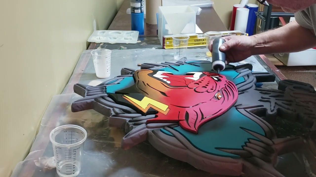

This piece is done on Shapeoko 3XXL with basic Carbide Create. Base is 3/4" MDF, and the layers are 1/4" MDF. After the barbed wire was cut, i used a pointed roundover bit on the edges to give it some detail. The perimeter side edge was hit in random pattern with angle grider to give it a distressed look. After it was all painted it was flooded with clear epoxy.
Cougar Ink / Brad’s Custom Signs
