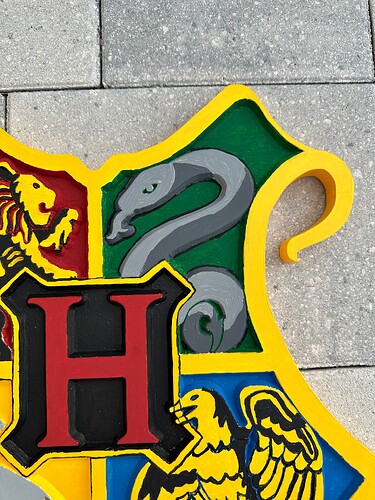

Harry Potter Hogwarts Crest
For Christmas I made the Hogwarts Crest for my daughter to display with her wand collection. She is a Harry Potter fanatic, so this crest will make a great addition to her growing wand collection. I found an image of the crest and used carbide create to trace the image.
I used birch plywood with an advanced v-carve tool path. Used 1/4in end mill then switched to a 60 degree v-bit to finish up. Then used 1/4 end mill for the contour cut out path.
I cut of the tabs, gave it a quick sanding and cleaned up some of the fuzzies left behind. I used white acrylic paint for the first coat. Then used the appropriate colors for each house and also painted the back yellow.
Things I learned: I am not very good at painting. Trying to do the feathers on the eagle was hard for me with my severely limited painting skills. I liked the way the crest turned out, and my daughter is thrilled with it.

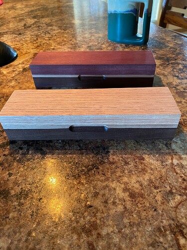

My gift project is a pair of knives and display boxes for our son and son-in-law. Inspired by knife scale projects posted in the forum in the past year I thought I’d try some made from epoxy.
All work done on a standard size Shapeoko 3
Design and tool paths using CCPro 764
CAM CM Beta 622

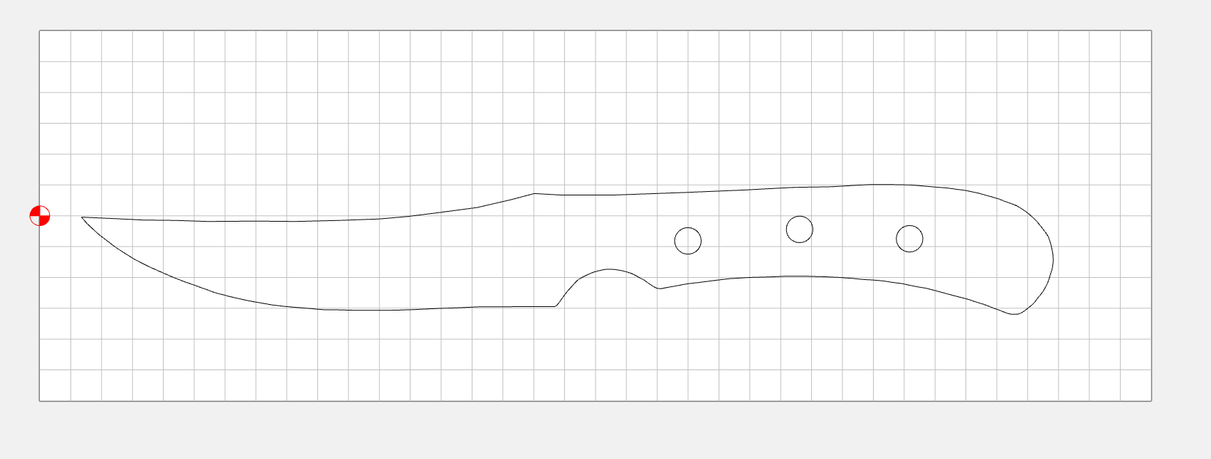

The process is fairly straight forward.
Scan your knife blank at 96dpi or as close to that as your scanner will allow. I used our Epson printer / scanner. Import the scan to Carbide Create and use the Trace function to get a vector to work with. Using Node Edit and Scaling you should get a vector for a test cut in a piece of scrap wood. You’ll see where you need to make node adjustments in your vector after a test cut. The picture below shows the pin holes for the scales enlarged to a diameter of .245”. Exporting and printing your vector image with the printer may be an option, I just didn’t think of that at the time.
Duplicate your working vector (maybe a couple times) in CC and save those off to the side. Decide what area you want the scales to cover on the knife blank, trim your vector accordingly and duplicate. Save the duplicate off to the side or on another layer. That gives you the outside contour of your scale.
I cut my scales from a block of epoxy my wife and I poured with the block being just over 1/2” thick. The contour tool path used to cut the scales blanks from the epoxy block was changed to a pocketing tool path to make a holding fixture for the scale blanks. The tape and glue method held the scale blanks in place for machining.
I wanted the scales to be replaceable. To make that happen I drilled out the pin holes in the knife blanks to accommodate stubs. The studs and screws clamp the knife firmly between the scales.
The scales blanks were flipped over and the tool path for the grips was applied. A drilling operation with recesses for the bolt head and nut were also ran at this time. The scales were attached to the knife blank and a little sanding was done to fine tune the fit around the outside of the knife.

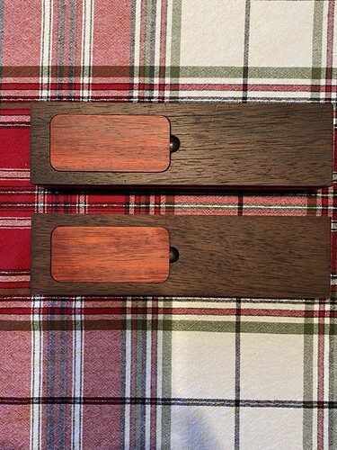

The boxes were pretty easy having the shape of the knife already modeled. The lower half of both boxes are cut from Black Walnut. The fop of one of the boxes is a combination of Purple Heart and Cherry, the other Oak and Cherry. The scale models were inverted to create the pockets on the lower and upper half of the boxes. There is a shallow ridge and pocket to help keep the two halves of the box aligned along with 4 magnets holding the two halves together. The bottom half of the box was flipped over and a pocket was cut for a sharpening stone compartment. A compartment cover was cut from Paddock and is attached with two magnets.
Mistakes and lessons learned:
Don’t count on two of the same knife blanks being exactly the same.
Don’t count on them being straight.
Save your work often and save an updated back up file.
Cut your work in scrap lumber first, even if you have to glue up a few pieces.
Never pour a 1/2” thick block of epoxy at one time, it takes forever to set up.
