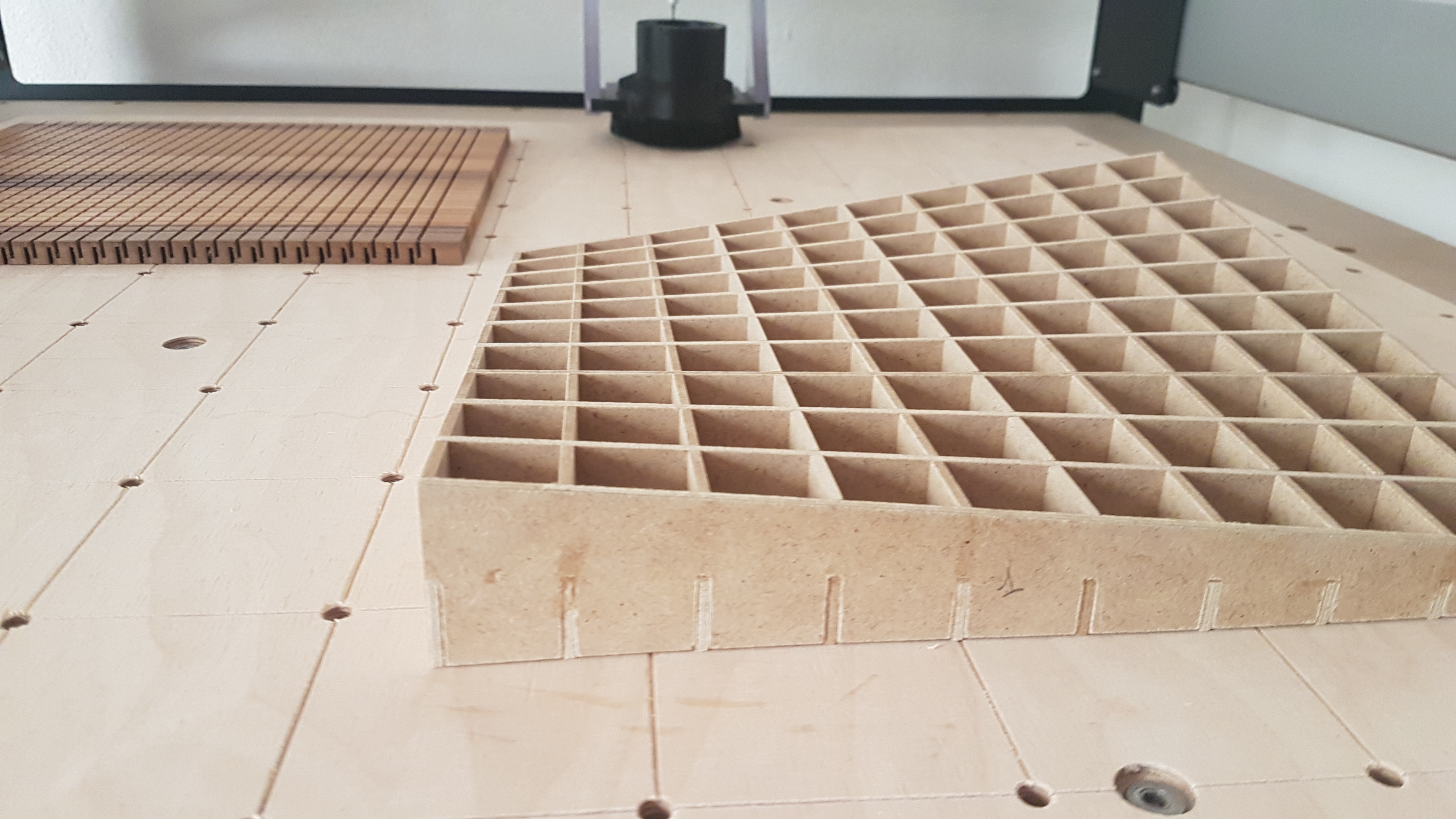

Hi, everybody,
I made a decoration for my house. (a frame)
I put it in two times… I looked for a shape that I really liked, in the shape of waves, but a little too pronounced for what I wanted to do.
So I made a frame with a simpler shape, but that I could fix “a soft wood” on it. that the cladding be constrained in both directions of the wood. In French we say gauche…
Then I had the idea to introduce a led ribbon inside. to make it more fun, and more trendy :wink:
the frame is in 3mm medium, “soft wood” in walnut. I made all the drawings on rhino, and made the machining on CC.
plancher tordu.c2d (772.3 KB)
ossature1.c2d (204.6 KB)
ossature2.c2d (203.6 KB)
recto.c2d (112.7 KB)
verso.c2d (115.2 KB)

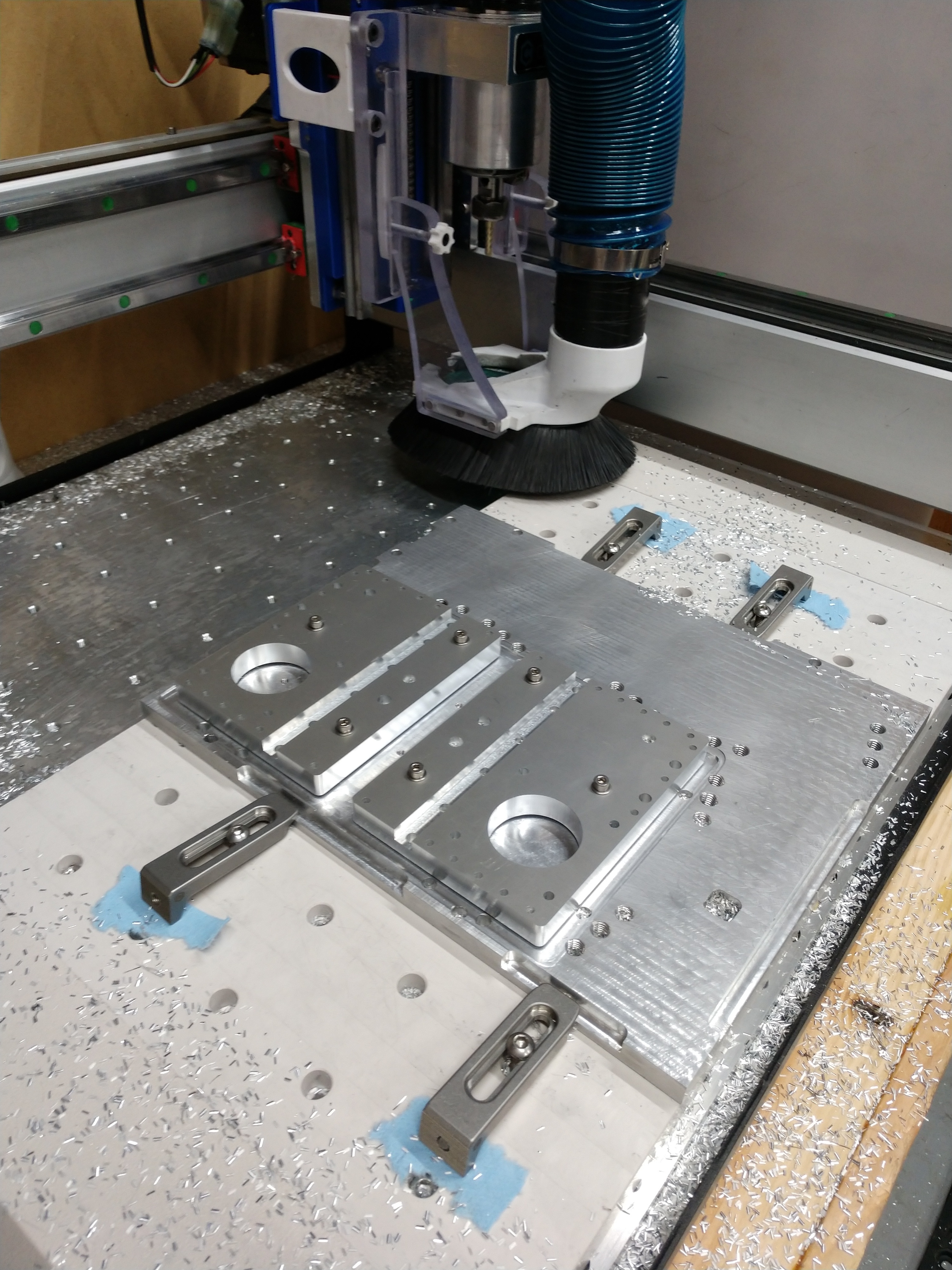

Not exactly the submission I was hoping to do, wanted something more “artsy” but just hadn’t had the time. So, I figure from seeing @BartK’s post, it encouraged me to just post what I have been doing, as it is 2D plates, that assembly in to a “3D” part. I have already shared the design files of my SO3 linear rail adapter plates but never really went into the CAM and workflow I go through. This is also the first time designing and using fixture plates (not just vises and drilling holes into my HDPE spoil board) to help develop faster and repeatable setup time (Typing this now, I am wondering if there is going to be a “fixturing” contest in the future from @Julien :laughing:)
Originally, I wanted to be able to machine two pieces of stock for the 4 (Y Axis) or 3 (X Axis) assembly parts, however I miscalculated how large of a fixture plate I would need and had to improvise a little. So I decided to move forward and just have the fixture plate multi purposed and machine the first set of parts, then re-setup with new stock to mill the second set.
There was at least three setups I needed to do, the first setup was the stock in its rough cut form (5.5" x 9") using fixture pins and side clamps to get access to the top for boring tolerance and threaded holes along with other features (dado joint and motor through-hole).
Second setup required getting access the sides to clear the stock down to shape. Using the existing features of the part, I created M4 thread holes that align with them on the fixture, so once features were cut they expose the mounting points to my next setup.
Third setup is to support chamfering the parts on either side, I used index pins to locate the part in its final form while still using the M4 threads to clamp the parts down, removing the pins before starting the g-code op.
When it came to tolerances, I really don’t have them defined, as for one, I’m not a professional (I don’t know the best method to define them), and in a way it’s in the hands of the SO3 rail lengths and how precise the linear rails are mounted; let alone there is slop designed into the system. However I try to do my best to get as close as possible (<0.005") in the critical areas. To do so, I use gauge blocks and Fusion 360’s “Stock to Leave” to dial in the dado joint. I end up surfacing the Y plates (being typical 6061) to increase flatness and parallelism (indicating on the dado) using a fly cutter on my benchtop mini mill (hope that’s not disqualifying :P). ATP-5 stock would help alleviate this process (though I believe it’s flatness spec is 0.015" at this thickness). I then surface the joining plate until they fit into their paired counter part.
All said and (almost) done, it was quiet the journey filled with frustration, pain and eventually love and happiness :laughing:
The Y fixture and CAM was my first attempt and just is a mess with weird setups from in-progress fixes, etc. The X fixture is a better example too look at and base off :slight_smile:
Linear Rail Carriage Plates
Y Fixture
Y Extrusion Plate CAM
Y Carriage Plate CAM
X Fixture
X HDZ Plate CAM
X Motor Spacer CAM

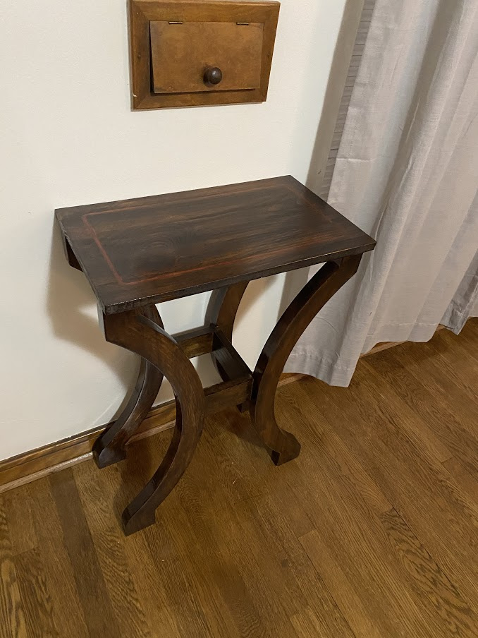

Curvy Entry Table
(all done on Shapeoko. If my wife and I could make this…so can you!)
File: https://a360.co/2Al4Of2
So another honey-do item on my list was an entry-way table to sit under our mail dropbox. This was our first venture into making a piece of furniture (so don’t shoot me professionals… :slight_smile:) The table was to be about 30 inches tall and about 12x20 inches for the table top. After a bunch of googling for some inspiration, we came up with the below model:
I found some big box store 2x12 lumber that would work for the legs. The legs were to be 29 inches tall and I thought making them 1.25 inches thick would be safe (to take out about 1/8” of warp on either side of the lumber). I planed down the 4 rough (and warped) pieces of pine:
The next step was to cut out the legs. I (software) free-handed the contours of the legs and tried to make them a little fancy. I placed a notch in the middle of the legs to fit the middle supports into. I also designed the tops of the legs to part of the joint to connect to the tabletop (with about 30 thou of clearance for each dimension of the joint…probably could have used more like 50 thou and still have been snug):
Next, was to cutout the tabletop. I had some (super cheap) rough bandsawn lumber that I figured I could use:
I just used the ‘poko to plane down (who needs a planer anyways…) and get rid of the bandsaw ridges, and then I had a nice clean tabletop!
I then cutout the holes for the legs to fit into (0.5” deep). We happened to have some epoxy, so I also cut a small groove in the top for a little epoxy accent (0.1” deep):
image image
I then cutout the braces for the legs. Pretty simple there, no issues. We then stained the legs and filled the tabletop groove with epoxy. Next, I held my breath and assembled the legs into the tabletop and placed the braces into the grooves on the legs, and voila!
Finally, we glued everything together and then stained the tabletop and the cross braces. We had to slightly wipe the epoxy rectangle to clear the stain/poly mix that we were using (probably a better way to go about that). The epoxy actually did a decent job of rejecting the stain, so that helped. I thought it’d be fun to show the before and after shot of the wood we used:
Before (boring raw lumber):
After (fun and practical table! we liked how orange/copper epoxy inlay turned out, nice and subtle):
Let me know if you have questions or suggestions for improvement!
Cheers,
Kyle

@dakyleman - Kyle,Beautiful job from big box lumber to an heirloom!
If there’s any chance you could post your files, that would be awesome. I’ve got a cousin that still has a mail drop slot and would very much enjoy making something like this for them.
@MikeG Thanks a bunch Mike! Yeah it’ll hopefully stick around in the family for a while! I’m in my mid 20s so I plan to get plenty of mileage out of it before passin’ it on :slight_smile:.
Awesome, I’m happy for the design to be reused! There are definitely some small improvements to make with the design that I used a Dremel to correct/adjust, so keep that in mind (tolerances on fit-up of the legs, the notches for the braces could probably be improved, maybe make the tabletop thicker, etc).
Oops I forgot one of the requirements of the contest… :sweat_smile: I updated my original post and also put the link below for your convenience, let me know if you have any issues! :
