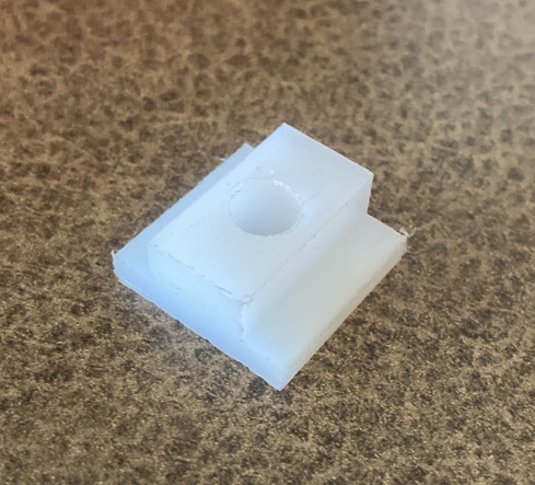

A slider to fix a bi-fold closet door

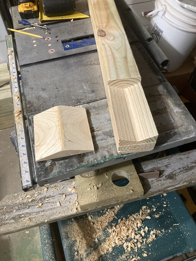

45° cuts for a deck post & backer

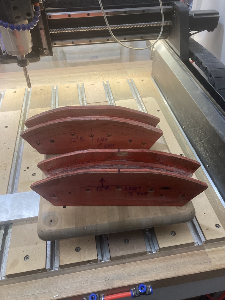

Tube bending dies

While some of the projects I’ve done do have 3D elements. Many of them were done with 2D in CC. Even the prizes were done in 2D. The turning program for the angle was laid out in XY, and I just Replaced Y with Z in the G-code. The sides & bottom were done with manual machining on my HDM. Only the spindle fans were done in NX. The rest were all in CC. (some with 3D).

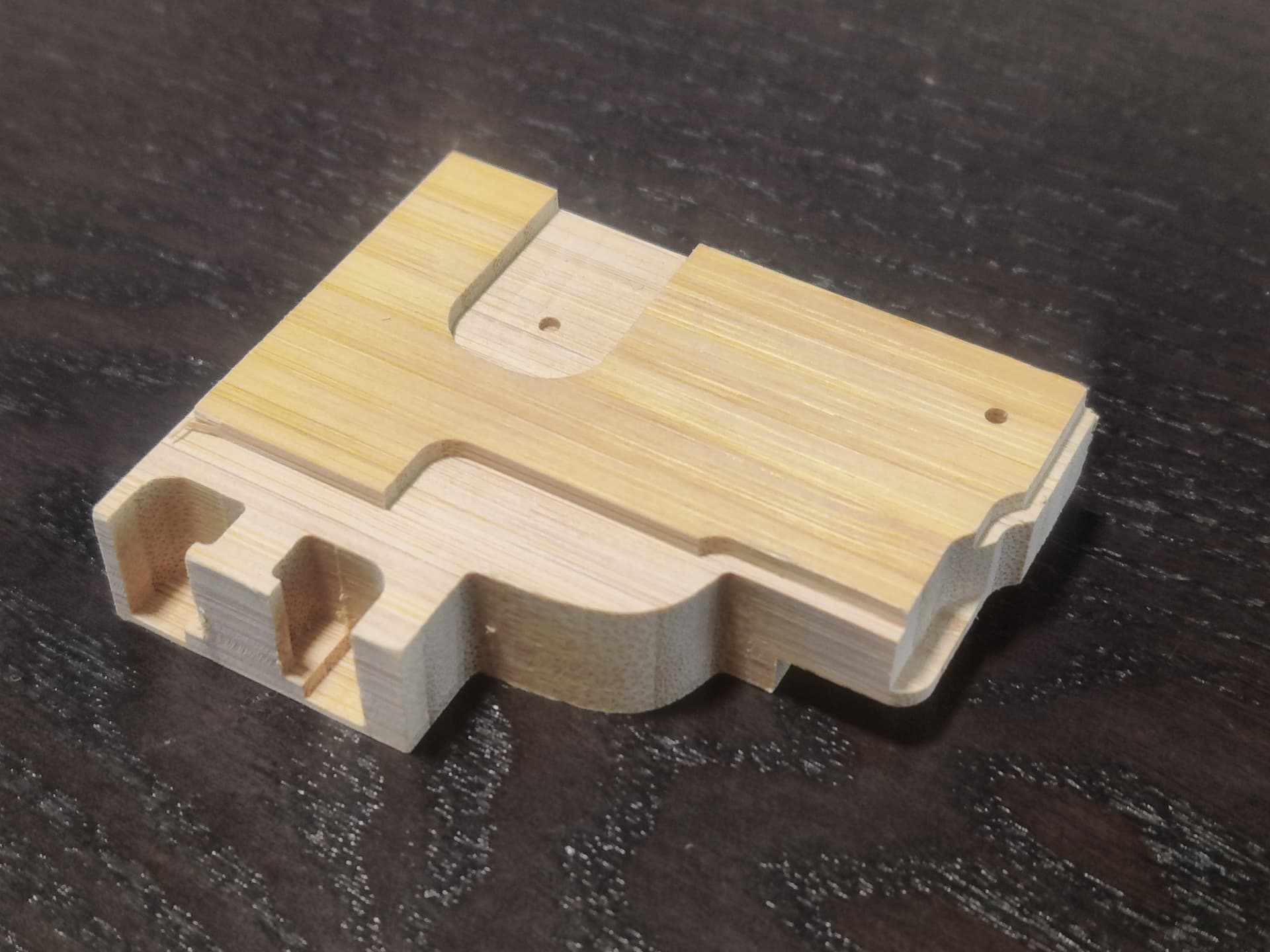

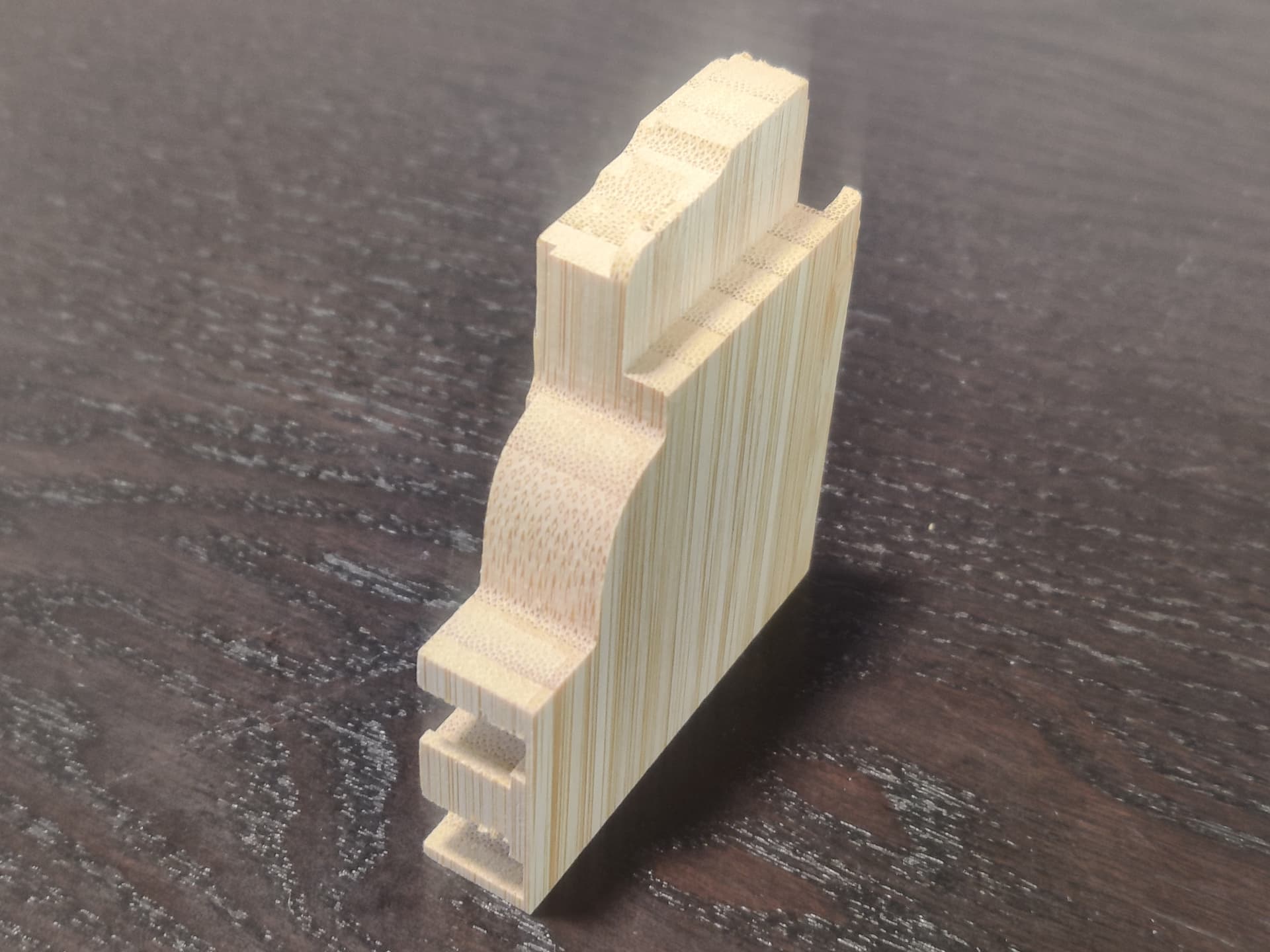

Having spent many years installing IKEA kitchen cabinets, I always found the drawer system really nice except for the fact that the back panels are metal. Therefore, the drawers are impossible to be cut/shaped to customize for plumbing or re-size a drawer width to a non-IKEA size.
Behold the Maximera drawer-adapter bracket!
In stylish bamboo - made from IKEA’s bamboo cutting boards before they made them cheaper & unusable for CNC stock.
Now I can use Maximera drawers anywhwere & everywhere with a plywood or solid wood or plastic back panel sized & shaped to fit the installation.
Nice!!! Exactly the kind of stuff I was talking about. Excellent entry!

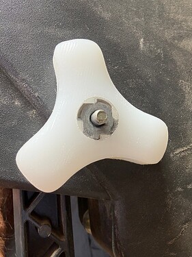

This one is a knob for my old band saw. The old hard plastic knob decided to crumble in my hand one day. This was an easy fix. Both of these two projects were cut from a HDPE cutting board.
knob.c2d (1.3 MB)

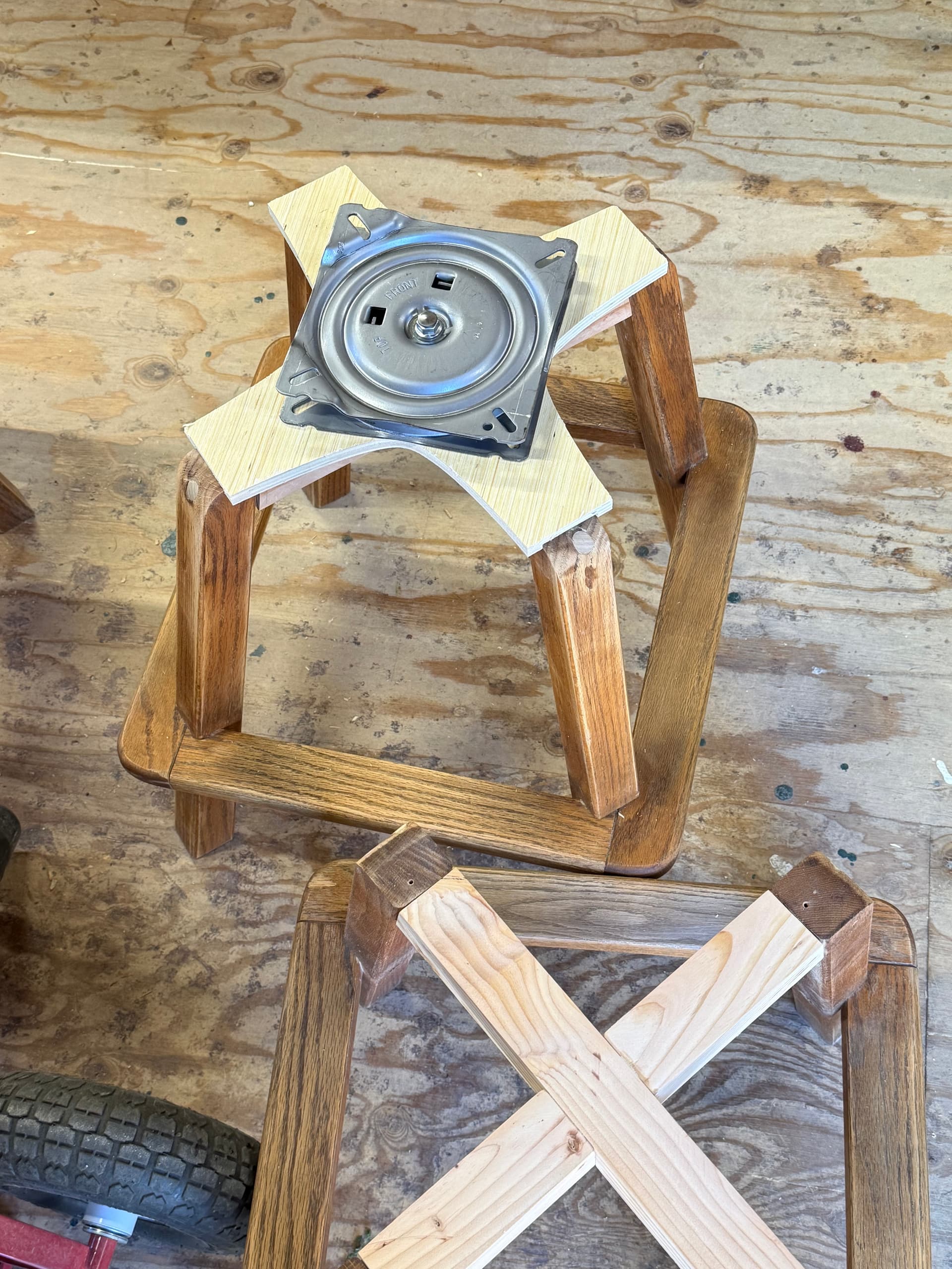

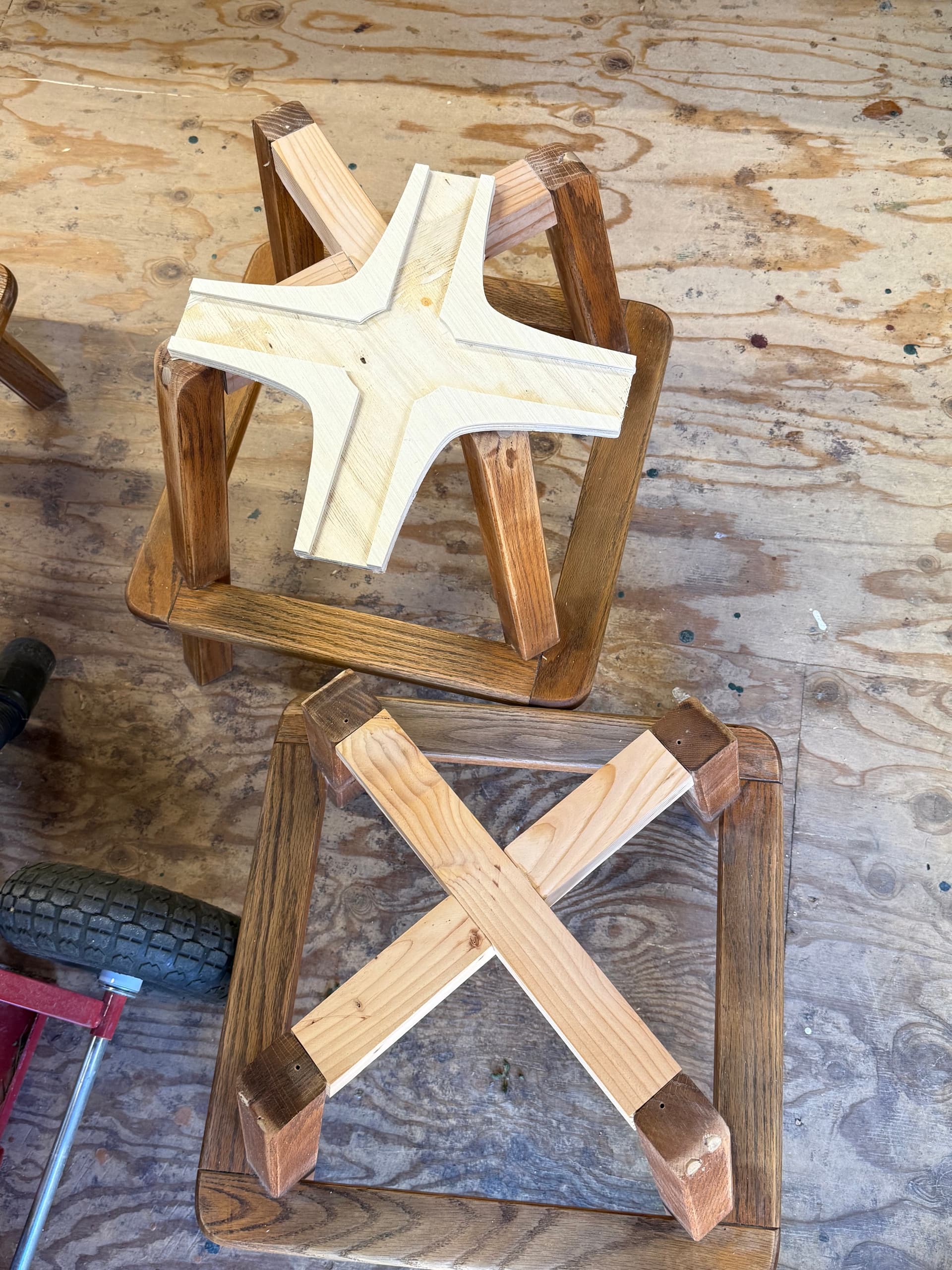

I rebuilt 4 bar stool type chairs earlier this past summer and was looking for a way to tie the top of the leg supports together a little tighter. I made a supporting plate out of plywood that tied the four legs together and was the mounting base for the chair swivel.
upper chair brace.c2d (176 KB)

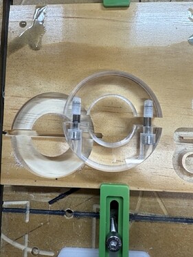

I replaced the trolling motor on my Bass Boat and wanted a quick way to adjust the depth of the motor to a set position. I cut a stop collar from cast acrylic.

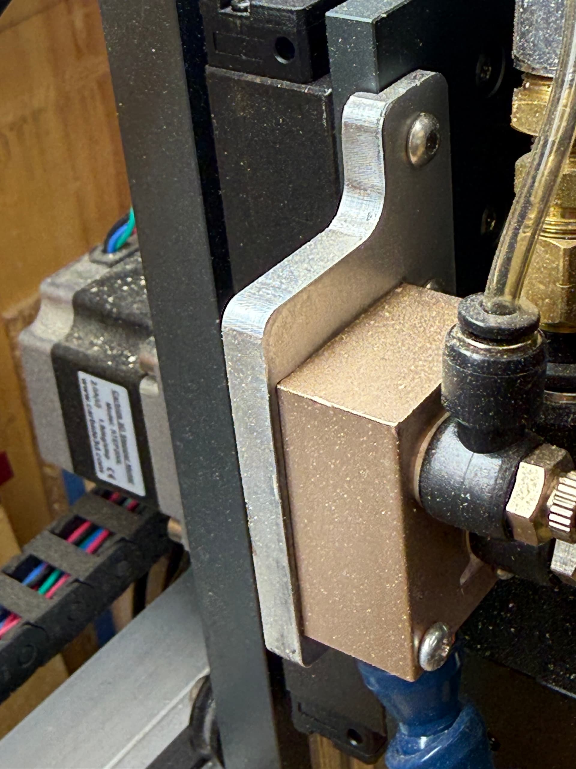

A new mister holding bracket for the HDZ.
new mister bracket.c2d (164 KB)

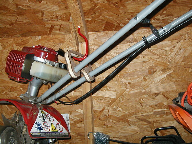

When the carrying handle on our Mantis Garden Tiller broke it was replaced with one better than the original.
I love my mantis. Thanks for the tip 20 chars.

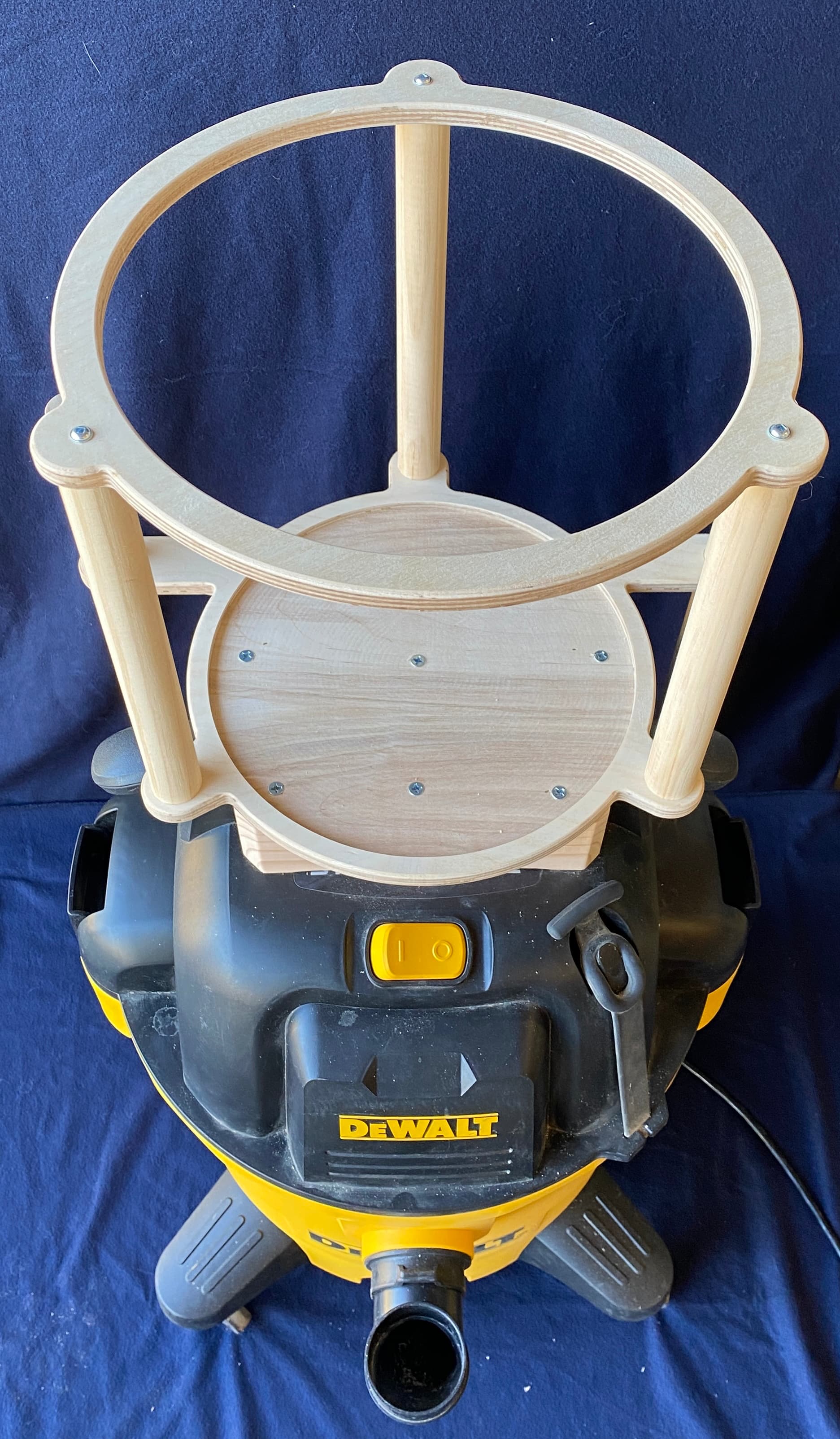

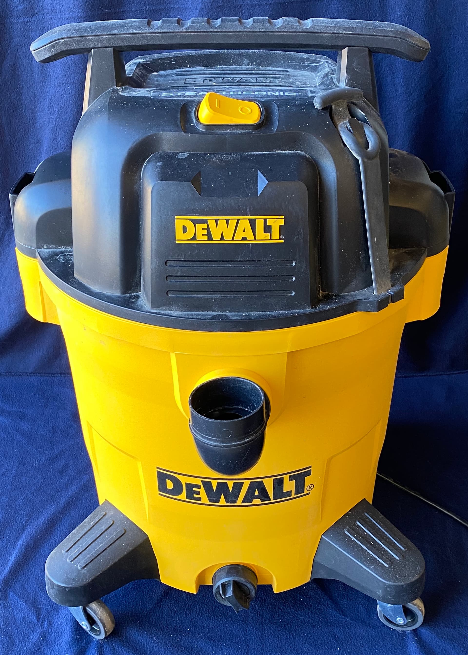

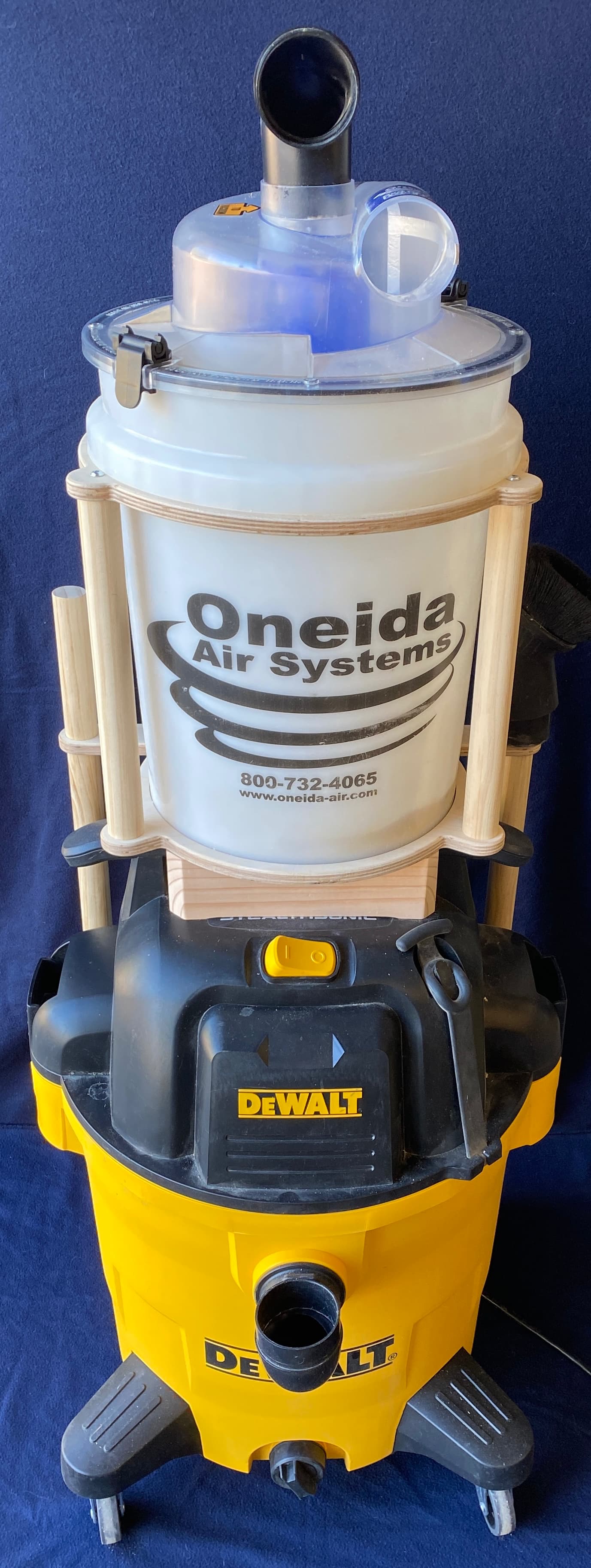

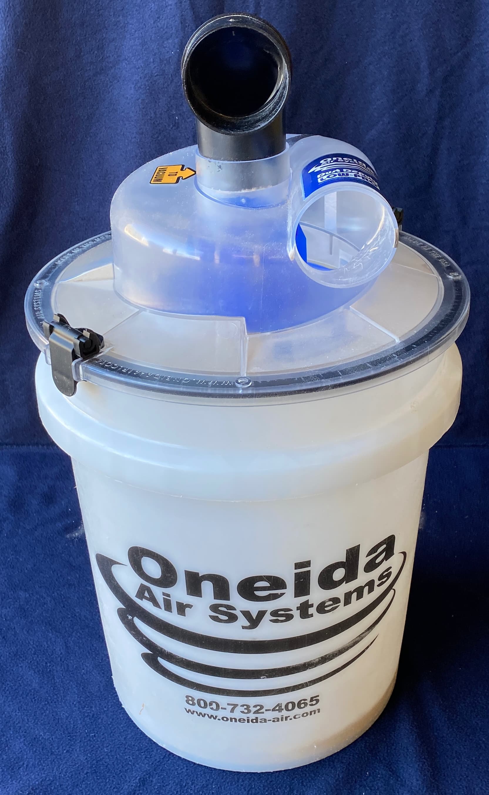

DUST DEPUTY LOW-PRO PIGGY-BACK ON DEWALT STEALTHSONIC VAC

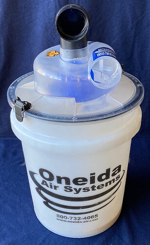

My challenge was how to make this:

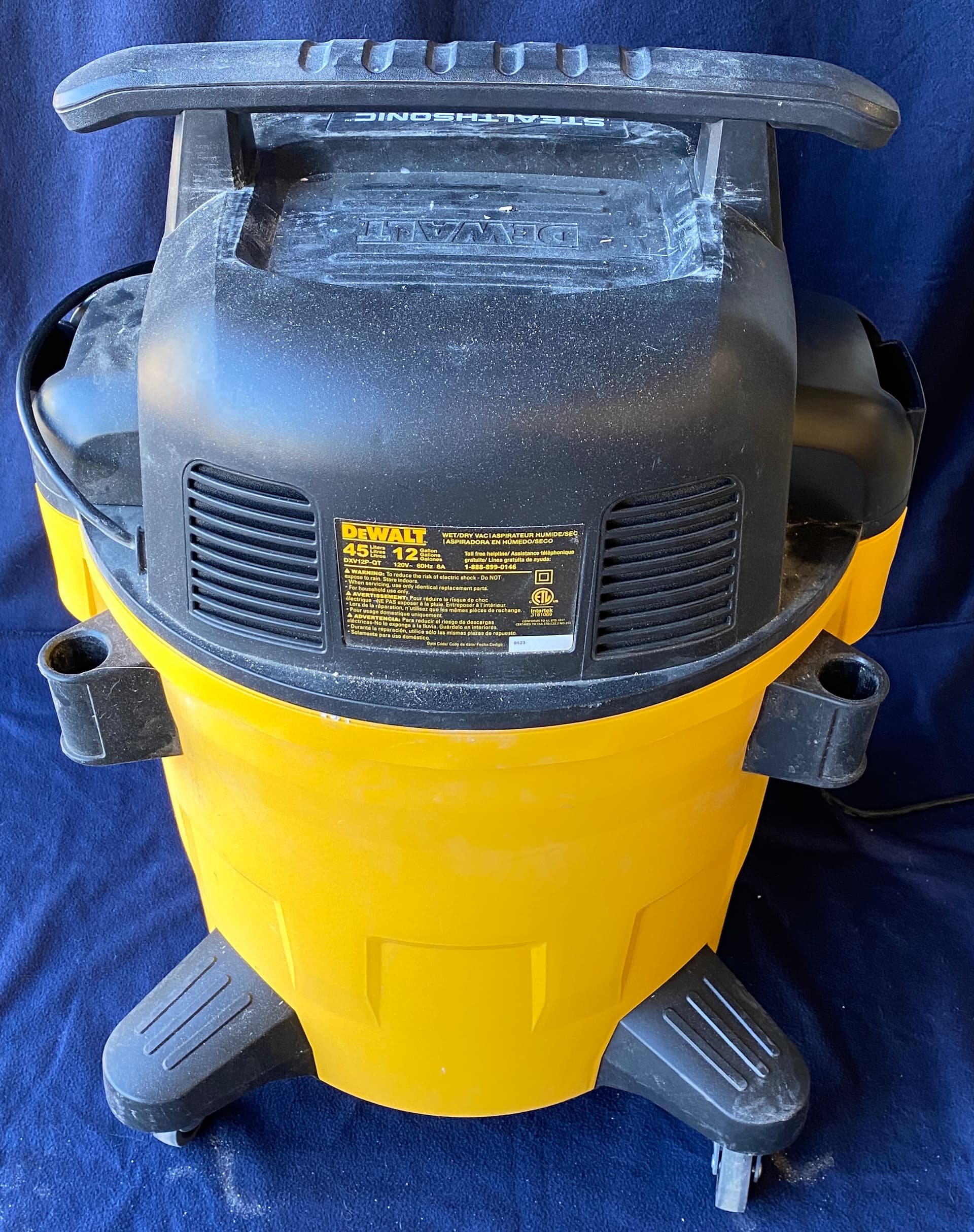

Fit on top of this:

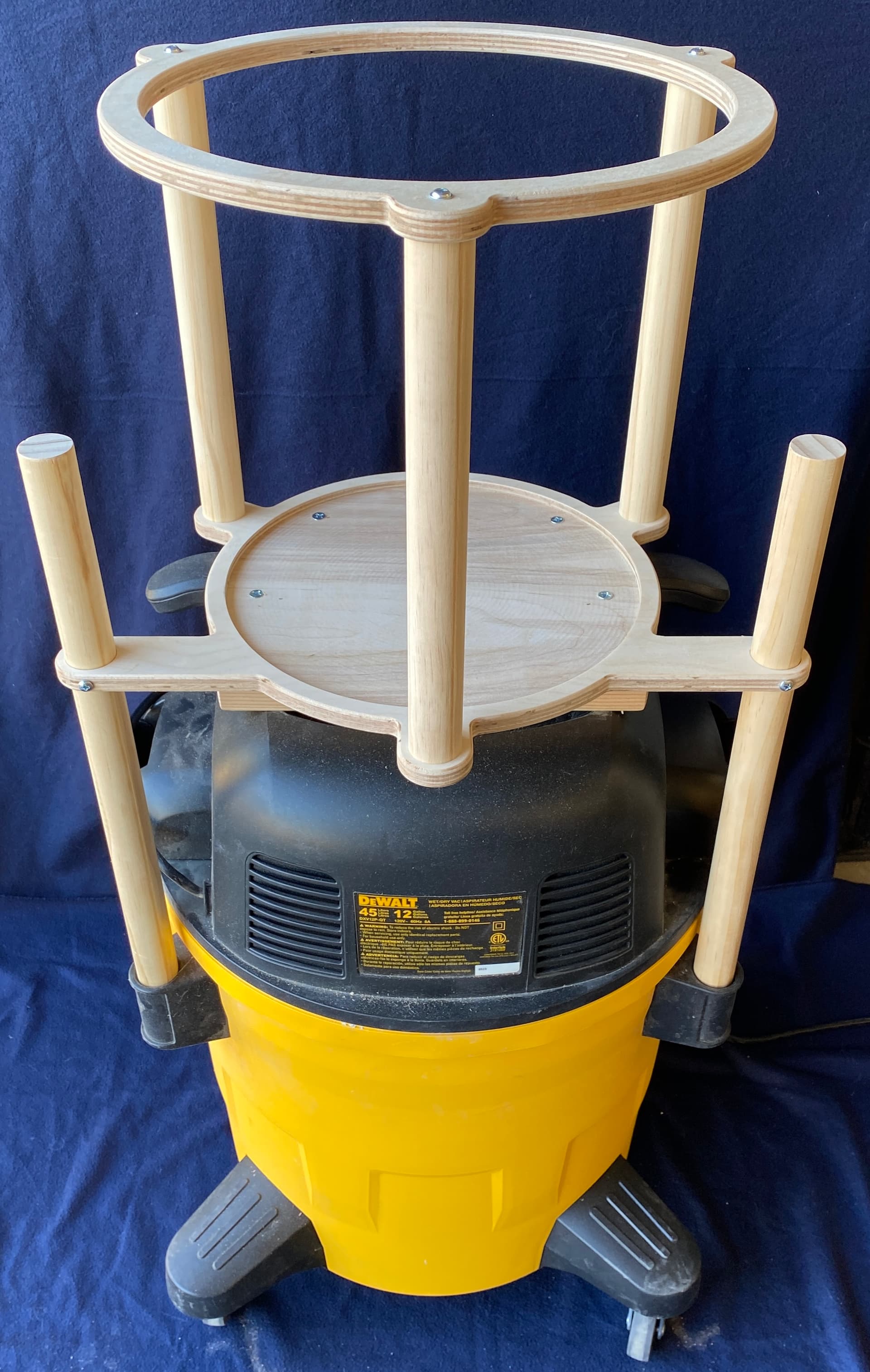

Resulting in this:
I wanted it to be stable/rigid but easily removable by just lifting it off. The 12 Gallon Dewalt Stealthsonic has two mounting holes in back, meant to hold an accessory bag that comes with the vac.
1.25" dowels fit perfectly into these holes.
C3D FILES:
Dust Topper Bottom.c2d (132 KB)
Dust Topper Top.c2d (176 KB)
I love this. Will have to do it.
I have the taller cyclone, not the low profile but the same bucket so it should fit.
Thanks. I also have the taller dust deputy separator, but I bought the “Low-Pro” to reduce the overall height and make it less top-heavy/tippy.
Maybe I will need some bricks in the steathsonic bucket :blush:
