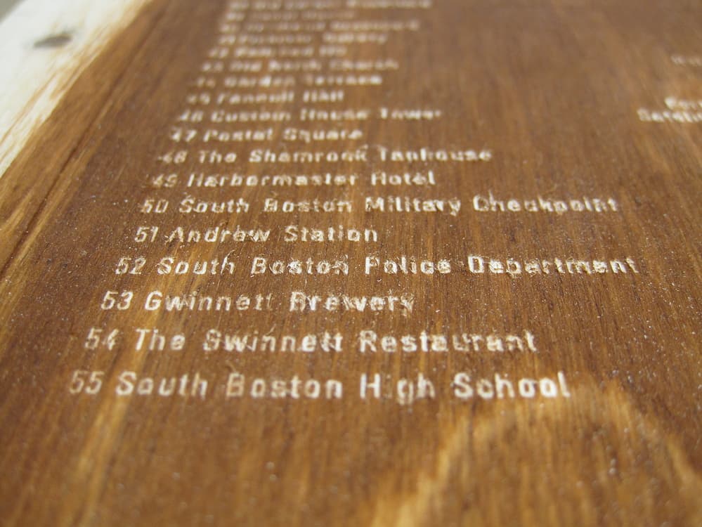

Here are some cut and pastes from a previous post (below)…
…smallest 17 degree v bit was used to barely scratch the stained surface of the text … the uppercase letters are 2mm tall…
With very small things, measurements need to be precise and the material needs to be (very) flat. The CNC will perfectly alter the bit height as instructed, but if you bit is going up and down 1/32 of an inch yet there is about the same variation in your material thickness the result is going to be frustrating.
