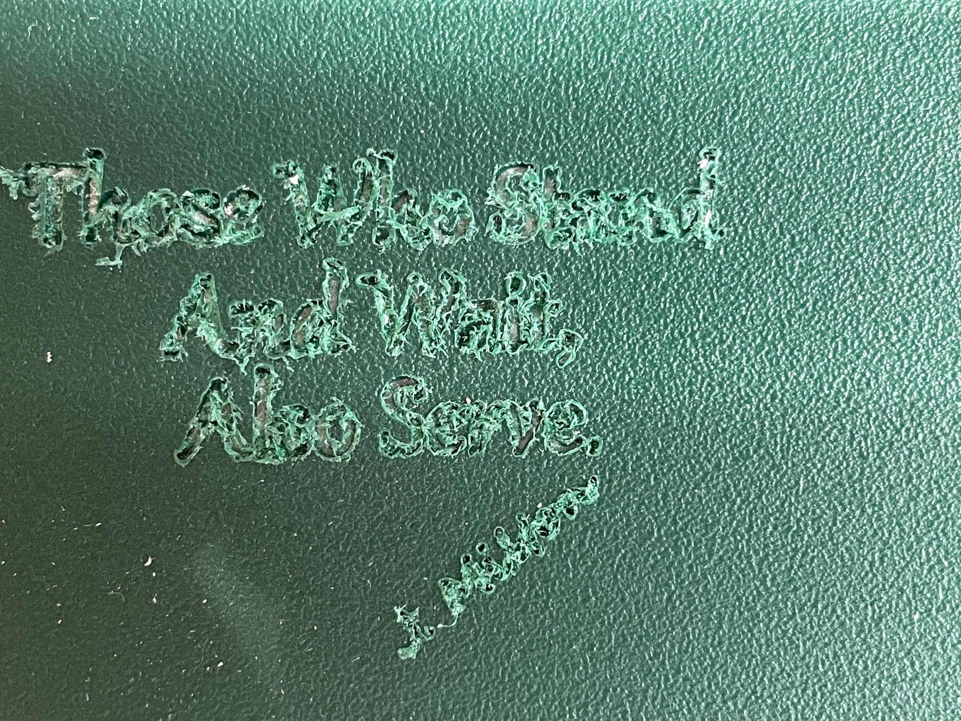

I’ve been experimenting trying to make small text, 1/8" using a 1/16" end mill without any real luck. Anyone have any guidelines or experience to share on how to make small text? Size of text, best font types, and tooling types/sizes, thanks in advance.

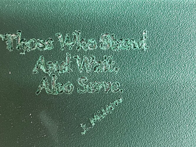

Thanks to all for the help, really appreciated. I should have said up front I am trying to make 1/8", or so, letters in King ColorCore plastic material. I have not tried wood yet. 1st image shows what I am after but also the very poor clear out of the letters. I’ve tried Vbits afterwards to clean up fuzz but no luck. Planning on trying slight offset as a 2nd run to see if that works in eliminating fuzz.

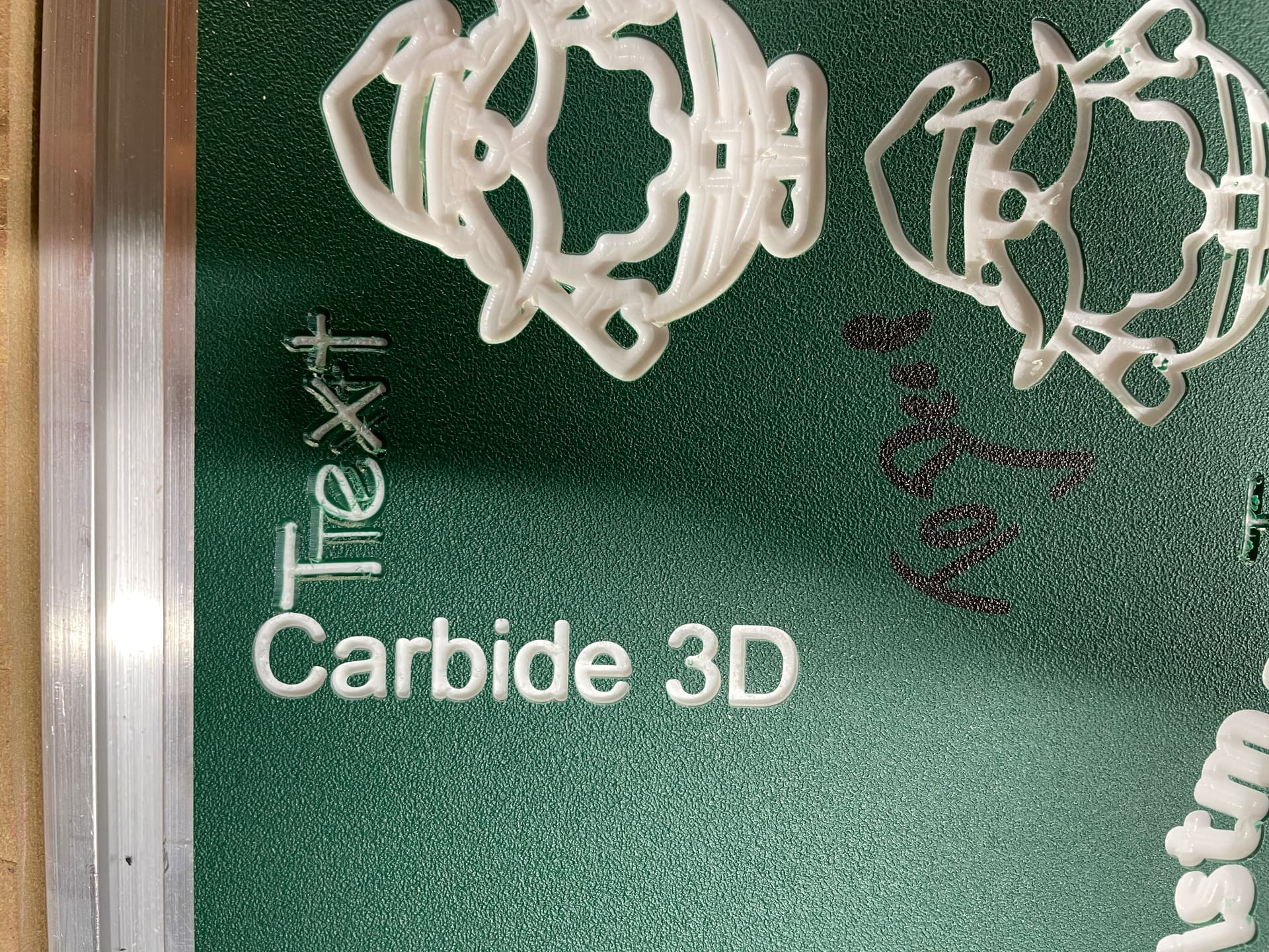

Will, 2nd image (Carbide 3D) is your file that looks great but letters much too big. I tried making my own file using your input but hanging up on "Draw in geometry at the narrowest point: And then inset: [[image]] Apply [[image]] " Not sure what you mean by drawing in geometry, inset and apply.
Again, thanks to all for feedback.
Draw in a circle which stands as a proxy for the tool you are using, so as to get a feel for how the tool size relates to the text size and then adjust its size (or the size of a duplicate) to get a feel for how much you can inset at the narrowest point.
Try the inset, and if it is fragmentary/non-continuous, undo or delete and try again with a smaller value — or increase the inset if it’s not tight enough at the narrowest points.

I have not had much luck with V Bits on ColorCore. I stick with O flute bits. Typically I use 1/4, 1/8, 1/16 Amana O flute bits and then transition to a set of tiny bits I picked up from Amazon that go all the way down to 1mm if I need more precision.
