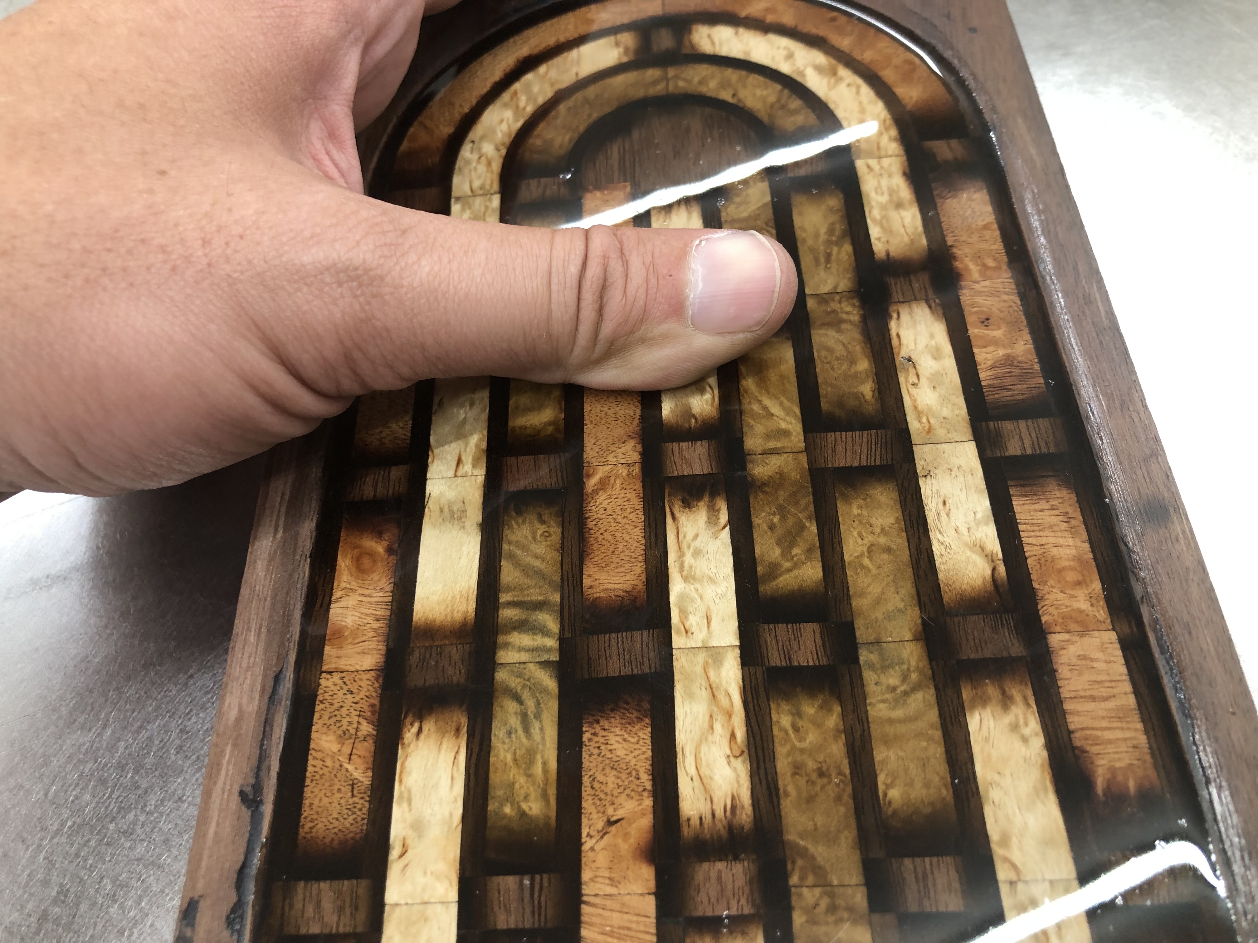

I started the weave patterned cribbage board this weekend. Needless to say, this is definitely a pain in the behind. There’s around 200ish individual pieces that I’m sand shading.
Took a while to get the hang of it, it’s starting to come together.
Next time the black lines are getting epoxied, maybe not.
It looks super dark, a light sanding should ease it out.

@MikeG me too, just painfully slow and super brittle. Glad I kept the veneer cutouts to fix broken peices. Super cool though, I ended up making the walnut veneer from the base material. Each one of the cuts match the grain placement. Excited to see if that effort paid off and is noticeable.
Side note, I was able to get down to .02 thickness on the veneer. It’s paper thin without tearing it out.
Also what I’m finding is that the veneer is shrinking considerably due to the heat. It must be sucking the very little moisture in the veneer. I re-calibrated my laser and the kerf offsets matched perfectly for the marquetry, but the heat caused some serious gaps. I have a plan to address that.

Hey everyone! I had some life events that took me away from the garage for the entire month July. I had a chance to get back in the garage and start working again.
Hopefully everything calms down now so I can concentrate on the things I enjoy the most. I finished all the sand shading and glued it up! Fingers crossed :crossed_fingers: for tomorrow morning!
I ended up tinting my glue black in hopes the small voids will fill black.

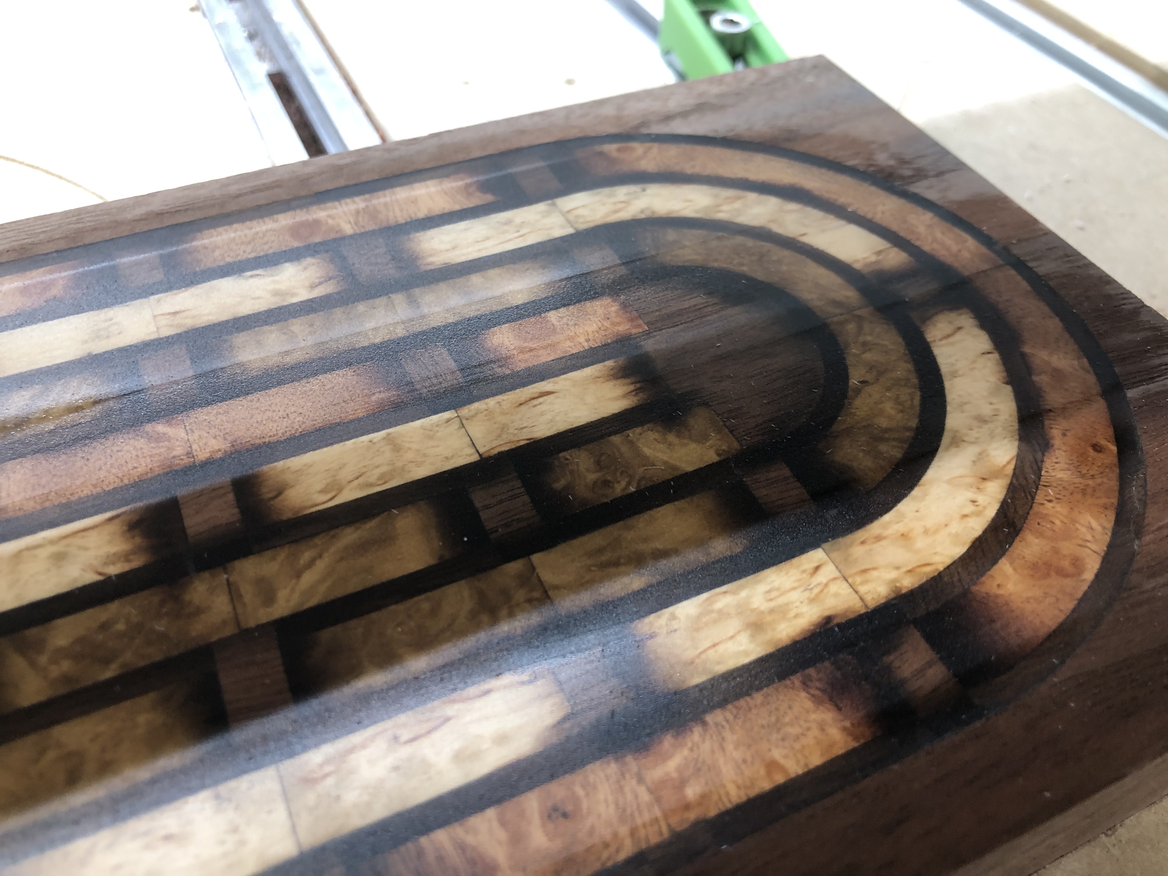

Doesn’t look like much, but this turned out pretty good! I have a ton of careful sanding ahead of me.
Sanding is slow. Some of the darkened pieces lost the shading, but I have a plan for that.
The depth of the veneer is super cool.
A handheld pen torch makes everything fixable.
It’s a waiting game now. Epoxy to seal everything up.
Next time I’ll use Cherry for the base material. With the lighter wood I think the deep shadows will pop more. This has been a pretty fun experiment!

So I’m sitting here contemplating if I should put the numbers and letters on the board or leave it be. Been thinking about it all day and at a point where I have to make a decision. Any thoughts??
Hard as a rock
Dang nat got stuck on the surface during cure.
Faced the epoxy to .0015 thickness
