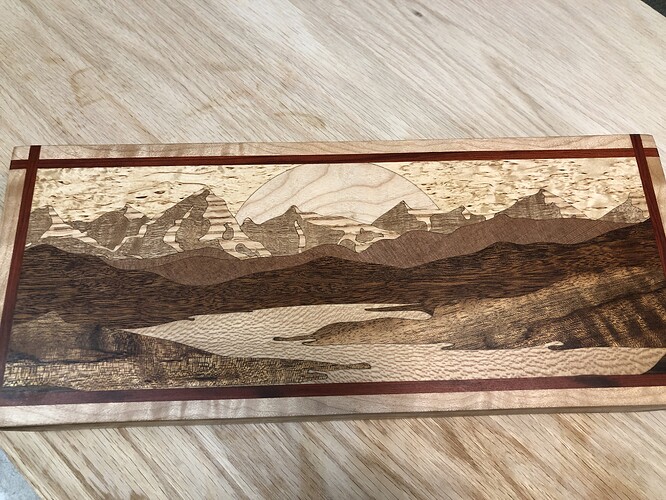

Also did some marquetry for the top of the box.

Just wanted to share something as I get asked a lot of questions on how I get the box top so flat. I purposely leave .1” of box material higher than the marquetry panel. Once the box is glued up I’ll flatten the excess in my drum sander…with being super careful not to touch the veneer. Just thought I would share. :nerd_face:

Amazing work!!! I am in awe of the joinery and design work! I especially love the veneered lid design. I assume those are all laser cut? If you could provide me with some info on how you go about cutting all the different veneers and designing them that would be great. I have a laser here that I have not used much but would like to try cutting veneers in the same manner.
Here is the link to the build video. Cheers!
@Spyd ill be doing an in-depth video on how to do marquetry with all the design steps. It takes awhile to understand different materials with offsets for kerf.

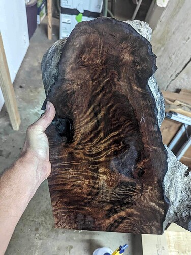

I finally stepped into the world of buying woods from different sawmills in the northwest. It’s been an expensive week of finding exotic woods with the right moisture counts and different wood grains. When they wife checks the account, I might be in some trouble.
This is some old growth curly redwood. It’s super dense and hard as a rock, The growth lines have more in the pencil width than most new growth lumber has in total. The redwood is probably extremely old.
Picked up a bunch of Claro Walnut Burls
And a whole bunch of Maple Burl billets.
Trying to up my game in the material category to enhance my woodwork. I’m going to knock out an anniversary cribbage board for my parents this weekend and will use some of this stuff for the box. I’ll post some pictures :nerd_face:
