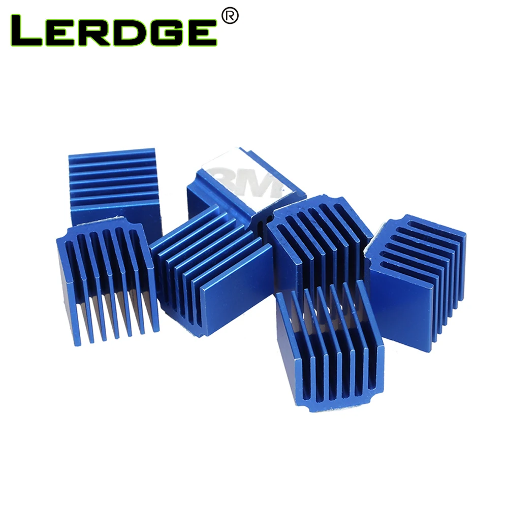

Waiting for the cable chains and homing switches. rest of the wiring is good so far. added additional cooling bodies to the nemas and stepper driver (glue still hardeining) as well to the usb driver. just for sanity :smile:

Wow mind sharing a link to the heat sinks?

sure.
bought these one for my 3d printer and orderer more then i initially needed… china shipping you know :smiley:
come with self adhering back and they worked quite nice on my printer.
They seem a little far away from me haha I will check local great idea!
