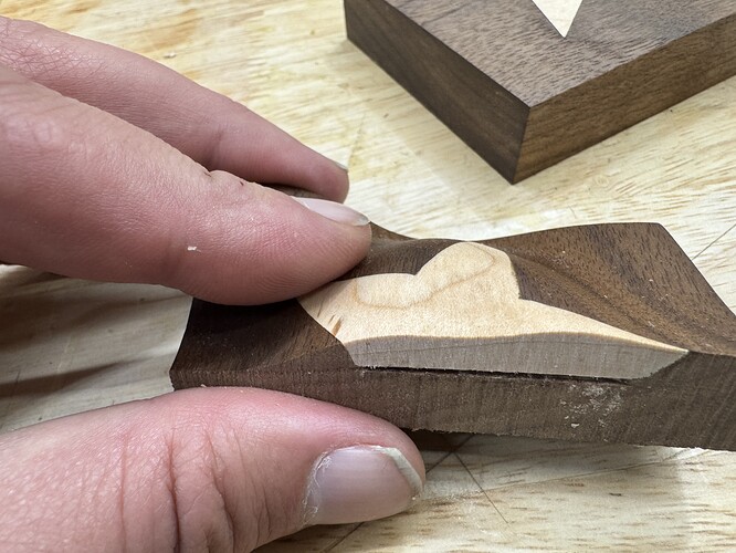

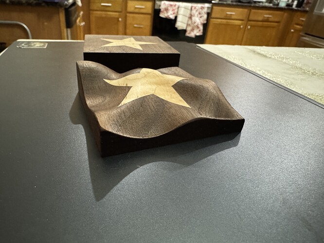

Finished up everything. Very pleased. On the 3D carve, I had some chipout in the top portion of the star point and it was enough leave a gap on the point.
Other than that, everything is tight, uniform along the surface, and the star maintained its dimension when looking top down.
Next step is a large Wavy Flag with Inlayed Stars.
