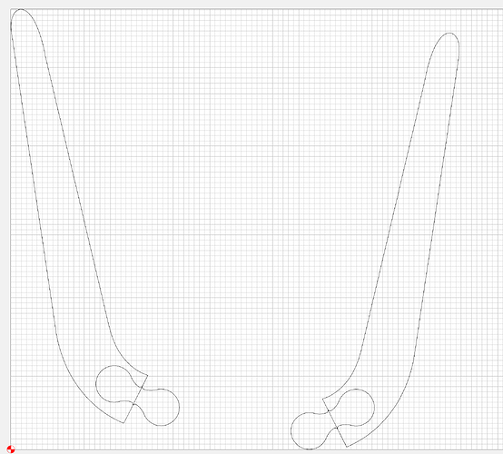

Here is the joint I’m trying to cut, when completed the male part has apx 1/16-1/8 all the way around. When I get back to the shop I will post some pics. For reference the dovetail is 1 inch at the widest point.

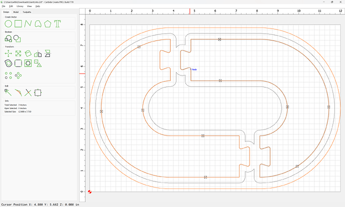

That said, this is a lot of material to remove with a 1/8" diameter tool, so we will assume Carbide Create Pro, start with a #201, and then use REST machining to remove the material which it cannot reach, and then the #102 to make a finishing pass.
My recommendation would be to offset by a bit more than any defect which you are seeing (but at least chipload):
Apply:
then offset by endmill diameter plus 10%:
Apply
The two small regions aren’t worth keeping, and I worry that they will break free and cause damage, so select:
and delete them:

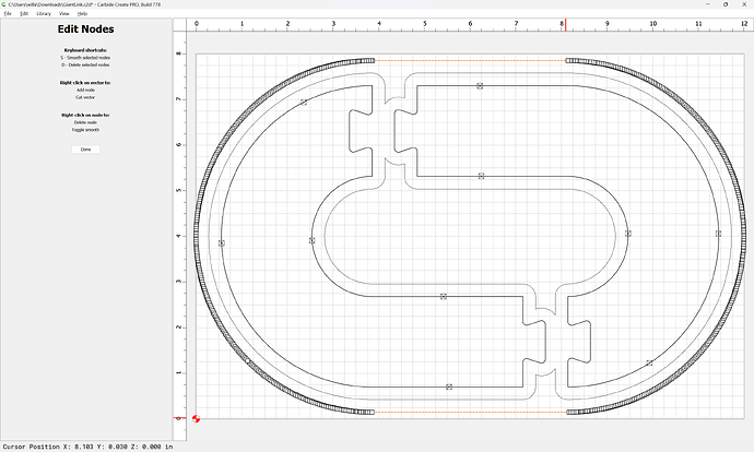

Then go into Node Editing Mode to clean things up:
Done
Then assign the toolpath:
which previews as:
Then select the original geometries:
and assign an Outside Contour Toolpath:
which previews as:

Ok after trying a bunch of different approaches, it occured to me to measure the width of the cut of one of the contours on my piece, it turns out to measure at 0.30 inches even though the bit is 0.25. I measured the bit and it is in fact 0.25 inches. I then did a test cut with the bit diameter set to 0.30 and the pieces fit togther perfectly.
So my next question is why would the cut width not be the same as the bit width. Its a pretty easy fix but I’d rather not have to do test cuts with any new bits to get the cut width and create custom tools for each one.
Has anyone else experienced this?
Thanks
