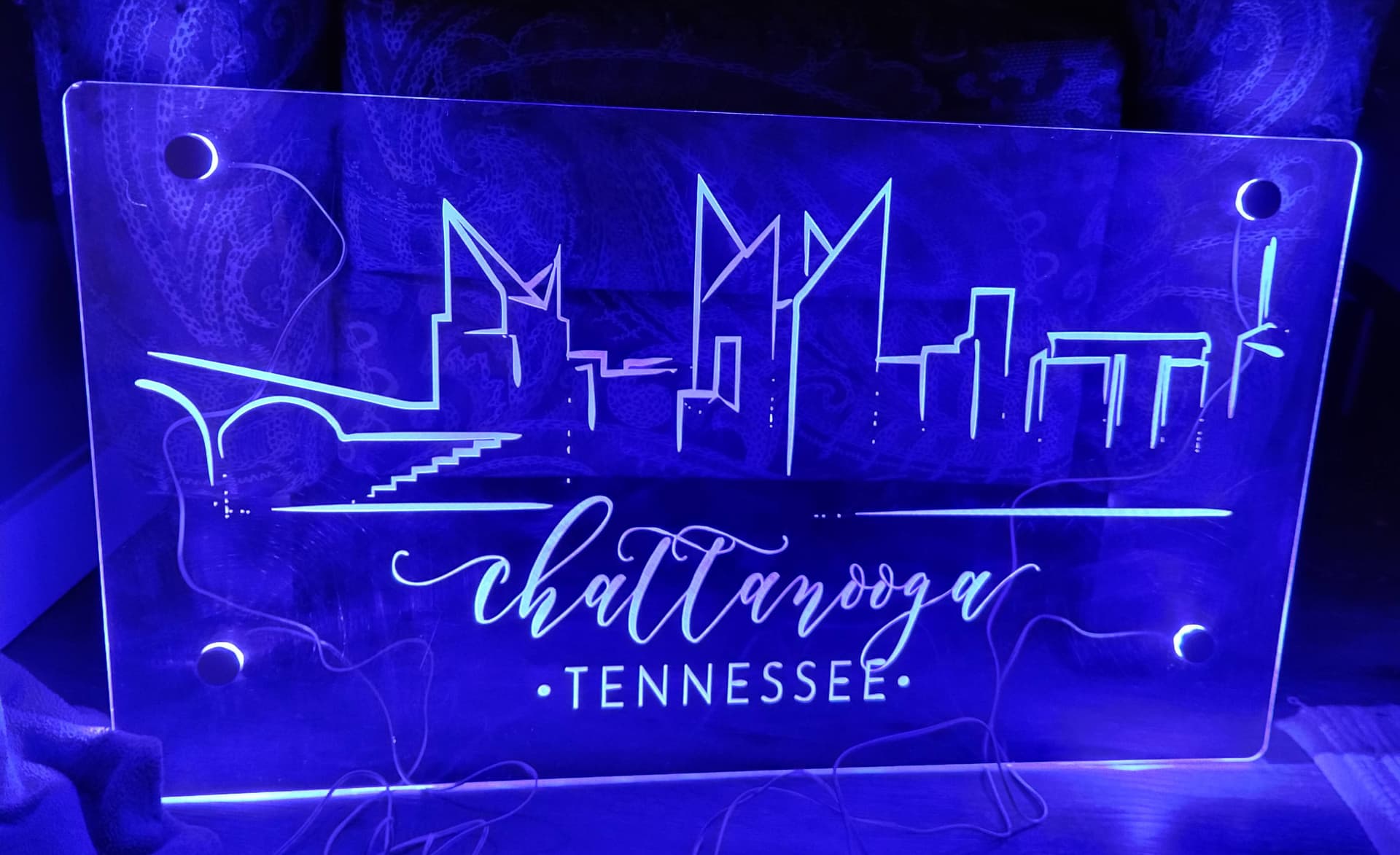

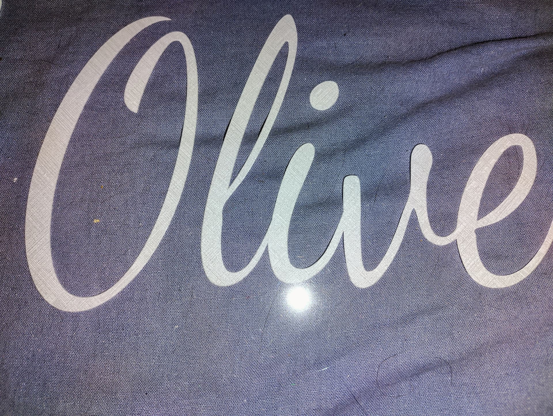

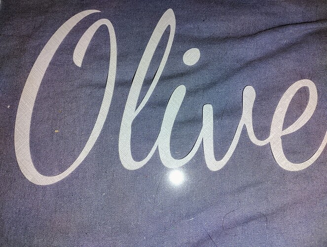

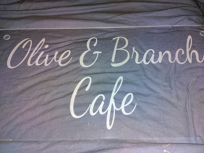

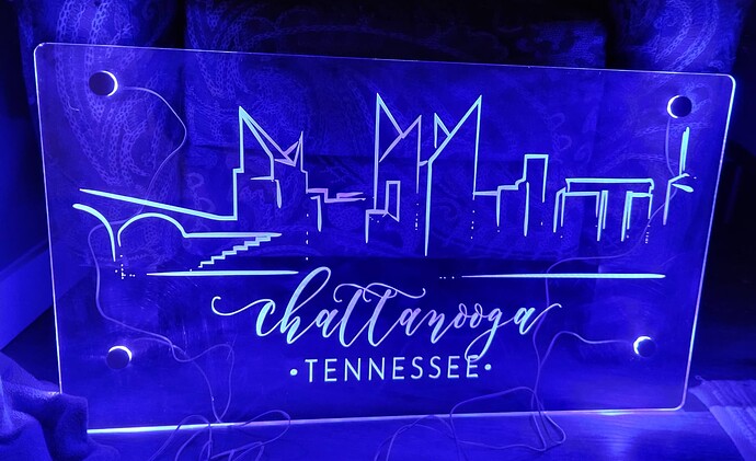

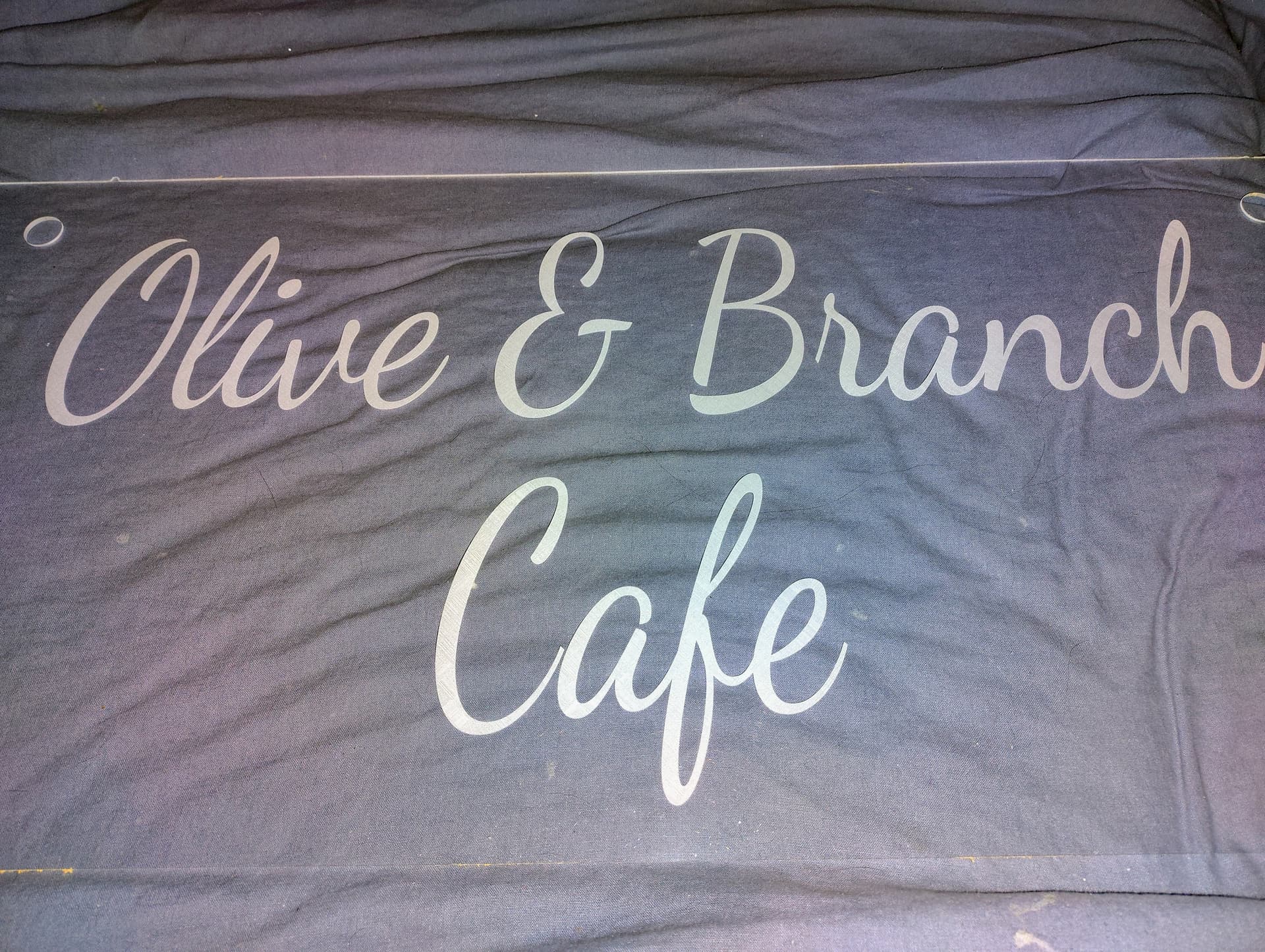

Ok so update I found out that with the diamond engraving bits you set the screw to be able to push the bit setter without the bit moving. An I like to use .15 depth of cut and crosshatch. The only thing is if I didn’t use a brush to constantly brush the acrylic away from the bit the lines would be uneven. Air works to.
And now your are a professional. Very clean. Congrats !
For the debris, keep it dry (any fluid will make it stick together ).
I have a deep Sweepy and vacuum ( 4" hose, Mullet cyclone and a Stealthsonic vac).
I keep the bristles near the surface, you can hear the vacuum start to change pitch.
That seems to keep it pretty clean.
Yeah I used mine for this one
Awesome job.
