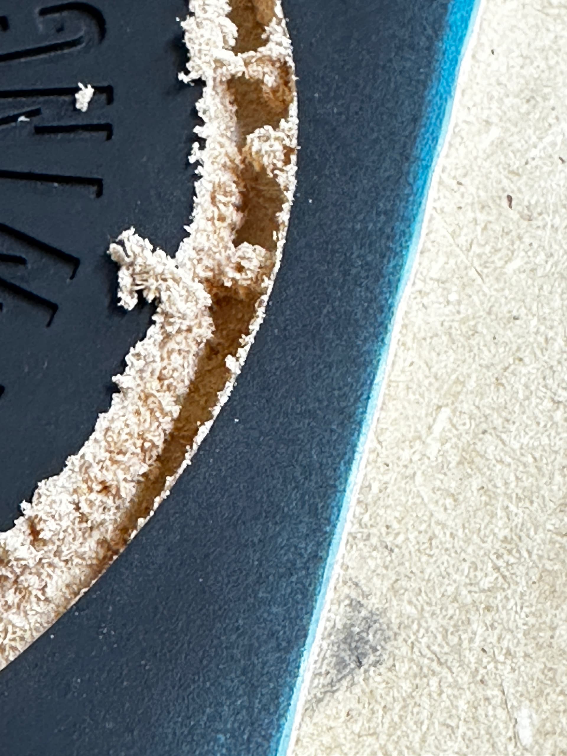

I cut a lot of carbon fiber parts on my machine. I generally load up my carbon sheets on waste boards so I can easily swap them out for different thickness material. I have tried everything and the blue tape and ca glue is the best option for reliability and consistency when cutting several parts out. I always cut 1mm deeper than I need to as the waste boards can warp overtime, so I have cut through a LOT of blue tape and never ran into an issue where it gummed up the bit or had excessive clean up.

Here’s what I’ve been using for years now without any problems. This tape is 0.00508" thick (manufacturers specs) so I offset my Z-zero for two layers (ignoring the CA glue thickness) 0.010". My bits will skim the top of the top layer of tape, because my Z-zero setting is so perfect! :smiley:
This FrogTape is medium adhesion and works well on many dust-free surfaces, but particularly well on my worn out MDF wasteboard.
The CA glue I use is very good and thick. I don’t need a lot of it, because I squeeze it into a very thin layer. CA glue works better (as designed) with a very thin layer.
