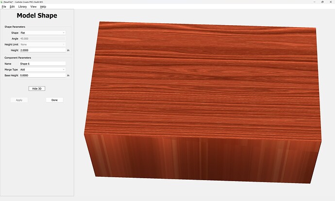

I’d like to create a platter that holds deviled eggs. Hey, 'tis the season you know! I saw the Nov2022 post by Will, but I’m hoping there’s a better (smoother) way by now. Here’s my theory of how the egg indention could be created.
I have a 1" core box bit – basically a bowl bit but entirely round on the bottom. Using that bit, I think a very smooth “egg-shaped indention” could be created by simply creating a short line (1.5 to 2 inches) with one end of the line at the surface of the material and the other end of the line at a half inch or so deep into the material. As the core box bit traveled and ramped between those two points, it would (in theory) remove an even and smooth pocket that ‘should’ look like an egg pocket. However, I am dumbfounded at how to make one end of a line lower/deeper than the other end of the line (in Carbide Create). Frankly, I’m afraid to even post this message as I’m guessing the answer is going to be one of those forehead-slapping AHA moments. Oh well, here it goes…

Draw in a rectangle to represent the stock:
Select it and go into 3D modeling mode:
model as a flat to the Stock Thickness:
Done
Select the egg shape:
Model it subtracting it from the stock:
Apply
Adjust the settings until the desired shape is achieved.

No, you would set up multiple instances of the line each cutting at a separate angle/to a different depth — if you try to draw it up in profile it would become obvious.
Here’s the file in its current state:
egg_v8.c2d (636 KB)
Just delete what you don’t want and make up the 3D toolpaths (or re-create the 3D object at your desired stock thickness).
