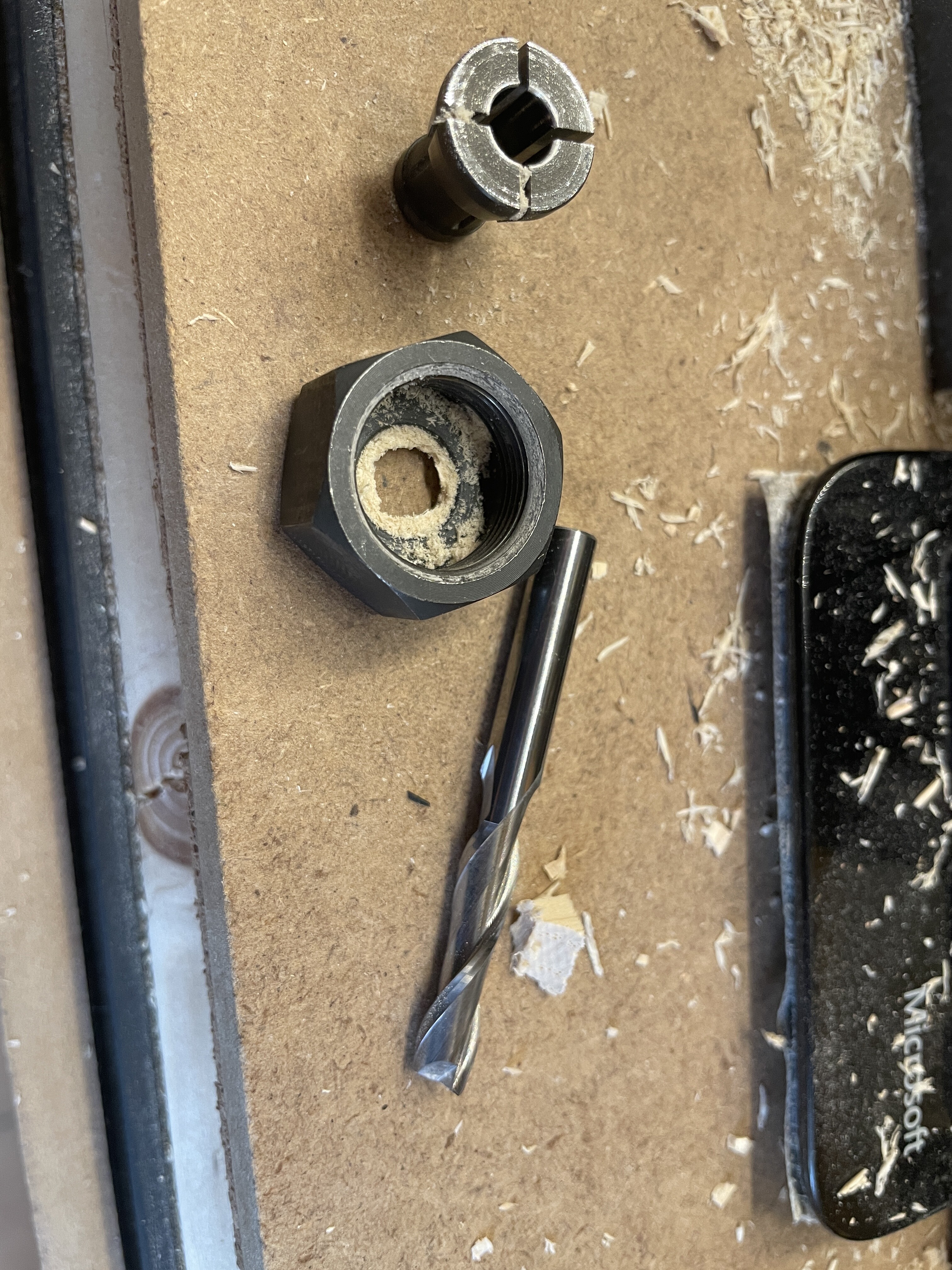

I meant the inside of the conical hole in the router, where you insert the collet and bit. If dust gets in that hole and you then insert the collet in there, it will not sit nicely in the hole, it could end up being crooked, making it impossible to tighten it enough (whatever amount of force you use).
I’ve only just received my Shapeoko spindle with an ER20 collet today, so can’t comment there, but the ER-11 collet on my Nomad has never gotten any dust in it. I swap the nut and collet between 4mm and 3.175mm versions every so often, and never see any dust inside it at all.
The ER collets look different to your router’s collet so perhaps the design helps?
EDIT: That’s after over a year of cutting metal, wood and hdpe
I have been using ER20 collets in my spindle for about two years now, and while I never had issues with endmills slipping (well, I never had issues with endmills slipping back when I had a Makita router either, it must have been my collet-cleaning OCD helping back then), I still tap them lightly after I cut e.g. MDF, and dust does get in there (in the slots of the collet). The taper, not so much, but worth checking from time to time.
There’s an opening for the button at the top of the shaft which seems to admit debris if the chips from cutting are dust sized and the vacuum isn’t efficient enough to take them all away.
If the job you did “yesterday” was long and warmed the collet, router shaft and end mill, perhaps the thermal cycle was enough to start the loosening process. Did you check for tightness before beginning the job that the end mill slipped on?
I did. I even tightened it a bit more, but it didn’t seem to work.
It just happened again!

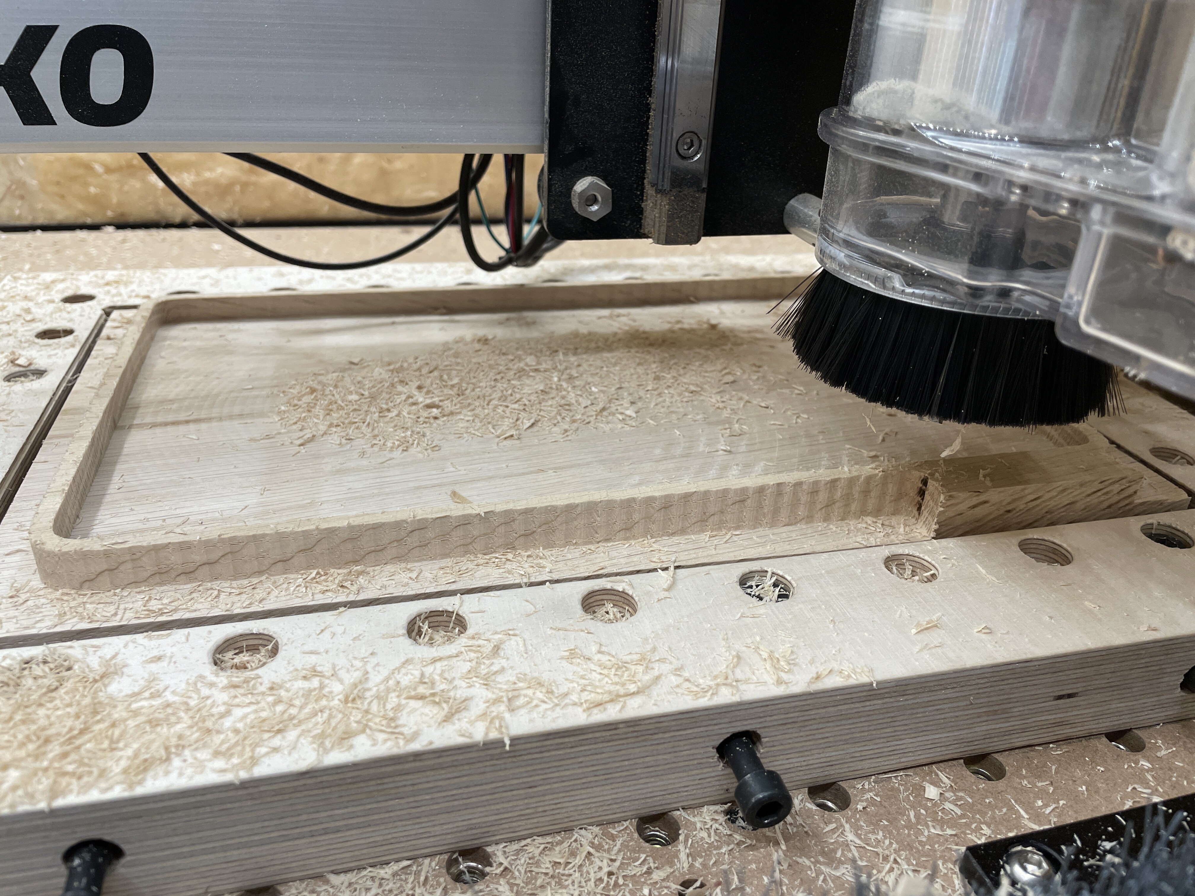

I took out the old tool, cleaned the collet and tightened the new tool and then this happened:
This is the path that it was running:
I’m not sure what to do here. Any guesses? Am I just being too aggressive in my cuts? It doesn’t seem like a thing that should happen?
Have you tried to confirm directly that the endmill is moving, either by measuring the protrusion when you’ve affixed it, or by marking the place where it meets the collet with a sharpie?
I’m quite sure that the endmill is moving. What else could be happening? Could the spindle be forced down? The wood is firmly placed on the wasteboard, so that’s not moving around for sure.
no but the piece could be pulled up if workholding is not good enough. I doubt this is the case here, is that a custom workholding jig I see ?
Can you share your cutting parameters ?
It sure is. The jig is working really nicely
Sure. I’m definitely pushing it to the edge… probably over it seems:
I’d be curious to know what your speeds and feeds are, just based on the photo it looks super aggressive. if I were approaching the same job I would assume that I’d have a depth of cut of about 1mm for hardwood.
Yeah, 9mm depth per pass at 3mm optimal load is…a lot, I tend to stay in the 1mm optimal load ballpark when cutting deep adaptive like that.
It only comes to mind now, but you should check your zero after this happens, to establish whether you lost Z steps during the job. If you did, chances are it’s that upcut endmill pulling too hard on that poor stock
You should always have a spare collet onhand anyways, so I would just get a replacement and see if that solves the issue, because it feels like the collet is not gripping the endmill when under strain…
This is exactly why you should confirm it. Not being able to think of what else could be happening is a fault in thinking and not an affirmation of reality.
From my experience in manual machining, it’s an indication of chatter.
As mentioned previously, generally too aggressive of a cut. It can also be lack of rigidity, but that is caused by too much tool pressure, or again, too aggressive of a cut.
At least, that’s for metal. I assume the same stands for tree, but may be wrong!
Those scallops could be the result of the toolpath.
I agree that the cut is at least optimistic though.
If there’s enough vibration to move the cutter I’d expect the whole Z assembly to be vibrating too, maybe a video (with sound) of the machine attempting that cut would help?

I thought those scallops might be the remainder of a roughing toolpath based on the pics posted
But I tried setting up a similar path in Fusion myself and the simulation shows the adaptive leaving relatively smooth walls so, no, it looks like it’s due to substantial deflection.

If it was my cut the first thing I’d do would be to either back off the optimal load to 1mm or 1.5mm or drop the max stepdown to 3mm or 4.5mm and see if the machine is happier at that lower load.
As above, well questioned, looking closer at the toolpath, you’re right, it’s not the adaptive, it’s deflection and the sheer size of the deflection suggests machine deflection, in my experience if you bend carbide that much it tends to break and fling high speed shrapnel at you…
