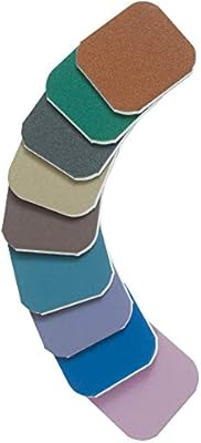

And that’s where I need help from you guys who have sanded/polished epoxy before: what’s your routine to get from the rough translucent surface I will get after surfacing, back to a perfect transparent finish ?
I only have wet sandind paper up to 1000grit, that’s not going to cut it I think, I have seen youtubers use up to 5000grit and special polishing pastes ?

I use micro mesh pads all the time to get highly polished surfaces. Works great on even unsealed wood if sanded with 600 grit or better… but I mainly use it to restore finishes and repairs on guitars. It works well on epoxy and polyesters
You can get different sized sheets and pads, furniture makers often put them on rotary sanders for large surface and also use with water for wet sanding
Thank you ! that will make the Amazon searching way easier with the right keywords.
12000grit, that should do it :slight_smile:

Hahaha! 12,000 grit is essentially rubbing a piece of paper on it. That’s above what they use on cars. Typically above ~4,000 grit they switch to liquid polishing compounds.

I couldn’t figure out how I would pour an extra layer of epoxy without messing up the side walls (I like the sharp edges), so I went for the hard way (sanding). I stopped at 1000grit, and got this:
Which turned into this, after applying a coat of mineral oil:
The colors are a bit less vivid after wiping, but that’s a good thing as far as I am concerned, so I’ll call this project done
