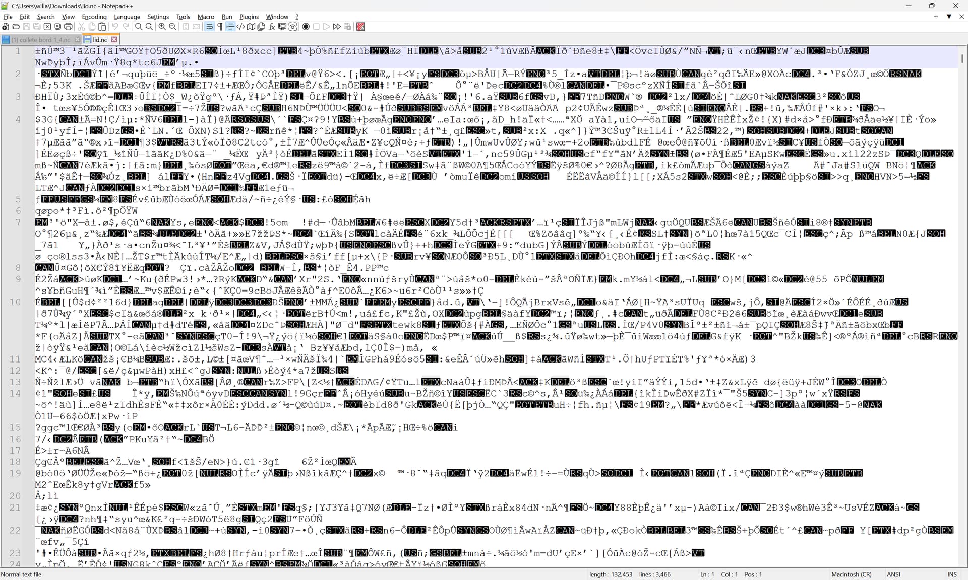

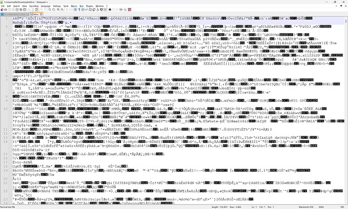

I made up some simple drawings in CC V8 and saved as a nc file. When I tried to run them on my Shapeoko 5, I got a “Found error message” and a list of lines that aren’t readable.

How did you make the lid.nc file?
It is not G-code:

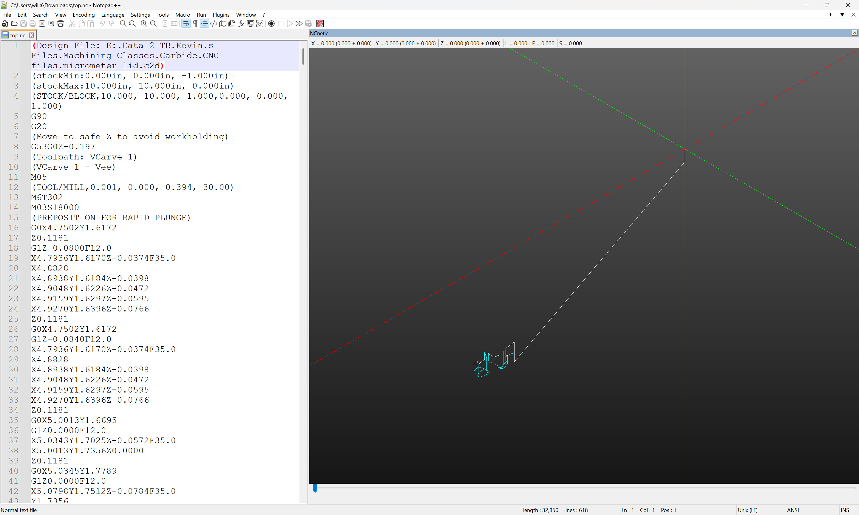

top.nc seems okay:

Weird. Made them both the same way. Drew them in CC V8, created toothpaths, and saved as G-code. Same way I’ve done everything else in the past.
Files were both saved to a UBS stick, on G:/. No directory. Then loarded into the cutter. Same errors.
Tool was taken from the CC tool list.
Thanks. Going back to start over and see what happened.

Export the files to a hard drive on the computer Carbide Create is running on, then copy them to the USB stick, then copy them to a hard drive on the computer Carbide Motion is running on.
