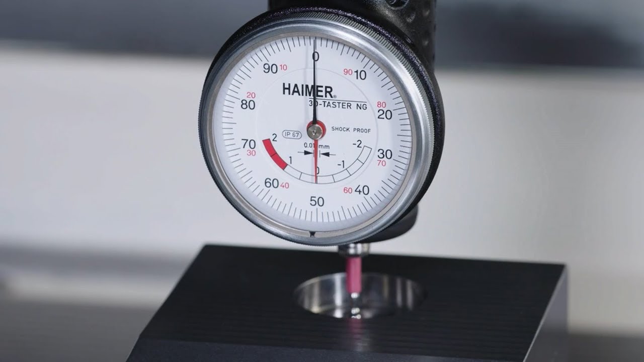

Just curious as to what other people are using for 3D touch probes these days. Most of the forum threads I am finding are a couple of years old and since we have longer Z travel now, I wonder if this Haimer is an option.

That looks like digital surface mapping. I am just wondering if anyone is using these Haimer units to set zero. It is analog and precalibrated that once you probe the object (side or top) until the dial aligns to zero, your spindle is precisely zeroed on the edge. Check this out.
I’ve had one of those on the shopping list for a while. Bear in mind a couple of things though.
You’ll need an ER20 collet spindle to hold the shank on those probes and there’s 101mm below your collet to the bottom of the probe, which is likely to restrict how tall an item you can probe on the machine bed, even with the HDZ that’s quite restrictive in terms of larger workpieces or those mounted in a vice or similar.
As for precision and ease of zeroing, yep, the Haimer is great, but the Haimers are designed for mills with lots of Z travel and I keep finding something better to spend the money on.
Here’s the dimensions
Might also be worth noting that the workflow for this type of probe is frequently to have tools with measured Z height when installed, which you can’t really do with a collet based tool change, so you’ll be finding Z=0 with the Haimer and then having to translate that into a Z=0 for your tools.
Thanks Liam. I was wondering what the Z zero workflow would look like since the Haimer would likely depress when touched off on a bit setter. What do you use for zeroing?
