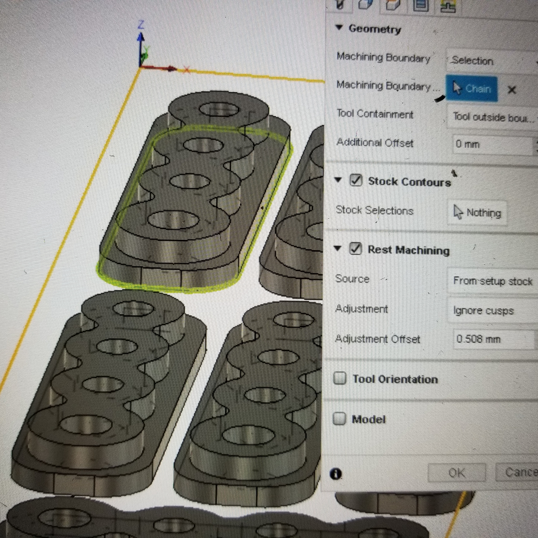

In fusion 360 how do you do adaptive clearing around that part to a set boundary? When I tired that on a bottle opener I was making it wanted to plunge straight in. I wanted to be able to machine just around the part even though the stock was bigger and I wanted to make sure that it did a helical plunge to full depth before it started the adaptive but I couldn’t figure it out. I ended up machining the stock down to size before running my part but this was very time consuming. Hopefully this question made sense and maybe you can point me in the right direction.
PM me a shareable link if possible, we’ll get you all setup.
Easiest way
awesome, i will try to get that sent over tonight!
It has to be 3d adaptive, and you need to enable multiple depths + ramping.
I’m sure Vince will have you sorted out in no time, but below is something I have found helps a lot in fusion when you’re struggling to get toolpaths where you want them.
Create a sketch on the top plane of your object then offset your outside profile by whatever amount (I did 8mm) - make sure the sketch is visible then go to the manufacture tab
When you are selecting geometry for your 2d adaptive toolpath select both the outline of the part and the offset sketch - it should highlight the gap in blue. You may also need to change your ‘bottom height’ as requried as it may default to the height of the sketch
These are the settings I successfully use to helix into aly with a 1/4" bit, you can probably go harder but it works for me :+1:
3
This should be the result you’re looking for - I just left it as a single depth at the top of the object height so its easier to see
And the helix close up
Depends on what you want to do, they way I did mine was selecting containment boundaries. Was helpful to test cam and adjust stock to leave on one part when running a batch
Sketch based cam is really useful too
very nice write up! I will give this a shot and see if I can get it figured out!

I just add an offset to the containment boundary.

On a bit of a side note, I have two other queries…I’m actually trying to get the cam dialled for that exact same part you posted there @neilferreri … but keep getting this mess in the through hole. Have tried both 2d and 3 adaptive… can’t seem to work it out- would you mind sharing your ‘passes’ and ‘linking’ settings for that part?

Here’s the one I used. Ignore the OLD_MILL setup in the CAM (anyone else get lost for a minute when they changed it to “Manufacture”?).
Actually increased my feed while going.
https://a360.co/2O8Lo3k
Video of part of cut: https://photos.app.goo.gl/svsTfkiMzqkqYM5e7
Ah awesome, thank you. Still not sure exactly what I had wrong but that has it sorted.
