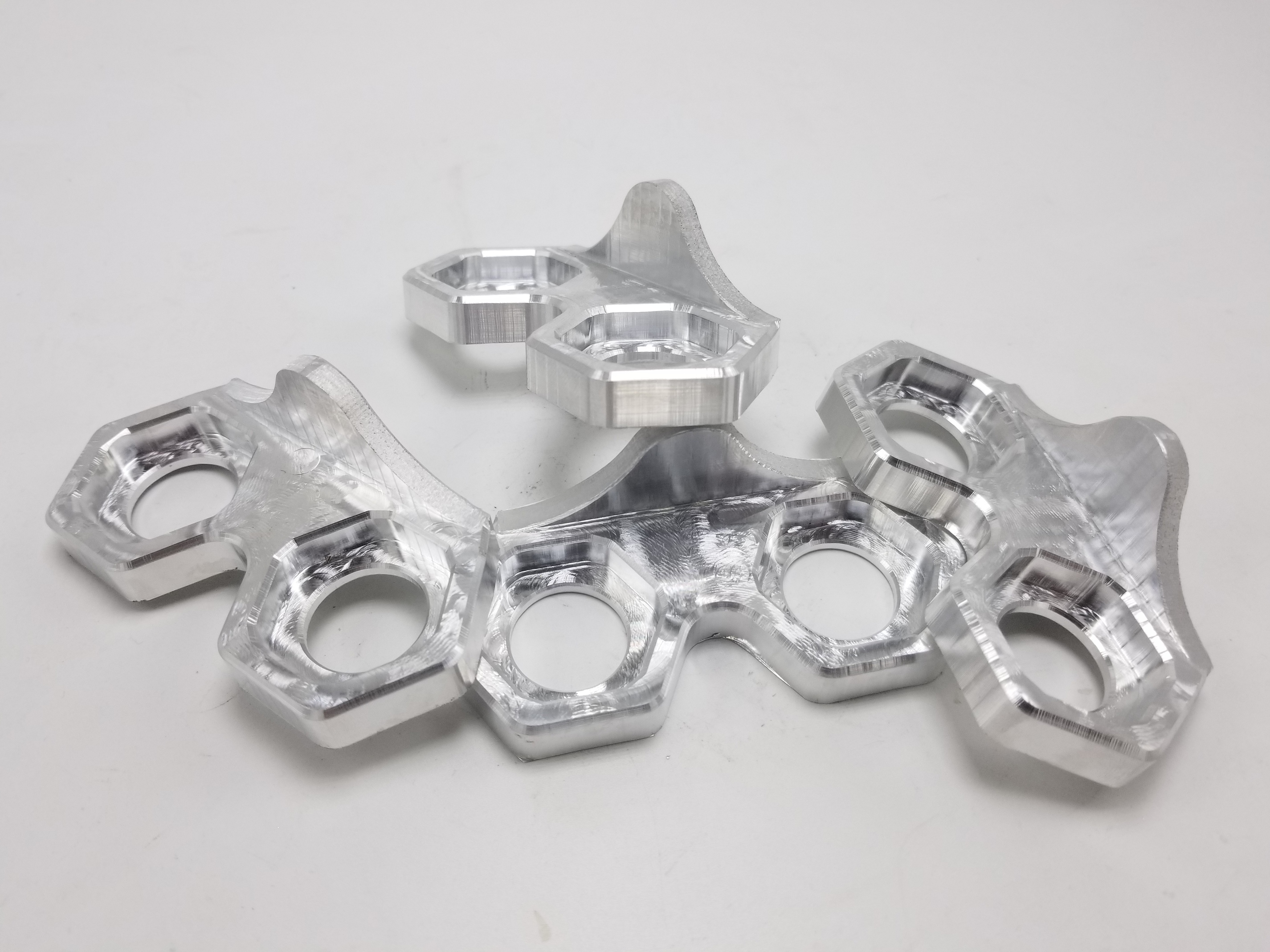

Yeah while very useful and the price is right, it makes my Swag 20T finger break look very basic. Like the song says: If I had a million dollars…
Datron 8mm 4in1 magic shine
200ipm
4.5thou actual chip

Small batch of dual sensor mounts done. Something in the cam is putting lines on some faces, i’ll change some things and try again.
Switching back to 3mm Datron SF and going to knock out the last remaining brackets on the red evo RS. Starting to get the hang of this lol, superlight, super strong, hexy is the new sexy
Well…I done messed up and broke a Datron 3mm, didn’t clear another fixture on homing… threw in the carbide 0.125 sf and finished the part. Its proper, real proper. After this car gets an intake manifold it will be making a solid 650hp, looks stock. P.s. - cheap collet reducers suck

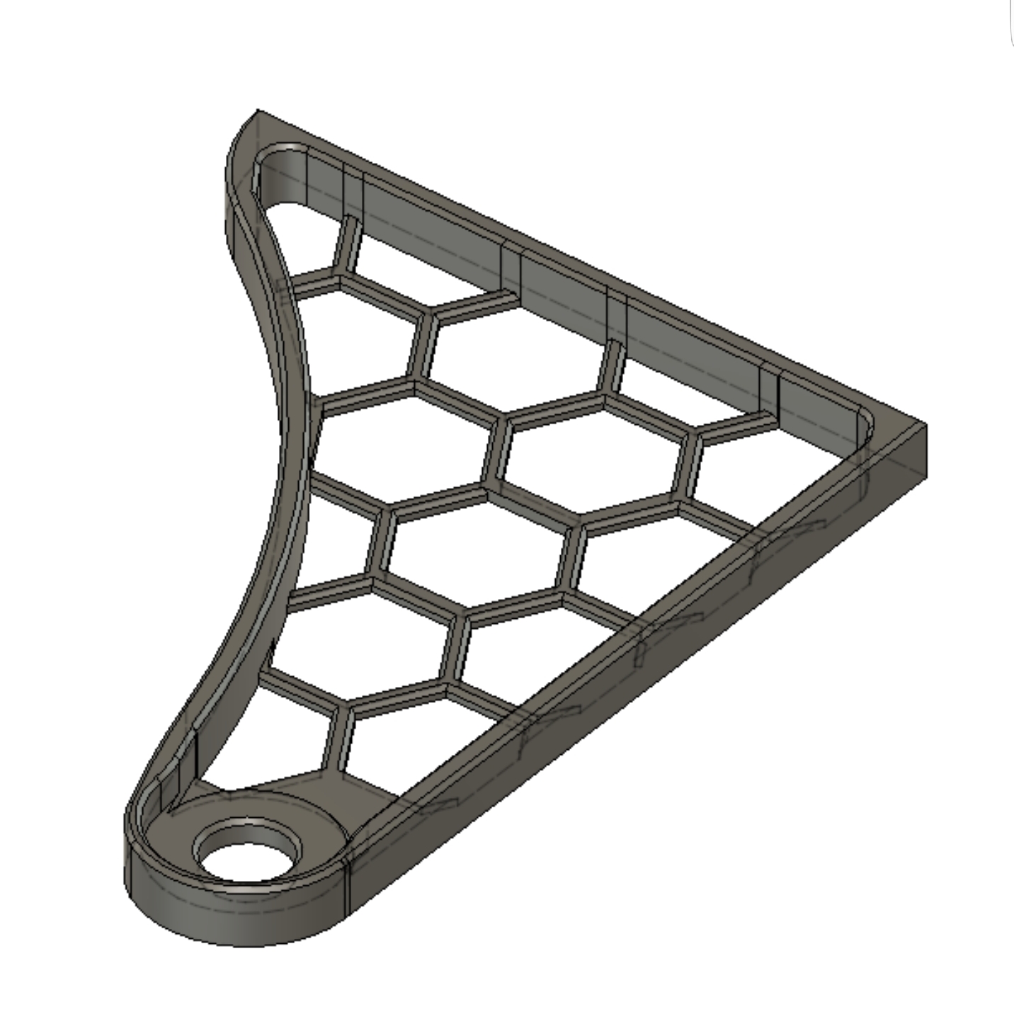

Those hexi are only 50 thou deep, bracket weights grams. Finishing this job buys more endmills

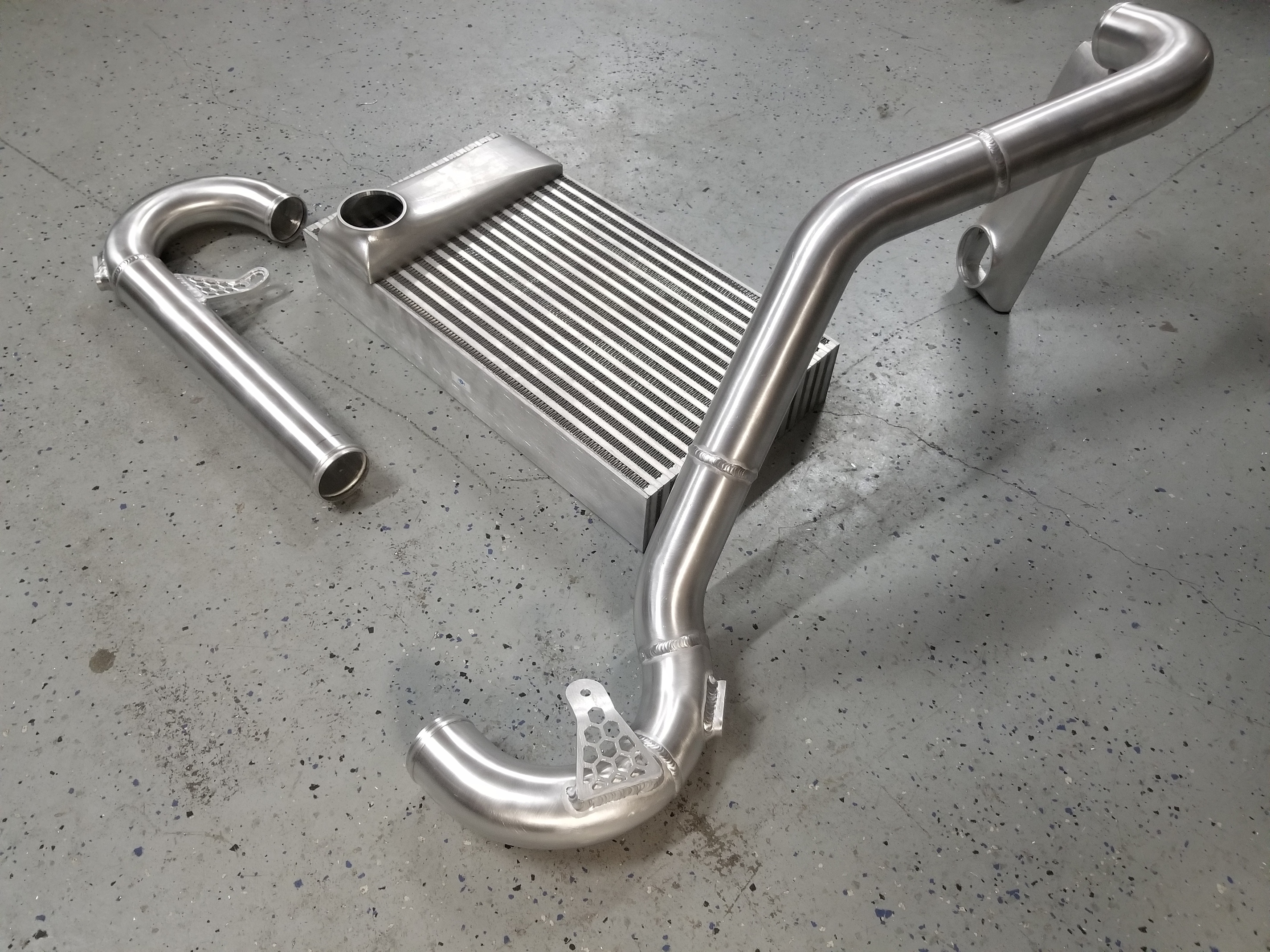

4am and the pipes are done, brackets torch annealed and bent then tig welded. They rubber mount to factory locations and another kit was already sold so its really nice to be able to cut another set easy peasy. With the cnc, I’ve been able to make 100% stock compatible designs that are infinitely repeatable. That’s the dream
Same low pro billet endtanks, bar and plate 800hp core
In case anyone is wondering. Those are dual temp/pressure sensor bungs for pre/post intercooler performance data
