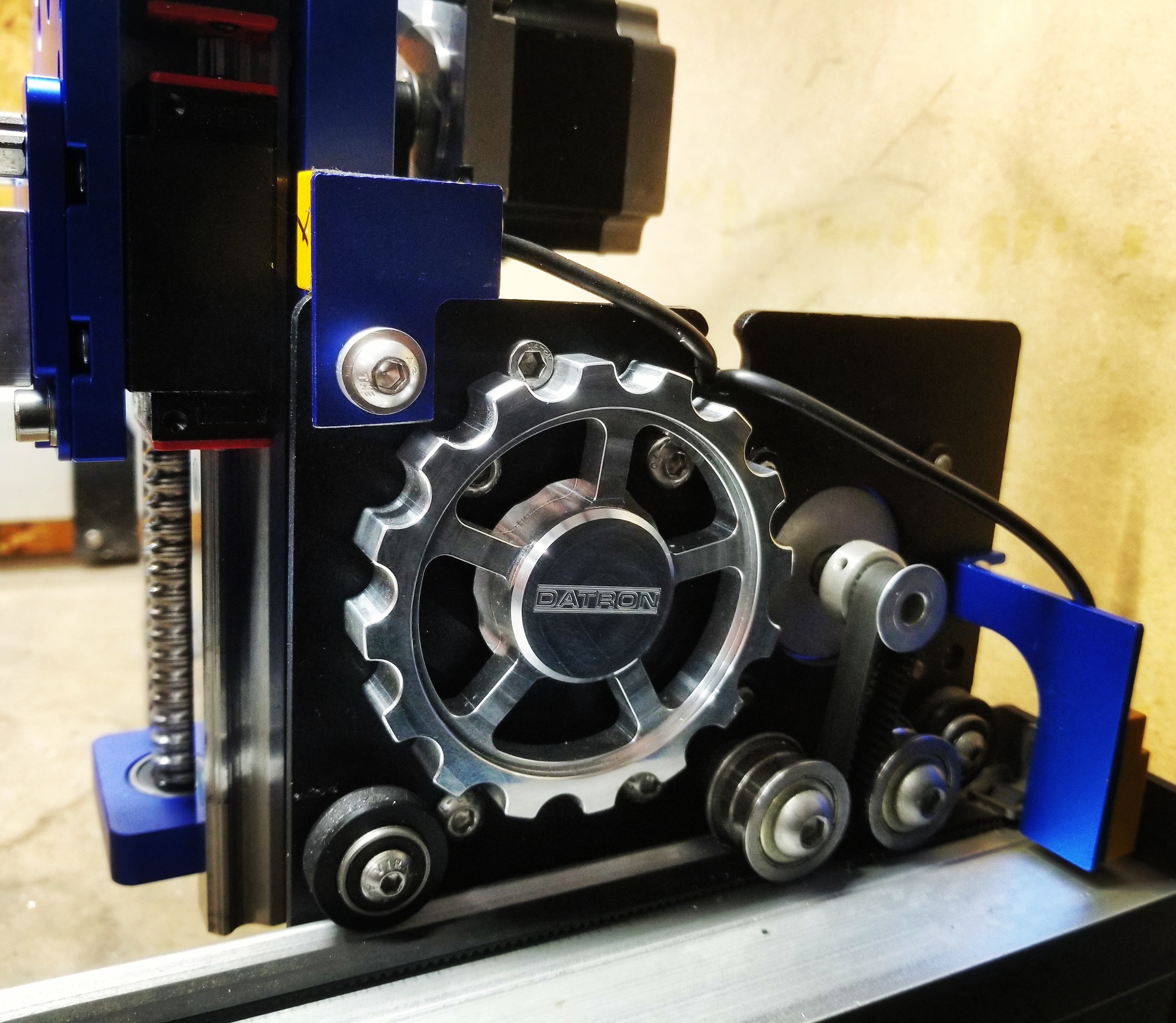

Hardcore Aluminum milling on an S3
wheel delete on X axis?
Go go gadget double trouble! Hopefully running two at 100%
Wow that’s the way to play. Double time. Like an Aluminium Symphony, light metal music.
Great setup, what is that mod (big wheel) on the Y axis?
It’s for his new chain drive setup!
But seriously, looks like bling to me.
Datron bottle opener made by a Neo. It’s a badass reminder of proper mini machining #goals

Found out where that pesky easy button was hiding. Mdf deck S3, HDZ, stock belts, carbide3d single flute, 95%dry/wd wall
