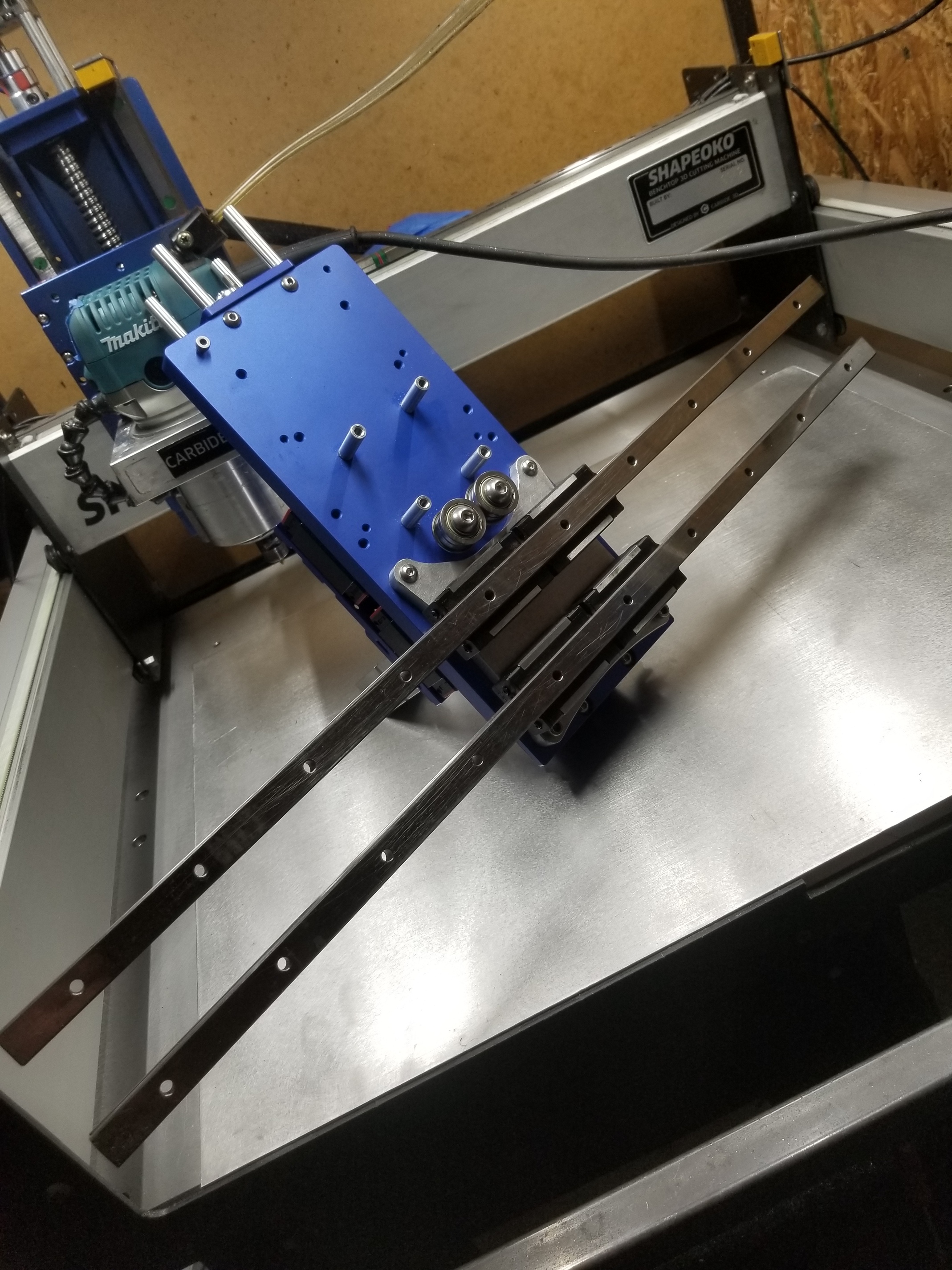

And…Presto, there it is, the linear rail Shapeoko X and, I suppose, Y.
Nicely done Vince, can’t wait to see some milling results.
Now you just need to move your Y steppers to the front to gain that loss of Y real estate back.
