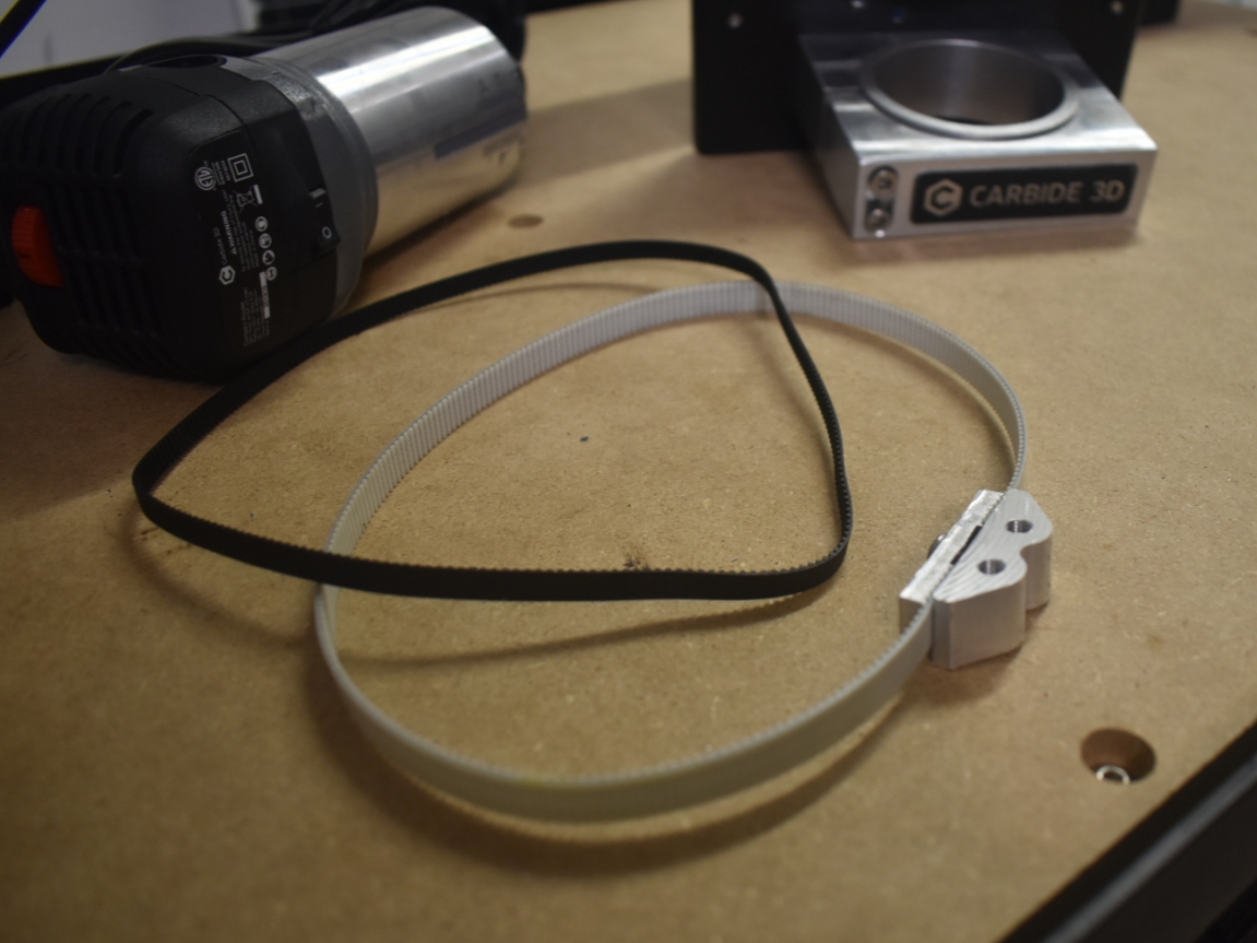

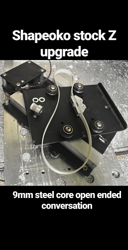

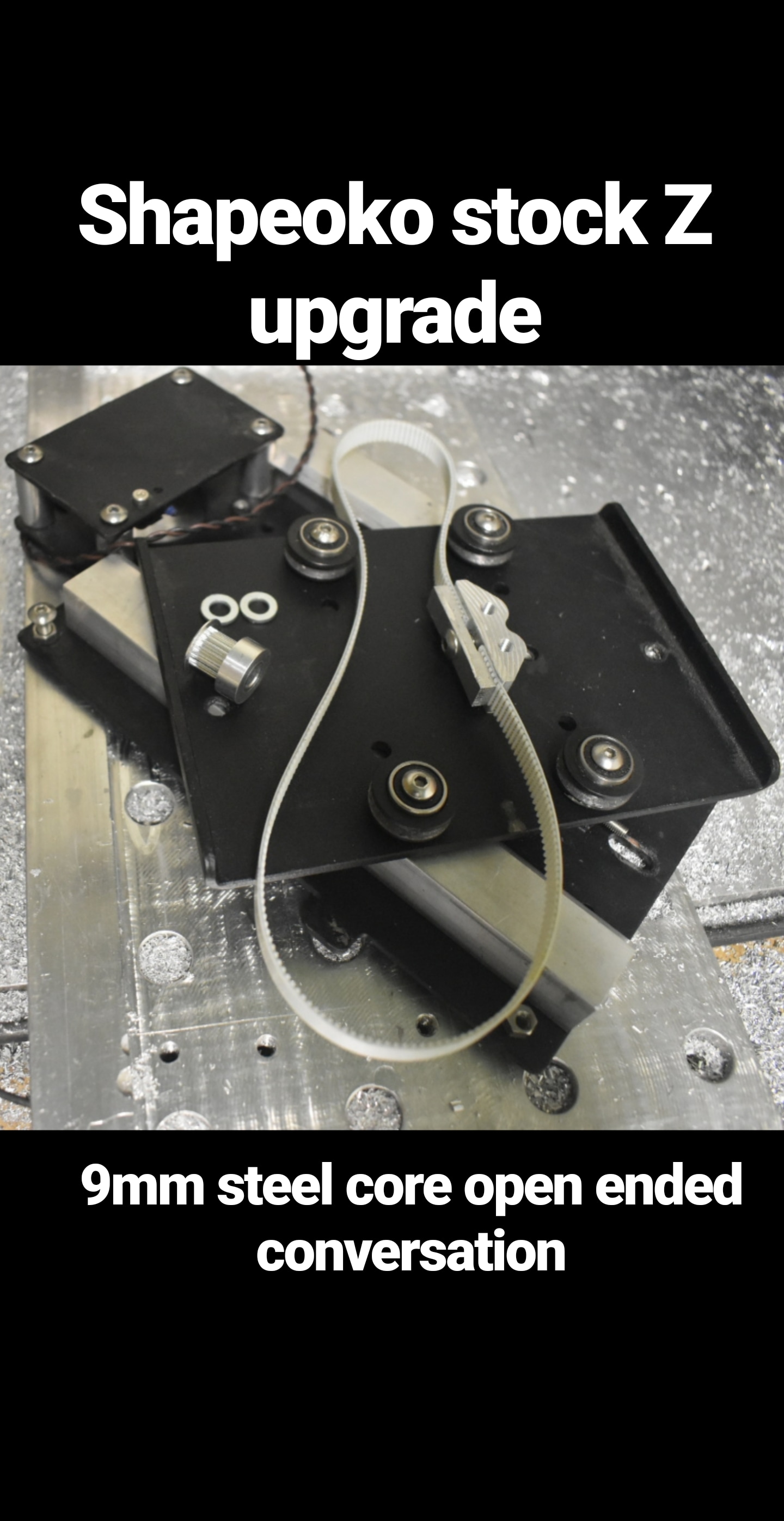

Load testing my new 9mm Z axis belt upgrade.
This was an 18lb load test with the billet upgrade and open ended 9mm steel core belt. With this upgrade, the Z axis can now output the same force as the X axis and use inexpensive open ended 9mm belts. Works seamlessly with carbide motion.
Video is sped up 2x. Jog travel speed on “Fast”

What happens when you power off the Z motor with that weight? :laughing:
Simple and Elegant btw :+1:
Two thumbs up mate! I’ve added it to my to-do list.
What a show off :stuck_out_tongue: Great work Vince
My thoughts…if Carbide3d tells everyone the HDZ isn’t for everyone… then we need to continue development on the stock parts for those other people. I’ve personally bought two HDZs and I fully support that piece of kit but it’s a good $$$ jump.
This 9mm upgrade removes one of the weak links and increases usability due to flexibility, you now can use whatever belt you’d like. It’s a simple billet bracket set that can be machined by the user with a 1/8th endmill and V bit.
“See a need, fill a need” - Bigweld

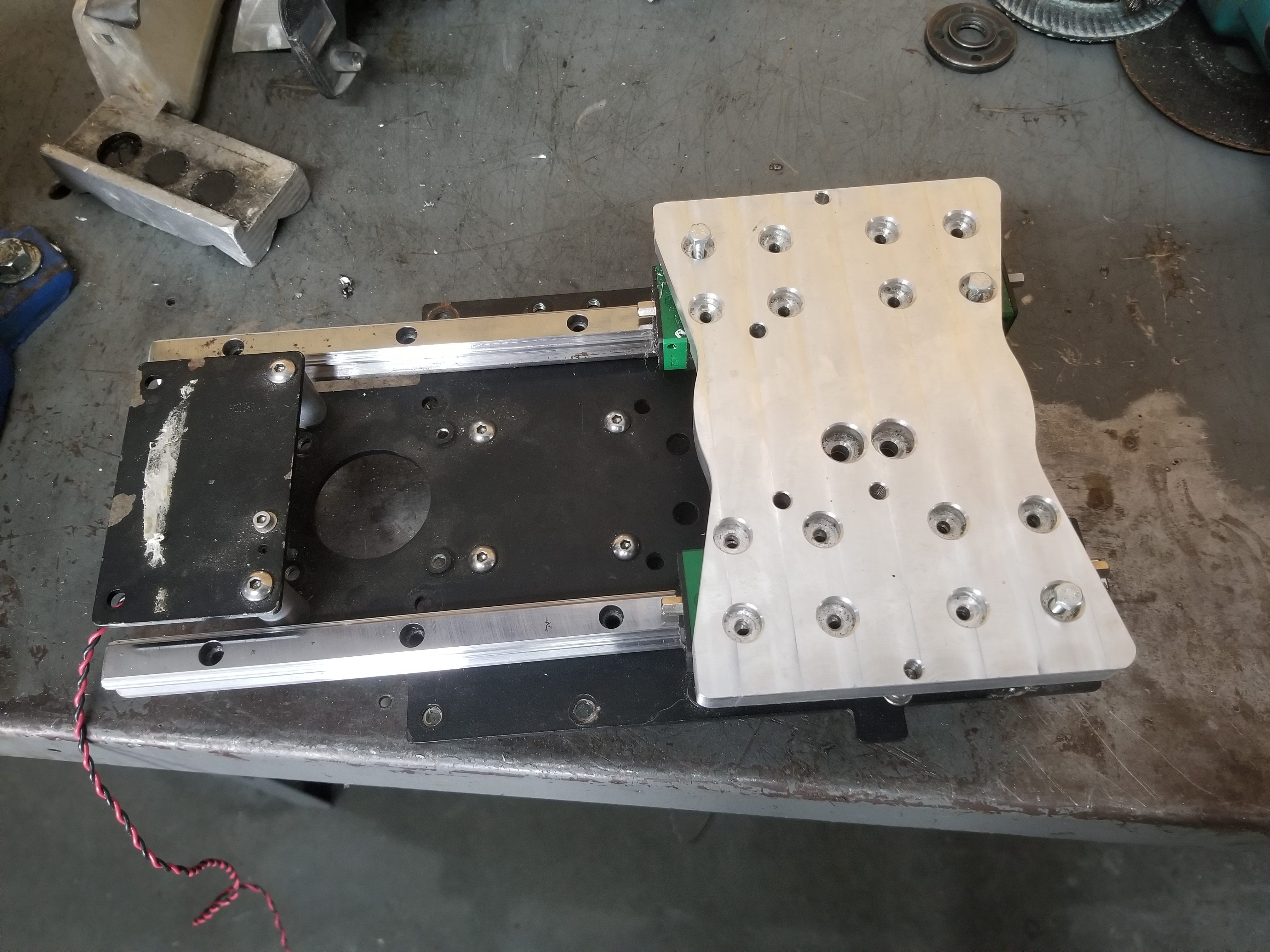

That with an EasyTram would probably go a long way for an inexpensive upgrade. Luke made those plans available free too. I used the easytram before getting an HDZ and it was stiffer than the stock Z plus it provided the ability to tram the Z in the X axis like the HDZ.
The main reason for this upgrade was to increase the drive strength for a 4.5" travel medium duty Z axis that’s almost operational. Its good to make these parts cross compatible with stock though.
I wouldn’t be opposed to making the drawings free but was thinking of a small charge, maaaaybe $5 for cam included. Made by a shapeoko, for a shapeoko has this certain ring to it :grin:
I’ll probably release these drawings once everything is finalized as well.

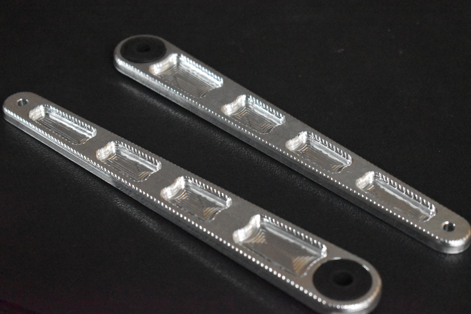

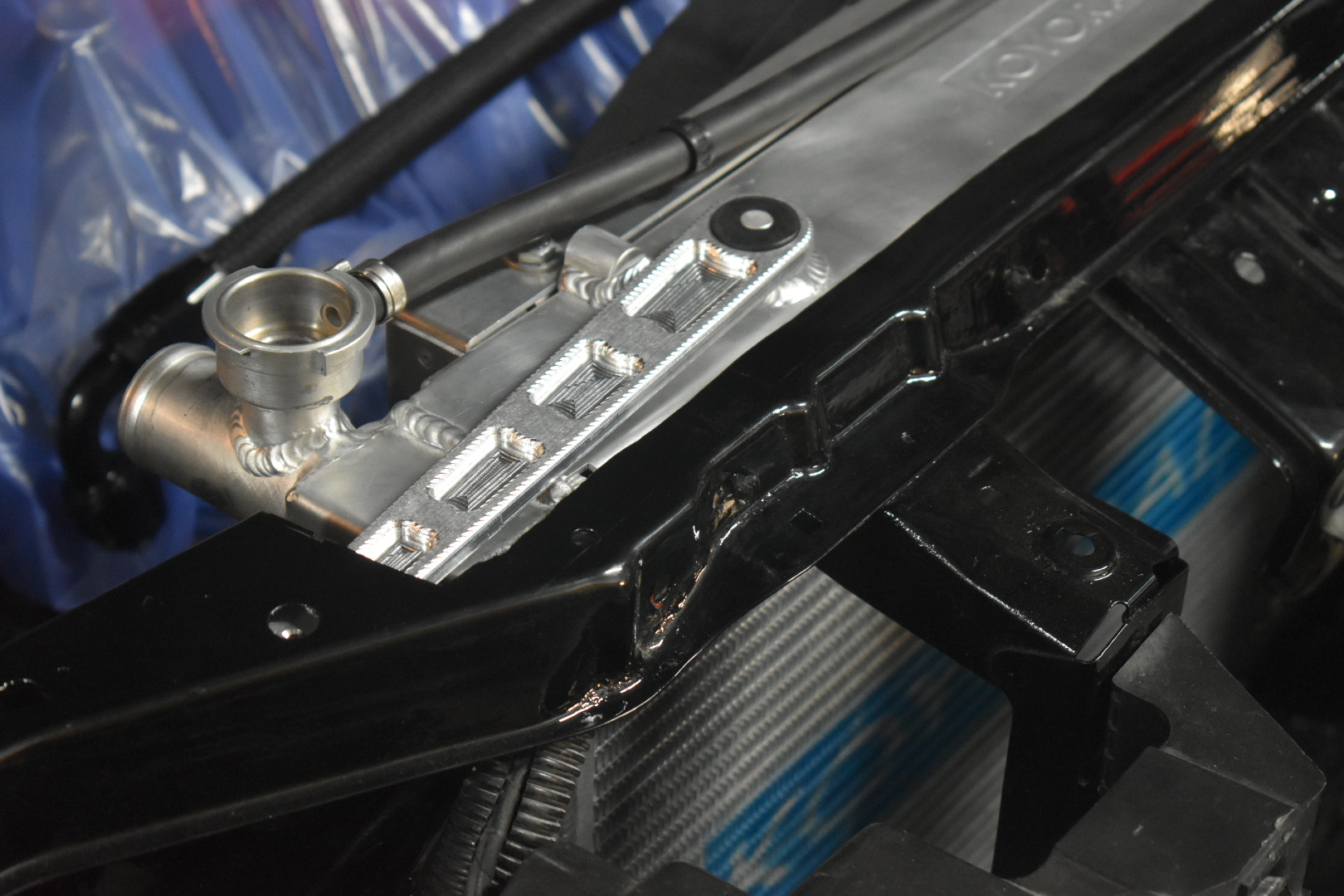

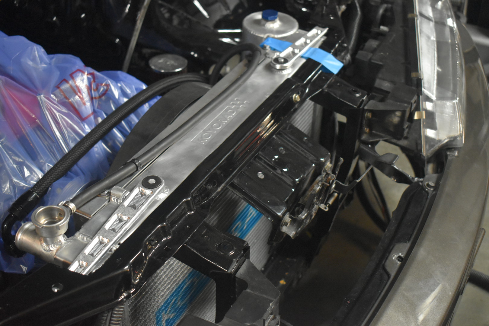

Billet radiator brackets for a 1000whp+ 2jz240. Practice in Fusion360 toolpath manipulation and bitsetter was used to post six toolpaths in one block.
Better look fast if you’re not sure you’ll go fast.
