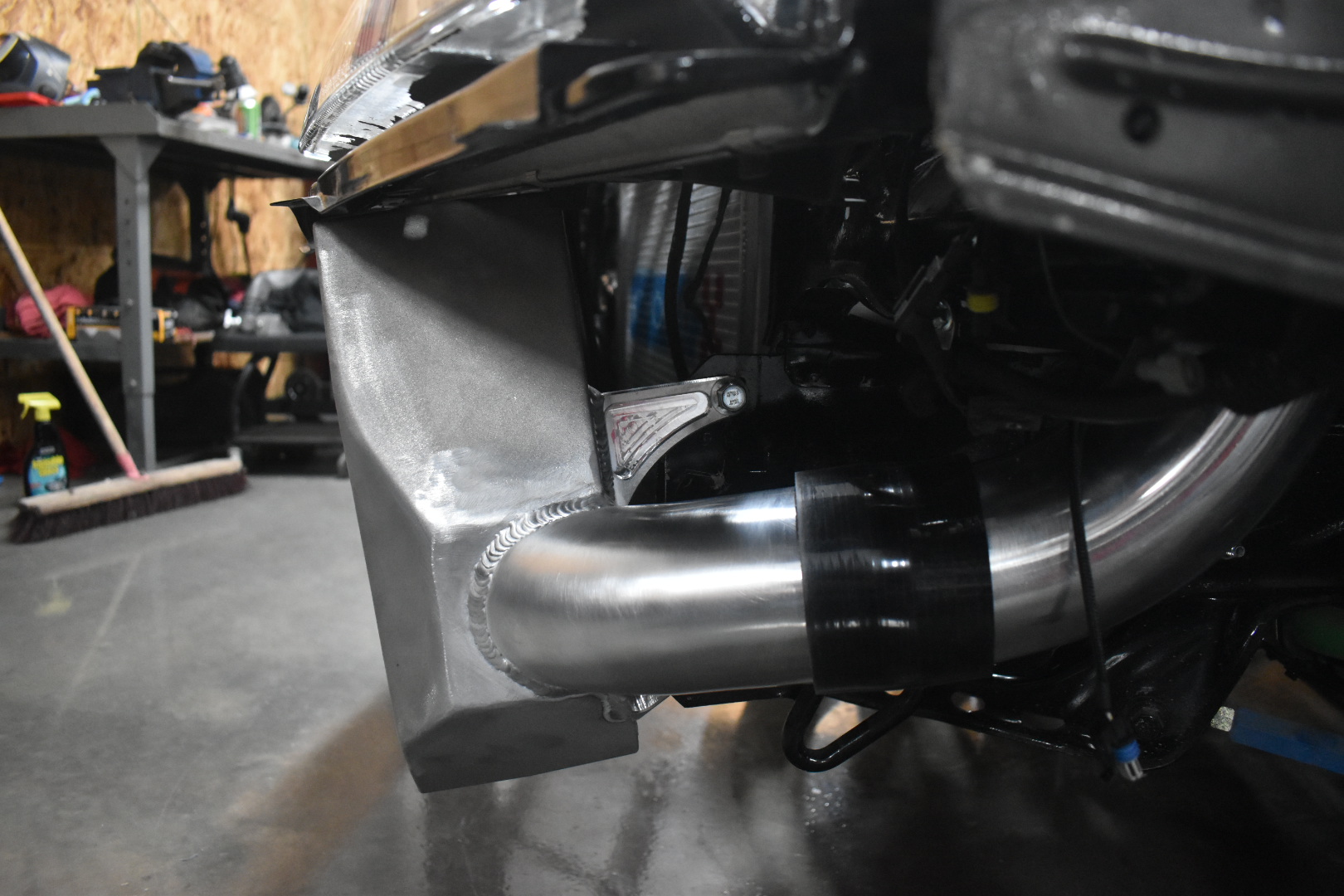

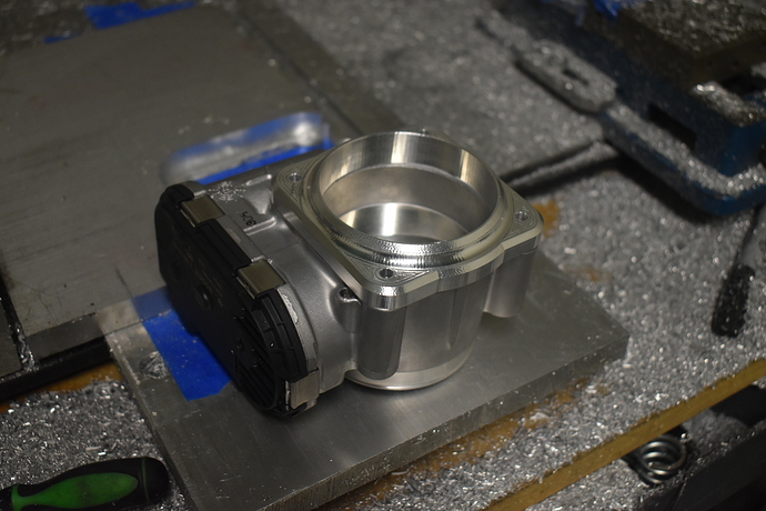

Whipped up 5 more billet brackets for the shop 2jz240. Single program posted, single toolchange via the bitsetter. Love the workflow and only 32 min for all 5 brackets start to finish.
Shiny purpose built horsepower :muscle:

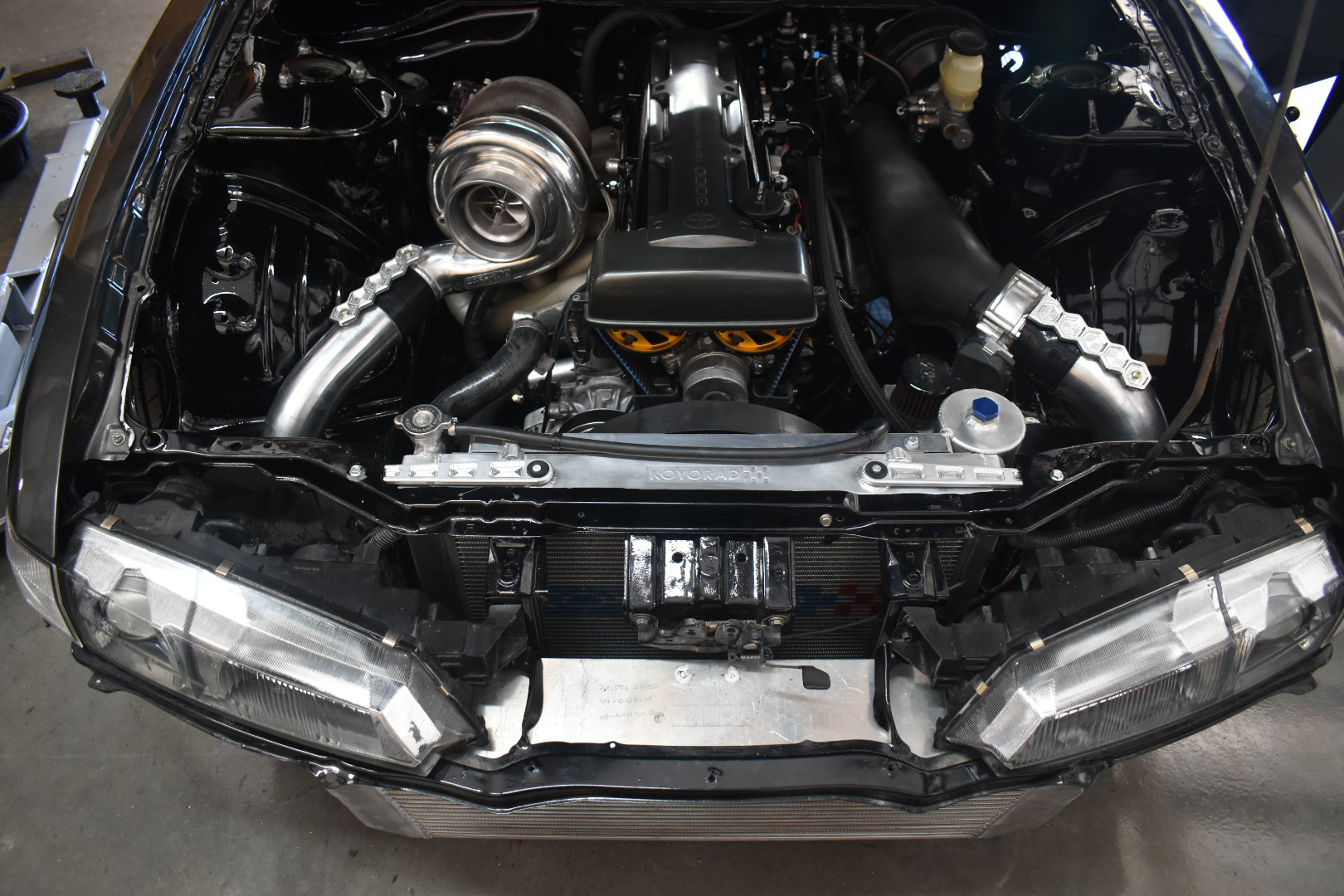

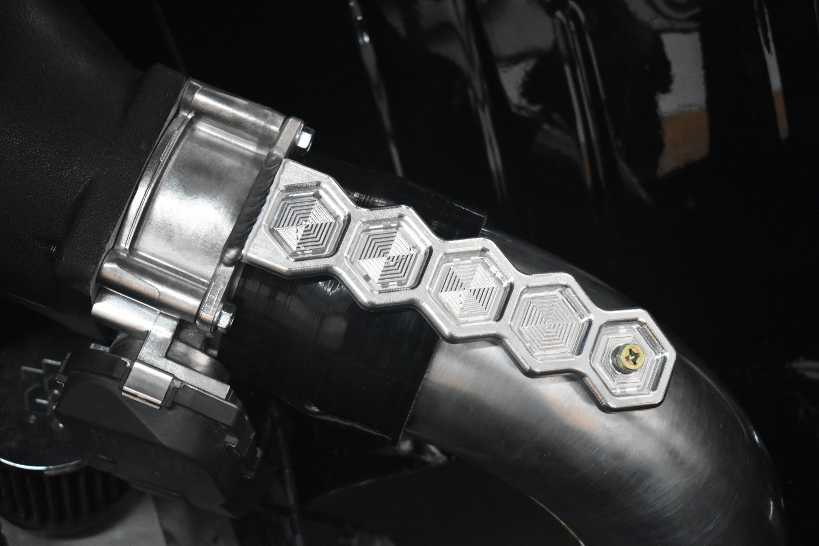

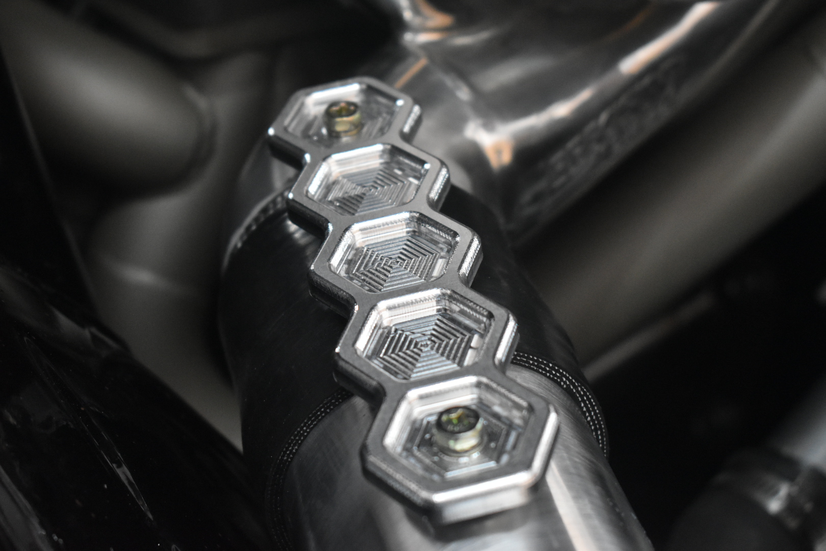

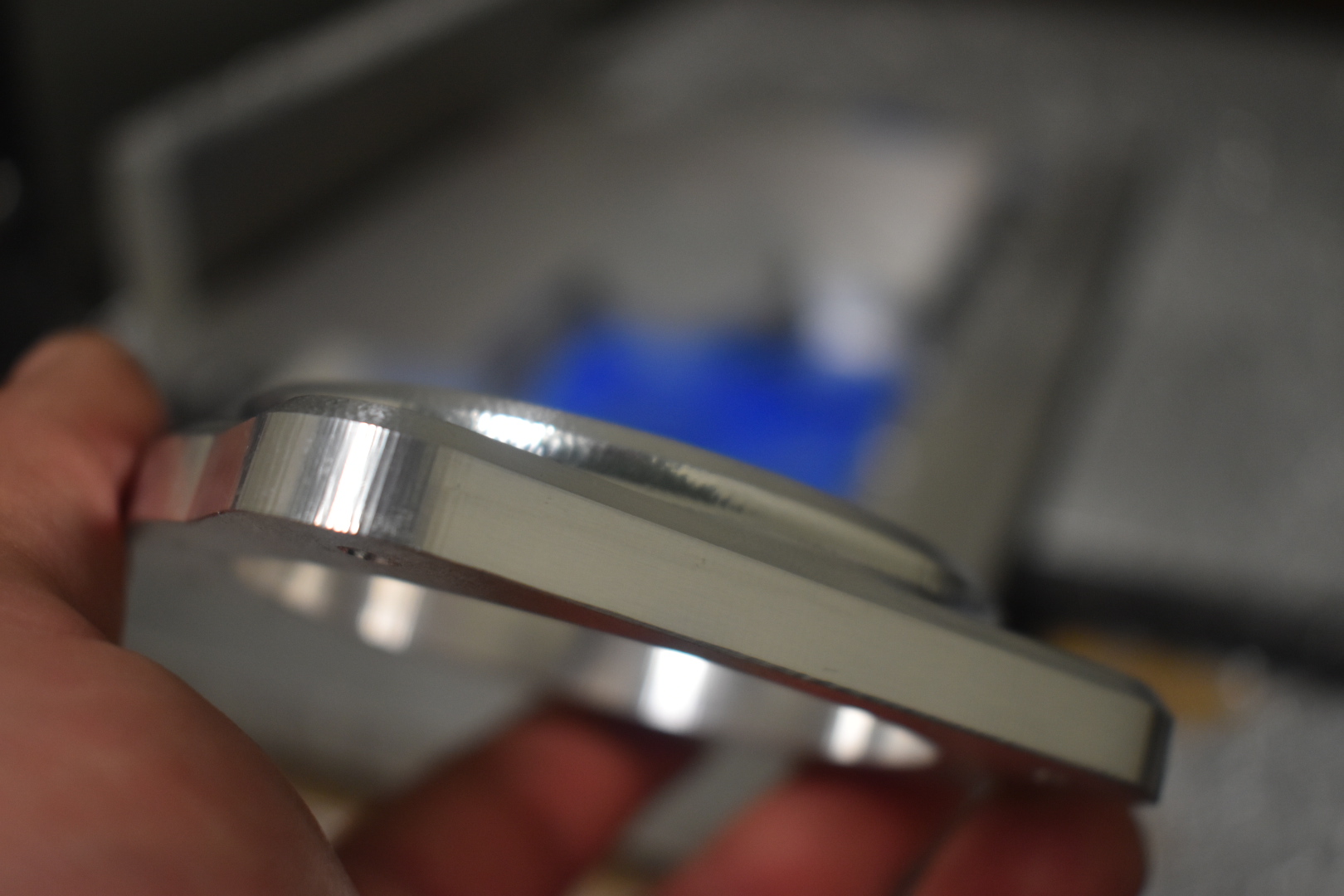

A few more pieces coming off the table. These are boost straps for just in case we run 60 psi of boost. Better safe than sorry and better shiny than boring.
Parts straight off the machine with a hand deburr on the bottom side.

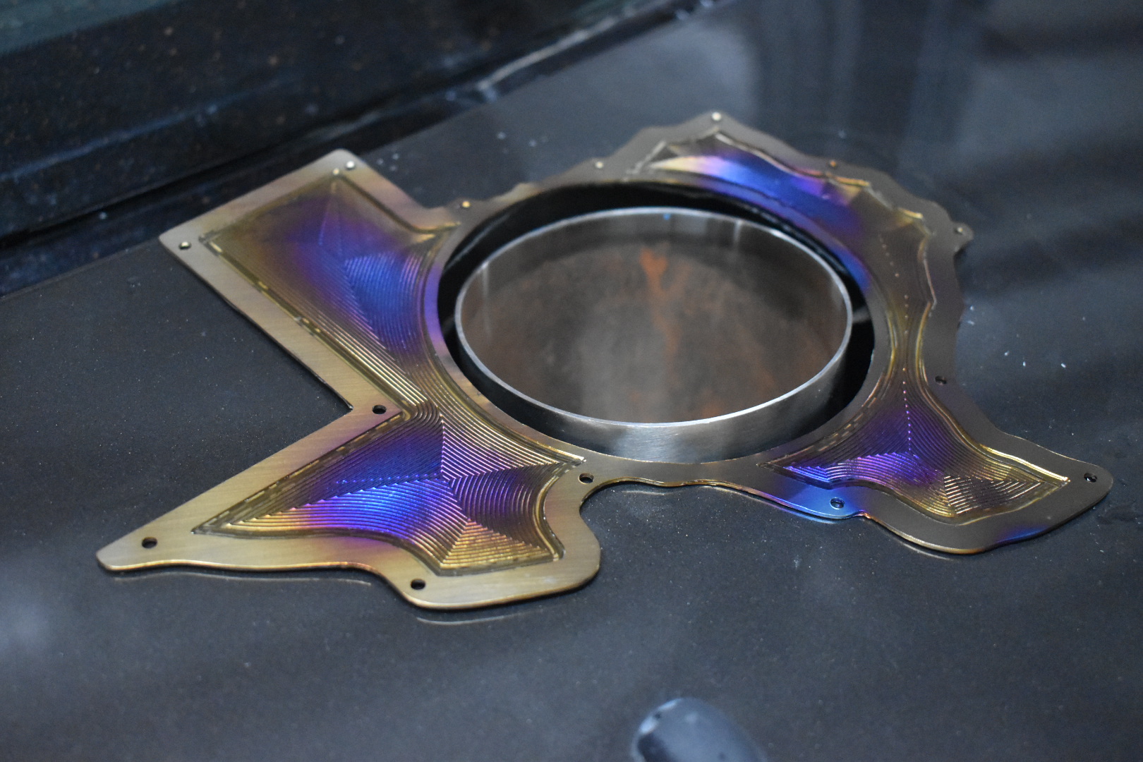

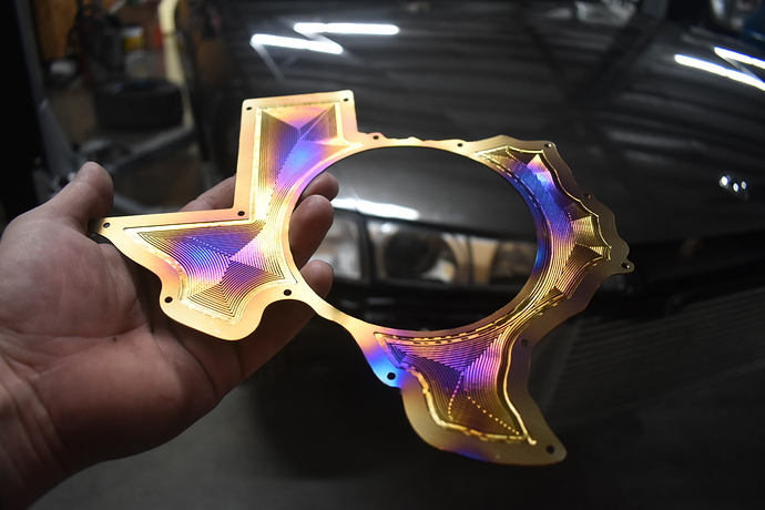

Splash of 0.030 titanium sheet with the same tooling as previous parts. SFM centric, bout 8,000 rpm
Vince, assume the coloration is due to heat buildup over time?
Constantly humbled by your work, keep it coming.
RMW
The color is from a manual torching to artistically oxidize the surface with a torch. Titanium is actually pretty weird with heat, it tends to build and localize so SFM while milling and chipload needs to be on point.

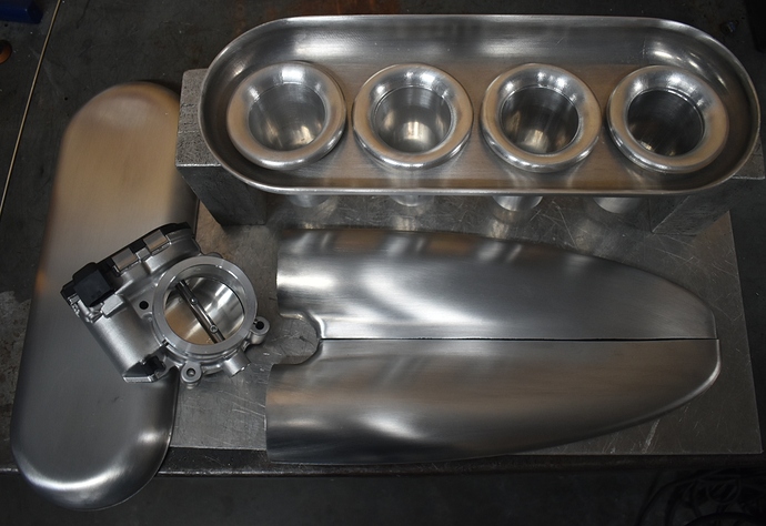

Good thing it’s easy to make spare parts. Had a little data recently on an intake plenum that prompted a slight redesign

Vince, when I had a Haas VM2 many moons ago, I spent some long nights breaking many of my finest endmills on a few dollars worth of 6/4 Ti, and I am genuinely curious how you milled Ti alloy with such a smooth finish. I thought I recall you saying you were running hss cutters on your Al work, but I can’t imagine that’s the tooling you’re referring to here. Are you using Autodesks HSM, to keep the loads uniform? That looks fantastic. The mind boggles.

I started off with hss tooling to learn on the shapeoko but have since moved onto all carbide due to wear and high speed characteristics.
That titanium plate actually didn’t require any adaptive (constant load) toolpaths. It’s all about not running too high an sfm (I used 260) and taking a bit enough bite to carry the heat away. The pocket toolpath was actually a horizontal with a ball mill that took two steps of 0.005 doc and a high stepover. I can post the file for you if you’d like to see. The inner and outer contour was cut with a $1.50 endmill that I’m not so sure was even designed for metal lol.
