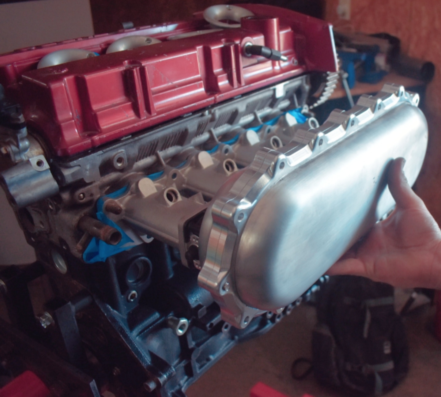

S3 + HDZ had no issues chopping up a 6" tall plenum…yes that’s a ratchet strap. C3D 0.250 SF no problem with the 5052 formed sheet and welded area.

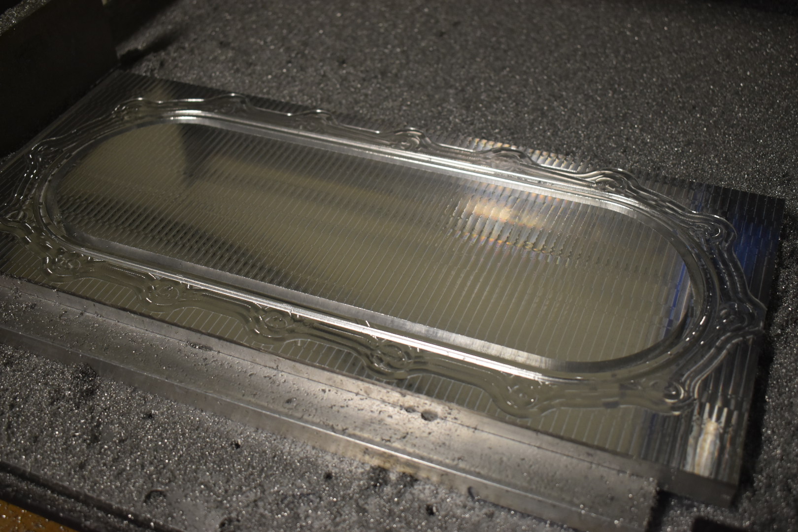

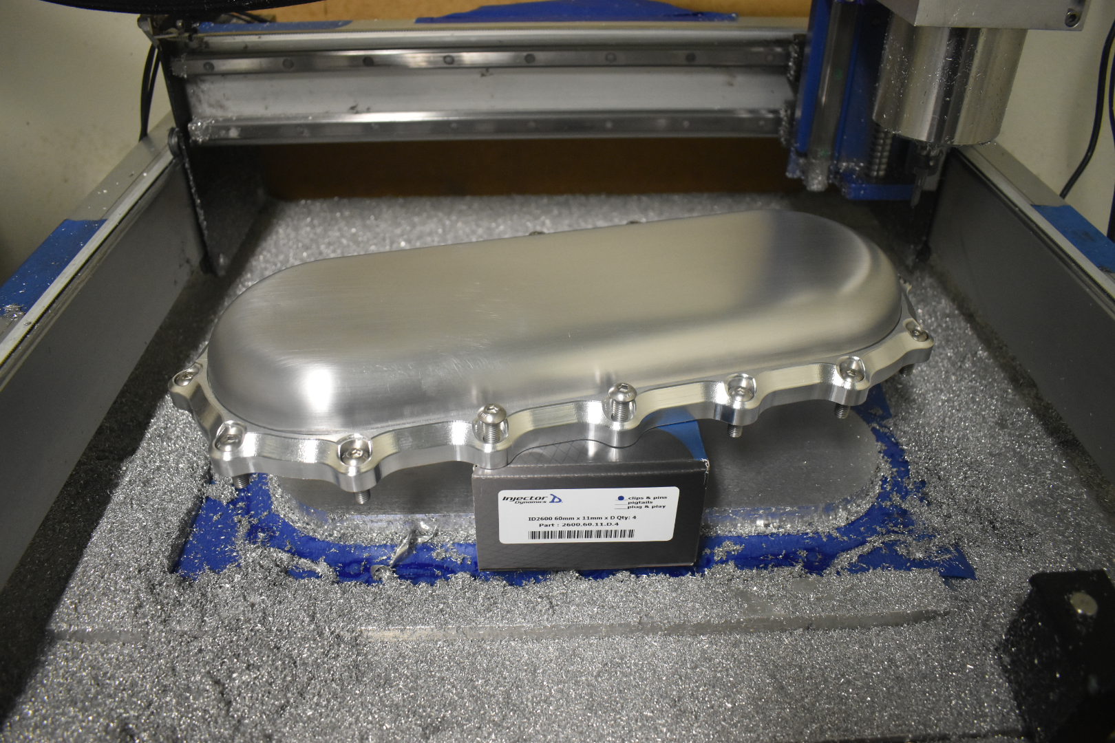

Carbide3d 0.250 SF and Datron 6mm single flute ball just killed it on this project! Side one done and done. These parts are right off the machine, no deburr no polishing, just butter feeds and speeds.
The flip turned out really well with just good, square stock and the 90 degree fixture plate. Superglue/tape setups used for both sides. Fusion360 for cad/cam and Carbide Motion for sender.
Started out life as an 8x18x0.750 6061 plate.

The full width inner and outer contour cuts were done without a roughing or finish pass. Chipload was 0.0015 with an axial doc of 0.015 and ramp/plunge set at 0.001 chipload. Chip clearing was almost entirely up to the endmill alone and minor light oil spray was used every other pass when axial was past 1xD. Hdz plus this strategy proved very consistent.
The ball milling was a trick from Marv over at Kern. A matching chipload with stepover can produce very good results. The finish pass was 0.002 chipload with 0.002 stepover with bottom to top milling in a ramping toolpath. This was important because the endmill would always be side cutting and the ramping ensures a constant toolpressure. The tool used was a 6mm Datron single flute, this ran at max speed of 24000rpm and really it’s just a beautiful tool.
While not as technical as some of the others, works for me and finish is getting better on each project. I also should add, the bitsetter really makes the workflow and overall product quality much better.

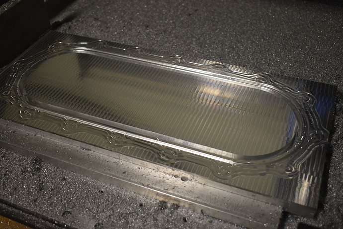

Trying to take surface finish closeups. It’s super interesting to see the differences between linear rail and V wheel motion. Tolerances were set to 0.0001 in fusion
edit the top hole chamfer was done by hand because they still need to be tapped and proper deburred
This is straight off the machine without any polish or post processing.
