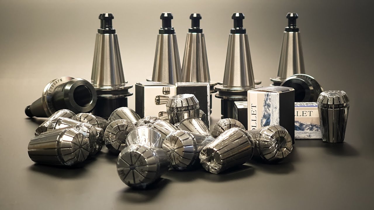

What do you use for collets / collet nuts?
I use all these collets:
10pcs/set ER20 Spring Steel Collet Set for CNC Workholding Engraving Milling Lathe Tool 3mm, 1/8"/4mm/5mm/6mm, 1/4", 8mm, 10mm, 12mm, 1/2"
And a couple extra 1/4" and 1/8" Collets
And these ER20 Nuts

Those collets are very cheap and likely have lots of run out. The collet nuts do not seem to be balanced. The reviews on them agree with my first two statements.
You can get nuts that are balanced to 18k from PWNCNC and 20k from PreciseBits. For collets you can get them from either PreciseBits or Maritool. PreciseBits sells collets with a TIR of 0.0004"-0.0001" and Maritool sells them with 0.0003".
I get the same low cost collets Mr Fox uses in his video and they have been both affordable and running true.
I got really nice 24k balanced er20 nuts for $13 each from Avid cnc
https://www.avidcnc.com/balanced-er20-collet-nut-p-476.html
I also ordered the same ISO20 tool holders he recommends but won’t have any input on those until my ATC gets here and is setup.

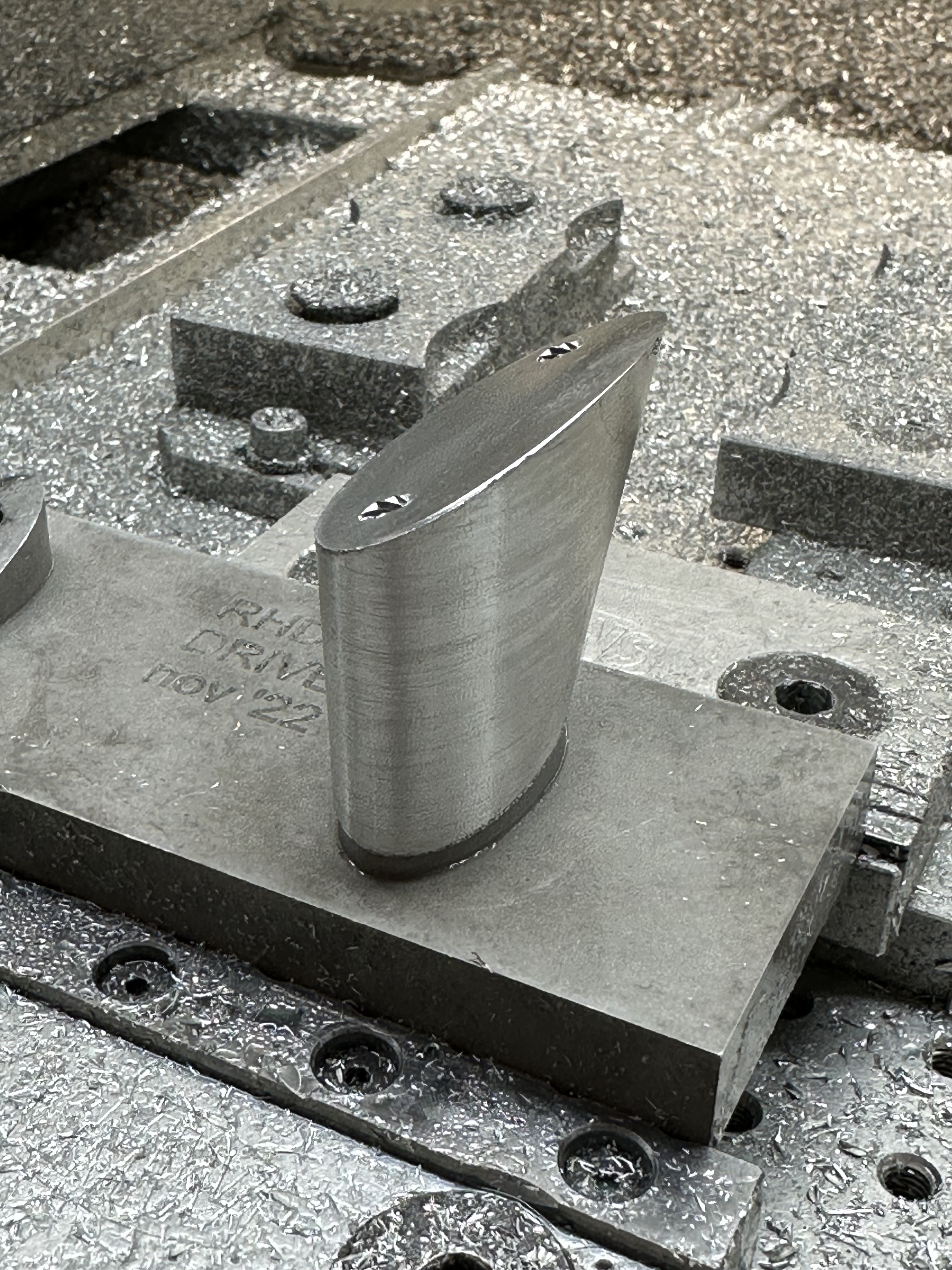

24,000, 1.8mm doc, 9mm stepover, 2000mm/m with 5mm lead ins. If you guys do not have it yet, Millalyzer is a golden tool to have when setup right. It was almost spot on for what I could get out of this 10mm after inputting my thoughts on the 6mm cuts I posted here above. I feel like the hdms cut maximum is going to be somewhere in the range of 390-450w of actual cutting power given how much delfection im getting now. The above cut is 407w with mql mist going and 526w with no mist. Im not sure it would be able to handle the shear temps very long without mist not taking into account the extra delection your going to have. Gonna drop my 10mm 3fl roupging feeds down to 1.5mm doc and keep the rest. The machine was much happier there. The nasty resonsnce you hear is the gopro camera clipping in and out. Its no where near as bad in real life but it is very loud.

That’s beautiful! Is there a return on making these for others?
We make lots of custom parts for builds, variations of this shifter is one of them
A good amount of that vibration also comes from the stock overhanging the vise and having no end support.
If you are getting deflection try increasing the Doc and reducing the Woc and you can get a good boost in Mmr.
You will be using more of the cutting edge, reducing radial loading, and get those cuts done in 1 step down vs 3.
10mm tools are almost 3x thicker than 6mm and can be pushed a good bit harder.
Perhaps try 10mm Doc, 1.75 Woc, 2540mm pm feed for around 44.5cm to start and you can probably increase the feed rate a bit depending on how it sounds.

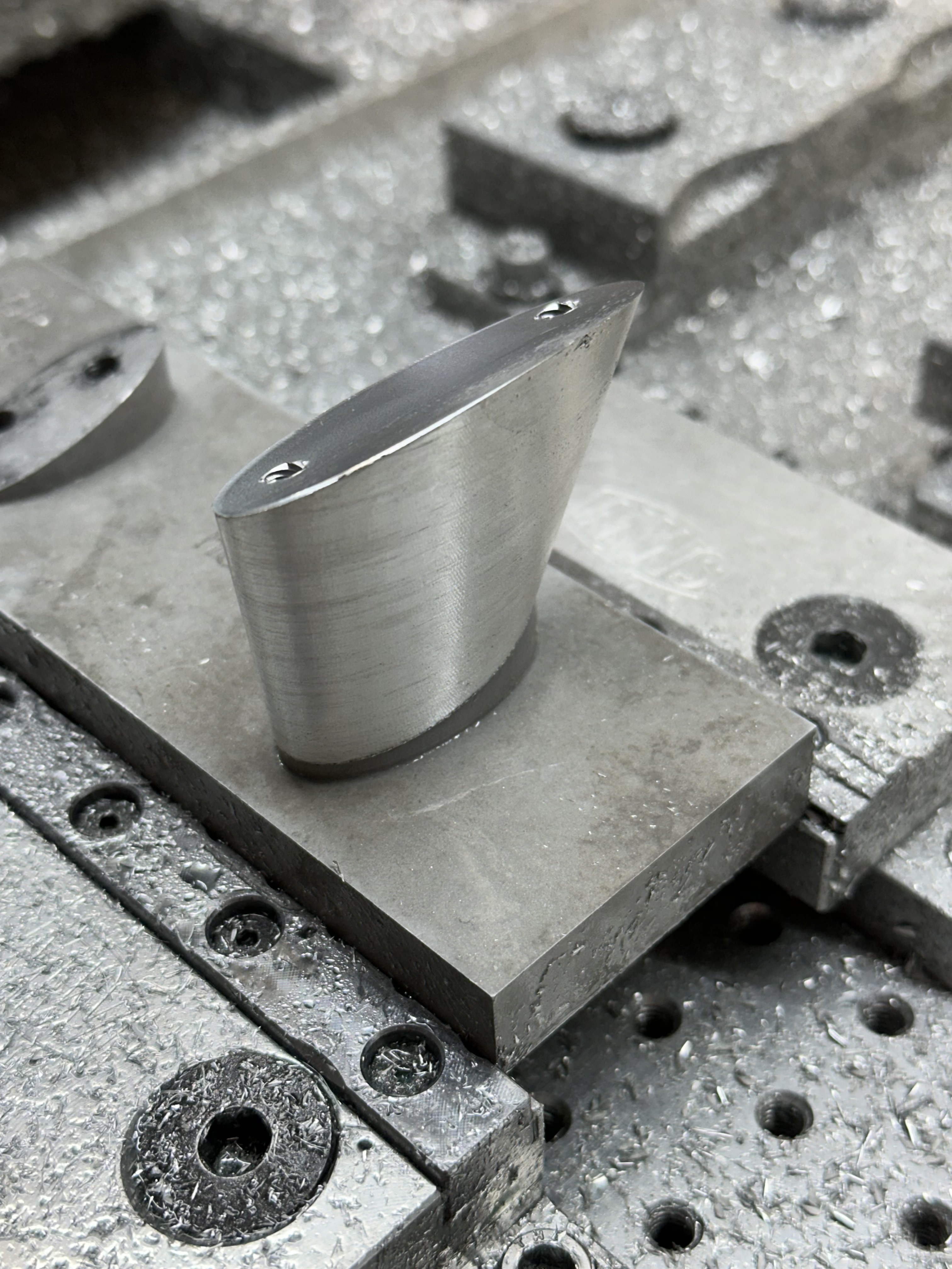

Everyday the HDM makes me happy, knowing we can make custom one off parts or prototypes right in the shop. These are RHD mirror arms for an Australian client, no need to stock inventory of the one unique part that’s different.
