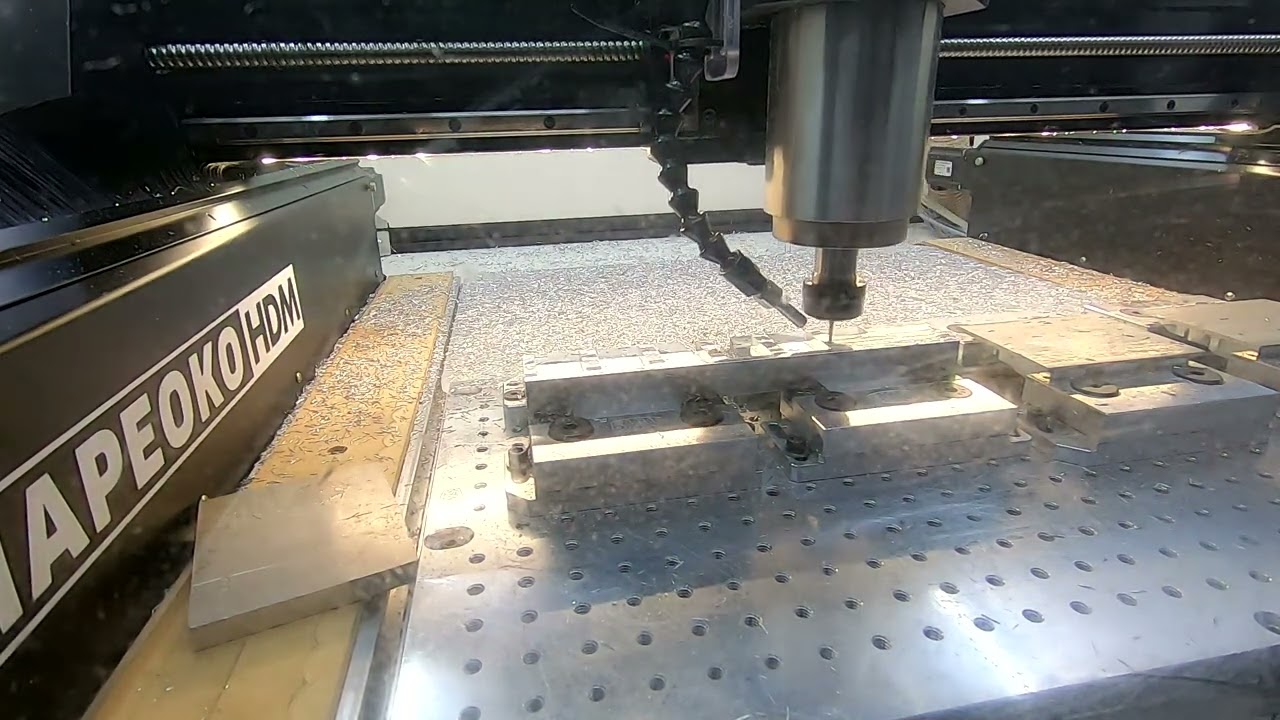

I love the look of freshly milled aluminum. Just a upright part holding soft jaw / jig to hold my parts so they can be drilled and bored to spec. This is the last setup for my first 3 sided parts. The parts sit in the pocket and through bolted from the back then will be held in the vise with another soft jaw. It’s probably over kill but I don’t want them pulling out when drilling so the bolts will make sure that can’t happen.

On the second set I really started pushing my 1/8" C3d Zrn coated end mill and was really surprised by how hard I could run such a small tool.
2d adaptive .125" Zrn Single Flute at .25" Doc, .018" stepover, 20k rpm, and with the feed override I settled on 88 ipm. I was waiting for it to jump to the spirit realm but it cut with no issue but I only have one so I wasn’t willing to push harder. I will post a video as it ran over 30 minutes in the cut at that feed.
I started at 55 ipm and ramped up to 88 by ear it ends up being .0044 chip per tooth.
The stepover / optimum load was .018" not .025"
Was that the single flute or two flute cutter you were using at those rates?
274Z Single flute with air blast and Coollube 2210AL. I think cutting that heavy dry would cause a failure.
Well I had to run another duplicate fixture after this video and bumped the feed rate up to 99 ipm and it went smoothly for 40 minutes with great results but it’s now limited by the machine acceleration in short pockets but still beyond what I thought such a small tool could do. No room for errors going this fast at 2x the tools diameter in depth of cut though. That’s over .0045" chip load.

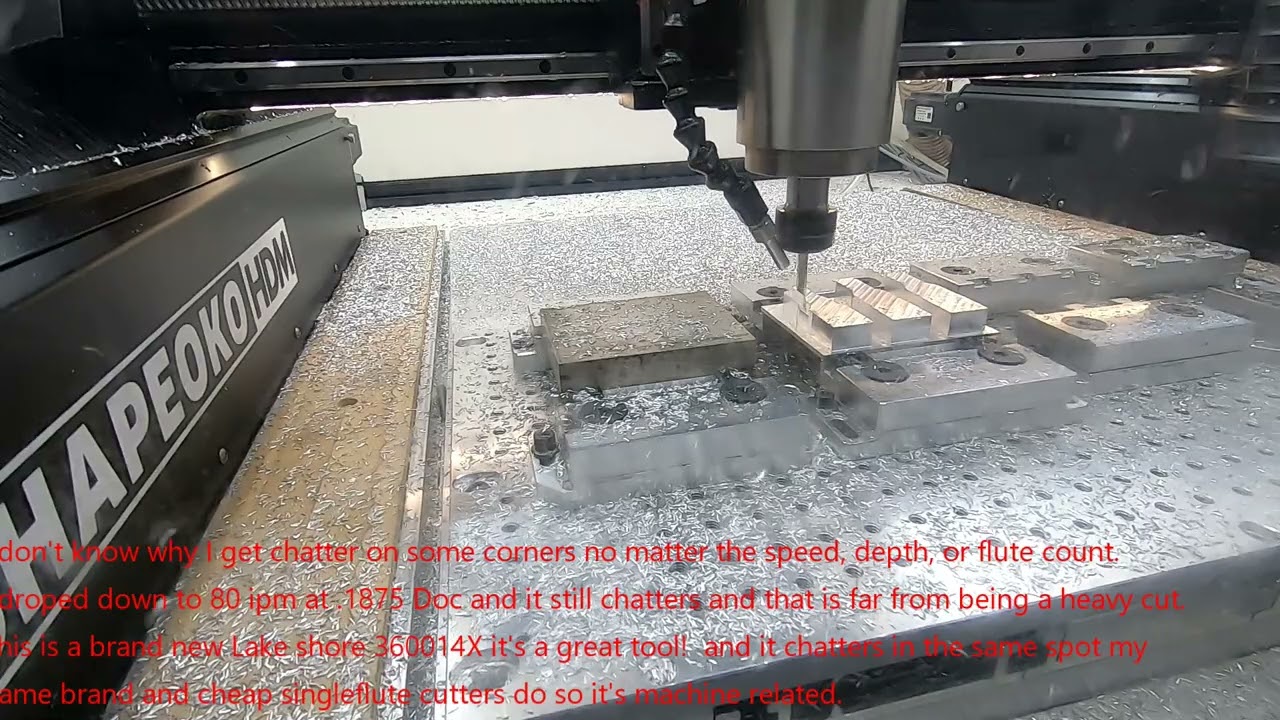

I see in your 150 ipm video you get chatter in the corners and I’m having the same issue. Every part of the cut sounds great until the corners. It doesn’t matter if I’m using a 6mm single flute or a brand new .25" variable 3f with chip breakers it does this. Even going from 1/2" Doc to 3/16" and slowing down to below 80 Ipm at only .035" stepover. My machine also has a strange resonance when jogging using the pre set CM points but only when going diagonally it vibrates the entire enclosure like a speaker.
Any ideas why this happens?
I do like Lake shore Carbides variable flute chip breaking rougher finisher mills with the .005" corner radius. They are chip slinging beasts when properly cooled and they leave a pretty damn nice finish.
I did murder 1 by being greedy with the feed override and not adjusting my mister in the narrow portion of the roughing operation to properly hit the tool and chip welded it at 140 Ipm at 24k .55" Doc .035 stepover adaptive. Ended up running 110 ipm with it’s non corner radius brother.

The chatter in the corners is interesting. Especially being an outside corner?? I have a shapeoko3 with the steel core 10mm belts with a similar situation. If cutting a circular pocket in aluminum, it only chatters at about the 1:30 and 7:30 positions. doesnt seem to happen (at least not as pronounced) at the 10:30 and 4:30 positions. fast feed, slow feed…1 flute 2 flute…etc and all at much more conservative parameters than what you are running.
I chalked it up maybe some loose v-wheels or something. but seeing a similar phenomenon on an HDM does have me wondering. The search continues!!
Does your resonance happen when jogging in both diagonal directions?
I am looking at using the option in Fusion to slow the tool path on certain parameters like when doing an outside corner, etc. I will test this week and see what I can do
