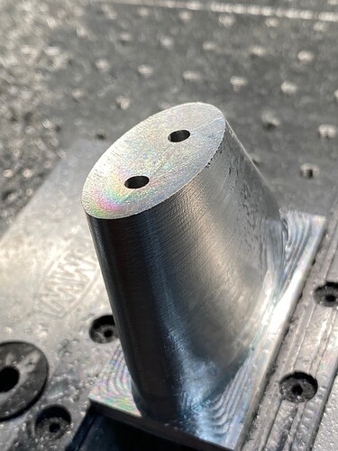

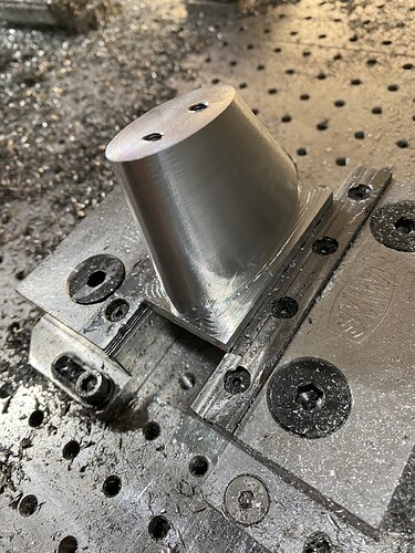

I am not sure if you will be able to achieve a better finish on a 3D surface like that on a machine of this class. It already looks pretty good.
After you get the parts cut out you could try using a tumbler to get a smoother finish. If you reload ammunition or have a friend that has a tumbler you could try one of them to see how they finish out. The media is important. They make walnut and corn cob media for reloading but they also make ceramic pieces for things other than brass shell casings.
Maybe take a look at this for some inspiration on how to improve the finish? They are using a tormach 1100MX which is a step up from an HDM but the principles will probably transfer well enough.
Thanks, I forgot about that video, just rewatched this afternoon and did a quick tweak on some speaker grill finishes… went from 11000 to 24,000 and the finish is almost perfect!!! Another test tomorrow but when I dial it in I’ll share. It seems the higher rpm helps some with the finish too
