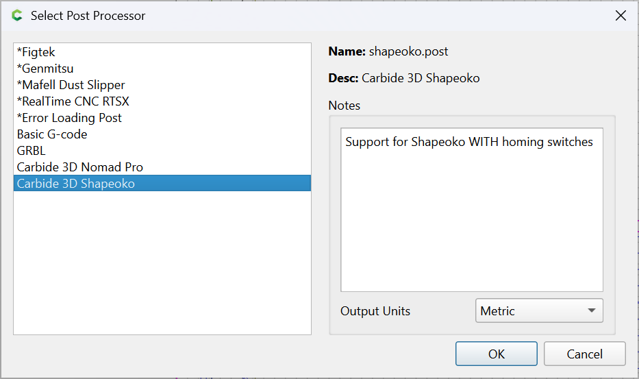

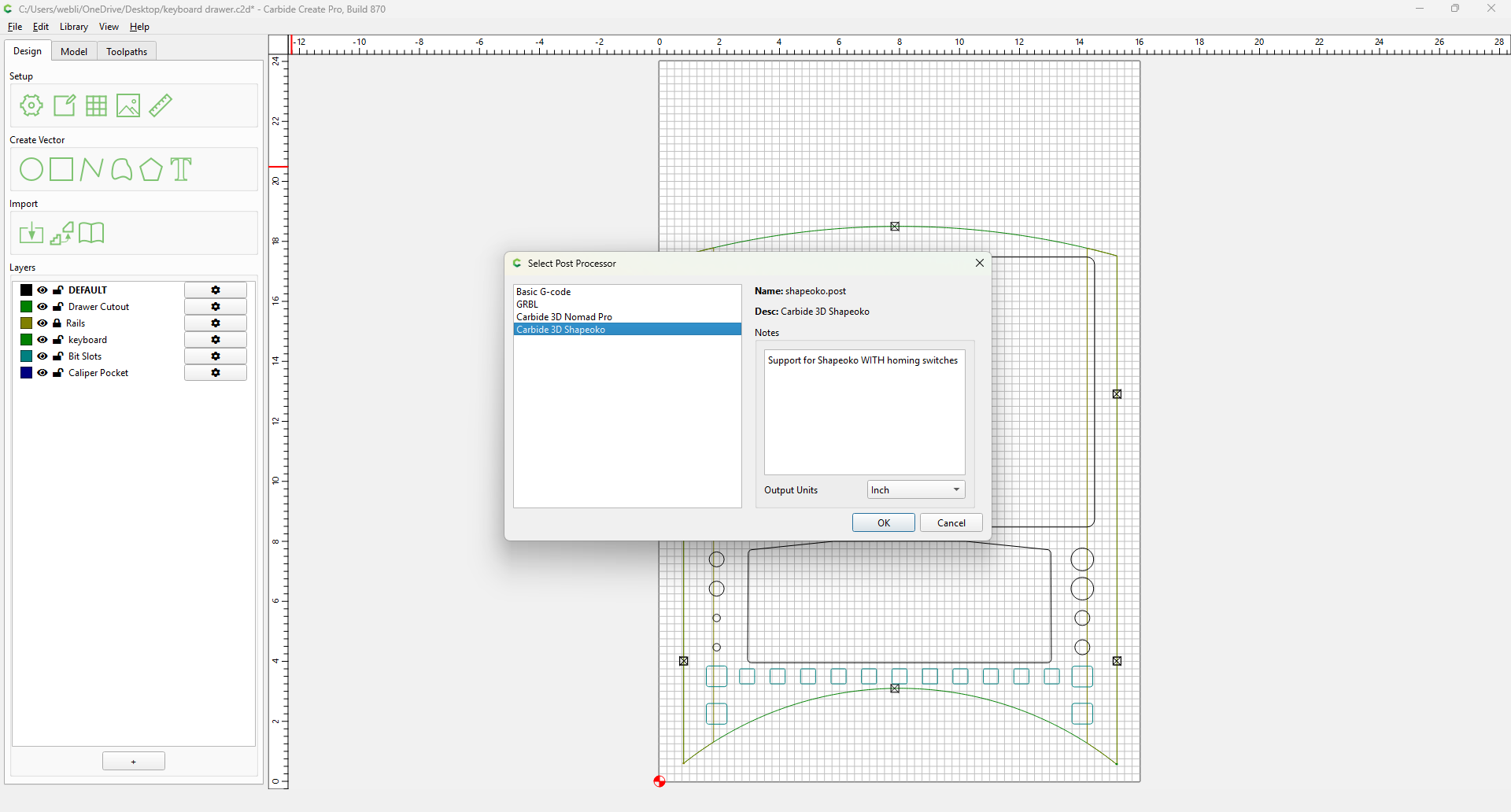

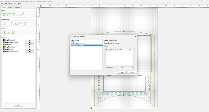

What post-processor did you use?
You need to select one which supports tool changes.
such as Carbide 3D Shapeoko.

These are the only options I have and I tried the basic g code and the highlighted one: Carbide 3D Shapeoko. In both cases it specifies the wrong bits and they don’t align with what my toolpaths are set to.

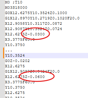

I appreciate the help. I actually worked with Gemini on the issue after I couldn’t figure out why nothing would change in the output to gcode. Seems CC doesn’t always update the actual gcode if you make a change to the tools in the tool library unless you reselect and recalculate the toolpaths. I went through each toolpath and did just that (and adjusted some values like ramping, etc.) and that did the trick.
However, this brought up a new issue for me: the first toolpath is a pocket, and somewhat large at that. For this (since I don’t have my McFly mortising bit yet) I used a Diablo 3/4" mortising bit. Please note that for this pocket I’ve set the depth to .1" deep. I wasn’t paying attention the first go around because it was the wrong bit for the job, but just like the first time the bit plunged into the stock probably half an inch. In the gcode, the simulation and all of the settings, the depth is set to .1", but I can’t figure out why the controller read something different. I couldn’t find the z-depth that CM thought it was supposed to go to, but I did test the Z-zero and it was correct to the stock height.

The Z depths in your Gcode look correct

Not sure I understand the “wrong tool” thing. The only thing in the Gcode that’s pertinent is the “t” word
M0 ;T10 (manual tool change. M0-Stop, T10-Load tool #10)
M6T10 (auto toolchange, M6-toolchange, T10-Load Tool #10)
CM on M6 stops, prompts for Tool #10, then measures the tool if BitSetter is enabled.
On M0, it just stops & prompts for tool.
So as long as the first tool number is 10, either is correct.
