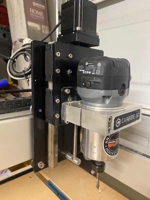

Do you have the original Z axis? The belt driven one?
I have this one
That is a z-plus also refereed to as LeadScrew in configuration.

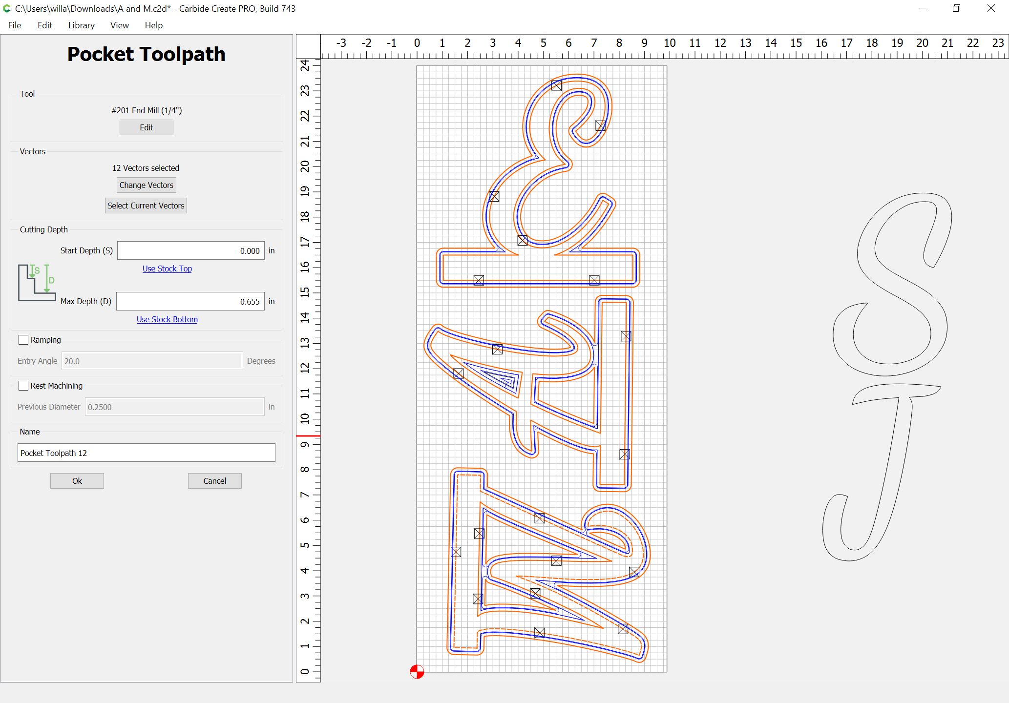

You are cutting a slot deeper than the flutes on the endmill you are using:
Add offset geometry and cut as a pocket down to at least tab depth:
Change the contour toolpaths to start cutting at the bottom of the preceding pocket:
Attached as a v7 file.
A and M_v7.c2d (252 KB)
I looked at your file and you have a pretty big stepover on the #201 bit.
Here is the stock #201 Softwood parameters
The stepover is 10% so that would be 10% of .25" 0.025
Here is your tool in the file.
your_201_tool_stepover
You have stepover at 50% at .125 on the pocket toolpath. That may be causing you to miss steps. You are getting a lot of tool engagement and that may be causing you to miss steps.
Maybe try to lessen stepover or use the stock stepover of 10% and see if that improves the performance. You are making a full engagement of a 3 flute bit. Also if you have a #251 (downcut bit) try that but stick with the stock F&S. An upcut bit like a #201 is trying to pull the material up where the downcut #251 is pushing down on the material.

The file is fine once edited to have pockets.

In the video you posted after the machine looses it’s place (while cutting into the stock) it then moves beside your stock and started air cutting and this looked like it was following the correct path but the video wasn’t long enough to say for sure. Maybe try air cutting and see if the machine follows the expected path and if it does maybe it’s related to your settings or maybe something physical on the machine in the X-axis movements. You said the wheels are good but did you check your belt (are the teeth used) or is the the grub screw securing the pulley/sprocket loose allowing the stepper motor shaft to occasionally spin freely inside the pulley.
EDIT: It appears to push through the material moving from left to right but in the opposite direction right to left is where you notice the jerk in the Z-Plus. It’s almost like something is slipping (little force pushing right to left) and the Z-Plus gets pushed around by the rotational forces of the bit in the material.
