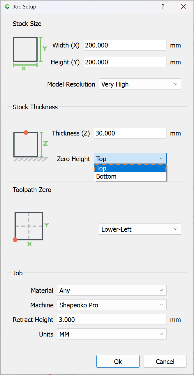

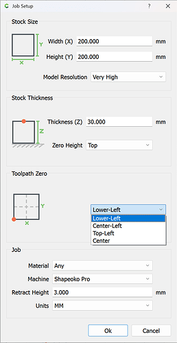

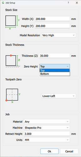

Locating the zero for a piece of stock relative to Zero is done using a BitZero β€” there are only 4 possible probing options:
  • XYZ fully registered at a corner
  • X at a corner (or edge if using a v1)
  • Y at a corner (or edge if using a v1)
  • Z when the unit is fully on a surface
which were gone through at:
and which need to match Job Setup which has four position options:
and two height options:
as described at:
