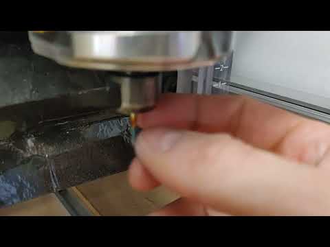

I checked if there’s any wobble on my end mill from the collect / spindle, side to side it’s rock solid, but there’s what feels like 1-2mm of play when I move it up and down. It’s tightened firmly in place.
Is that normal? I’m going to test it with a 1/4" endmill, maybe my collet is worn down.

Just tested a 1/4" end mill and there seems to be around 0.3mm of play when I try to move it up and down.
Can anyone confirm if this is normal and if it’s the collet or router bearing or?
That does not seem normal. Shouldn’t be any play that results in a tactile “click”.

Ok, thanks for the confirmation. I’ll order a new router today. Thankfully it’s quick and easy to swap out.
