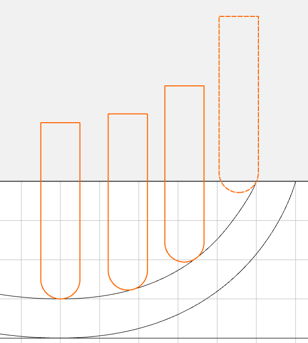

I want to make a dipper for water in a sauna and I do not know how I would go about hollowing out the dipper end to hold water.
Can anyone give me advice on this? I have uploaded a pretty basic file of how I started it.
I only have Carbide Create, not the Pro version.
What end mills would I need and how would I create the tool paths? Any other tips on this project? I have never done anything even close to this.

I start by making a section/side view.
Now draw the tool in where you need it to go. You will need a bunch more to get a good cut.
Use the bottom center node for the tool position to create circles to cut and determine the depth at each circle. Note the tool center point will not be the contact point on the spoon.

Thanks for the visual concept, it helps to see this example. Would this be used as a 2D tool path in which concentric circular paths are cut or is this being set up as a 3D tool path to cut left to right and descend towards the middle?
The visual concept @Tod1d showed is the same as I suggested.
It is using 2D toolpaths in the XY plane cut to the matching Z-axis depths — if you’ll draw up a side profile or vet the images above we can walk through this with you if you have difficulties.

What Will said ^, it’s the same as the spoon example above. Just a little extra illustration for clarity.
These are also referred to as “Z-level” toolpaths. A series of 2D paths cutting horizontal sections through a contoured 3D surface.
