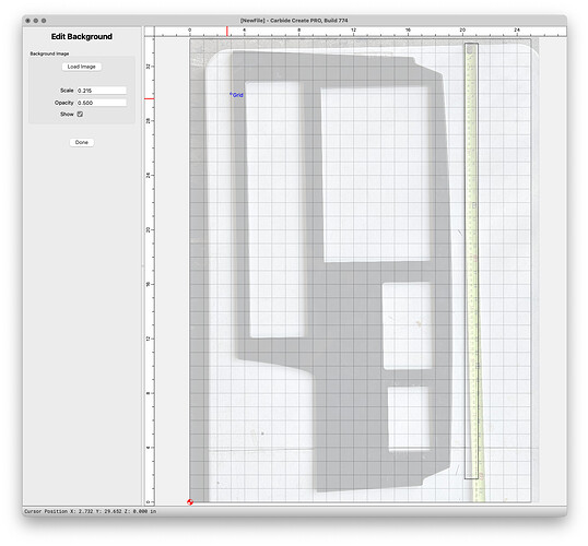

How can I measure these curves and get them perfectly as shown in the photo? There’s many curves and a curve on the top on the Dash Panel

If you think the top curve is a perfect curve then on a piece of large paper draw a set of circles about the size you think. Use the same center for each circle. Then lay your panel on top and move it to the various sizes until you find which one matches. As an alternative you could use a beam type compas and keep expanding it until each end matches and the center as well. Then you could draw a circle and measure it to get your curve radius.
Another alternative would be to take this to a copy shop that has large format scanner and copy it and get it digital and convert it to an svg. Then you could import the svg into CC. Just take a physical measurement of the object and create a rectangle that big so when you import it in you can size the svg to life size. Sometimes when converting the object can be bigger/smaller than the original size.
First tape small grid graph paper to the back.

To reduce distortion, you should stand as far as possible away from the item, and zoom in to take the picture. You also want to take the picture square on. If you can, hang the item on the wall (over a contrasting color), at the height of the camera.
How close is “perfect”? I only see 2 “curves”, the top edge & the left side of the bottom right cutout. The rest all looks like prismatic / parallel lines. I can’t tell if the left & right edge are tapered from the picture.
A flat bed scanner would produce much better results than a camera. But I think just measuring & drawing it would produce the most accurate results.

I would lay the piece on a gridded cutting mat and take as near level a picture as I could get; that should give you enough grid points to reproduce the dash.
I tried it and this is how it came out

I refined Will’s method by editing the image to square it up first, and then fitting the tape measure to the grid in CC.

If a tape measure is the most accurate measurement device you have, try squaring it up on the machine and using a sharp V-bit to move around & pick up points.
How can I do that ? Also I don’t have a V-bit. This panel confuses me very much with the angles
mount a straight edge (fence) & machine it parallel to the X axis. (optionally add Y axis fence too)
Use any sharp pointed tool and jog over the lower left corner & set XY zero. Jog to all other points, like the opposite corners of each rectangle, at least 3 points on each of the curves, and the other corners of the edge & jot down the positions. Now you can use these points to construct the part in CC, or any CAD software.
