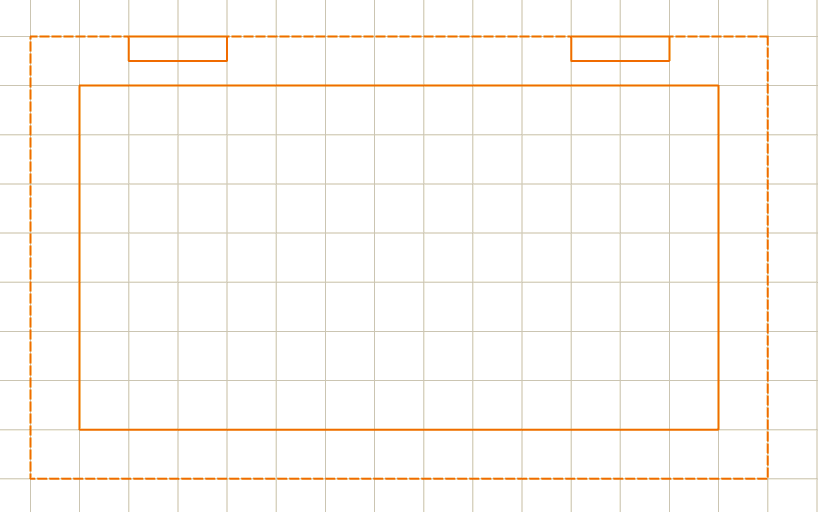

I just faked up something that looks like a lid - has a lip and room for two hinges:

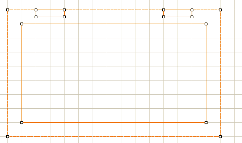

Select everything and use ‘Node Edit’:

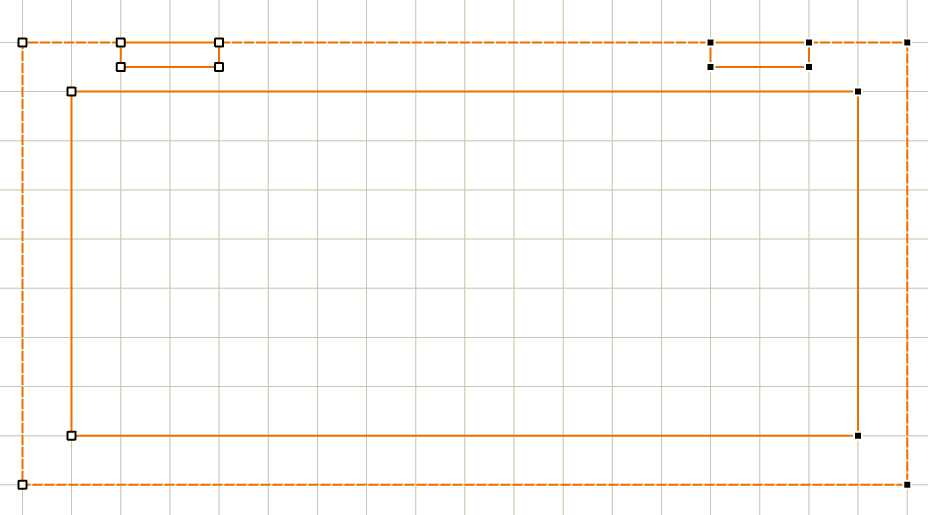

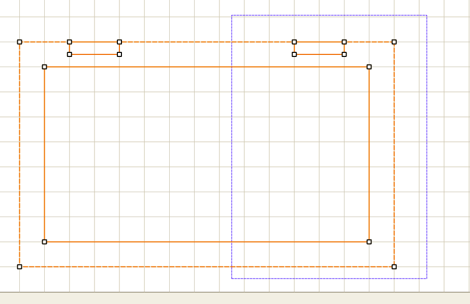

Now Multi-Select all the nodes right of center:
They will change to small black boxes. Grab one of the outside corners, and drag rightwards to a new grid point:
Done!
Moving on the grid makes sure you only get left-right movement, so the object isn’t skewed.
